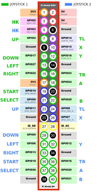

correia5022 wrote:Please correct me if i'm wrong, but i think he connects his PCB directly to the GPIO's of the Pi3.
So, what you have to do is simply connect the tactile buttons to the gpio and code them accordingly...
wait so I can attach two extra buttons? He gave me this chart that he used for this build I'm not sure where should the wires should go

Re: Lets talk about 1UP custom Gameboys
Post by tikiandskull » Wed Feb 22, 2017 8:06 am
gpio 14 and 23 for the triggers! ;) i use this for my build
abrugsch
Posts: 971
Has thanked: 356 times
Been thanked: 430 times
Post by abrugsch » Wed Feb 22, 2017 8:24 am
tikiandskull wrote:gpio 14 and 23 for the triggers! ;) i use this for my build
that would be L1 and R1...
try GPIO8 and 16 - they are assigned to second controller L and R but you can re-map them to first controller L2, R2
Pirate
Posts: 137
Has thanked: 95 times
Been thanked: 54 times
Post by Pirate » Wed Feb 22, 2017 8:50 am
Oh thank you guys so much I'll try this when I come home
