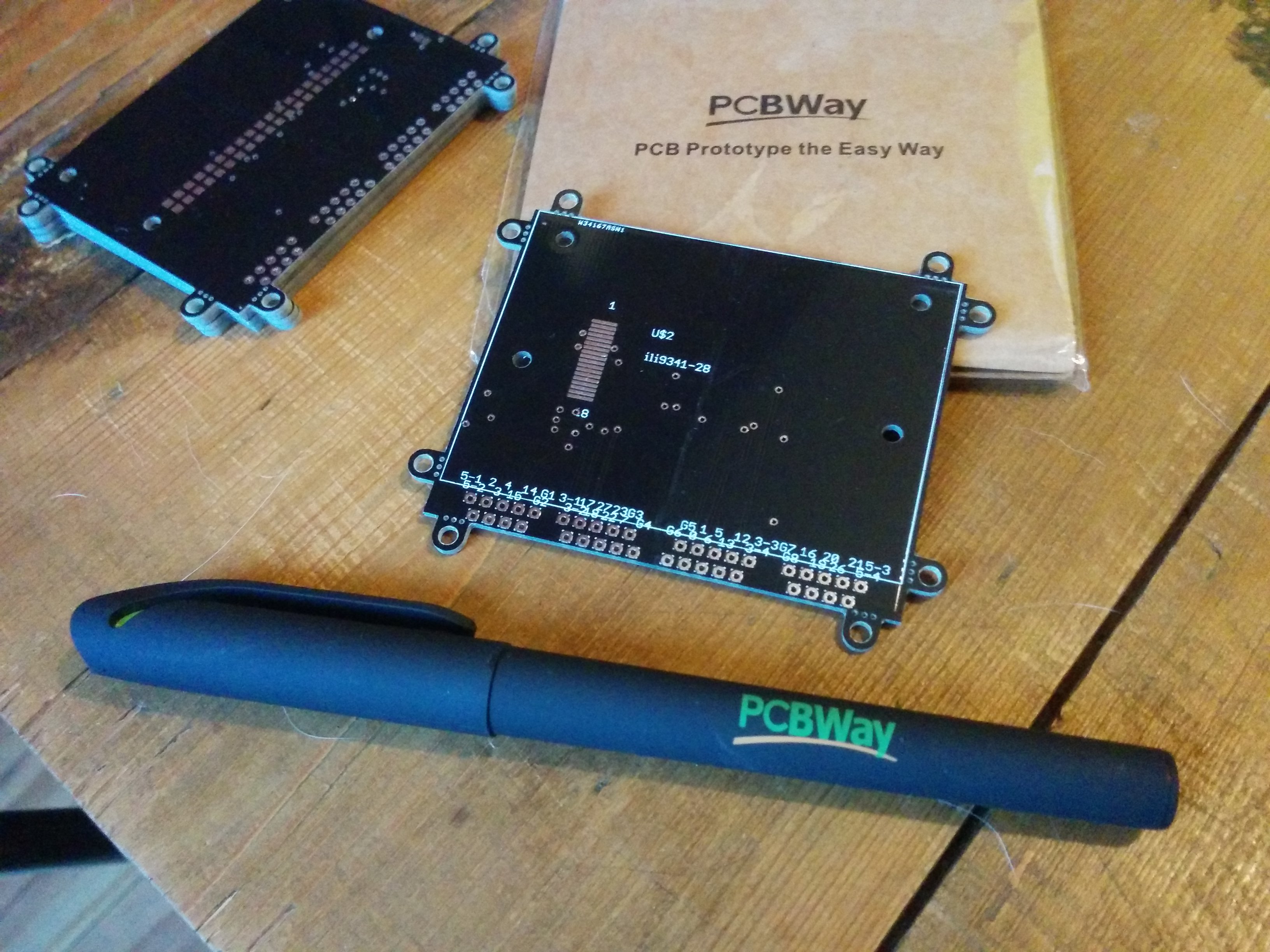

It's always a good day when a box arrives covered in Chinese writing. Especially when you check things and it all looks correct! :D

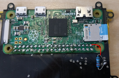

its alive!!!!!
Had a bit of a mare though!! seems i made 2 different 3.3v circuits on the board, and only attached one of them to an actual 3.3v source!! just one wire to fix, so its not a total loss.

I forgot the wire mod you mentioned and still haven't been able to boot it up yet...

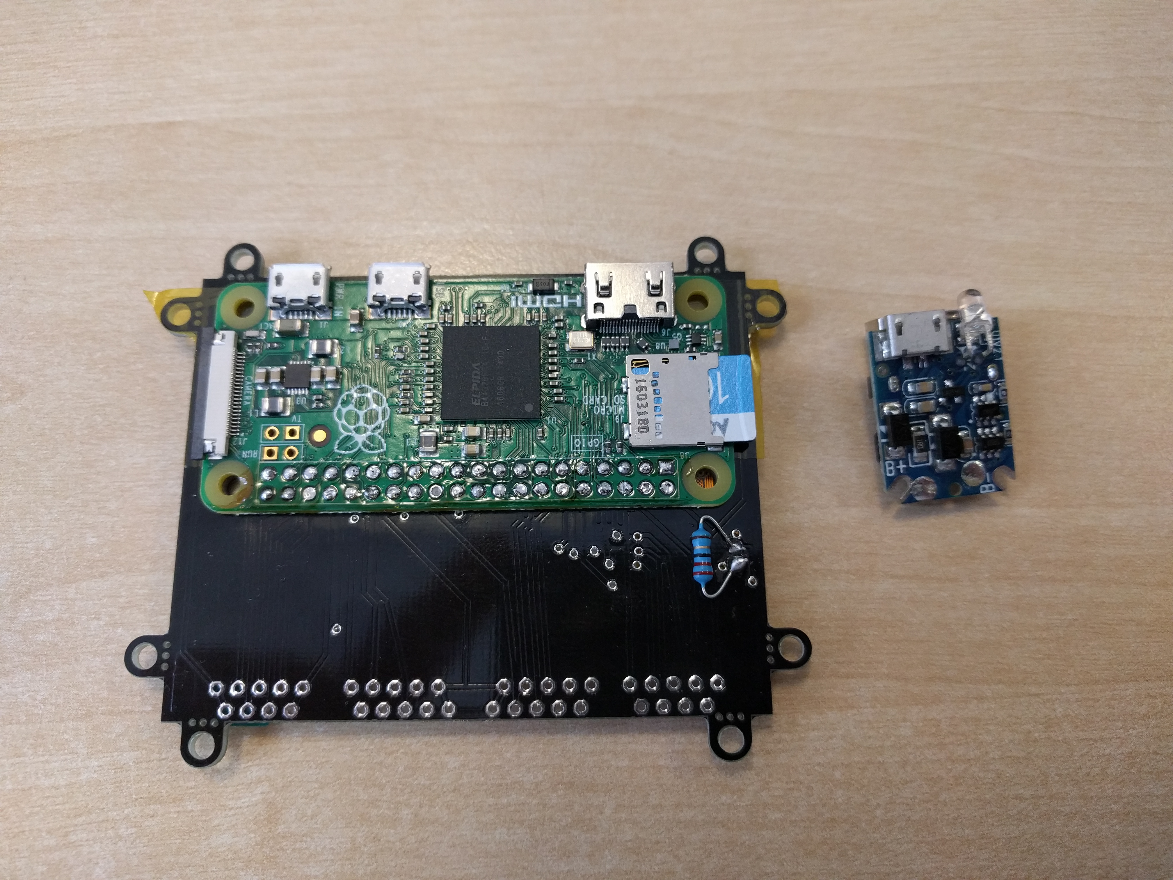

very nice!! i especially like the resistor bending skills!! Without the 'fix' wire, the screen wont work. although your resistor is close enough to the gpio pins that you could bridge from 3.3v to the resistor instead of using up those 3.3v connectors at the bottom
whats the extra little board? is that the charge/boost/protect board you mentioned the other day?

moosepr wrote:although your resistor is close enough to the gpio pins that you could bridge from 3.3v to the resistor
Ooh. good call. though i was going to replace it with a SMD resistor as soon as i got hold of one. but a kynar mod is still doable anyway... ok :)
yes, a tiny one for the VMU, which I'd forgotten that I was waiting for. :oops: once the USB A socket is removed (other side of the board) and I swap the overly large inductor for a lower profile one (incoming from RS at half the cost of the board just for the inductor! - only because I didn't want 10x of a cheaper one)
