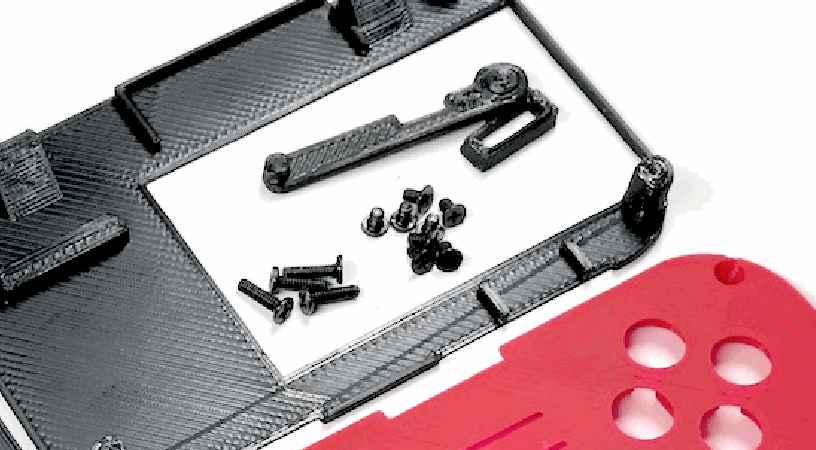

HoolyHoo wrote:
Fri Jun 09, 2017 7:13 am
Could be wrong, but that looks tapered to me.
Ah, didn't realize the case was tapered. Yes, if the hole is tapered you want a countersunk screw. When you're mounting a flat surface, like the Pi to Helder's board from some of the photos I saw, you'll want a counterbore screw.
I hear that if you buy a $30 pack of screws from wermy, he will throw in a set of 3D printed parts for free! (sarcasm :lol:)
Edit: I don't want to provide bad advice but it looks like wermy's long screws are counterbore. I'll let the pros weigh in at this point.

dryja123 wrote:
Fri Jun 09, 2017 7:26 am
yeah, in that pic, wermy is showing counterbore screws, which is strange because in the prints are countersunk holes. i guess that countersunk screws will fit better.
I think i'll give these a go:
Hexagon Socket
or
Philips type
HoolyHoo
Posts: 766
Has thanked: 206 times
Been thanked: 741 times
Re: STL Files for 3D-Printing mintyPi
Post by HoolyHoo » Fri Jun 09, 2017 7:52 am
Honestly, the screws are so small and the 3D part is soft enough that either screw will bite enough into the part that it should sit flush. I don't think it will make much of a difference so I really don't think we will have a screwgate issue here. ;)

Post by Helder » Fri Jun 09, 2017 8:26 am
Screws are all flat head counterbore Philips. Sizes include m2x3mm , m2x4mm , m2x7mm or m2x8mm.
3 sizes needed.

Post by wermy » Mon Jun 12, 2017 8:30 am
The holes are tapered, yes, but that's really just to make it printable cleanly without supports. I am using counterbore Philips screws, like you'd find in a laptop.
