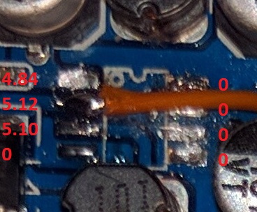

Yeah, I tested the wire where it connects to the board and it is a solid 5v. I tested the jumper wire connected to pin2 and it is 5v as well.

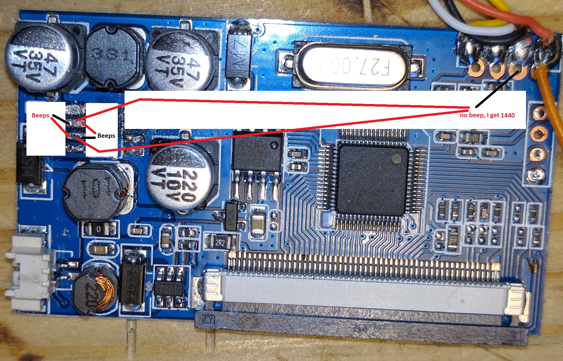

Fleder wrote:No, i mean, measure the solder pads where you soldered on the wires, if they are somehow connected.
No problem, let me know if this is correct. I test three points. The two in the middle beep. The other ones just show a positive number. I also test voltage as well. I flipped the image around to match the orientation of the guide.
Yo you got a "beep" from 2 to 3 on the continuity check? This might be the problem. Try to desolder those 2 points completely (with soldering wick), so no solder is left and reattach the wire again, if they are no longer connected with solder.

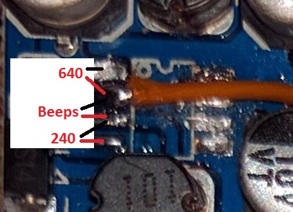

dirtybeagles
Posts: 386
Has thanked: 34 times
Been thanked: 64 times
Re: Modifications on my screen ? (Blue PCB) [Amazon.de, ePathChina]
Post by dirtybeagles » Sat Jun 04, 2016 8:32 am
Fleder wrote:Yo you got a "beep" from 2 to 3 on the continuity check? This might be the problem. Try to desolder those 2 points completely (with soldering wick), so no solder is left and reattach the wire again, if they are no longer connected with solder.
This image is after taking off the wire and cleaning up a little. I still get beeps though.
On this image, I tested the ground in the upper left while holding the red cable on the multimeter and I get a signal in the 1440 range.
Not sure I can clean it up anymore than what I have in picture 51

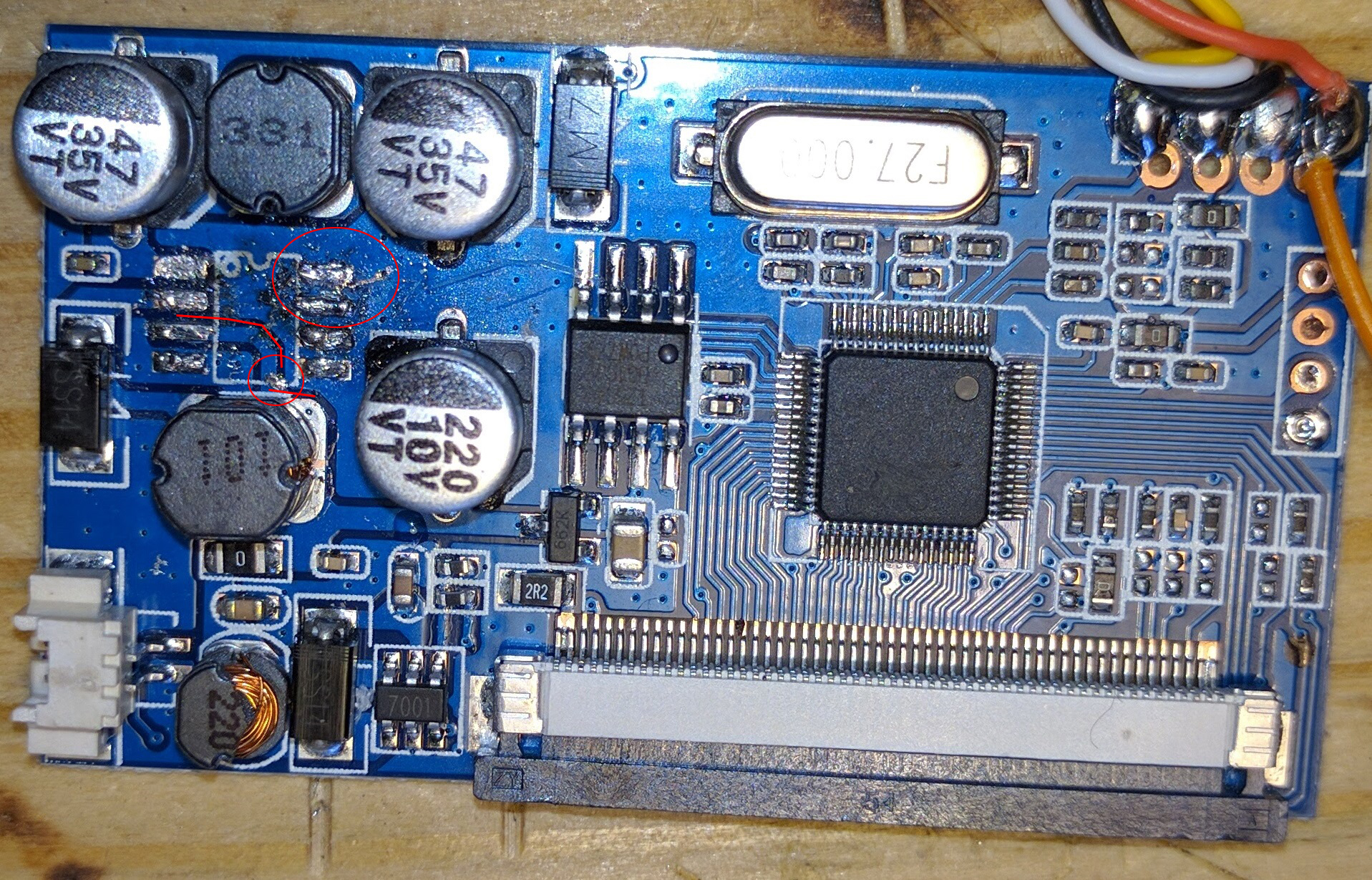

skrapps914
Posts: 184
Has thanked: 63 times
Been thanked: 33 times
Post by skrapps914 » Sun Jun 05, 2016 2:58 pm
any luck figuring it out? looks like theres a glob of solder in some points that may be bridging a connection. i followed a trace with the red line and circled the glob. also circled what looks like 2 points might need to be a little cleaner. if you have a wick, use that and clear it out best you can
