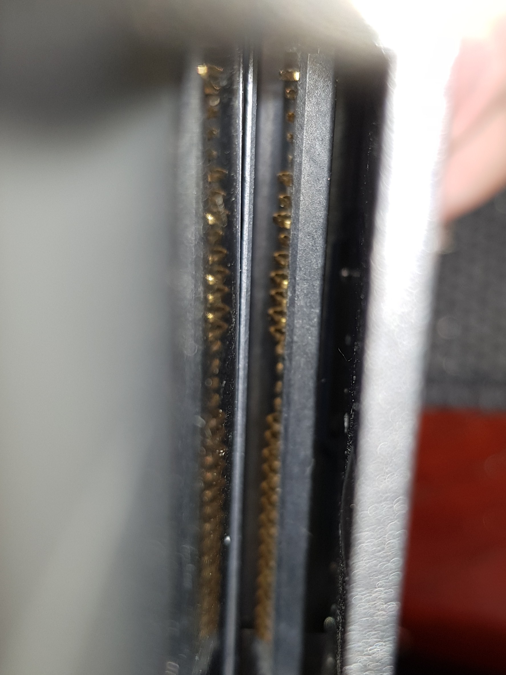

I thought I would check the pins on the underside as you suggested and I can see a bunch of them bent. Not sure how I've done that maybe while soldering. I doubt it will make a clear connection like that. I'll take it apart and see if I need a new one.

Meant to upload picture earlier. Just noticed it errorred

That looks pretty beaten up, i would re install a new cart slot. Rome wasn't build in one day remember :mrgreen:
indeed... that one is not that good...
i would also use a nother slot!
