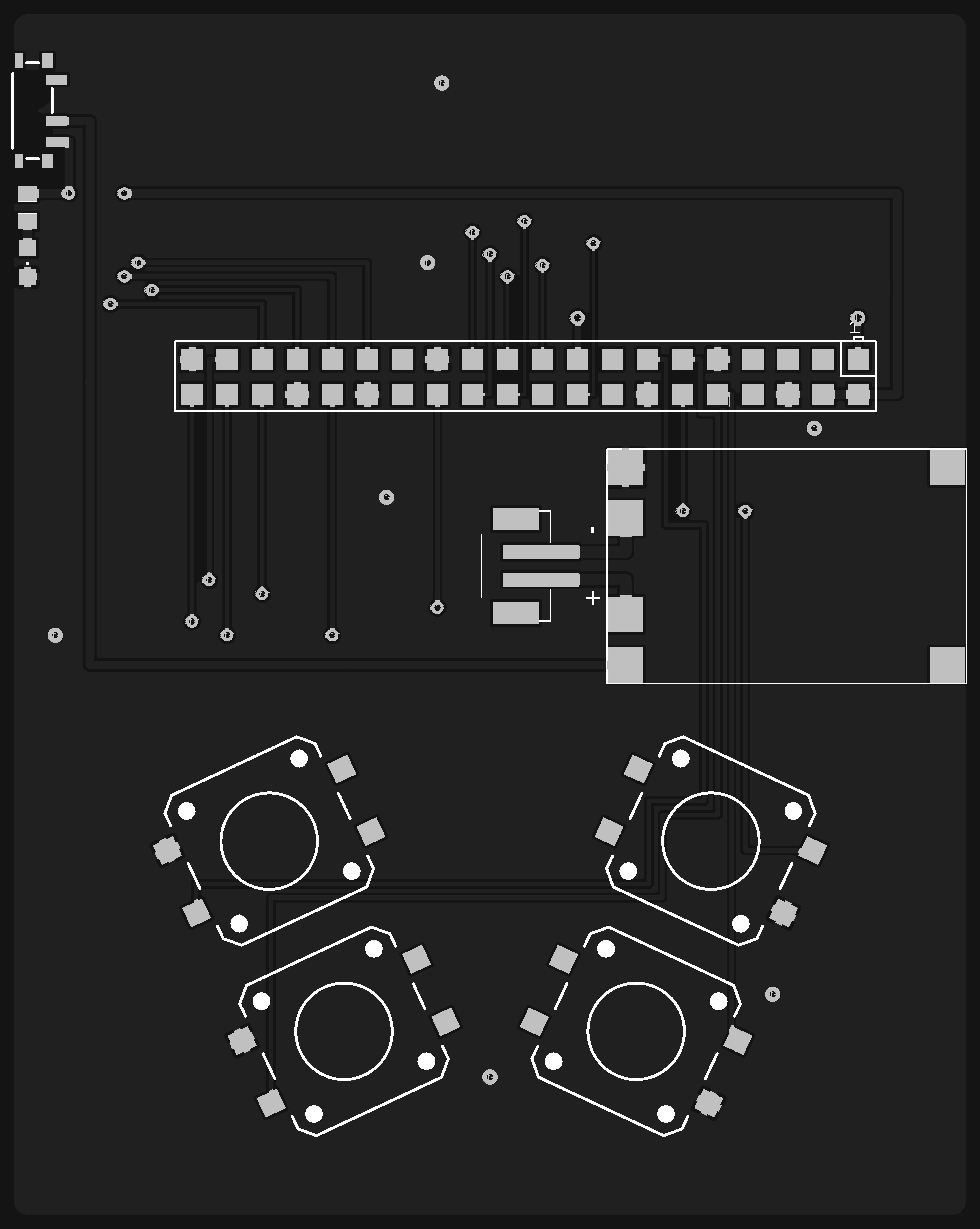

In my waiting (boredom) time of receiving the first run of of the 2.2" & 2.8" version PCBs from China,

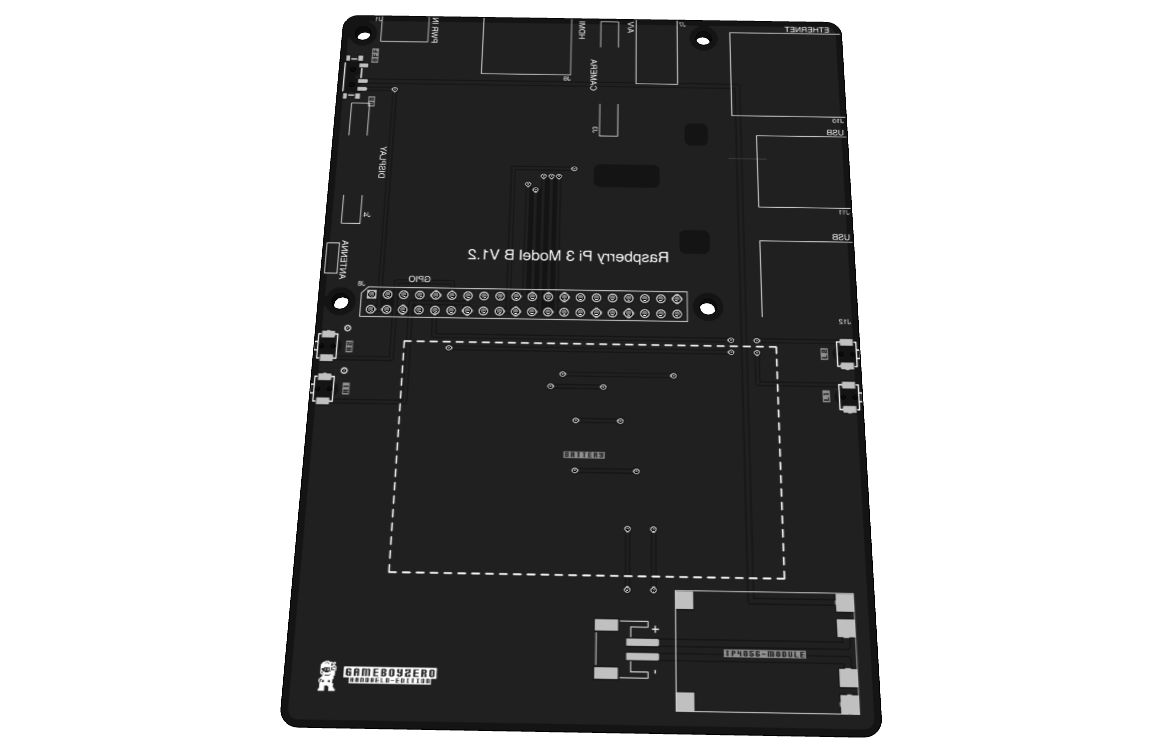

I have created and uploaded a 2.8" version using a raspberry pi 3. it's a little taller and wider, but this one also feature an accurate DMG (Gameboy) layout... ...eventually wanting to create a Acrylic / Plexi laser cut case
LMK what you guys think of this one.
Top view of RPI3 versionShow
Bottom view of RPI3 versionShow
This version would use a female header on the board and simply plug and play. that way you would not be committing your Pi for life
I will later replace the 40 pin header with an SMD Female Header Socket (or you can just use Kapton Tape)
The GitHub repo in my signature is always up to date

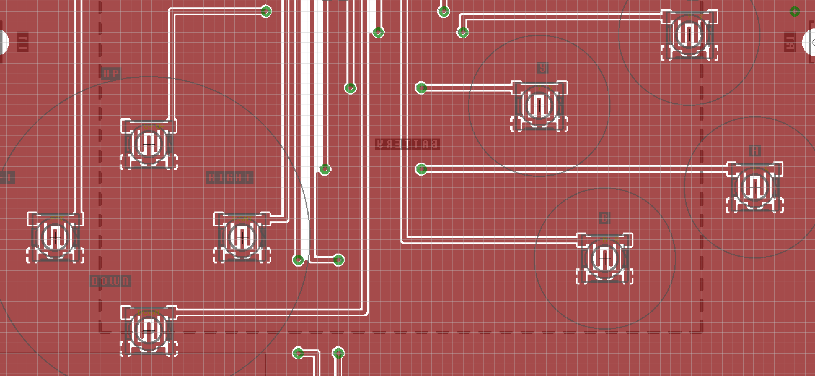

i have, and that's a great idea, since that would reduce cost by using capacitive buttons.
what i will probable do after the initial short run is overlay the capacitive touch and tactile switch on the foot print
pad and button overlayedShow

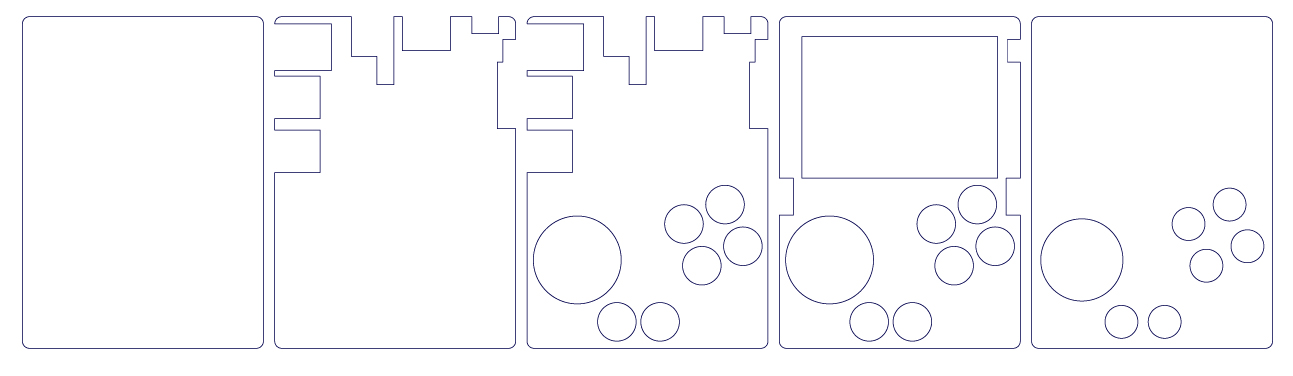

As well, currently working out a plexi (layered) solution for the Pi3 version (PiZero cases to follow)
Plexi Layers for Pi3Show

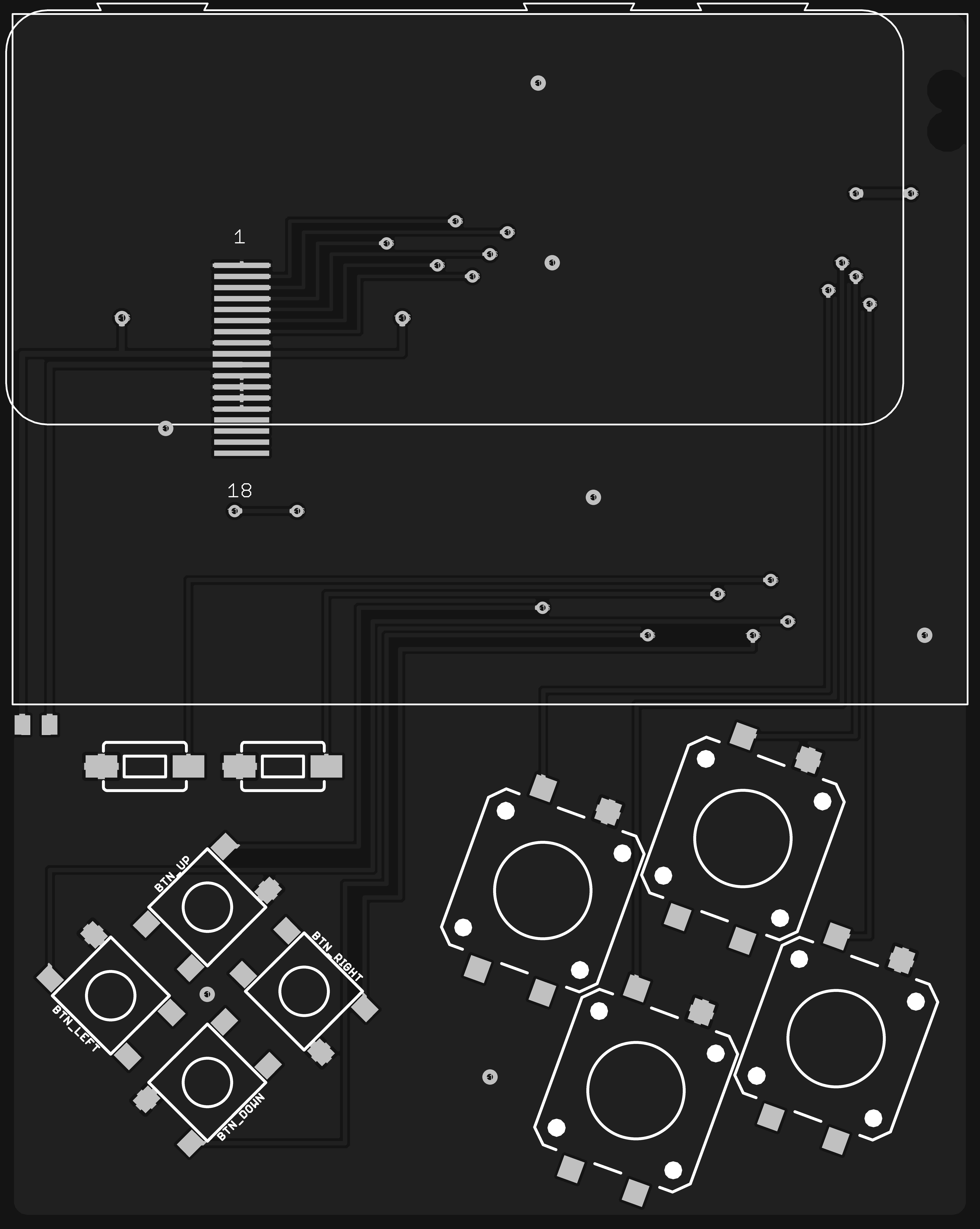

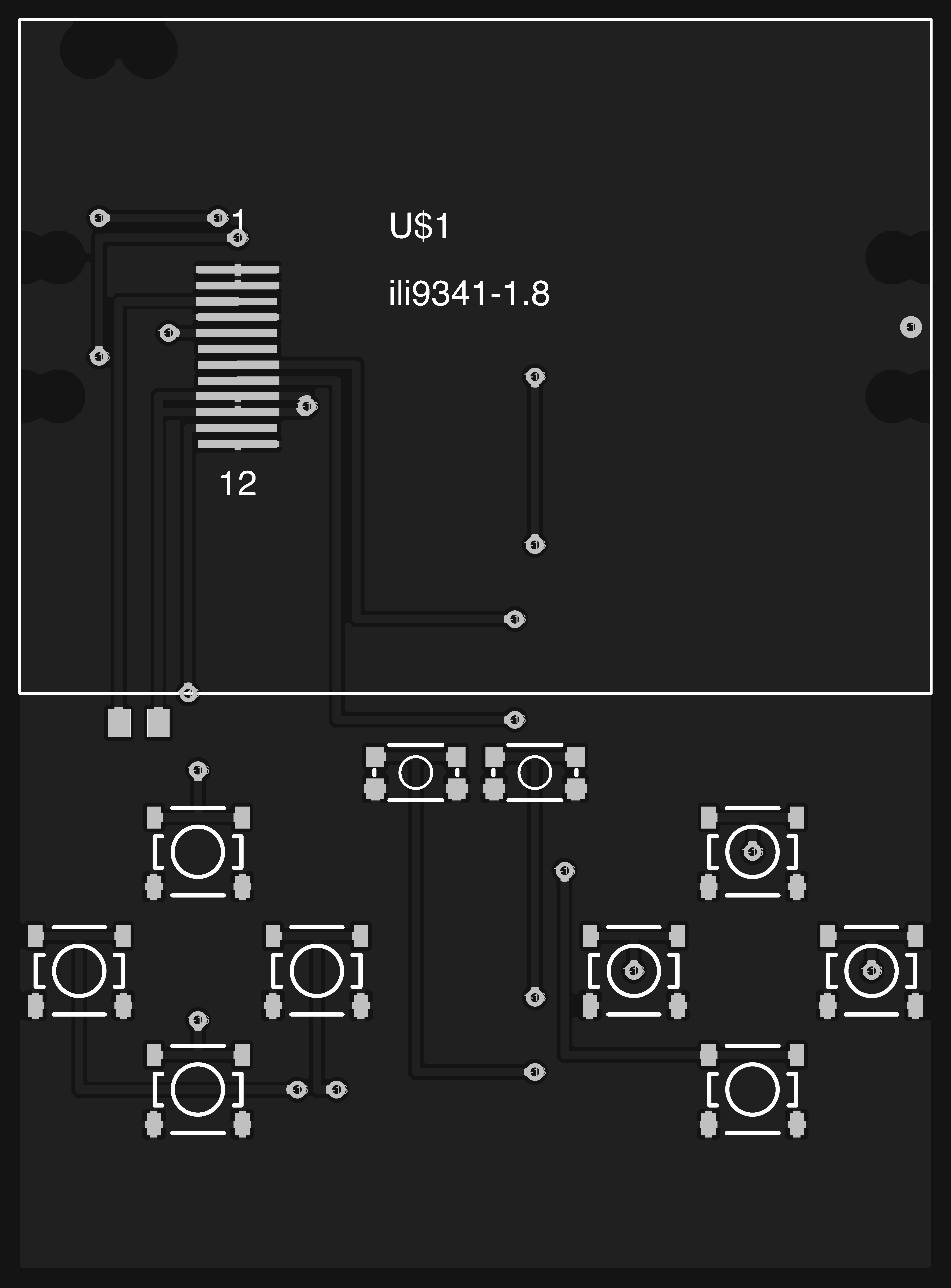

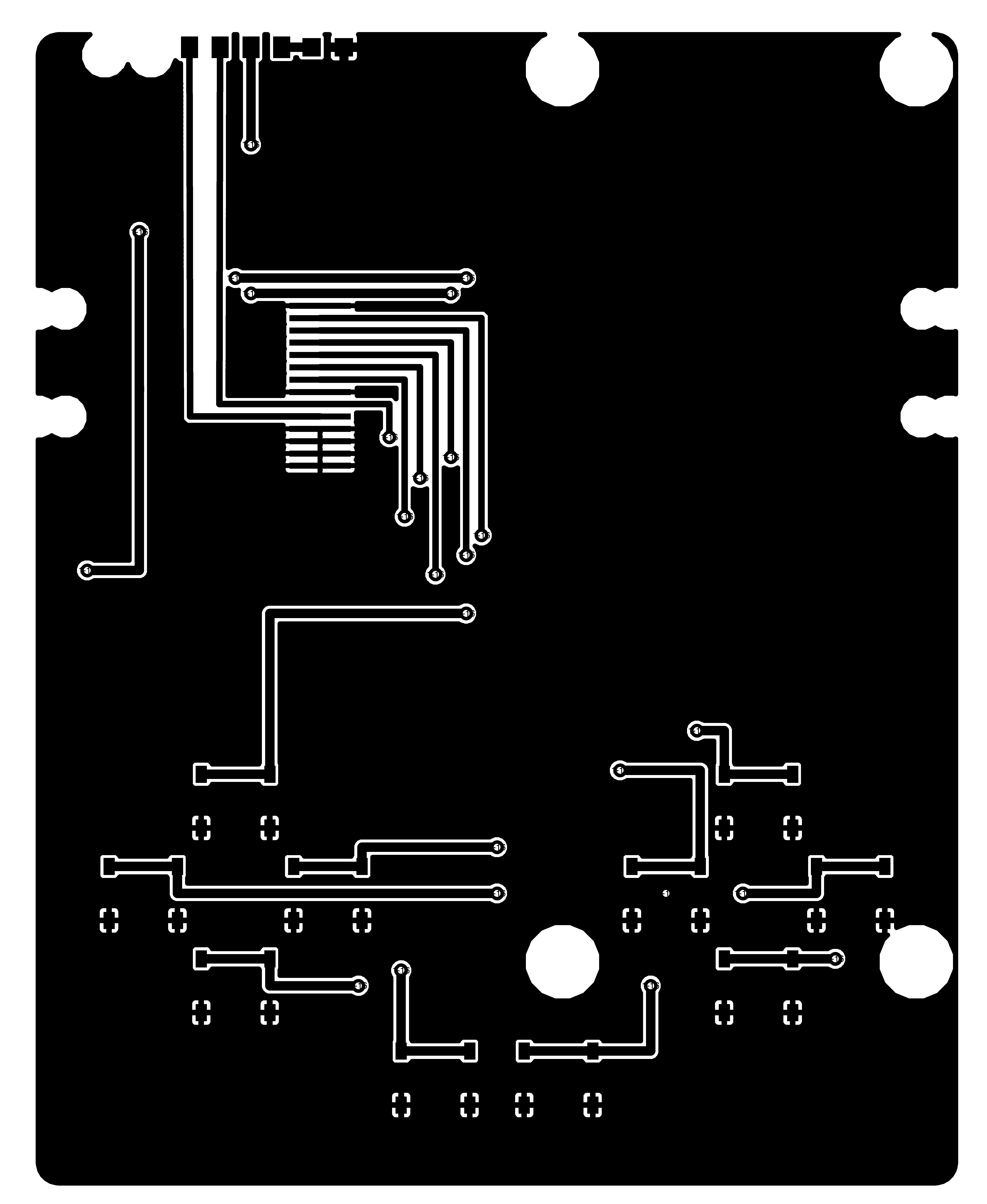

So after tinkering with the smaller 4.2mm outline buttons i have found that once i have them in hand, it's too small.
Iterating on the project, i have netted out that the 2.2 ILI9341 will suit it the best
The d-pad buttons are now 6.2mm outline tact switches, rotated 45 deg and laid out in a diamond formation.
The primary buttons (ABXY) are now matching the 16mm offset of the standard DMG layout.
The shoulder buttons (L1/2 R1/2) are now lower on the back panel and have been placed in an ergonomic fashion.
This was done in order to accommodate a simple 2 layer plexi case (to be designed)

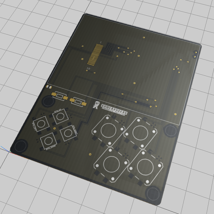

Check out the pics, let me know what you think
(for some reason the Pi Zero tPlace layer shows up on the tPlace of the pcb in printing, but won't be so on the final stencil)
topShow
bottomShow

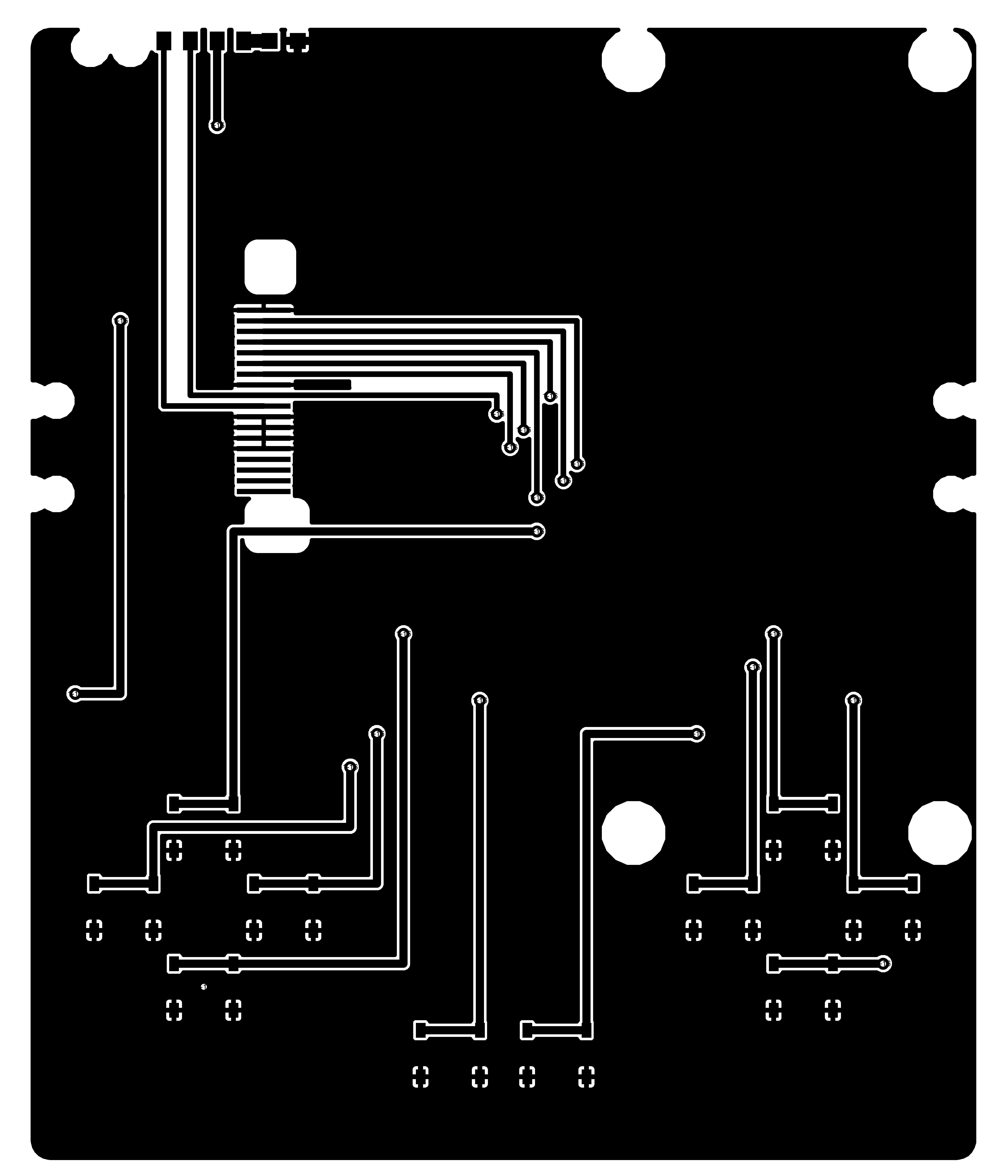

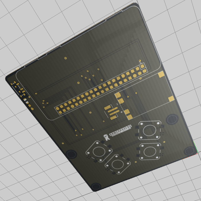

top silkShow
Screen Shot 2017-09-12 at 2.28.57 PM.png (295.22 KiB) Viewed 10055 times
bottom silkShow
Screen Shot 2017-09-12 at 2.29.24 PM.png (315.56 KiB) Viewed 10055 times
