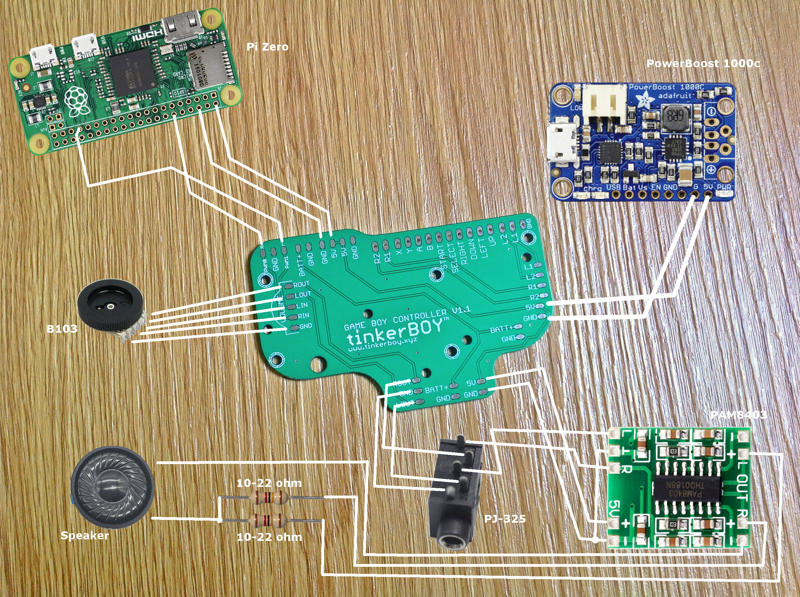

Re: Do I have the right parts?
(I deleted a previous post I got links mixed up)
So I was about to order everything and then stumbled across this an a option. Compared to what I was going to buy originally. Wouldn't this just be a better option? So then with this pcb the tinkerboy couldn't I just wire it to the Pi for gpio controls? Then the only this left would be in terms of assembly ( USB for keyboard etc and micro usb for charging and screen)
- GBCv2.1_wiring-1.jpg (2.47 MiB) Viewed 6495 times
- rodocop
- Posts: 1723
- Location: Saskatchewan
- Has thanked: 606 times
- Been thanked: 608 times
That board is essentially the same as the one you have linked, it is a basic PCB and you can wire the controls via GPIO or Teensy, I've actually used this exact board (one version down with no volume wheel connection, but I didn't use a volume wheel anyway). The only thing about this board that is better is that you can route audio, and power through the board which is handy. Also, if I recall correctly TinkerBoy is out of stock on these anyways, and I know he has also been producing some other boards with more features, which you could wait for as well.
As you can see, in terms of wiring they will be essentially the same, but if you wait for TinkerBOY to release some of his v2 boards you'll get build in audio amp and controls via a teensy.
My TinkerBOY buildShow
My simple PCB like your first linkShow
