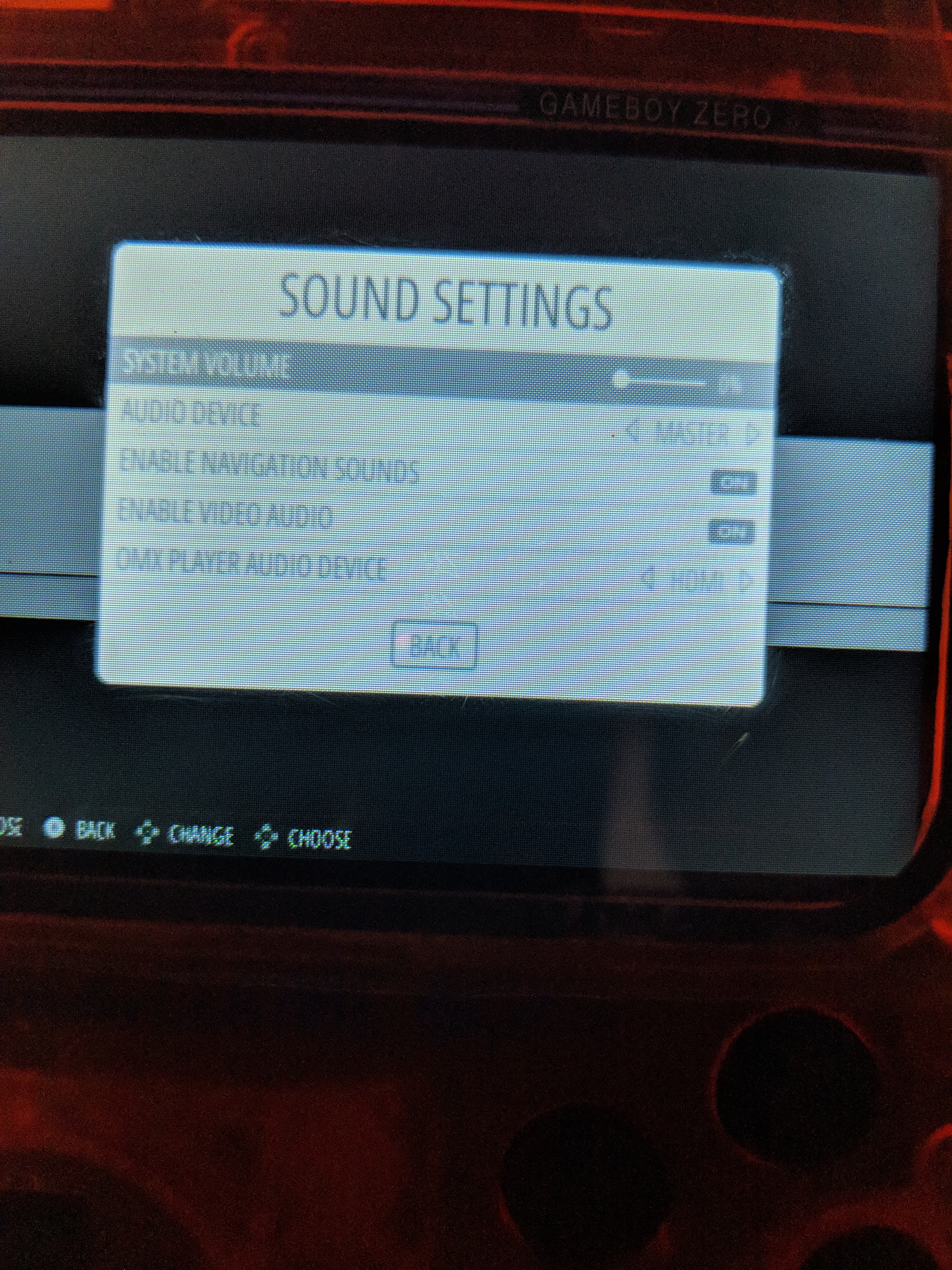

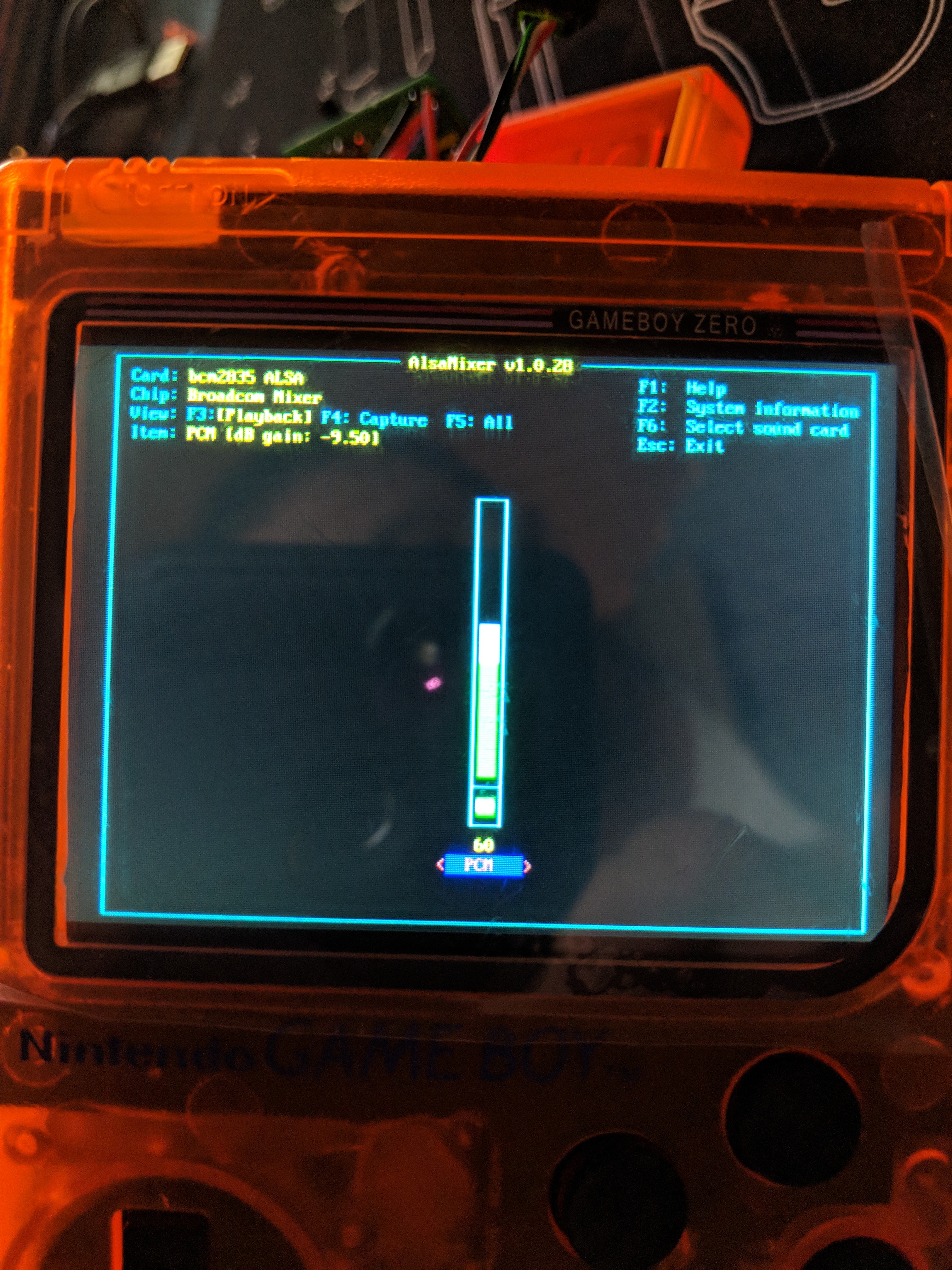

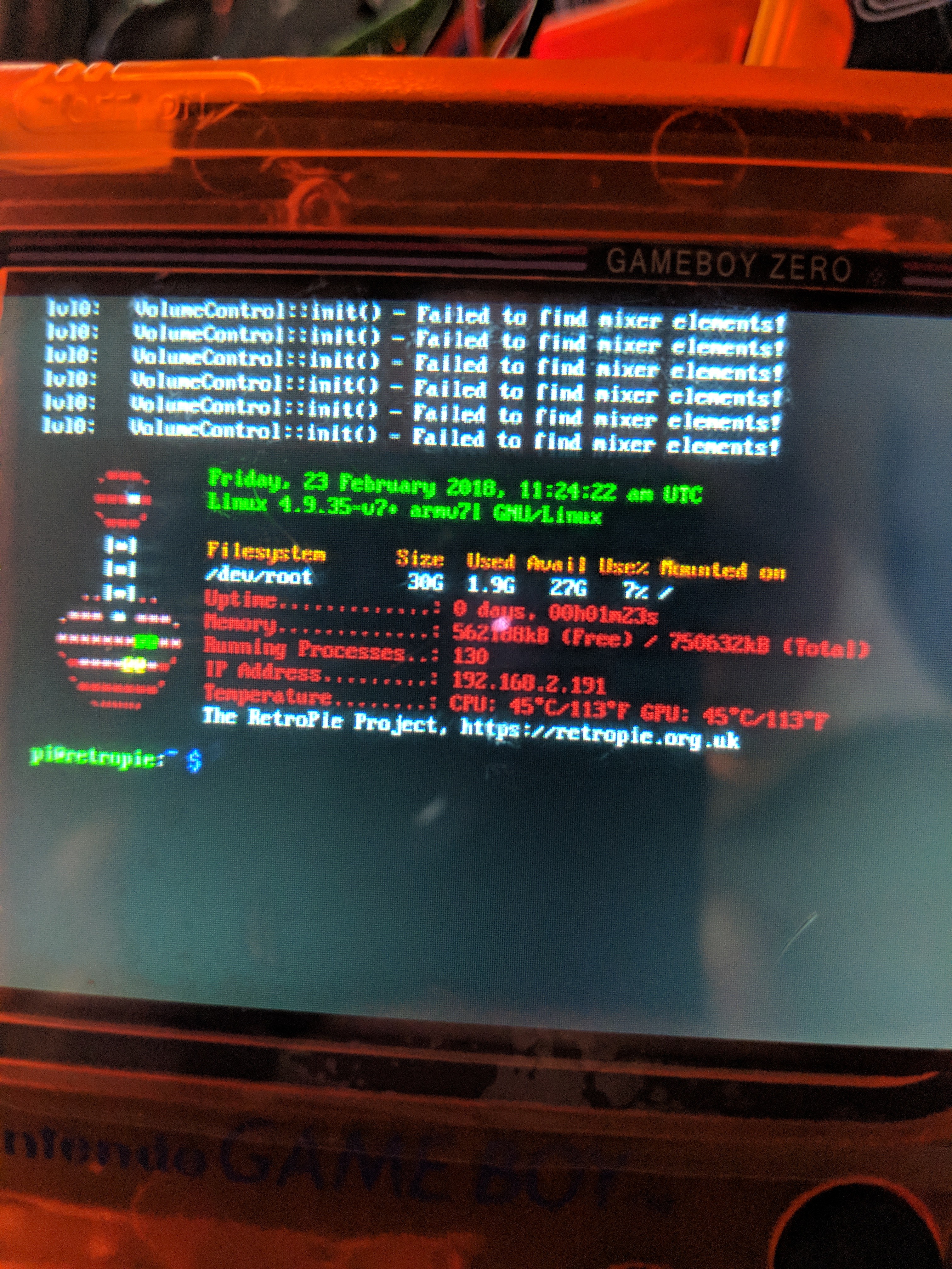

For anyone who wants to assist with my alsamixer issue, here is what I know. With a fresh image, on first boot, alsamixer settings in ES show up and work fine. After the first shutdown, the settings all seem to grey out and there is no more sound in ES. I can change the settings, but they reset when I close and reopen the settings screen. When I exit to console, I am prompted with a "no I2C chip found" and "RetroPie lvl0: VolumeControl::init() - Failed to find mixer elements". I am researching the errors atm but not really getting anywhere, yet. If I launch "alsamixer" from console, I can turn up the system volume and get sound back, but still no ES sound menu settings working. Frustrating set of issue, but I'm determined to resolve them.

I agree that the amp shouldn't be too much but the speakers began to sound overpowered and terrible after the first 1/16th of a turn of the volume wheel, rendering it useless. So if nothing else, the additional resistors made my wheel usable again.
I have tried setting sound to only HDMI , as well as every other option, with no luck. In the pics, u can see the mismatch between the GUI and console system volumes. Only the console setting will save and stay put.

the volume wheel may be a dud (faulty), it shouldnt do that....
also try changing the Audio Device from Master to either PCM or Speaker....
