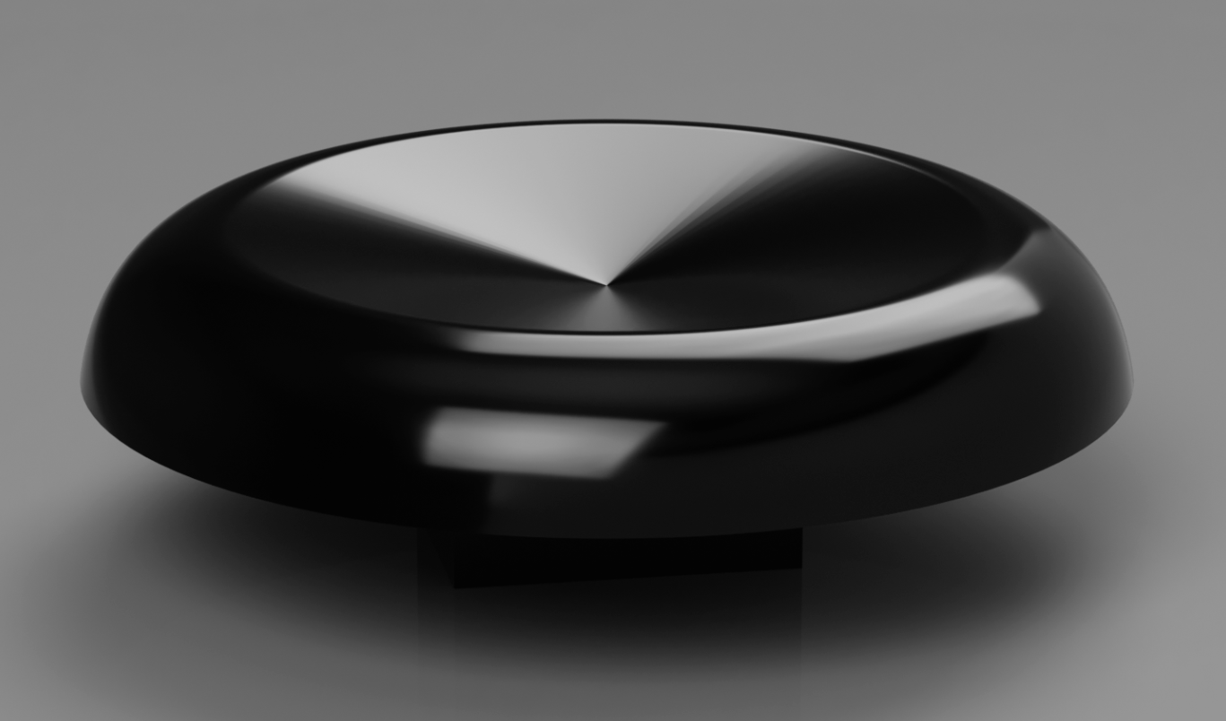

I printed it in the orientation as seen here:
CapShow
I printed at .2mm first layer and subsequent layers at .1mm. Supports on the bottom.

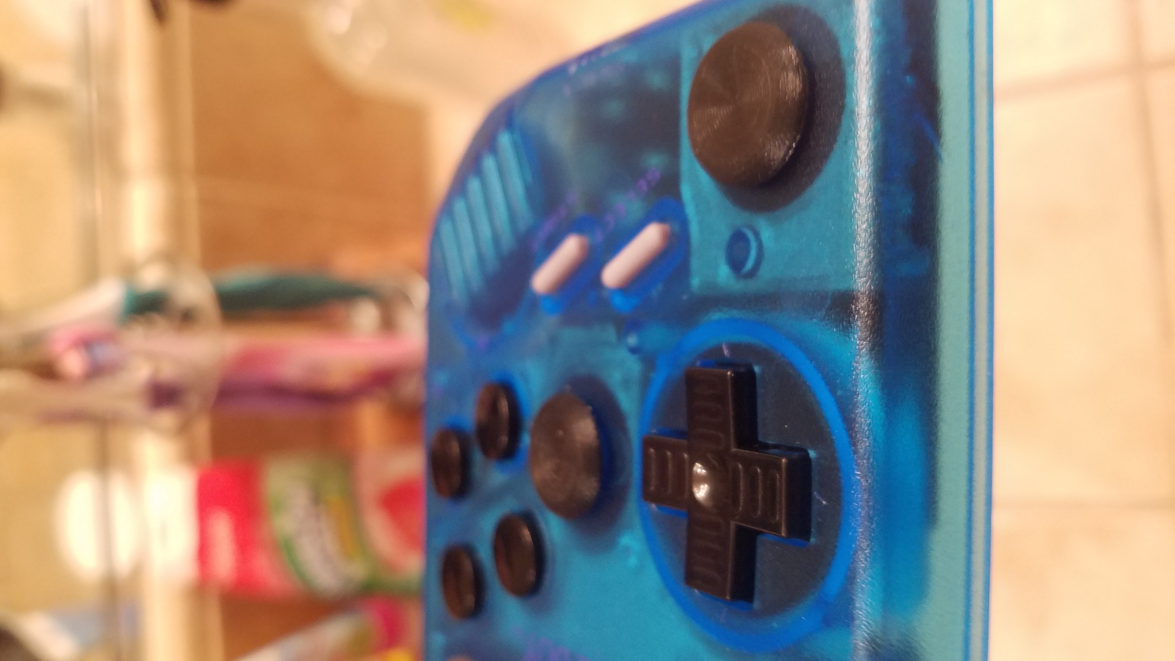

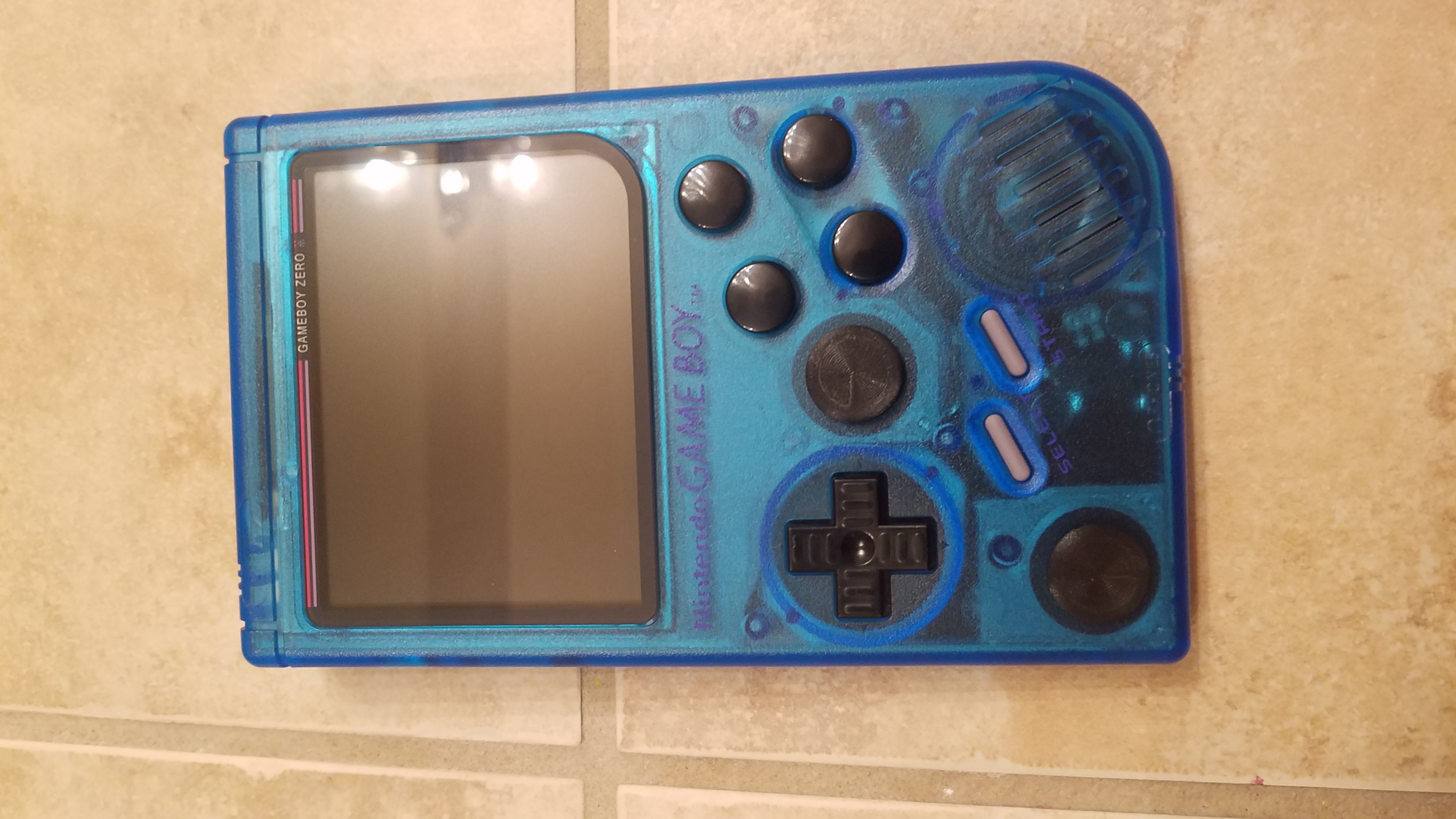

I'm using the STL in my RetroPie Futureboy build. I just posted a work log on the forums! Thanks for the work on this! I printed mine in clear filament, and it's going in a transparent case. So having clear sliders to match only made sense!

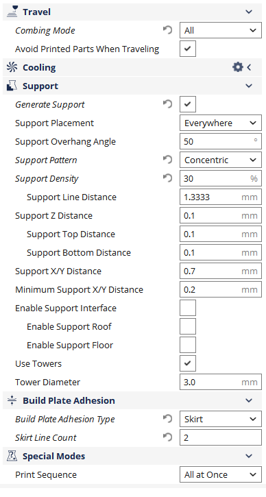

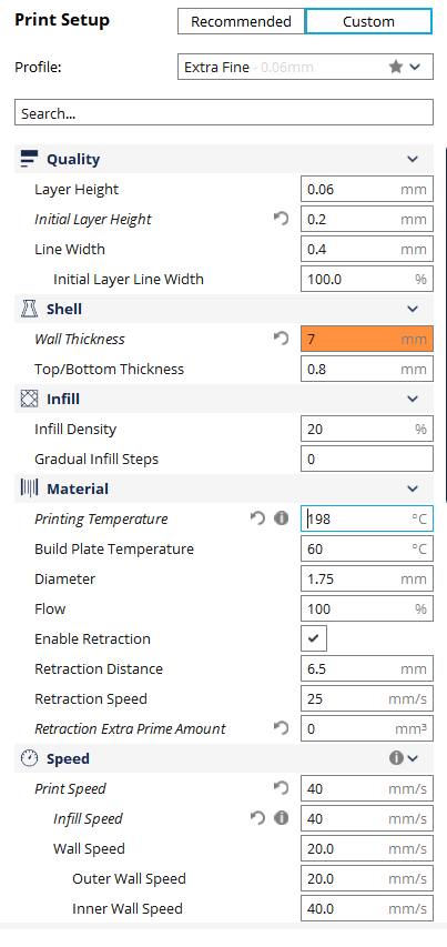

Cura Settings
Joystick Cap Print Settings 1.PNG (31.15 KiB) Viewed 17918 times
Joystick Cap Print Settings 2.PNG (29.98 KiB) Viewed 17918 times

https://www.element14.com/community/com ... -like-heck
I had issues when a friend was printing them where there's a bunch of teeth on the bottom sides. Im not sure if it's the filament or not.
