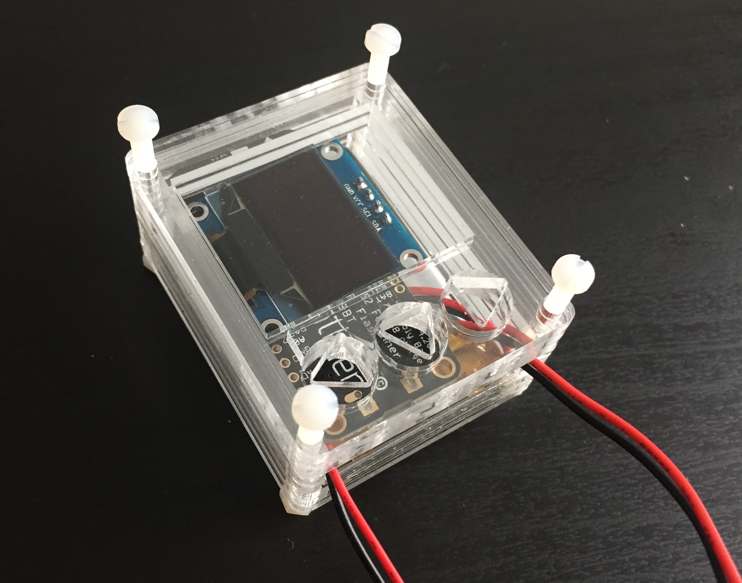

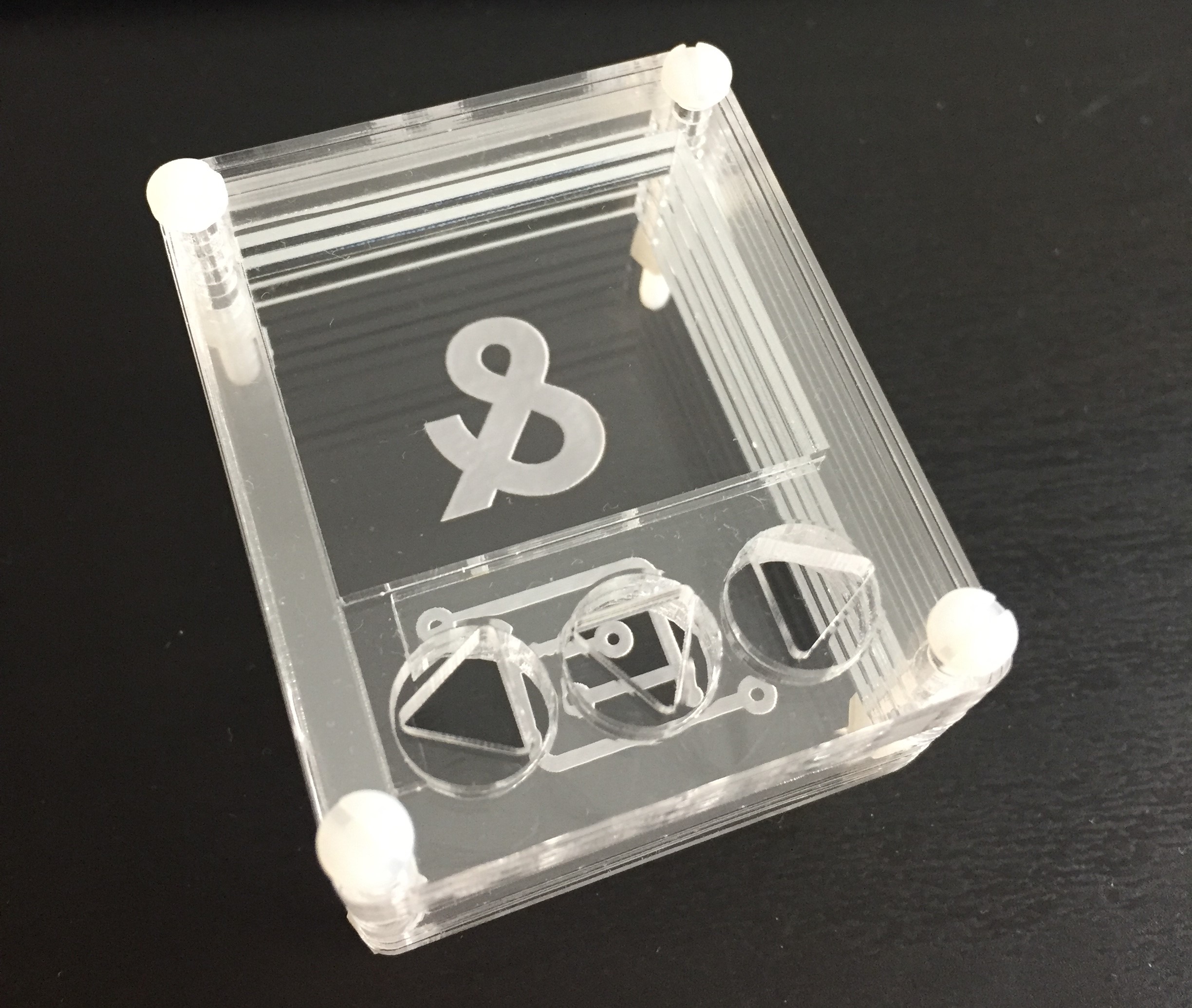

Got the laser cut parts for the case and buttons today.
Front:
Back:
Checking everything fits:
Very snug here, had to clip the top off the JST connector
PCB should arrive on Friday so I might have this finished in a week's time.

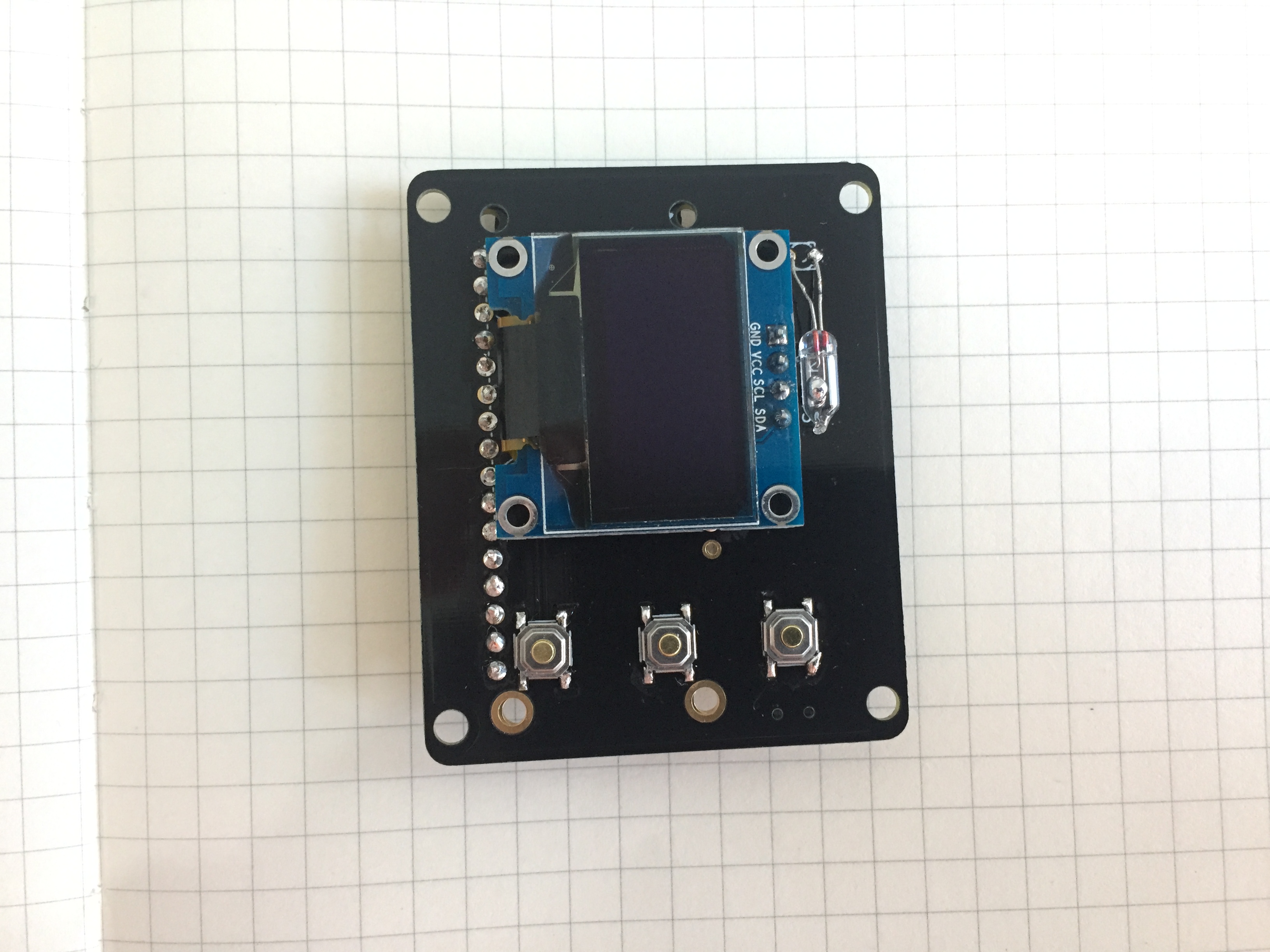

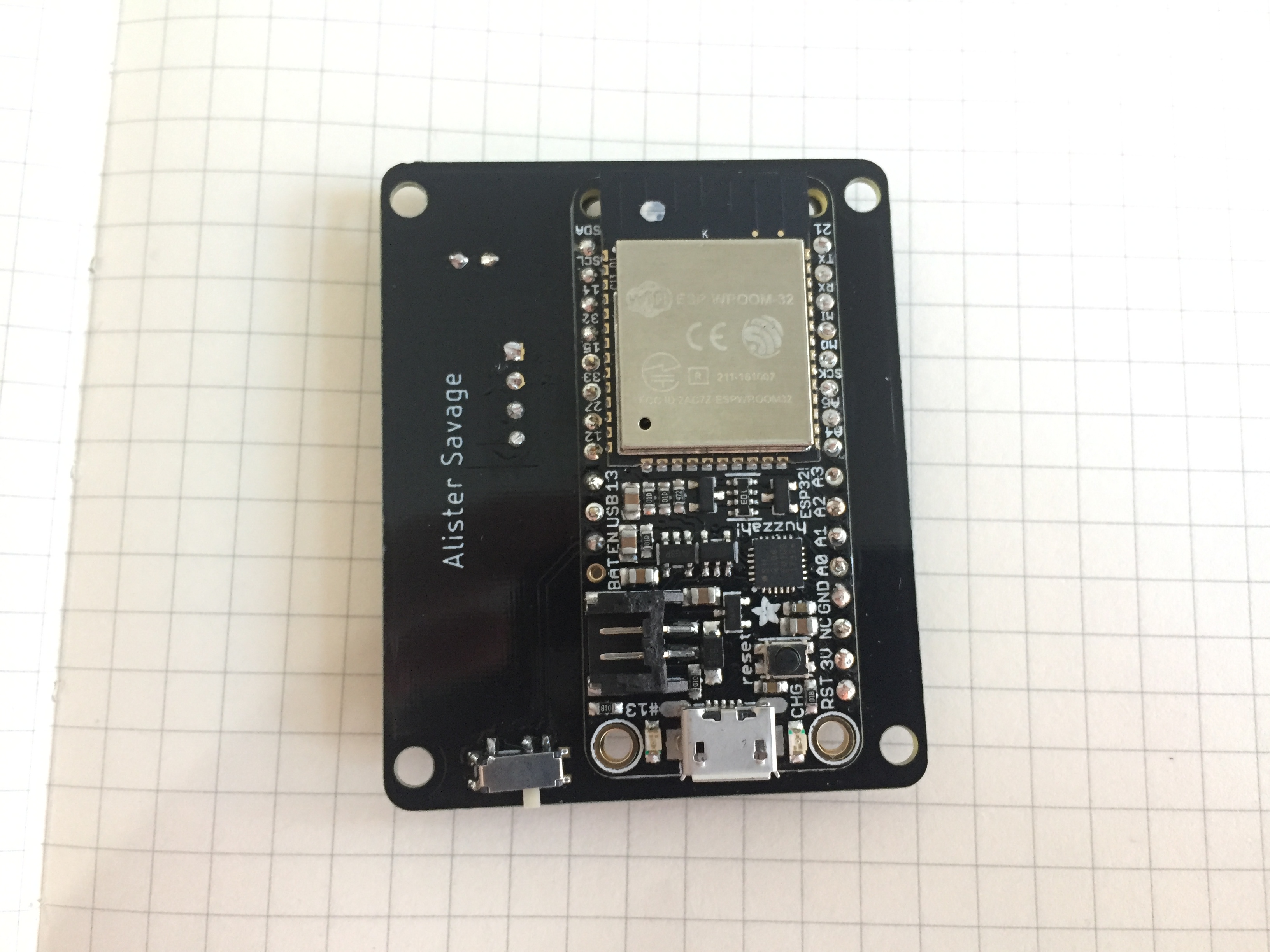

My PCBs arrived a full 5 days early

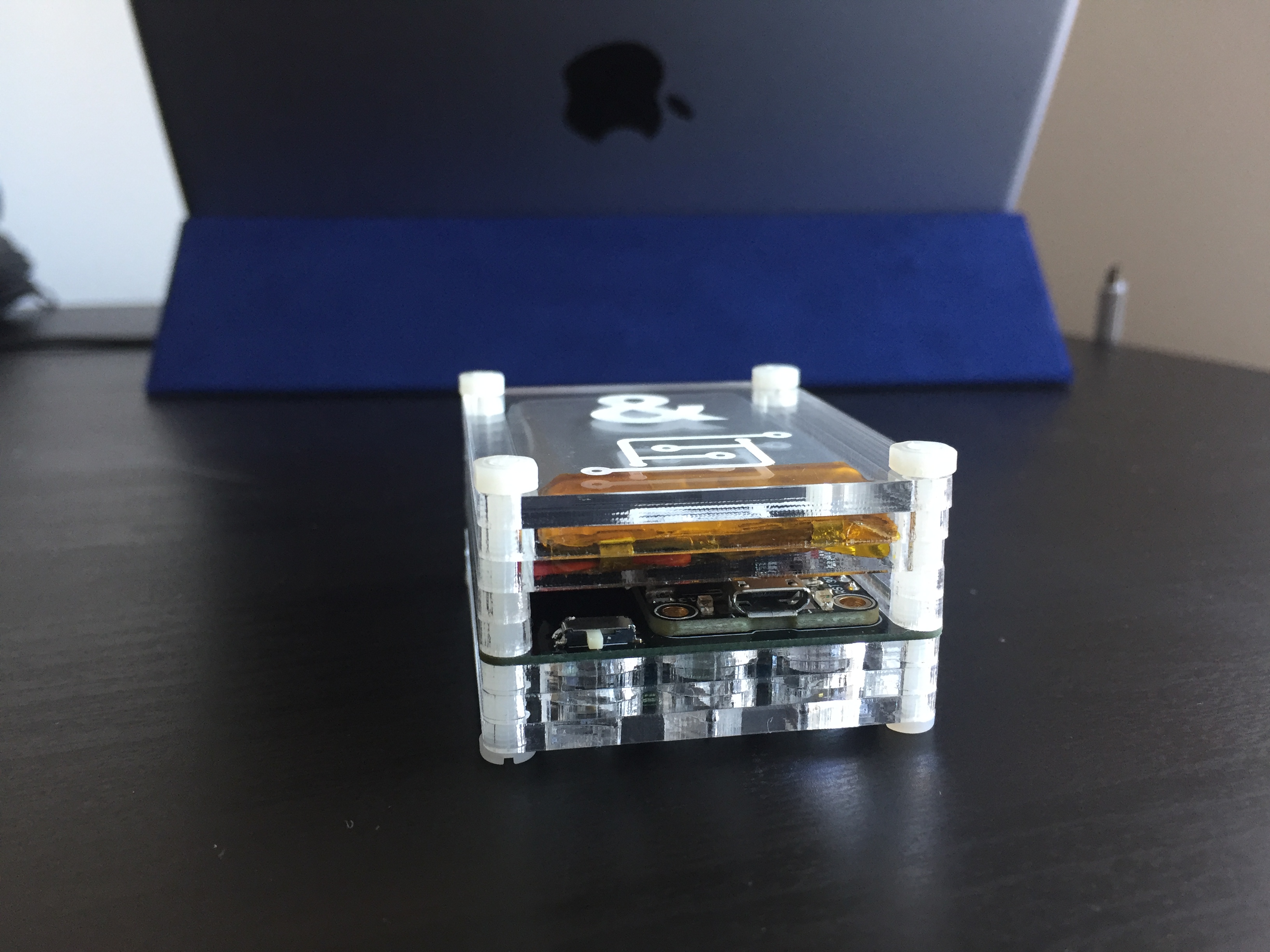

Front all soldered up:
Back

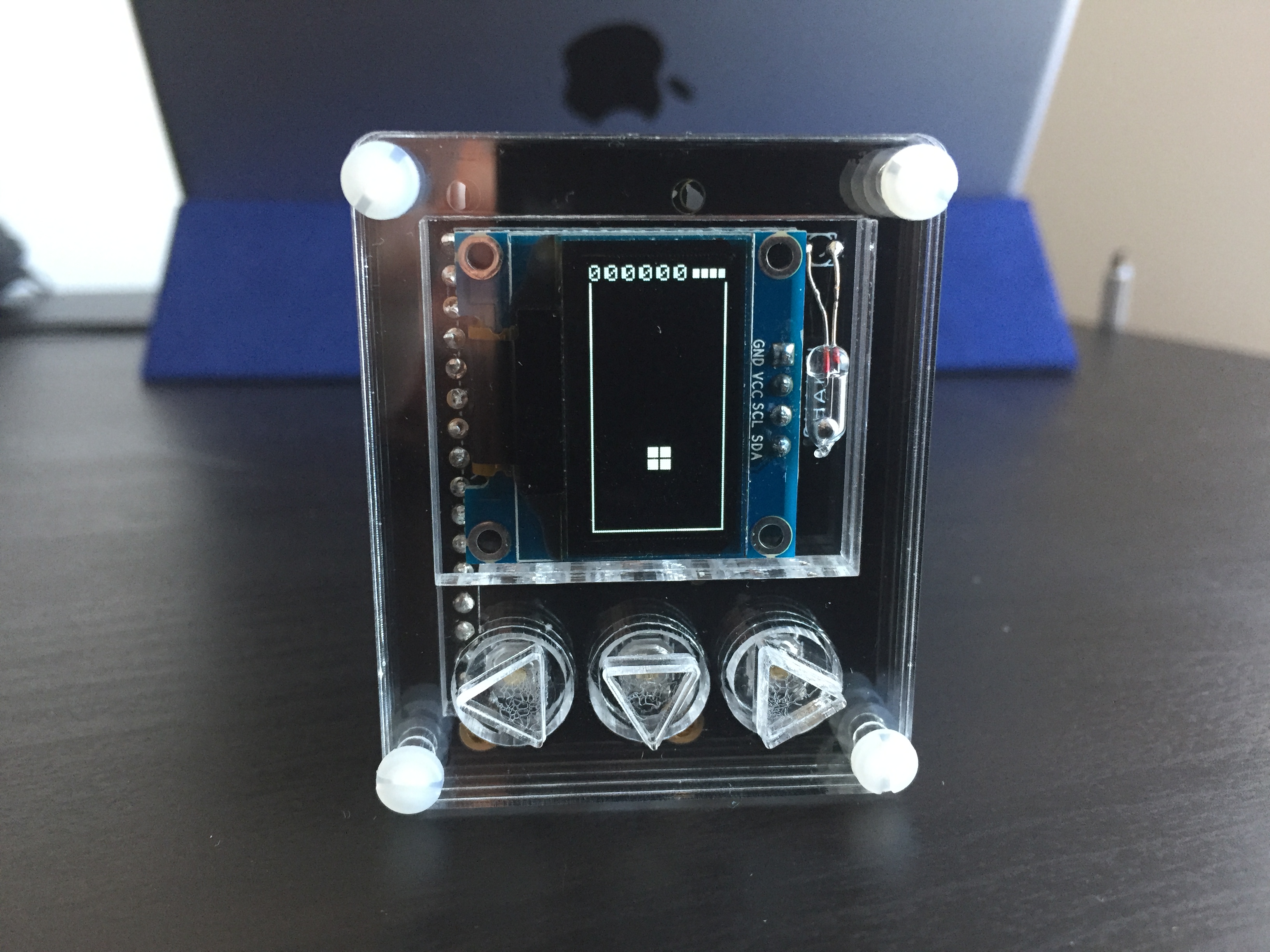

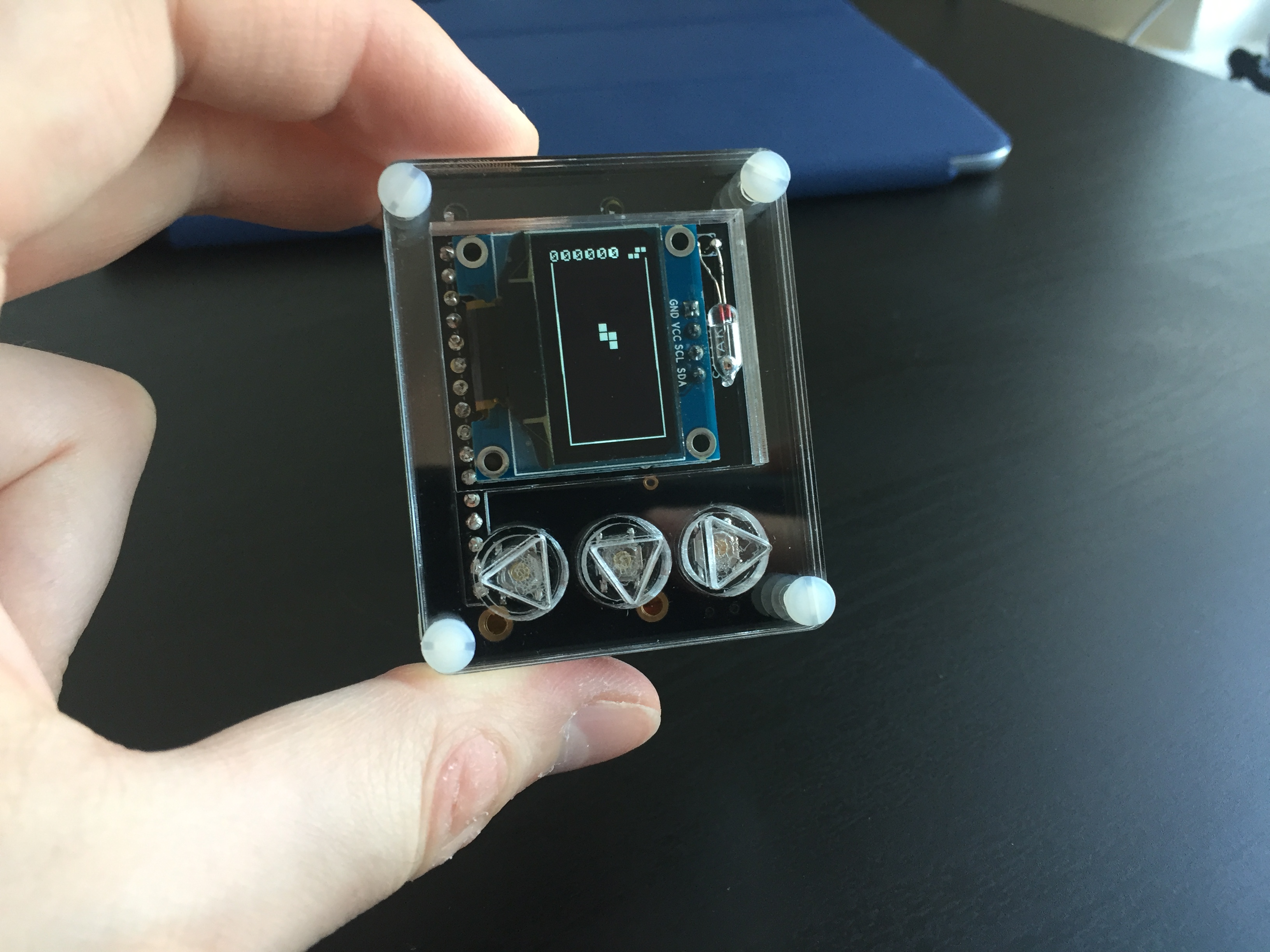

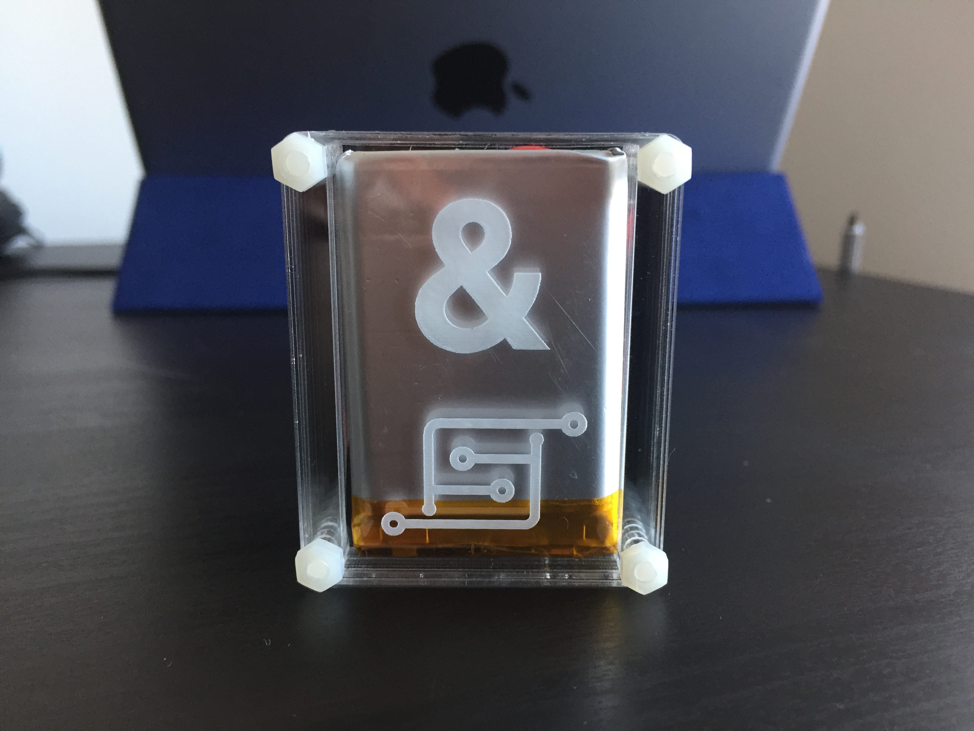

And all finished in the case
Front:
Back:
Bottom showing the opening for the micro USB and power switch:
Everything works exactly the way it's supposed to. Overall dimensions: 45x55x29mm
I'm pretty happy with how it turned out

Turns out it has an 18-hour battery life.
I know 1000mAh was overkill, but it was the same height and width as the other components so made sense.
