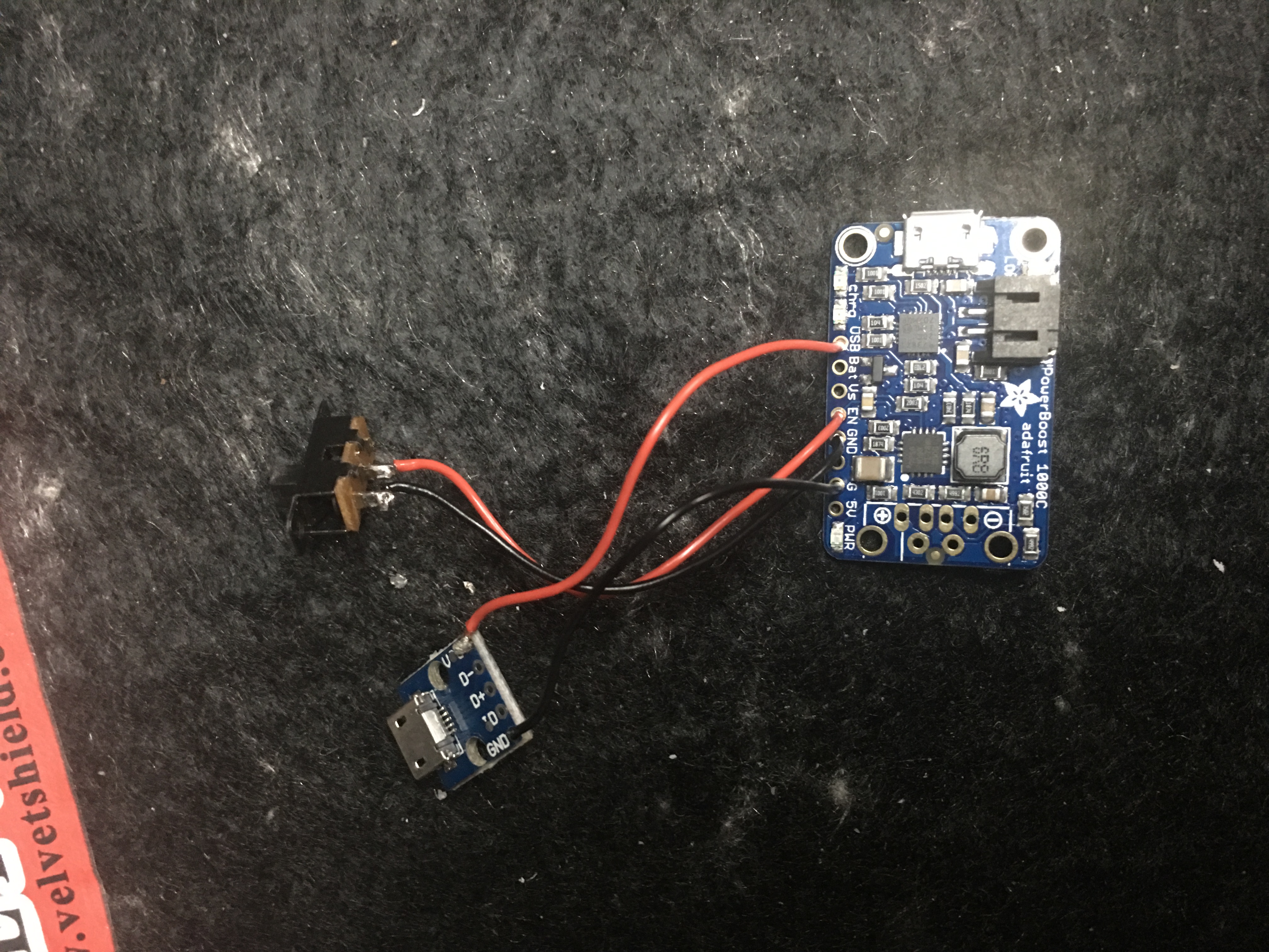

Not much of an update, but started testing out electronic components. First up is the on/off. It is a simple SPDT switch connected to the adafruit 1000c. I did the same connections as Wermy on his custom GBZ build. Circuit tested out good, so i will update next time with any news.

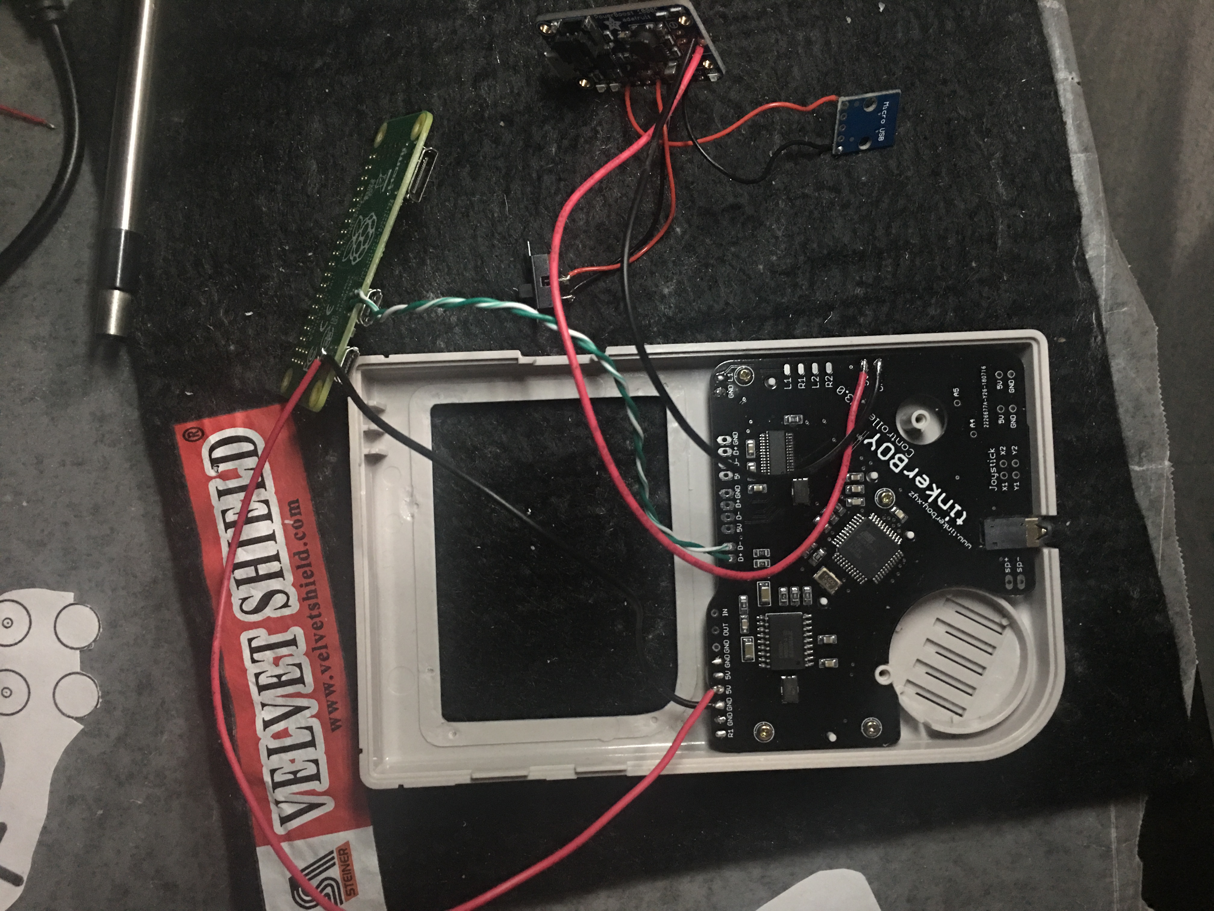

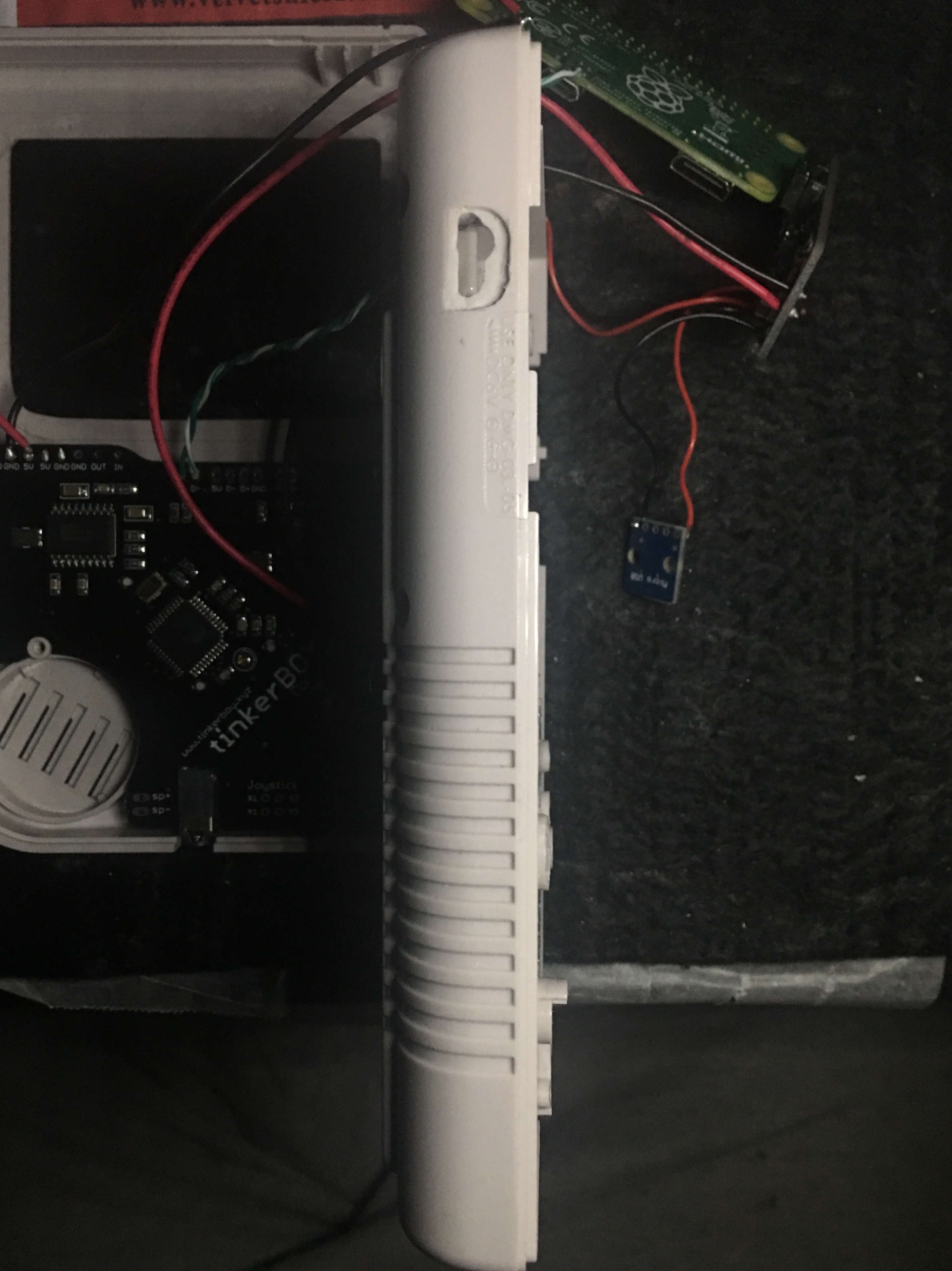

Yay! So I contacted TinkerBoy and he suggested I tried a fresh install of retropie. I did so and the Pi immediately recognized the V3 board.
Will test with ROMs at a later date.
I am thinking of painting it, because I did the hole for the microUSB charging port and it came out so ugly. I am thinking of using plastic or epoxy putty and fixing it back up.
And this is my test rig. Everyting wired up except for L1R1. I simply jumpered the pads with a small piece of wire while setting RetroPie controller.
I am waiting on the monitor to come in and I think that would be the final piece so I can start putting it all together.

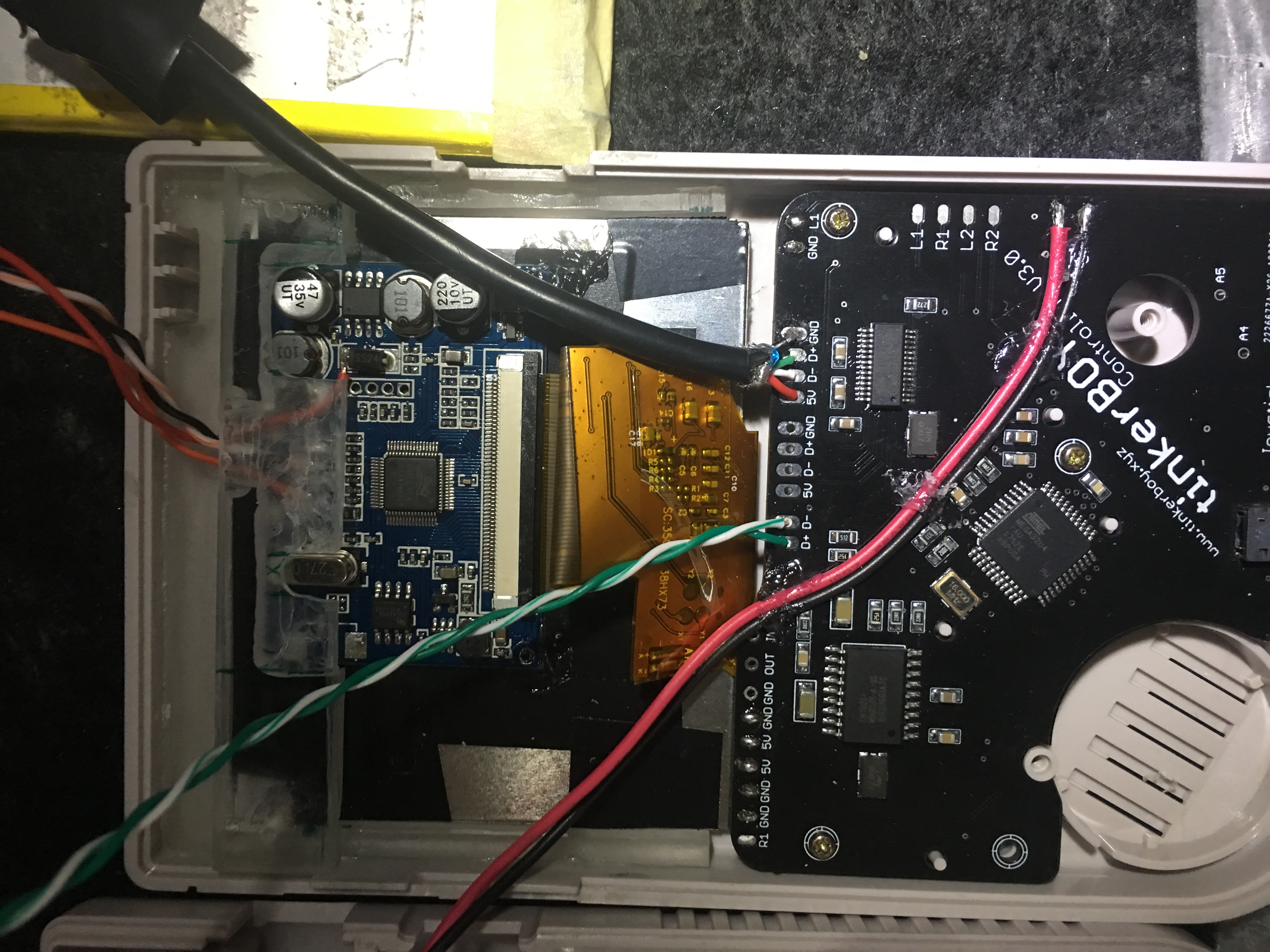

Post by Warzone1320 » Wed Sep 26, 2018 2:02 pm
Forgot to take progress pictures, but I made a bracket for the screen with acrylic and glued it down with epoxy.
The screen is only pressure fitted. Not glued down, however it took a lot of effort to make it fit without breaking it or it being too loose.
I glued down the power cables from the power boost to the controller to route them out of the way.
Was able to test out the whole system only eith batt power and was able to play without any problems.
Now all I need is to trim cables to find a way of getting the case to close...

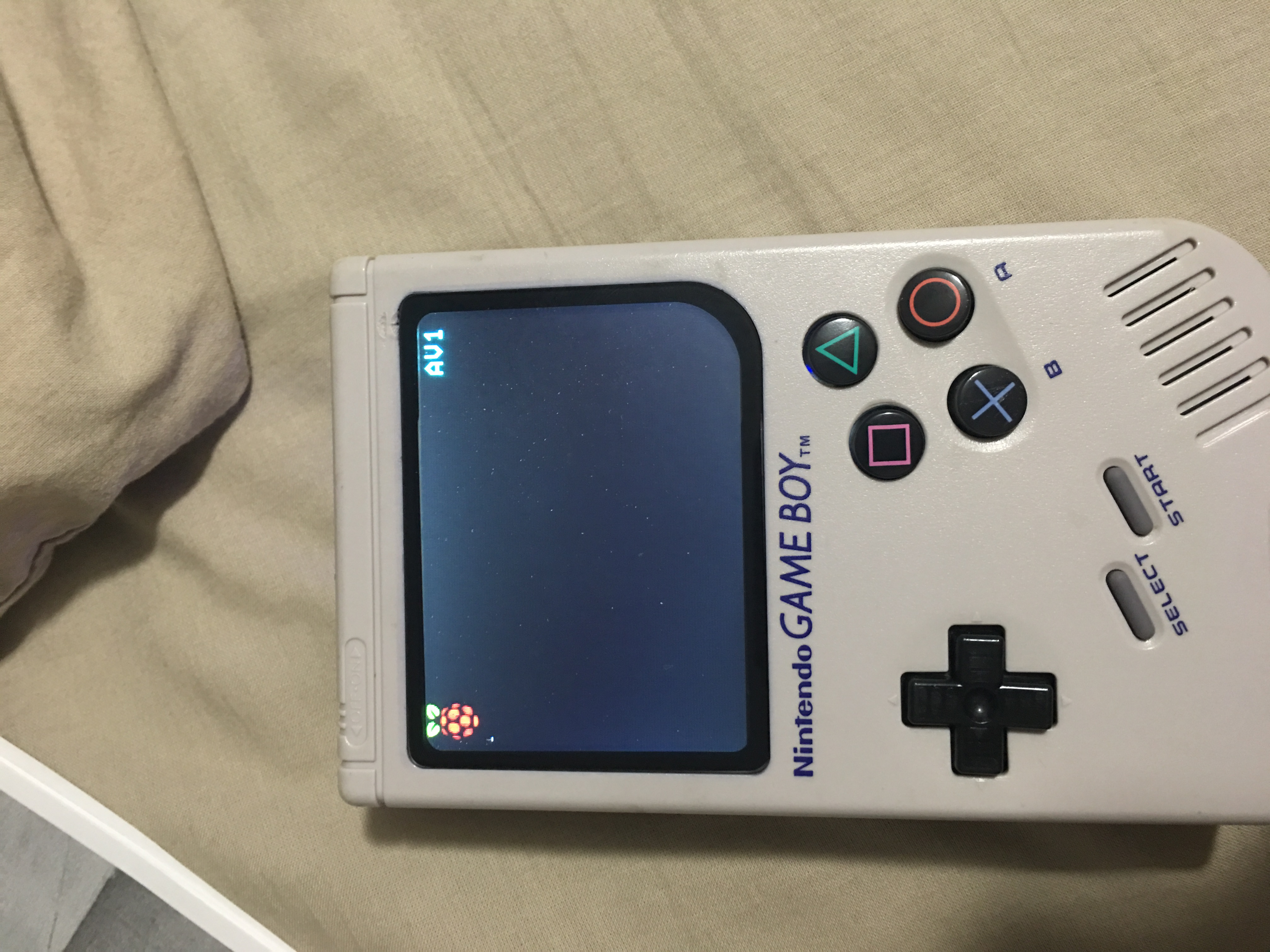

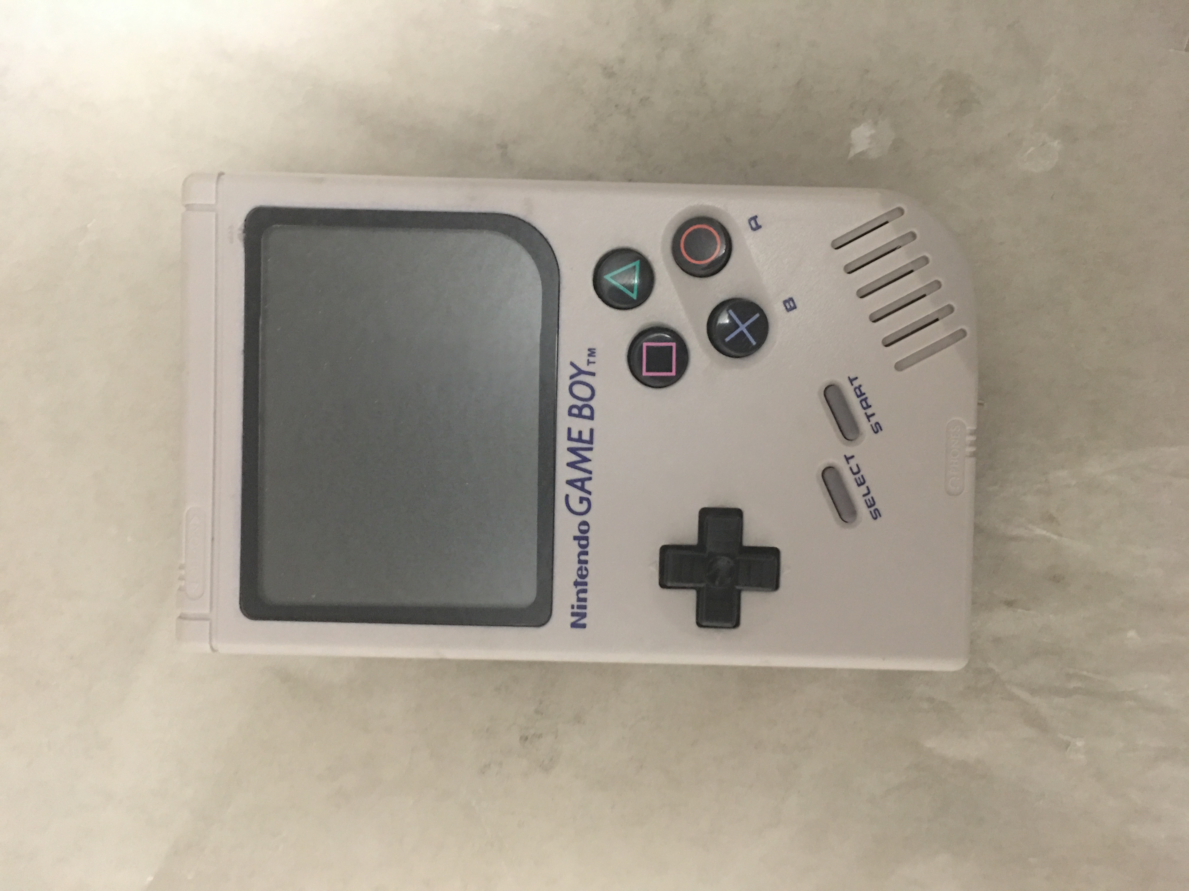

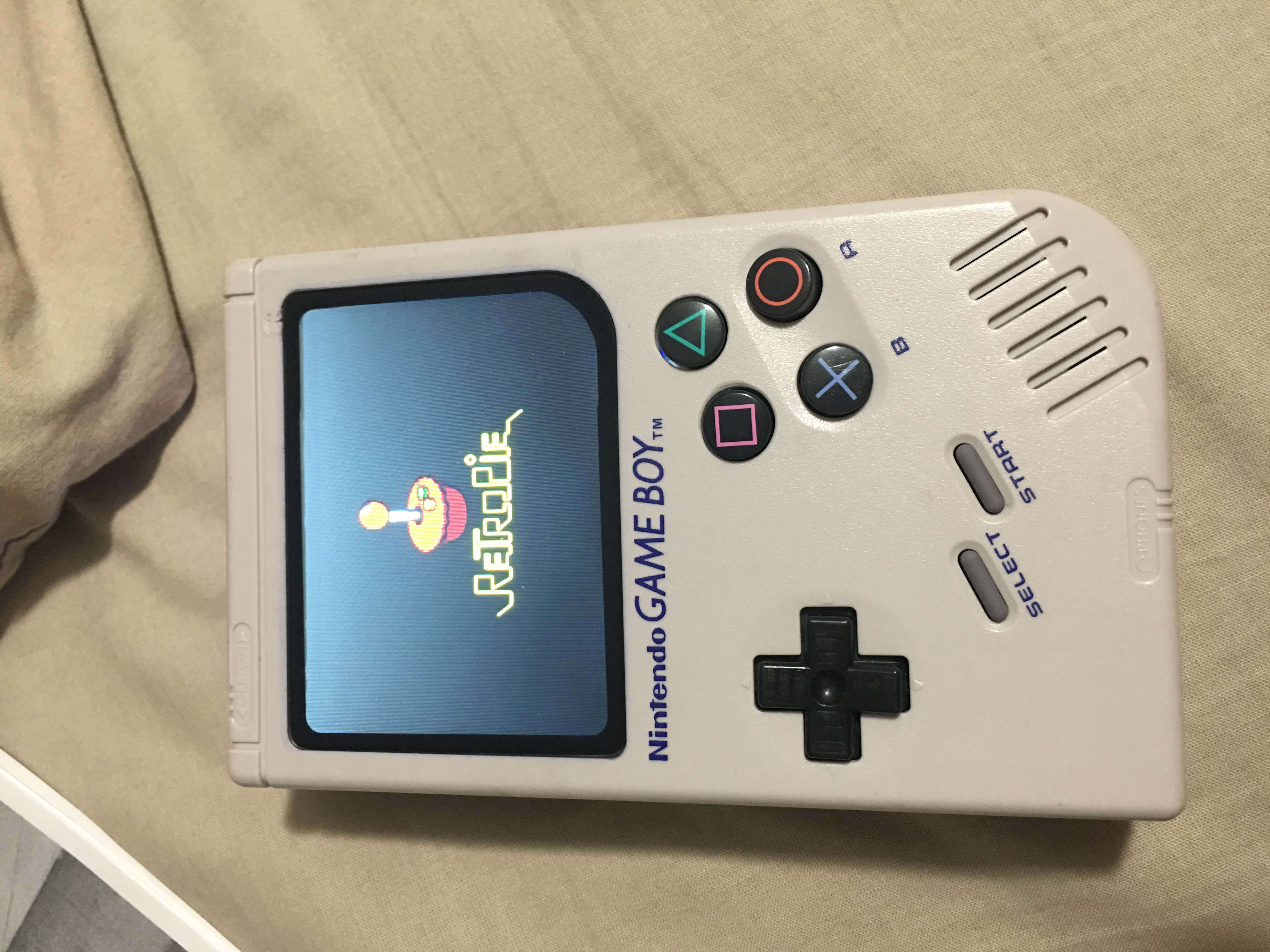

Forgot to take pictures of the finished interior...
Was able to finish it up and started playing it.

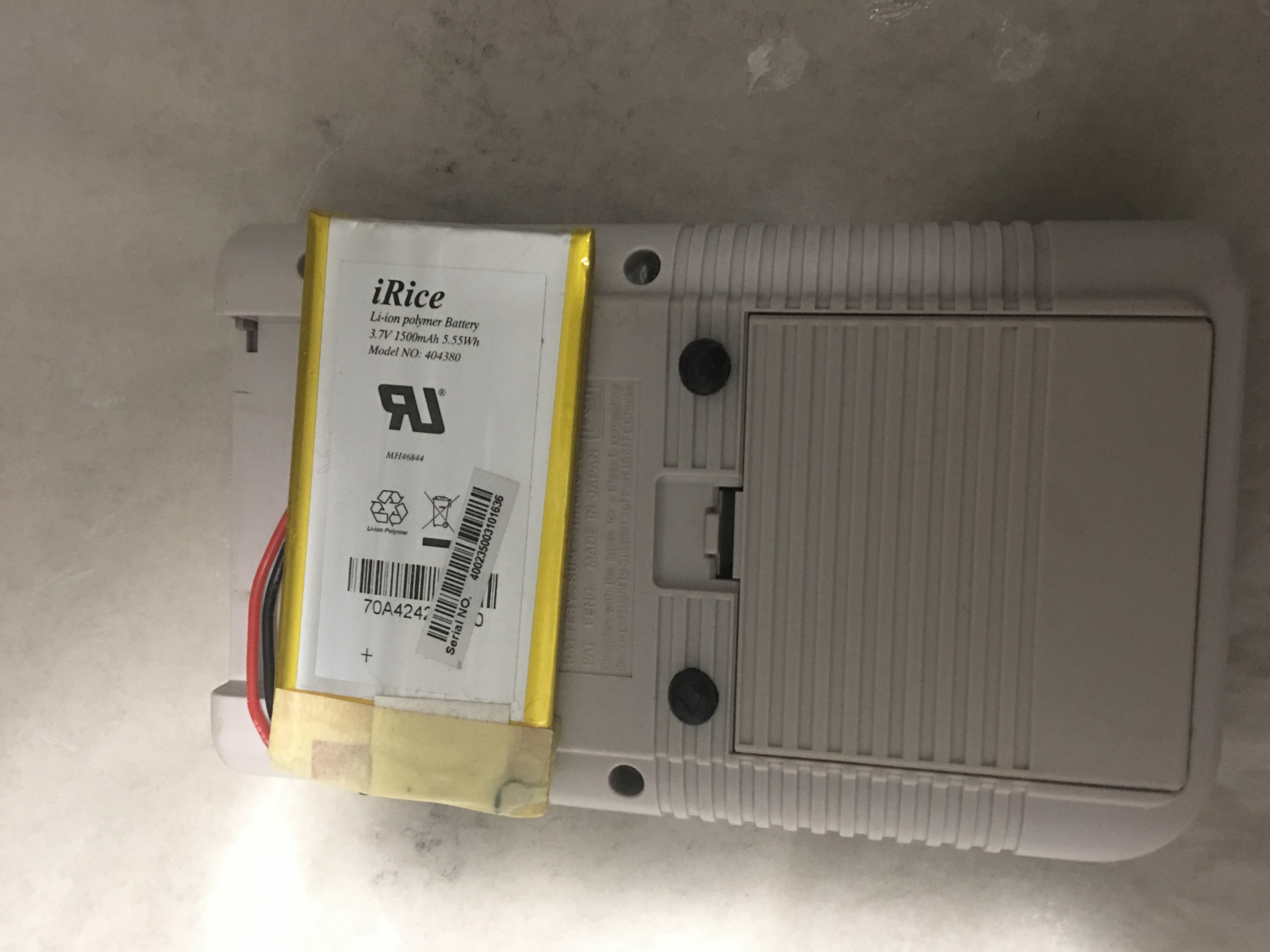

At the moment the battery is on the outside because I dont have the right size. I might get Helders battery when it is available.
I might have to go back in to trim some wires and make them fit better and add a speaker.
I also need to find out, why the R1 button is not being recognized by GBA games.

The buttons came from an old and “retired” PS3 Dualshock. I had to modify them to the right size since they are longer by a few mm. You can see in the pictures how i modified them.
