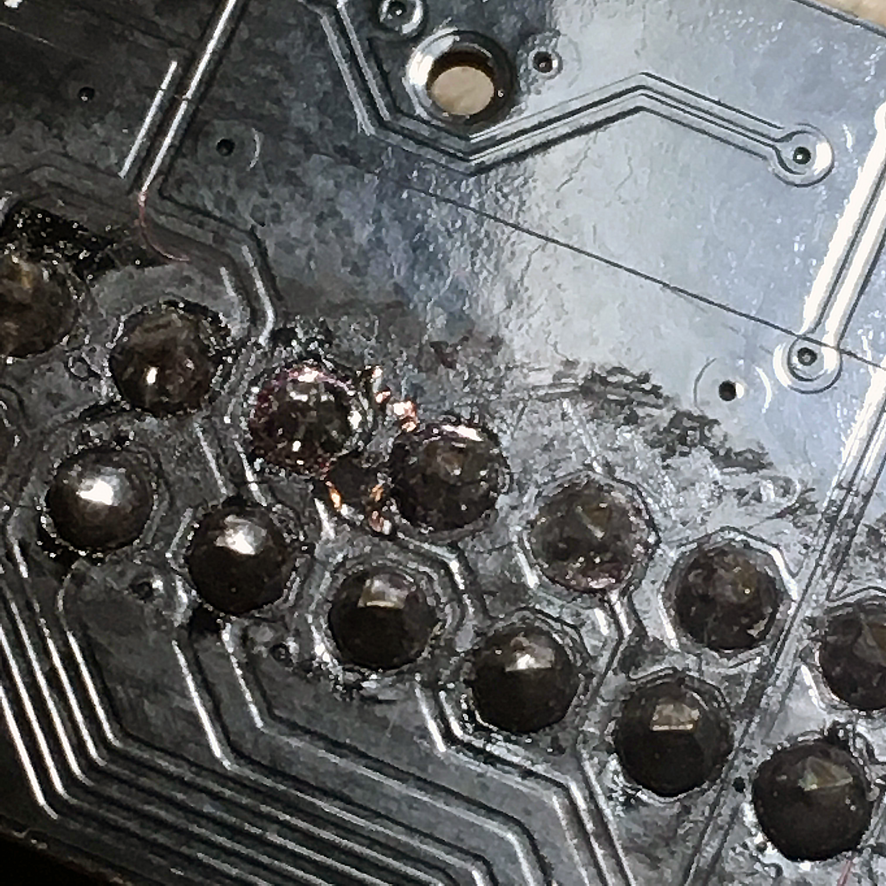

The soldering around those connections, could you get an in focus macro shot? Ideally using some kind of light to really highlight the scratches

I've tried the best I can to take a picture with the tools I've got.

I'm not Kite, but those traces do not look happy to me!

No I agree with you there! With the naked eye it didn't look that bad! :roll:
Hope it can be salvaged, i'll be a bit upset if I've ruined it.

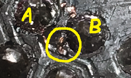

Hi, ok, so it looks like the pin with the trace is damaged.. here are some pics of the pins how they are meant to look:
NOTE: This is MIRRORED so everything is backwards!
Could you please measure with a multimeter in resistance mode the resistance between A and B (B is GND by the way)
IF there is a direct short (as in it reads 0ohm or close enough) then you need to fix up this bit OR cut that trace:
Test for a short again... now IF there is no short, you can continue!

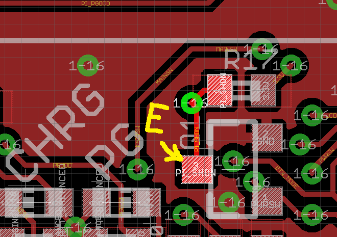

You need to solder a wire from Pin "A" (which is the one badly soldered in your picture) to this point 'E' on the other side of the board:
You can verify that everything is working as expected by making sure that:
a) there is NO short from A to B
b) there IS a short from A to E (this is MEANT to be connected)
nurgle
Posts: 11
Joined: Wed Apr 26, 2017 5:07 am
Re: CS Lite: Shuts down, kernel panic
Post by nurgle » Wed Oct 17, 2018 11:39 am
Thanks Kite so much. This has worked a treat! I'm so happy, I really thought I'd ruined it. Starts up perfectly now and safe shutdown runs when I turn the power switch off. In tester mode everything is good. Looking forward to being able to continue the build. Really appreciate the help. :D
