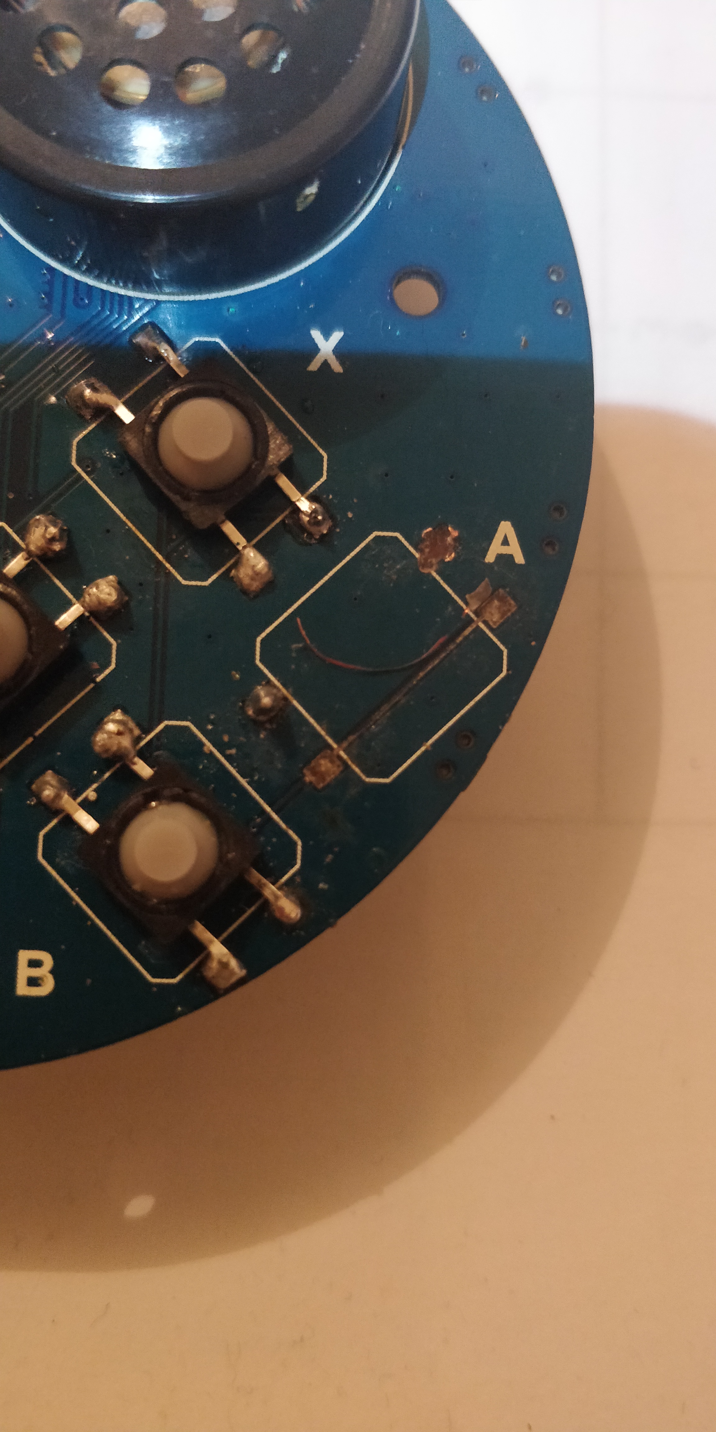

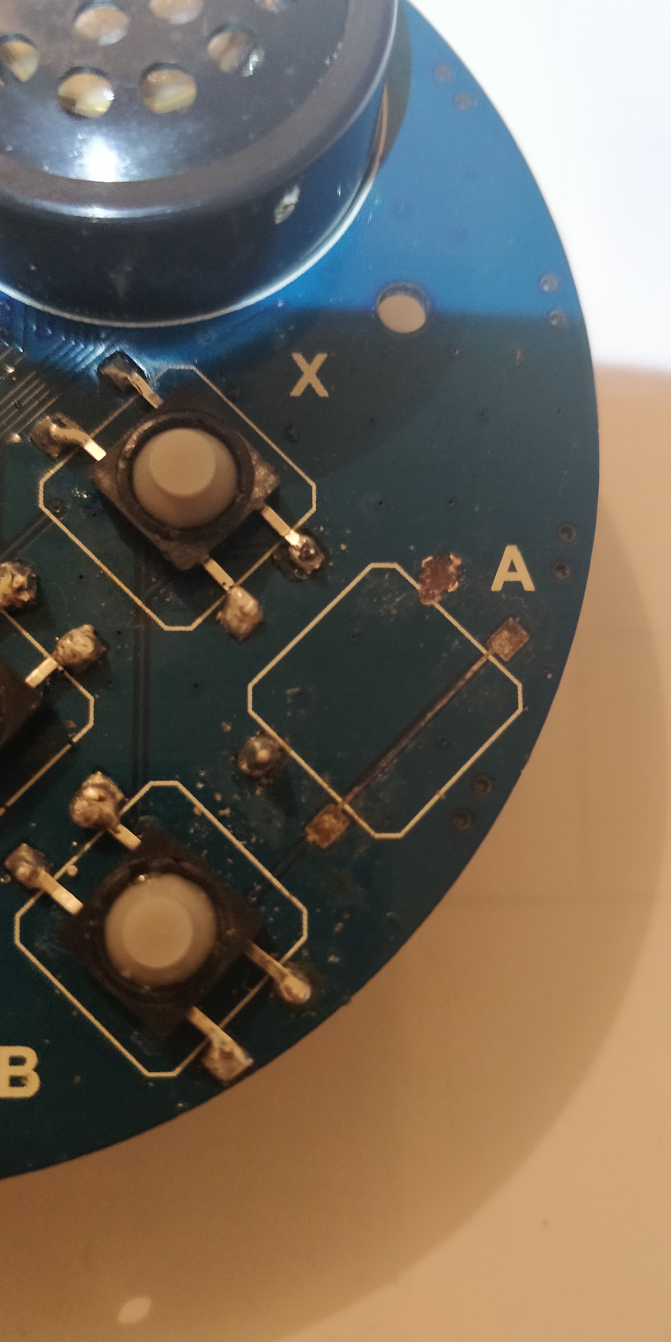

Post by tomysteria » Thu Nov 21, 2019 4:29 pm
Hello,
I bought the amazing WaveShare GameHat 3D Printable Case STL's made by HoolyHoo.
I replaced the buttons by soft silicone buttons from Adafruit but the A button doesn't work anymore.
On the second picture, we can see a fragment of copper that was ripped off when I removed the original buttons.
How did you remove these buttons ?
There was some glue under the buttons and I had to tear off with a plier even after having desoldered them.
Was it the same for you ?
Thanks
Re: Waveshare Game HAT - replace buttons and joystick
Post by Helder » Thu Nov 21, 2019 5:23 pm
Hello,
Thanks
Scrape the trace I highlighted in orange and solder to the exposed copper which I circled in red. The green is a GND point so just one pin is fine and don't worry about the right side that is missing pads but be sure to scrape the trace as I said above.

Post by tomysteria » Fri Nov 22, 2019 10:49 am
Hello everyone! Thank you Helder. I followed your advice and it works now! :)
