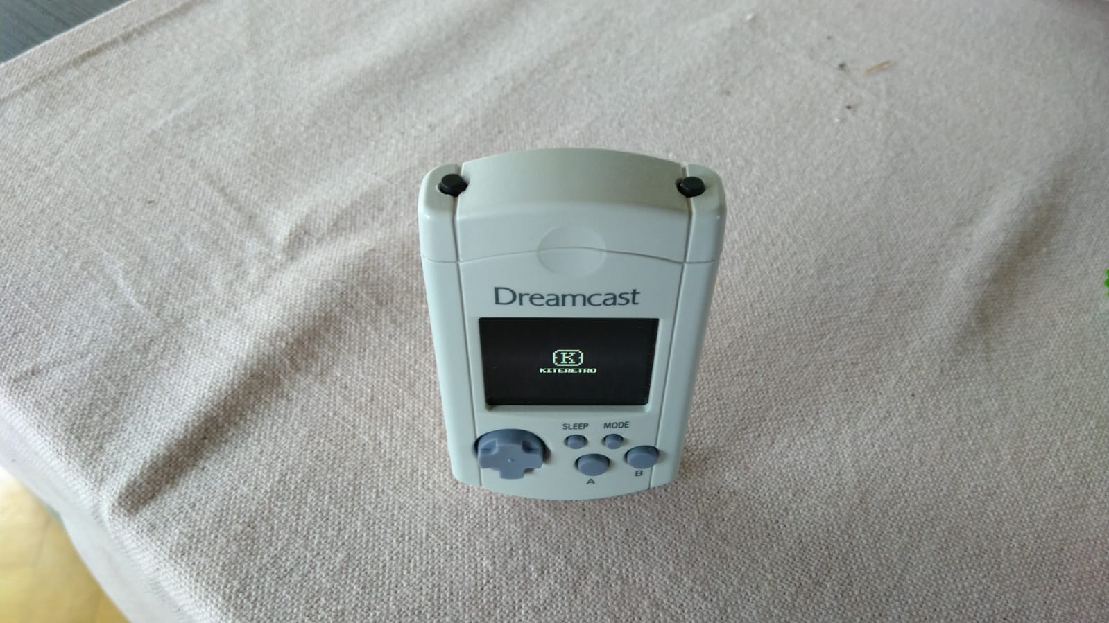

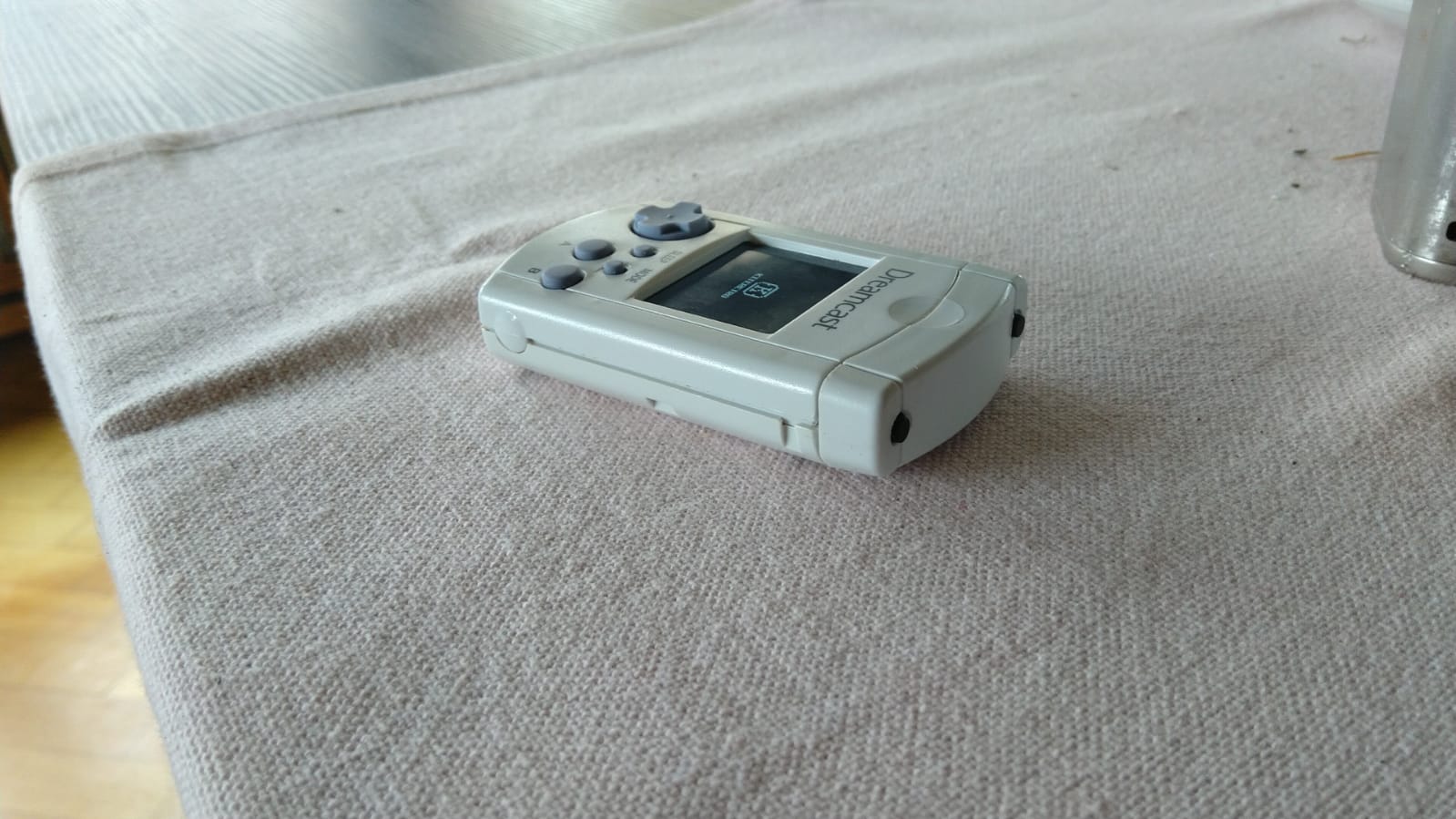

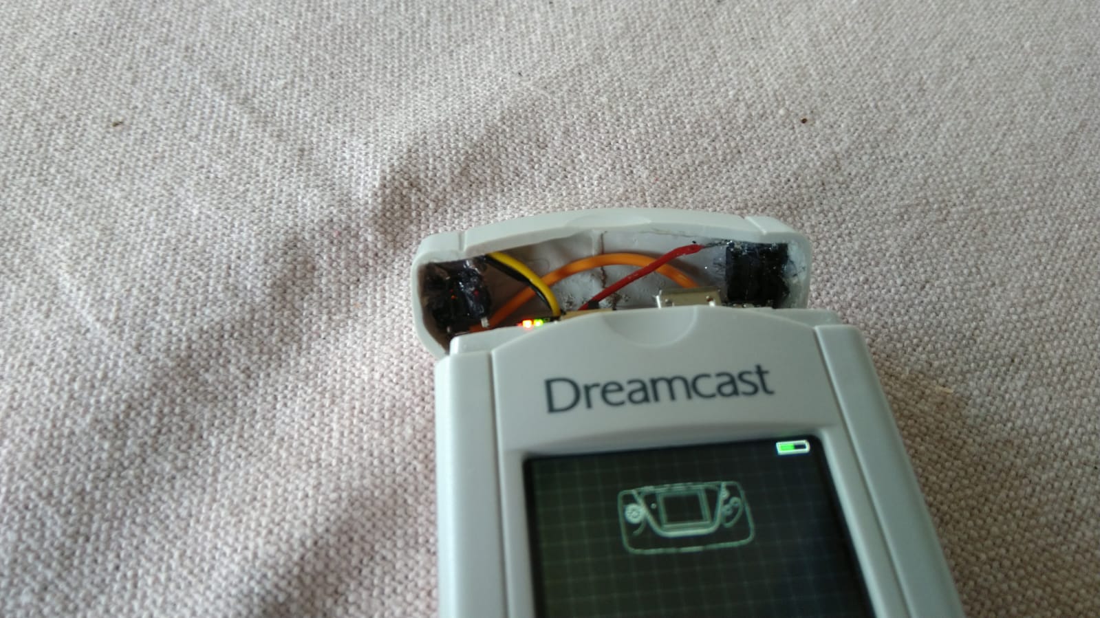

Added the L/R buttons!
I like them in the lid, easy to reach and feels nice. There wasnt any room in the case anyway with the 800mah battery.
It was a veeery tight fit, I scaped a bit of the gem so it fits inbetween the switches.
Shot 1Show
Shot 2Show
Inside the lidShow
As a bonus I now have a security line to not lose the lid :)
