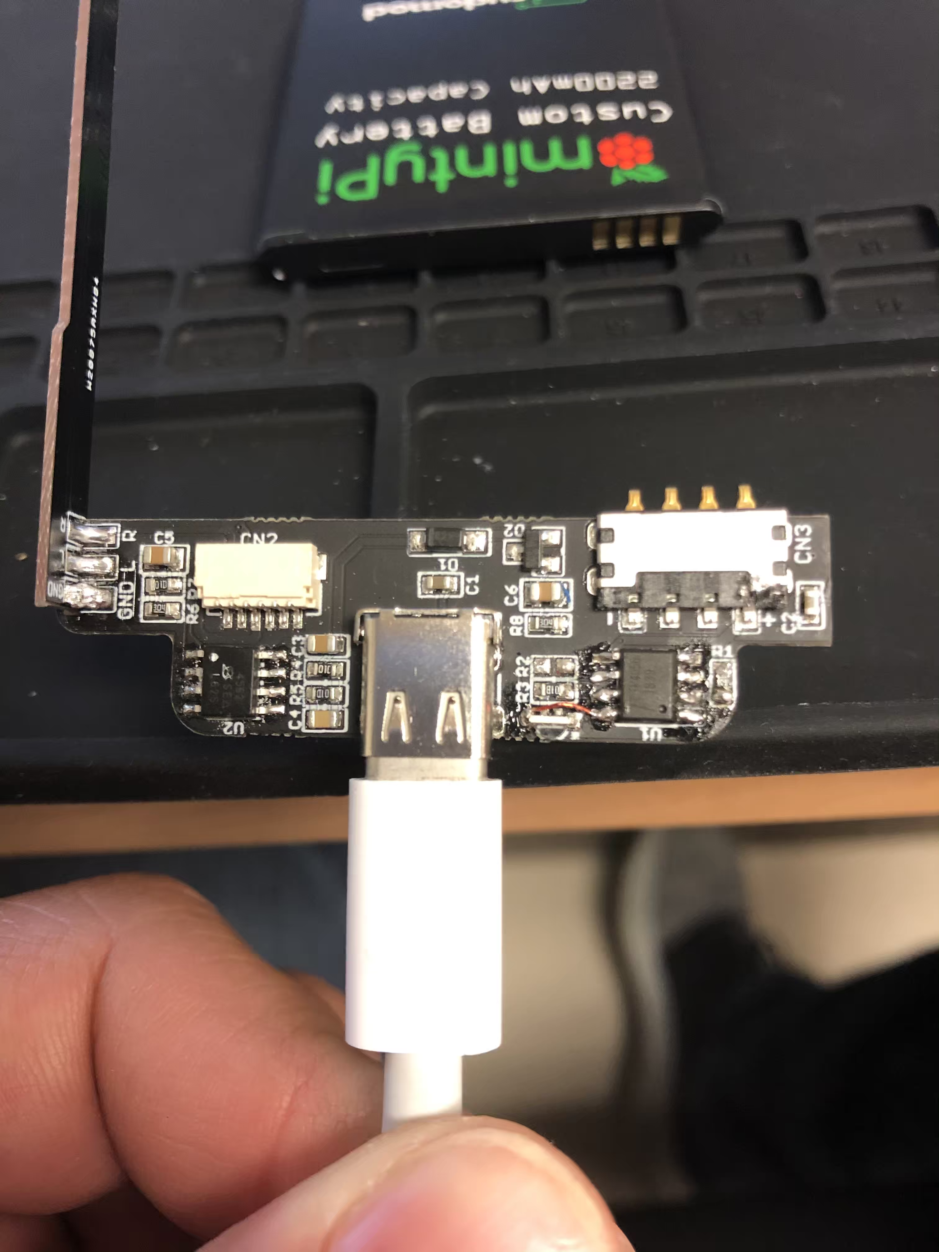

I try my best to reflow and the other suggestions, but still did not work. Do you have any more suggestions? How do I test the USB port?LilTrublMakr wrote: ↑Thu Apr 11, 2019 8:18 pmReverse the cables when you do the continuity testing for a true test. The LED comes on because the multimeter is essentially powering it.
R2 on the power board looks bridged to me also. Clear that and try moving the wire (between the LED and U1 chip) up from the pins a little and see what happens. I also had this problem and I reflowed the LED, R1, and U1 and it started working again.
thanks

In Helder's post a couple back, he has an image where you can see if there is power coming from the USB connector.
I generally use the outside of the USB connector itself as ground as it is the easiest place to put the black multimeter prong and keep it grounded. You want to test the purple "USB 5V" pins while plugged in and powered.

I did that but I get not get voltage reading from the pins.LilTrublMakr wrote: ↑Fri Apr 12, 2019 6:03 pmIn Helder's post a couple back, he has an image where you can see if there is power coming from the USB connector.
Thanks

Try reflowing these 4 tiny holes on the back of that board. I would not add extra solder unless you cover the nearby holes with something like kapton tape to prevent bridging. The inner 2 of the 4 are the 5v (red circles) and the outer 2 (black circles) along with the 4 big ones are ground
My next guess after that is that the TP4056 chip might have gotten fried.
Is the CN3 connector right next to C2 just flux or is that damaged?

LilTrublMakr wrote: ↑Fri Apr 12, 2019 6:47 pmTry reflowing these 4 tiny holes on the back of that board. I would not add extra solder unless you cover the nearby holes with something like kapton tape to prevent bridging. The inner 2 of the 4 are the 5v (red circles) and the outer 2 (black circles) along with the 4 big ones are ground
thanks
