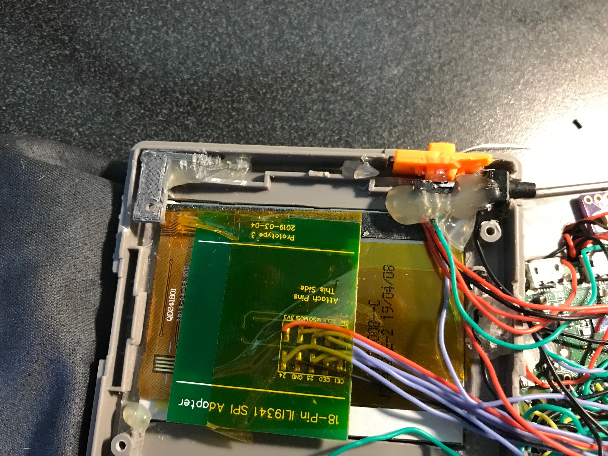

On the SPI adapter, you can actually ignore the two pads on the right edge (CE1 and GND). They're not connected to the screen. I've got another version in testing that uses CE1 for fbcp-ili9341 (it's an alternative to fbcp which is supposed to improve the refresh rate, however from what I've read is a bit too demanding for the Zero's single core, but would be good for Pi 3). So anyway you can just remove those two wires, since you only need the 8 on the left instead of 10. That'll save a tiny bit of space and reduce complexity.

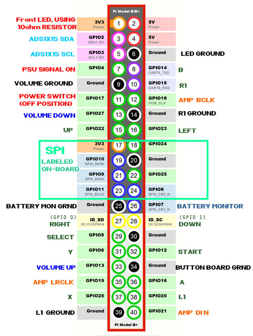

awesome! - i was wandering about that, because i thought it seemed like the one input wasn't being used. i think that means i can add a battery monitor button in there after all then! (so much for reducing complexityDividion wrote: ↑Sat May 25, 2019 5:15 pmOn the SPI adapter, you can actually ignore the two pads on the right edge (CE1 and GND). They're not connected to the screen. I've got another version in testing that uses CE1 for fbcp-ili9341 (it's an alternative to fbcp which is supposed to improve the refresh rate, however from what I've read is a bit too demanding for the Zero's single core, but would be good for Pi 3). So anyway you can just remove those two wires, since you only need the 8 on the left instead of 10. That'll save a tiny bit of space and reduce complexity.

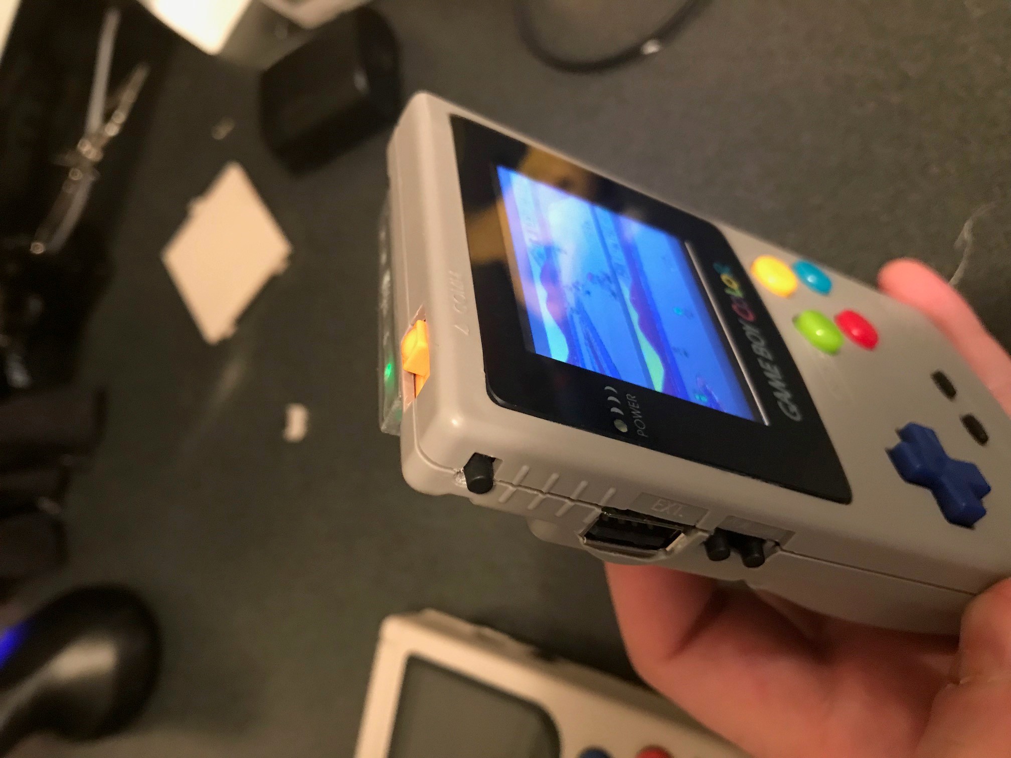

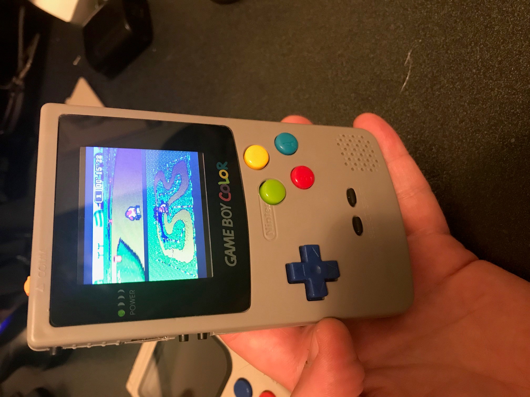

I also swapped the screen guard for a glass one, pre-printed with the standard logo, and added in the battery monitor button. While I was in there, I ended up disconnecting the front LED, since the activity onboard LED was almost in that spot already from the Pi, I just stuck an unconnected LED there, which allows the activity one to display through the original hole, making it actually useful instead of just another power indicator (especially on boot-up prior to the screen driver starting up where you can see it working to boot):

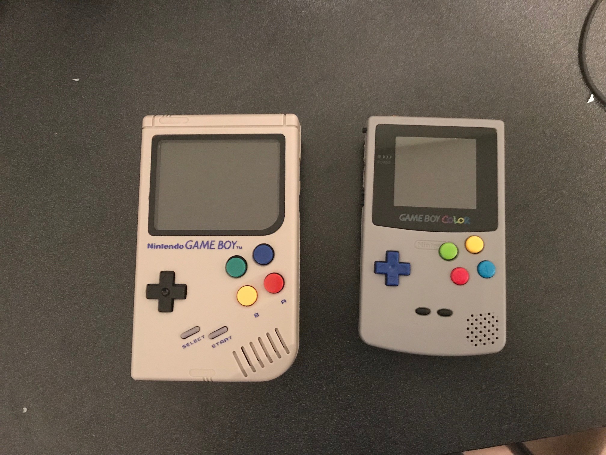

here's a size comparison to a GBZ:
a couple more pics:
