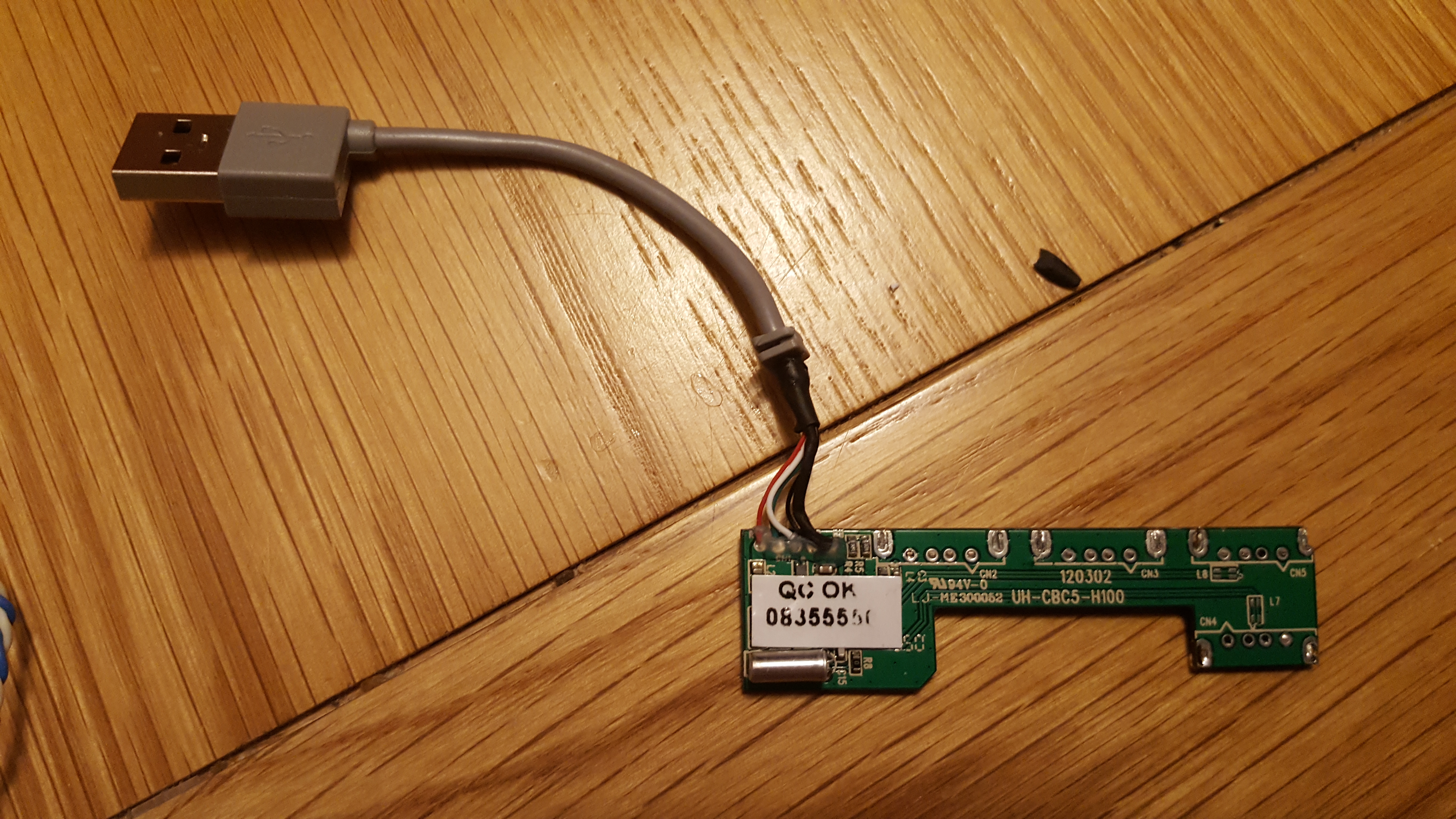

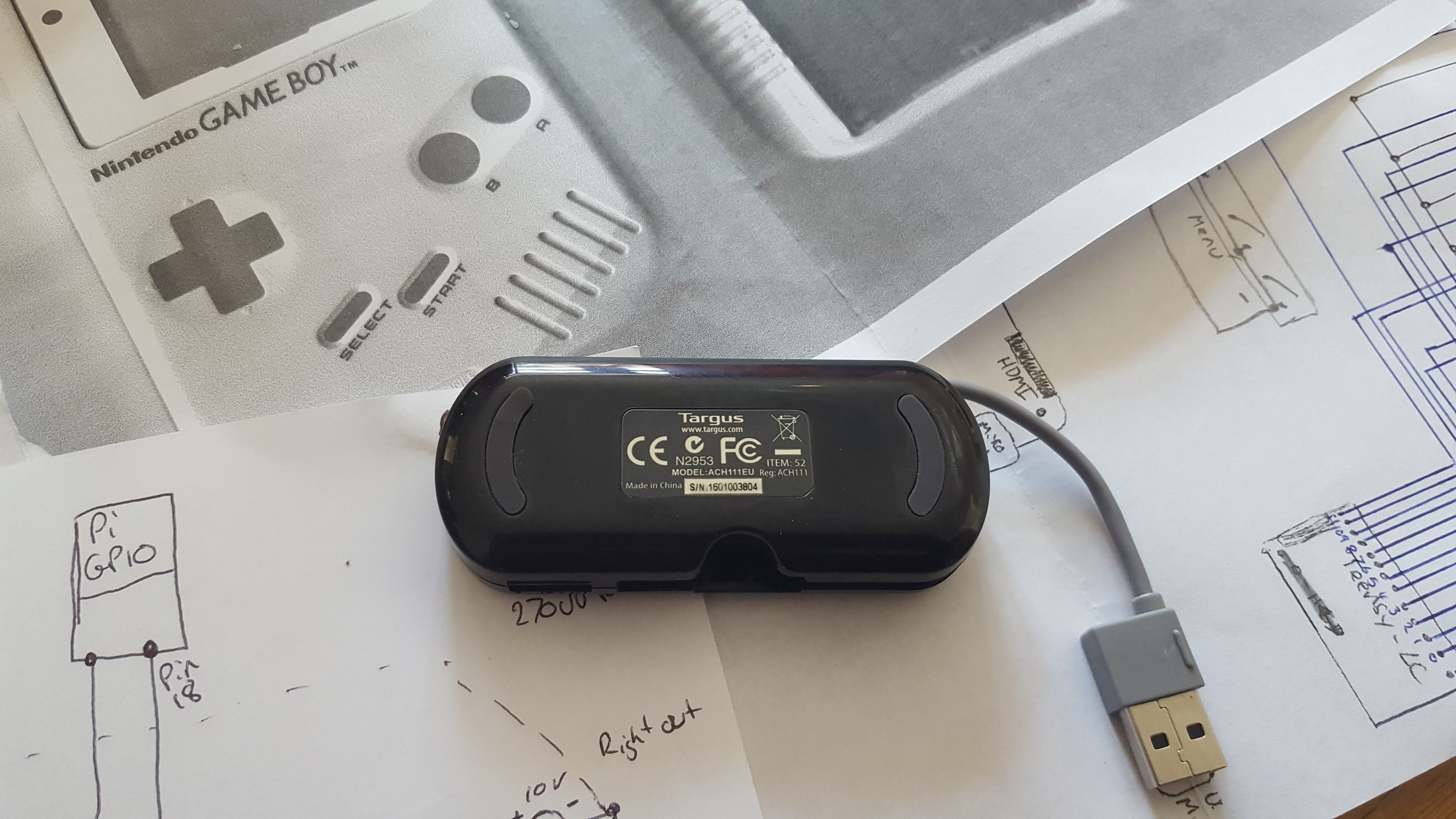

Just posting this as ive had trouble with usb hubs and found this one, targus ach111eu 4 way usb works fine I've plug in teensy controller. ps3 controller and key board all working fine together :lol: :lol: :lol:

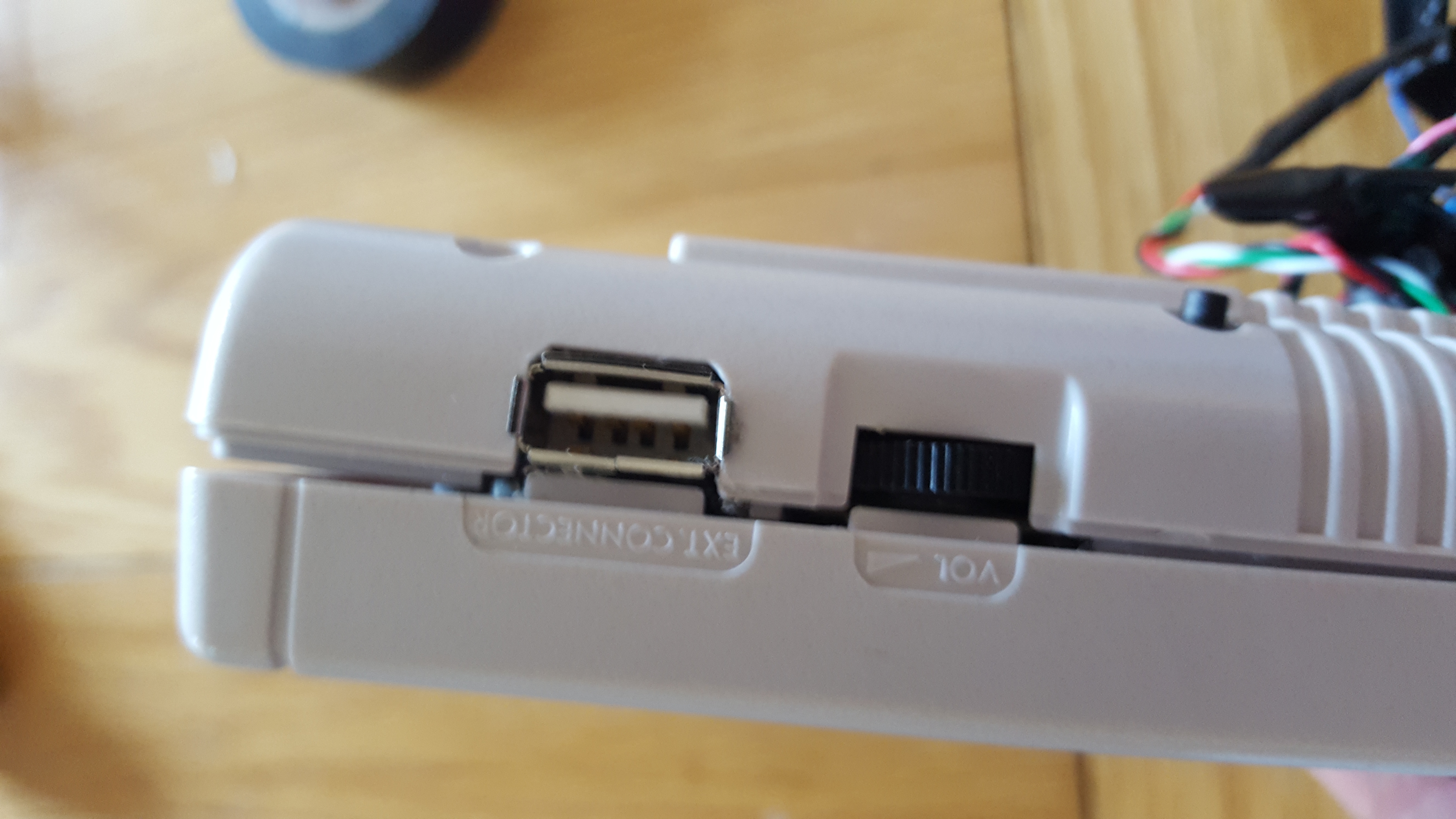

Usb hub slimmed down

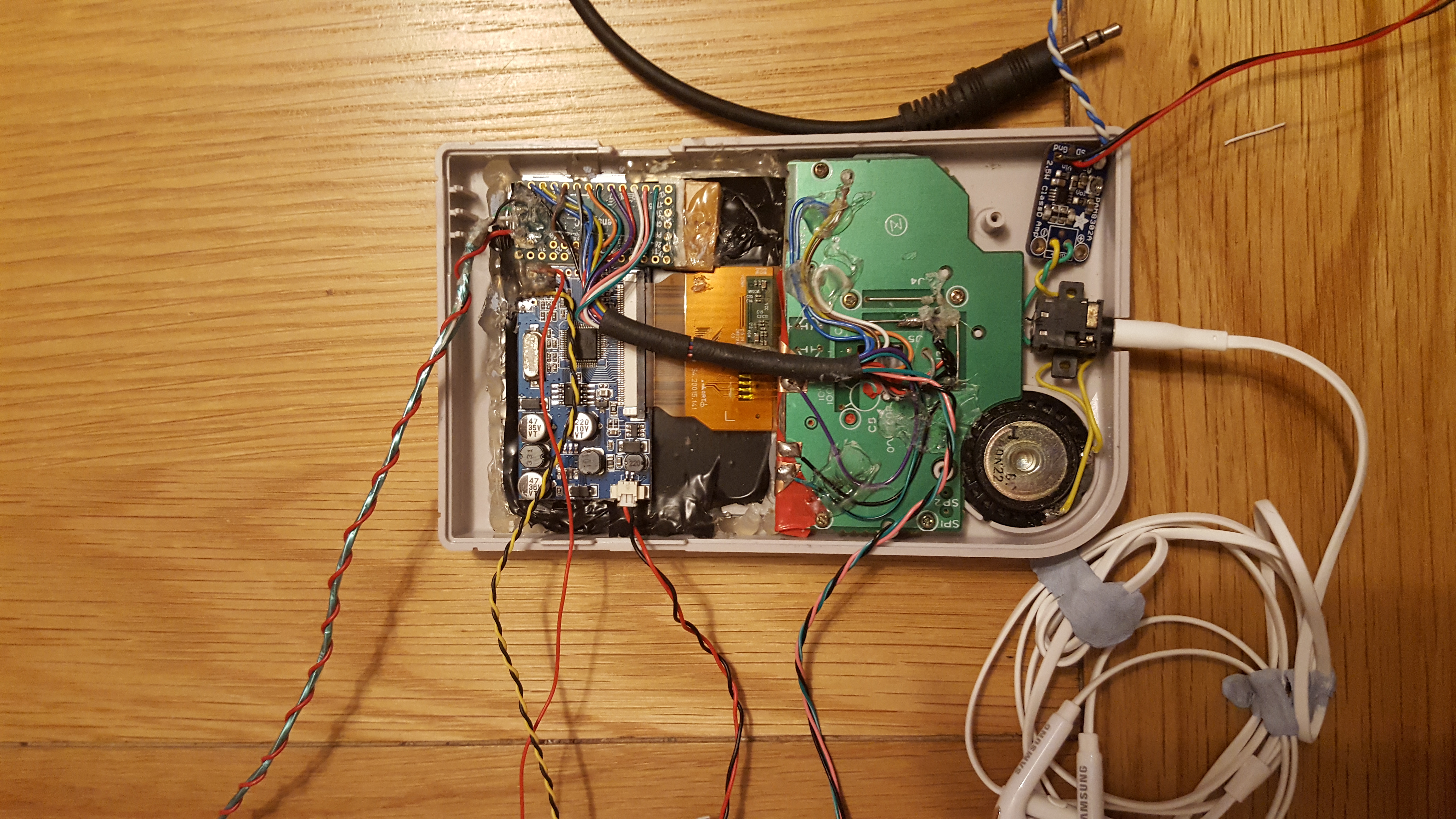

I had a go at my audio all been tested and working just got a few things to think over.
My head phones cut out the speaker fine but the volume though them are alot louder then the original GB speaker which was quite low.
Theres a small amount of fuzz coming through but I've not done the filter circuit yet which will help lol.
I am thinking of replacing the speaker due to its the original and the replacement will make it sound better and louder hopefully lol :mrgreen:

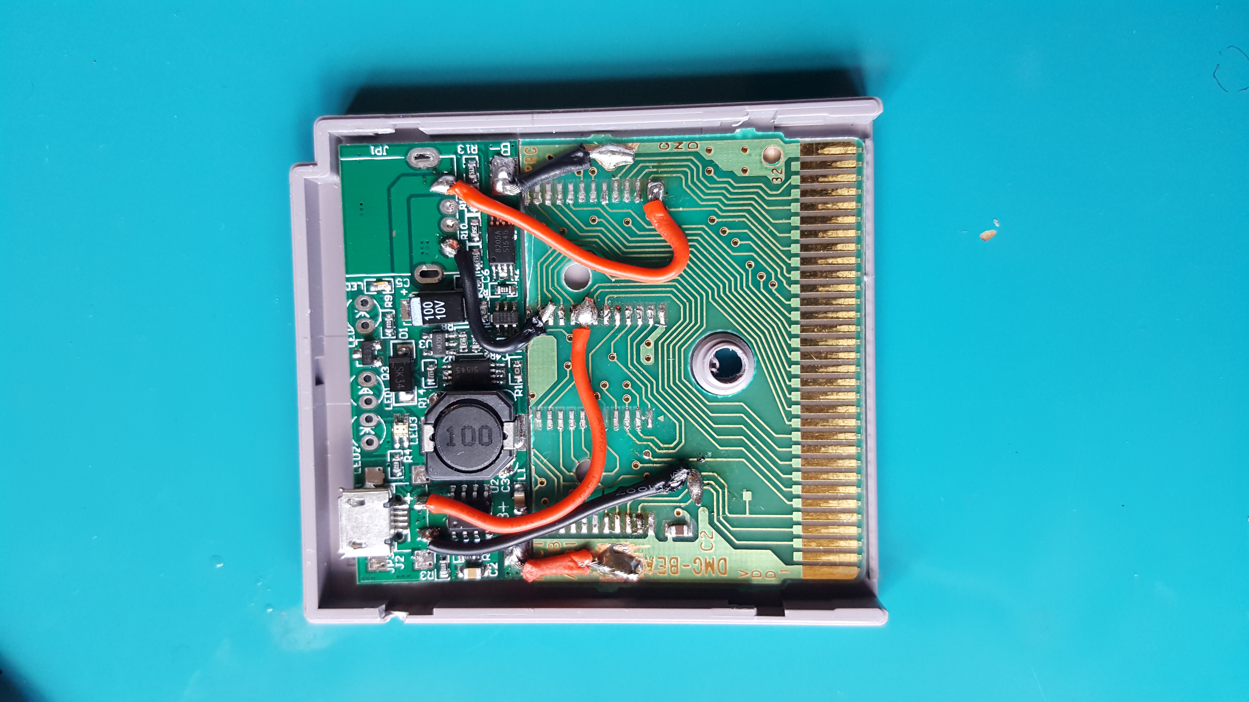

Because I'm not using the powerboost 1000c I'm using the one from banggoods I thought about putting it in the game cartridge.
So if the cartridge is removed gbz not work at all plus bit of a safety feature due to it the power circuit once removed it disconnects everything even the battery it self.

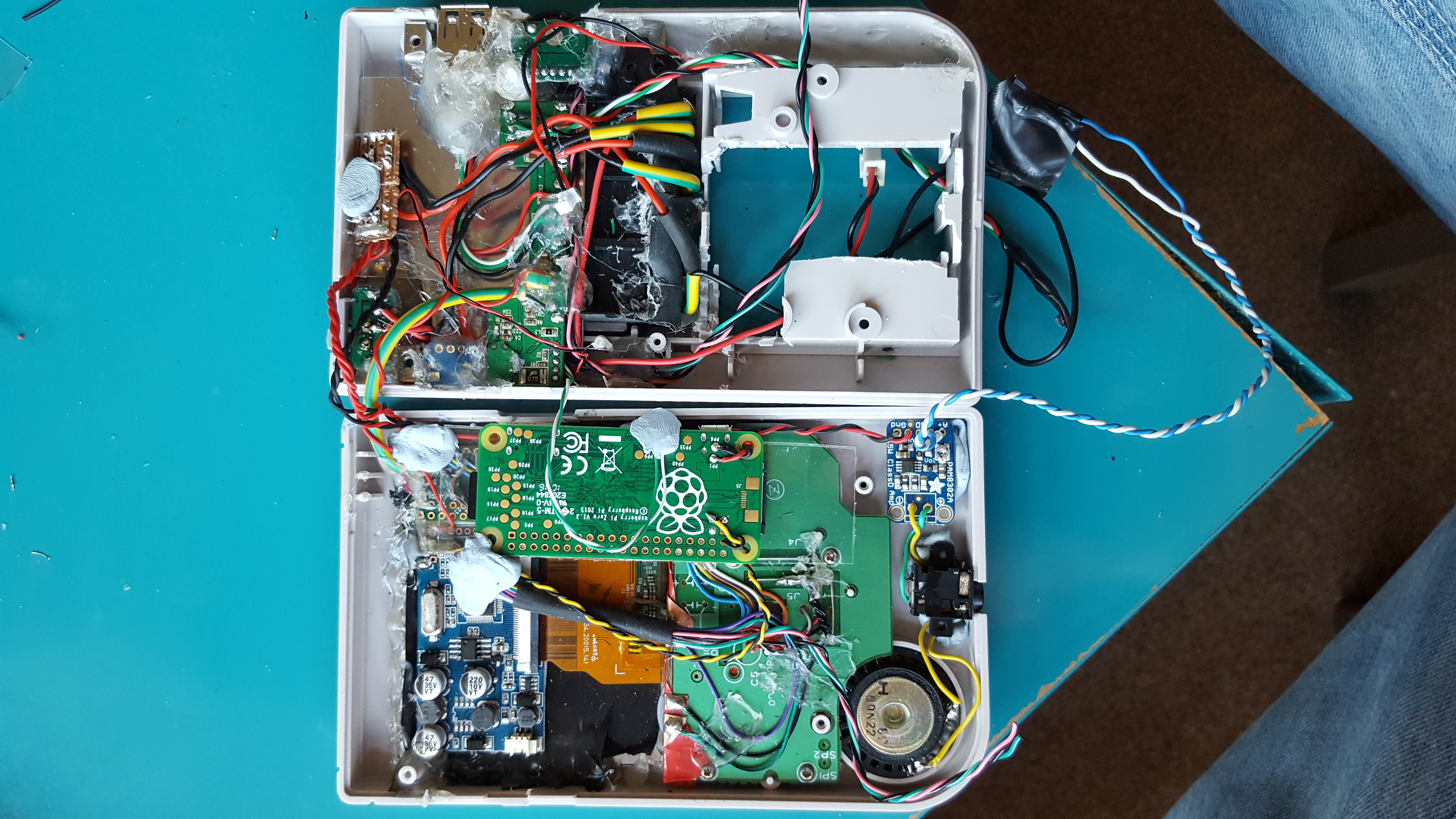

Mock up where parts are going to be inside still could all change lol

I like what you've done with the cartridge. I originally thought there may be an issue with the traces being too thin, but I see you've doubled them up.

I'm so close to finishing it's doing my head in lol.
I'm still waiting for my new battery to come plus I got to sort out a small gap on the case it dose all close but it pushers the teensy down which disables the controls so I got to make the room :lol: :lol:

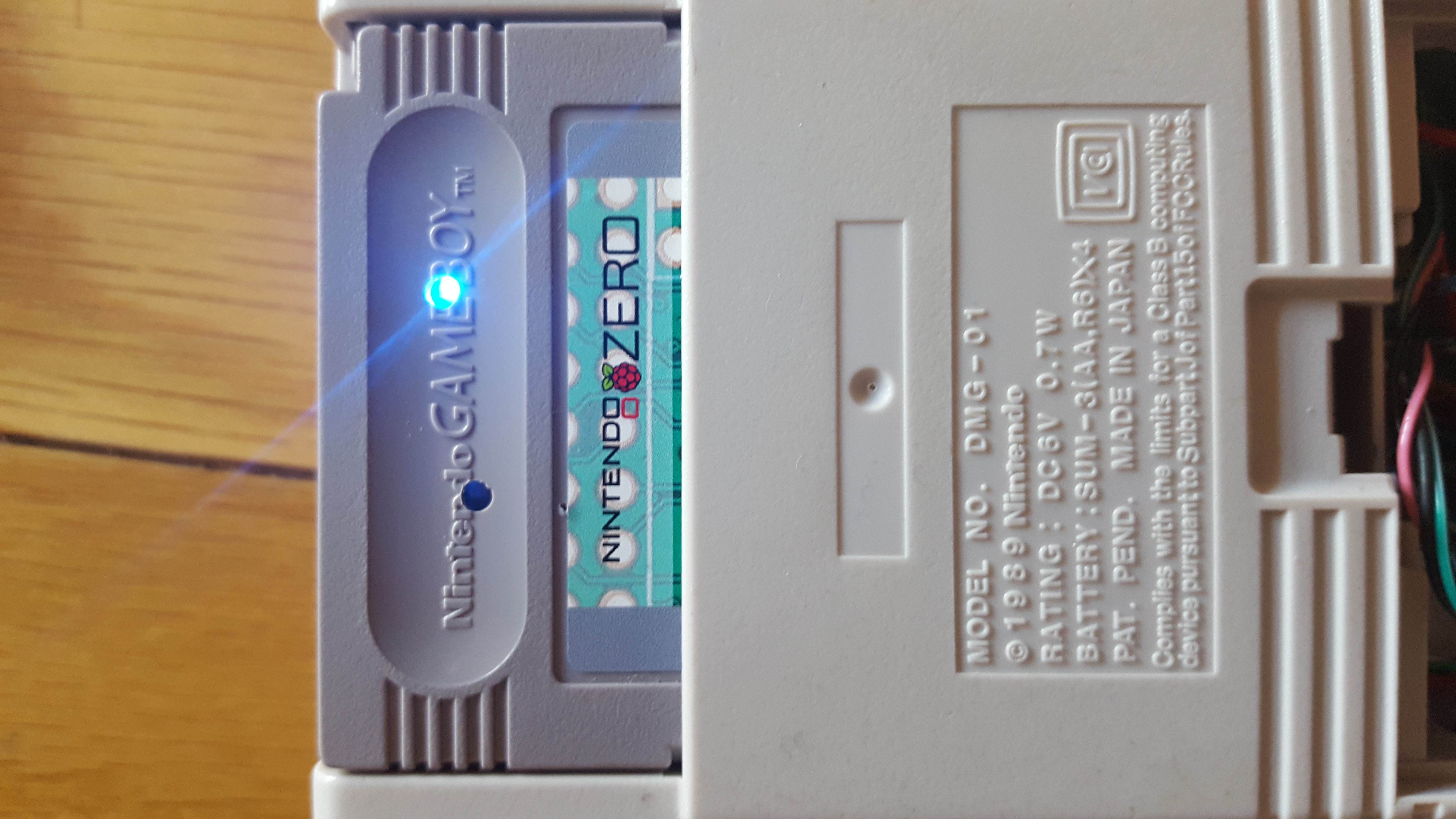

Red light charging while playing
Working with my test battery

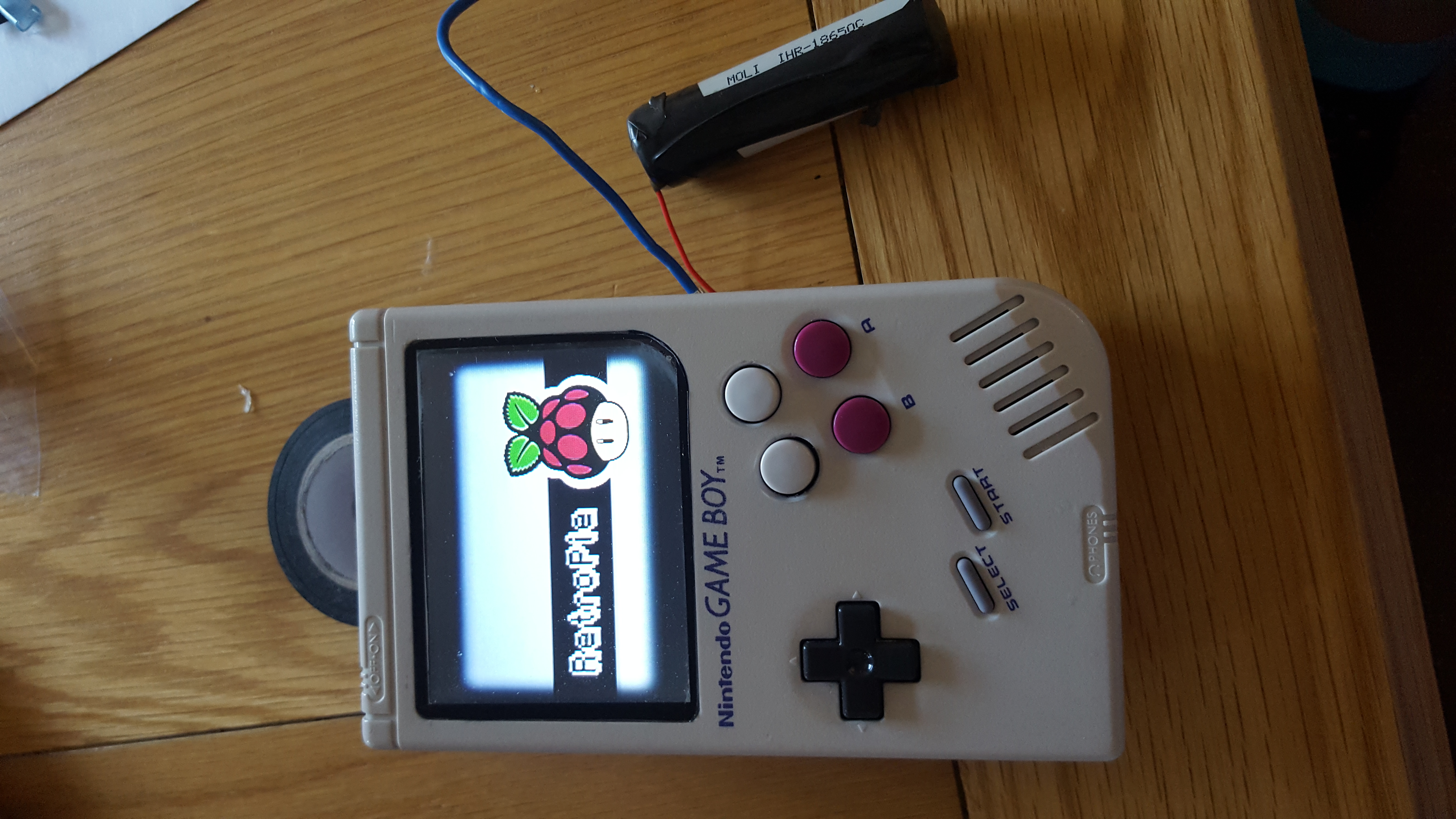

Post by Psy128 » Sat Aug 27, 2016 4:24 pm

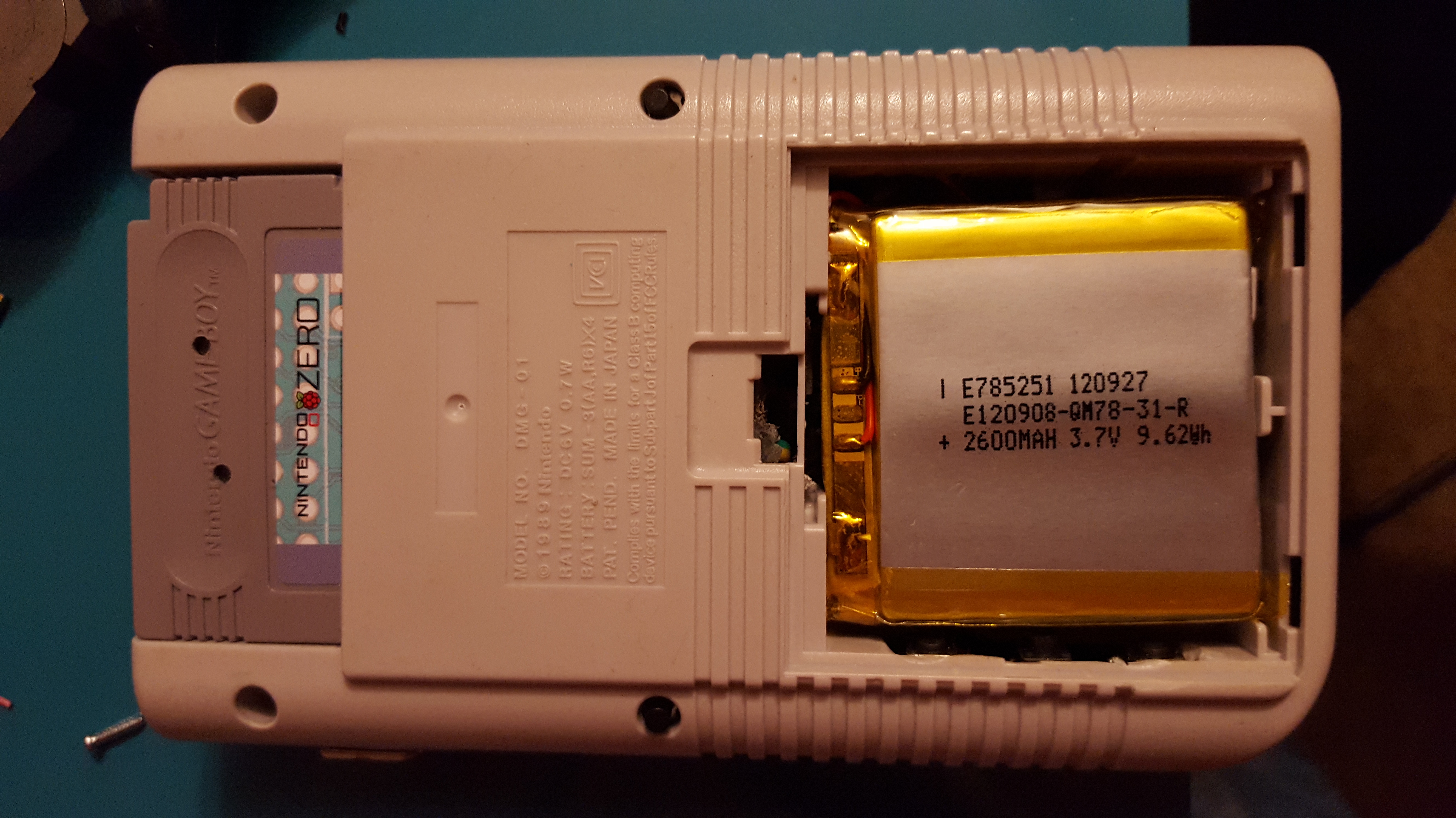

It's been a while now but I've got my new battery so now it's all finished.
It works pritty well I'm happy with all the work I've put into it.
I would like to do it again (will do lol)
Due to all the little mistakes that you know how to get around the second time round lol
Plus I would like to thank everyone who uses this forum even if you didn't help me with this project direct but added your own views and experience with other people for me read through it all helps lol :mrgreen: :mrgreen:
New battery perfect fit

Post by alien0matic » Sun Aug 28, 2016 4:53 am
Wow, that is a perfect fit. Do you have a link to that battery?
