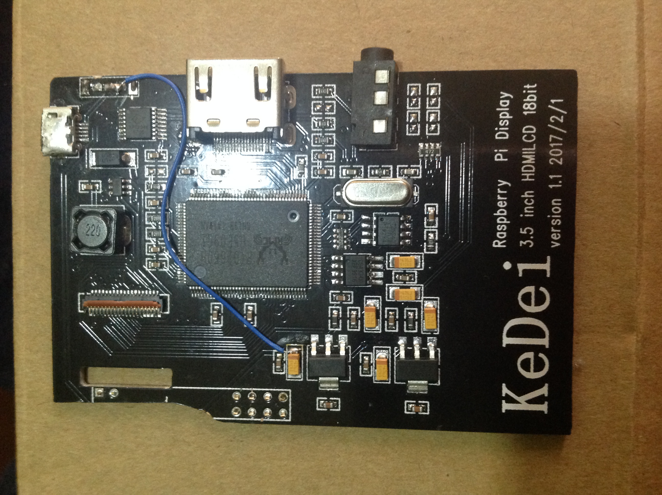

The 480x320 kedei hdmi screen is noticeably clearer and detailed(especially on text) though compared to the 320x240 lcd in DPI mode. Obviously because of the higher resolution and HDMI?. But it LAGS while the dpi screen is smooth. I prefer the dpi screen. Just imagine a 640x240 screen on dpi mode. It will surely blow the hdmi screen out. :)
I was actually almost finished with my kedei hdmi build and was very excited but while i was trimming the board edges it slipped and broke the ribbon cable. 🙁So stupid of me. I just ordered another one and have to wait another 30 days. I have an extra hdmi screen with menu controls but has different dimensions and contruction.

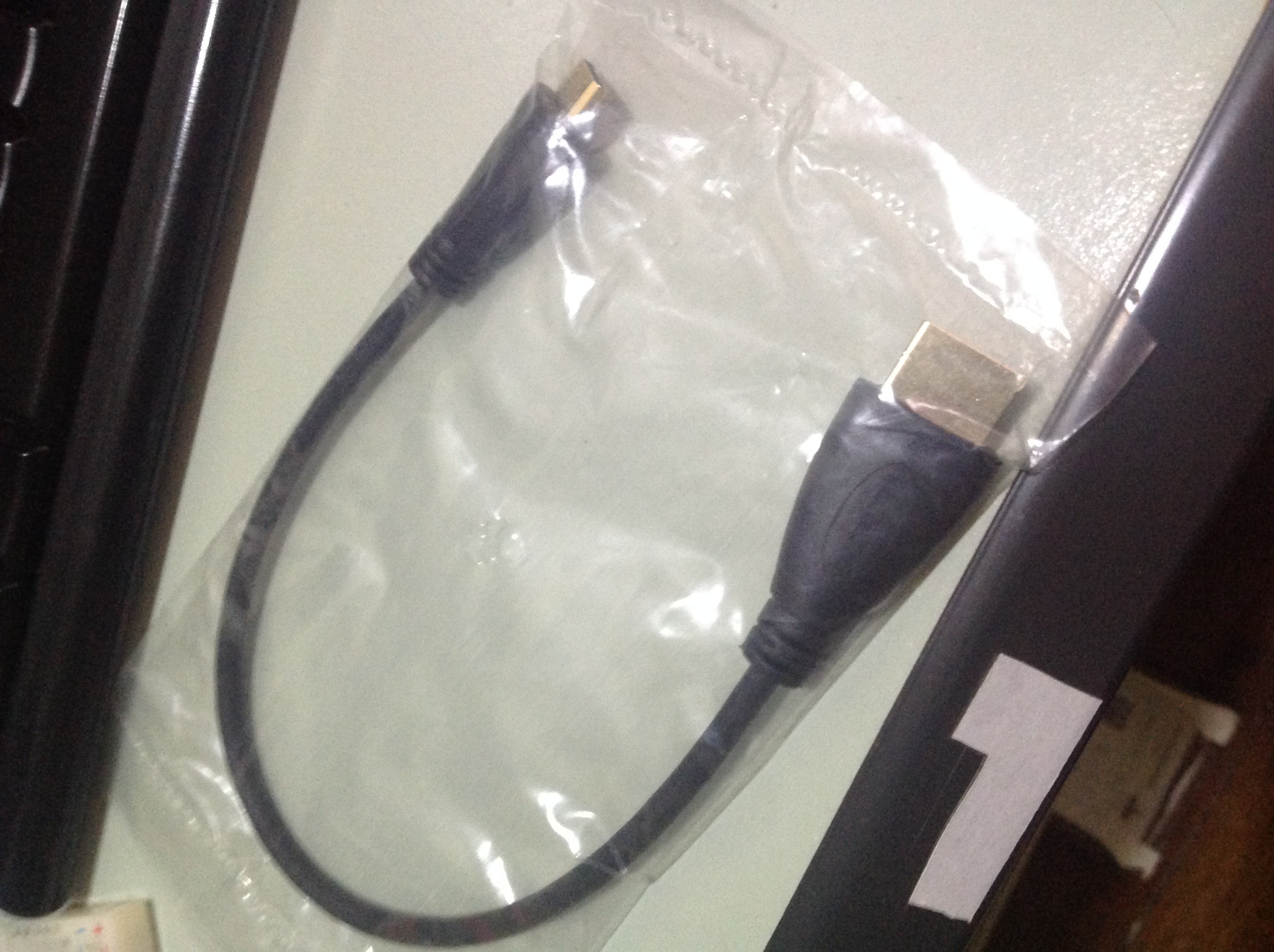

I'm using a short hdmi cable i bought on aliexpress. Very cheap. I hope that's the reason for the lag. I have stripped the cable and found that it's only using 15 wires but i doubt its what causing it to lag? But using the same cable on my hdmi monitor is perfectly fine.
I've tested only on playing nes, snes and gba games.
I'm curious to know why yours doesn't lag while mine does. I think we are using the same kedei screen like this?
the 15 wires isnt the issue, the adapter i had made doesnt use all the connections either (that had to be done for it to fit on a small pcb)
i've also tried a similar cable, and didnt experience any lag....
also why have you got a jumper from the switch....
i've just got it wired up from the switch (positive) to powerstrip (usb for negative)

I have the same lag before or after any modification. The 5v input on this board is directly connected to the sofware side of the board which turns on automatically when you connect a power. Backlight side of the board is with a switch to power on. Since i trimmed the board near the ribbon where the connection to the soft side of the board somehow i need to reconnect it to the 5v line.
My hdmi settings:
hdmi_group=2
hdmi_mode=1
hdmi_mode=87
hdmi_cvt=480 320 60 6 0 0 0
Sorry for the offtopic.
