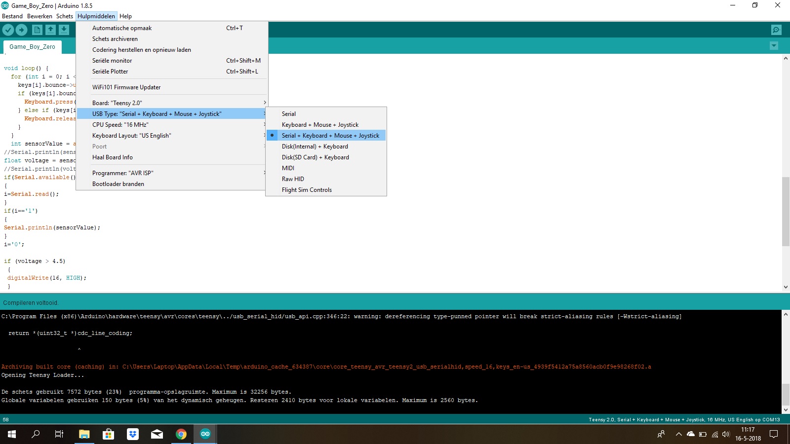

A couple of things you have to do before compiling and loading the sketch on your teensy:
The analog input is set to pin 21 on your teensy, change that if you wan't to use an other (analog) input.
The ledpin is set to pin 20 (so you have the two pins for battery monitoring close to each other) but you can change that also to your liking.
You also can edit the input (buttons) pins to your setup that's in the "void setupKeys()" part, every number after "keys[0] = key("letter", "number")" is the pin you want to assign to a button (do NOT edit the number between the two []).
You can find a keyboard/retropie listing here https://github.com/RetroPie/RetroPie-Se ... ontrollers
And one more other thing, set up your board like this:
(the screenshot is the dutch version of the ide but i thing you will get it)
Its important to do this or you will (again) get a lot of annoying errors (and you've had enough of those).
Now your sketch should compile and upload without any errors!

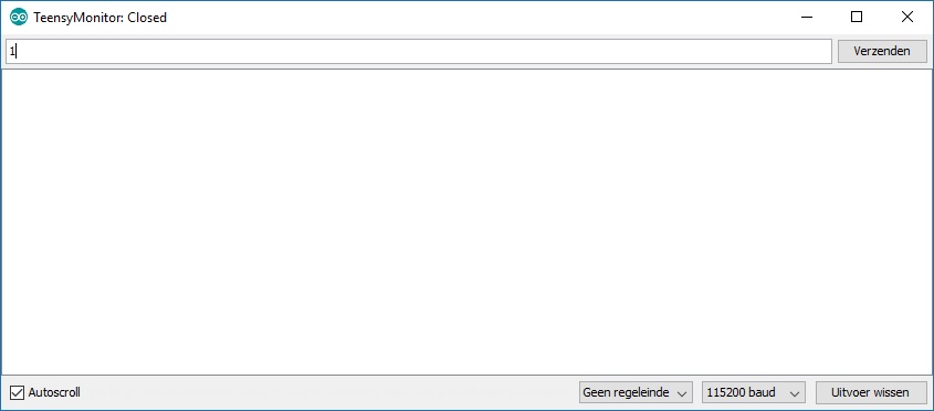

Oh if you're impatient (i would) you can test the battery monitor on your pc as well.
Connect the teensy to your pc, and start the arduino ide.
Start the serial monitor (the litte magnifying glass icon on the right side).
Check if the baudrate is set to 115200 (right side screen bottom).
Then in the input box (small top of the screen) type 1 and push the send button.
If everything is ok you should get a response from your teensy in the message screen (random number because there is nothing connected to pin 21 yet).

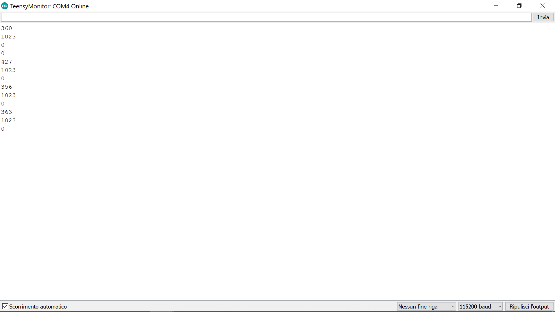

JackReacher
Posts: 14
Joined: Fri May 11, 2018 12:49 am
Location: Rome, Italy
Re: OSD Battery Monitoring for Helder's AIO Boards
Post by JackReacher » Wed May 16, 2018 11:56 am
allright
tested it and these are the results...
in order
not connected 3xx
vcc 1023
gnd 0
do you think is working?
I think it is!!!! :shock: :shock:
can't wait to hook up everything!!!
man, thank you!
