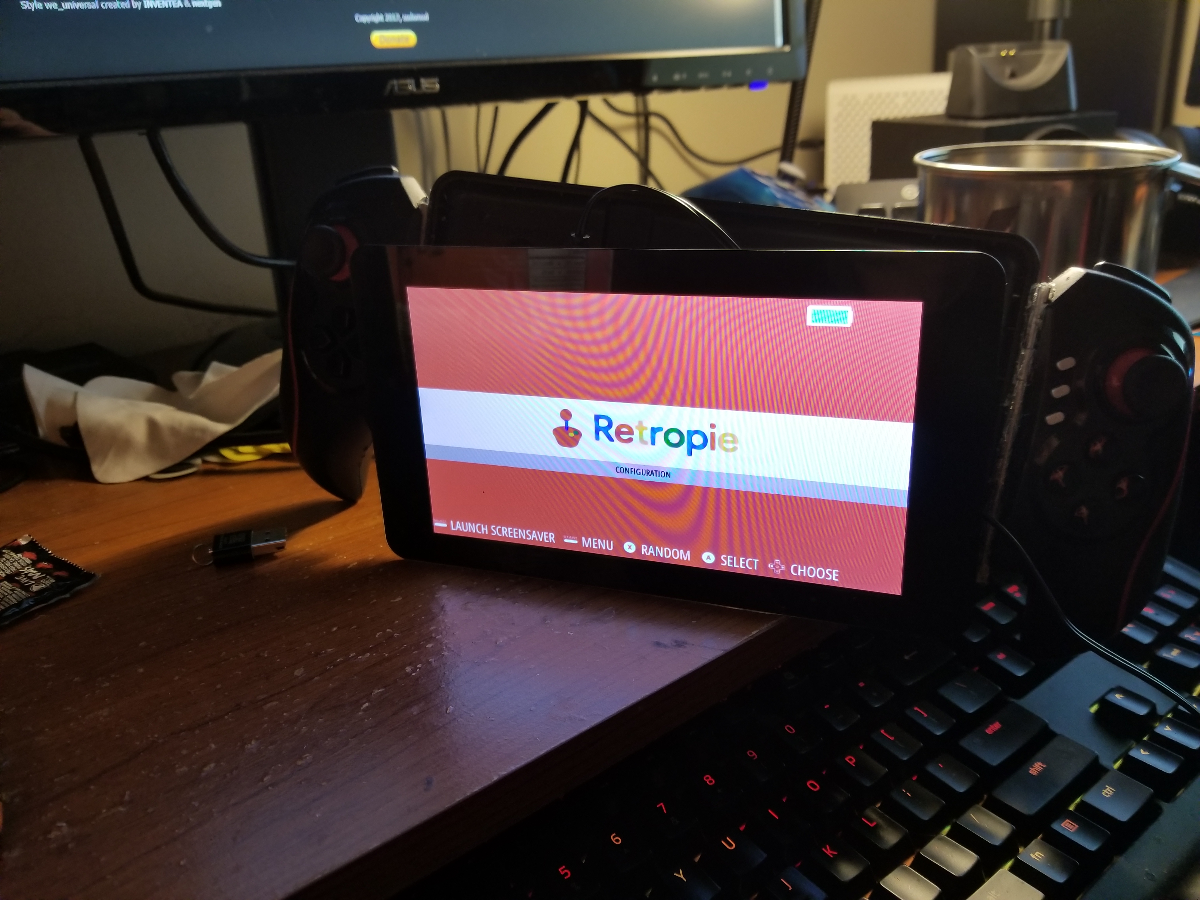

PROGRESS!!!! installed a fresh image of minty pi and downloaded the minty pi battery monitor and changed the values and now it shows on screen, but that is also troublesome cause i really dont wanna have to redo a 200gb sd card worth of stuff lol. Plus I also dont know if it is actually reading off of the battery as i have it pluged in from wall power to pi and not battery power to pi right now. Going to try and run it the same way off of my other image and see if i get the icon on screen now, i might need to to adjust the position though as it is not in the corner anymore due to the size of the screen

So it does seem that there is some type of conflict between the adafruit audio bonnet and the on screen battery display. I might just have to connect the speakers to the onboard headphone Jack and see if that works, if it does it will save a bunch of space (after rewiring everything that is.

Re: On-Screen Battery Monitor Options
welp bit the bullet and took out the audio bonnet and replaced it with the sabrent usb audio adapter, so now at least i got both sound and the battery monitor running thank you everyone for all the help and sorry for being a pain in the ass to veteran cause i know i asked you alot of questions with things but seriously man thanks for the help. Now I just gotta decide if I wanna leave the volume where its at or get the amplifier and boost the volume.
