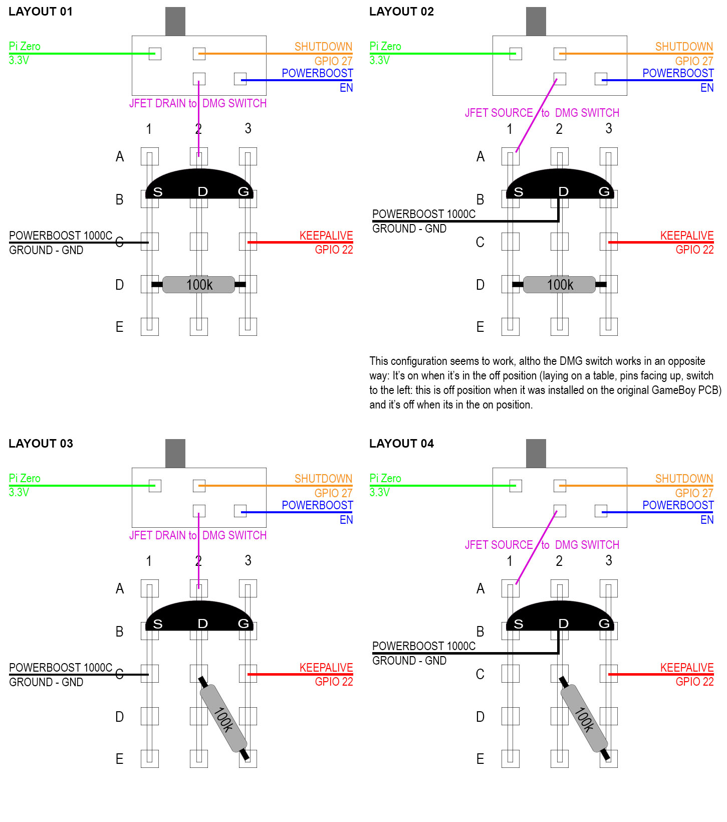

Since my last post, I've been testing and playing around with different configurations. I've made these diagrams to show what exactly I did.
Layout 02 seems to work but with the DMG switch behaving opposite of how it should. I'm thinking to just swap around the wires on the switch to get it to work the way it should.

KrxXxiT wrote:Since my last post, I've been testing and playing around with different configurations. I've made these diagrams to show what exactly I did.
In your diagram, if your switch is showing the off position, then yes it's wired backwards. Simply reversing the two pairs as you suggested should do it. What Jfet did you ended up using?
Vishay Siliconix 2N5460. But on further testing it seems that layout 02 & 04 work similar.
It's strange, sometimes it turns off straight away after flipping the switch, other times it takes 2 or 3 seconds. Is this supposed to happen? Is this because of "sudo shutdown -h now" in @popcorn's code?
(What I wrote in red happened, then I tested again...)
I ran through all the layout's again. It's weird, all seem to work except for layout 04. Layout 04 shuts down as soon as I flip the switch, no matter how far along I am in the boot process and post emulation station startup, whereas all other layouts react differently depending on when I flip the switch.
For instance, when I flip the switch as soon as I flip it on, it shuts off instantly, if I wait to see some boot text onscreen then flip the switch, it waits until the boot process is nearly done then shuts down on its own, but sometimes when I'm in emulation station it shuts down as soon as I flip the switch, and sometimes takes anywhere between 2 to 10 seconds.
What is going on? I must be doing something wrong.
Is it possible that 3 out of the 4 layouts work?
I'm getting mixed results and it's frustrating, is there some log file buried deep in the system that I can check?

@KrxXxiT
I tried all 4 of your diagrams with a fresh install of Retropie 3.8.1 (only adding the necessary dtoverlay=gpio-poweroff,gpiopin=22,active_low="y" config.txt change) on a breadboard with the Fairchild FET (noting that the Fairchild pinout is different).
Of note: #2 seems to match @Camble's most recent suggestion, while #4 matches what @myPiZero later recommended for moving the resistor. With all four choices, the power instantly cuts off when I flip the switch.
One interesting note: If I try to shut down the Pi Zero using the menus in Emulation Station, it does not shut down and I get a kernel panic. This happens on two completely separate Pi+SDcard+circuit setups. This happened even before I tried shutting down the system with the switch. One setup has Popcorn's script installed; the other doesn't.
