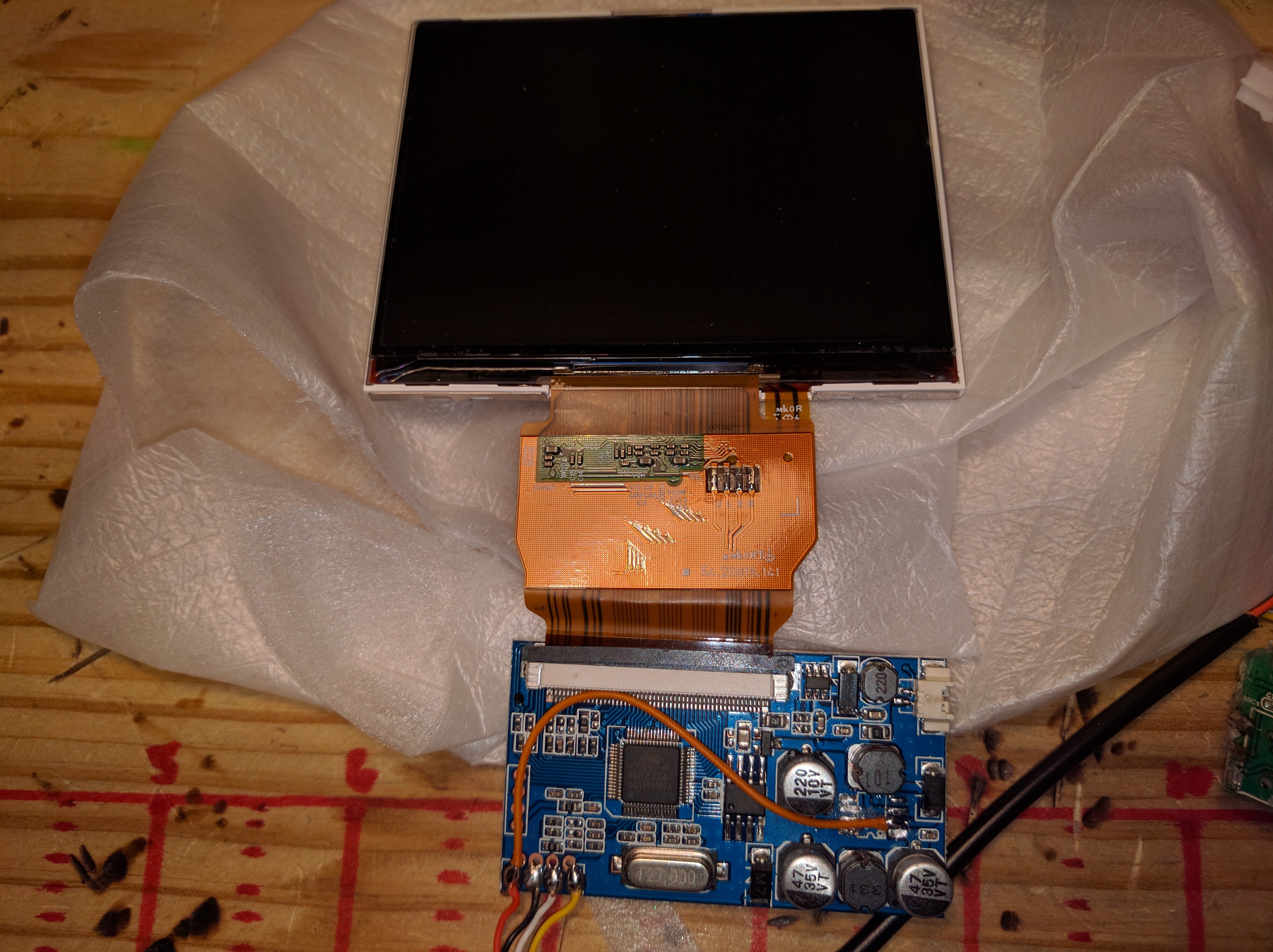

I tested the ePathChina screen that people have been asking about and I am NOT able to get it to run off 5v. I removed the IC and jumpered the cable. http://s20.postimg.org/nxs4pycwt/desolder_IC.jpg
Are we sure this screen can run?

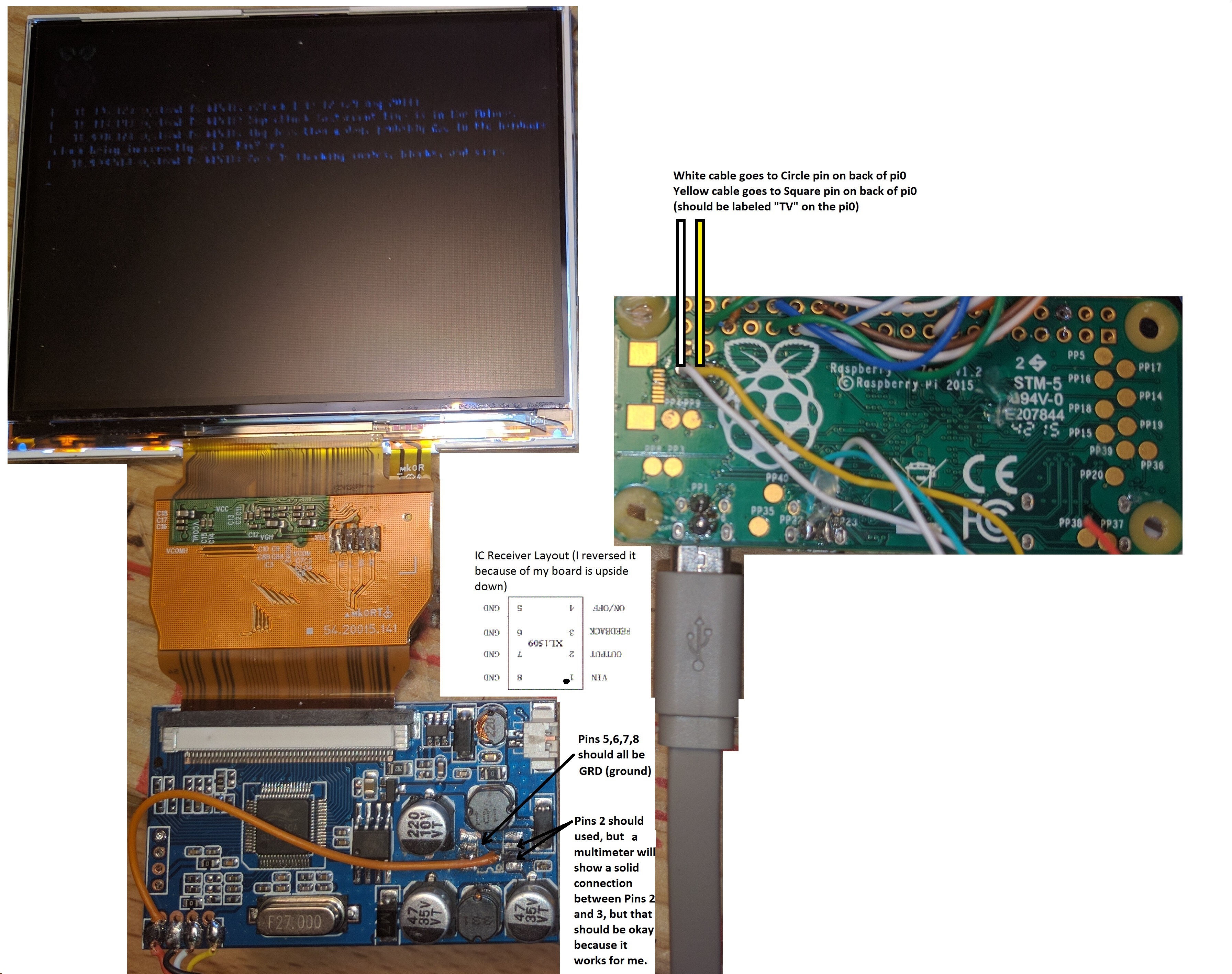

Post by dirtybeagles » Sat Jun 04, 2016 12:46 pm
