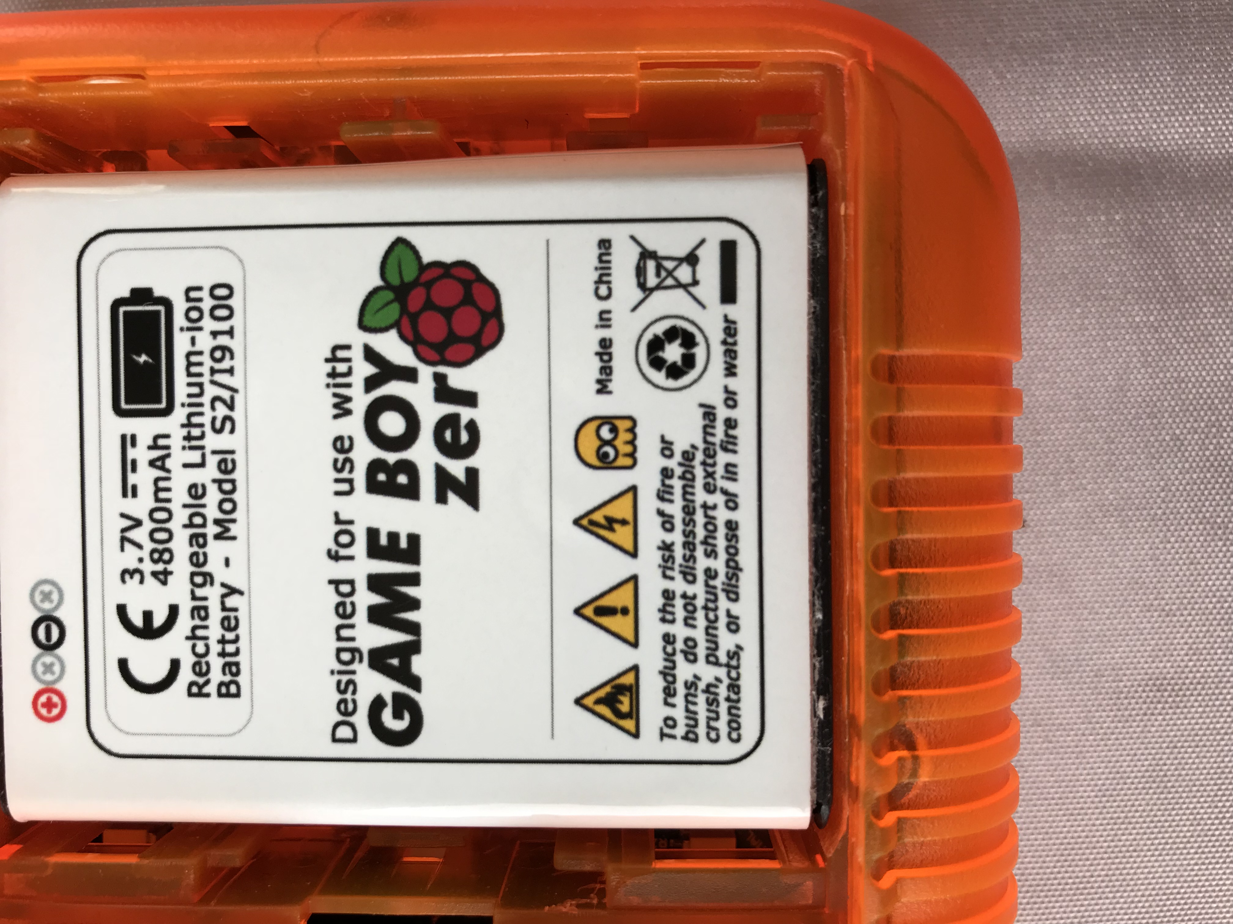

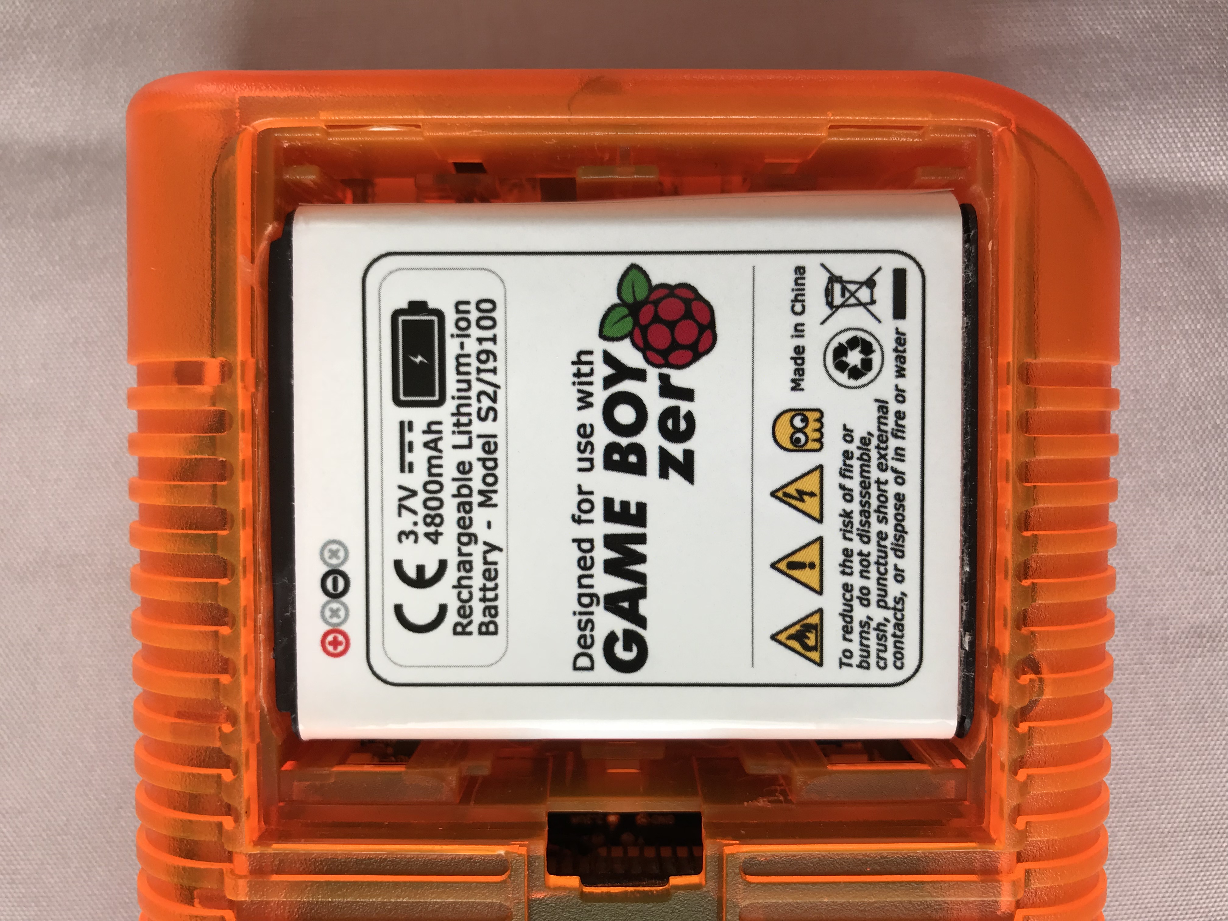

Post by djascher » Wed Mar 21, 2018 9:14 pm
Hi YaYa
Hoping you can help with me some research into batteries.
I was just going through your thread, and noticed that your build also used pogo pins to connect the battery to the main board, similar to HoolyHoo's build. Just wondering, what battery did you use? Where did you get the connector? And what kind of mods had to happen to your case?
There is a pic in your build thread where it looks like a piece of solid orange plastic is in the battery tray? Was this a custom design? How does it work with the original battery compartment?
Cheers,
David.
Re: YaYa's first GBZ - Kite's SAIO - Big Battery - NO Glue - Custom 3D parts - DC Jack - minimum case mod
Post by YaYa » Wed Mar 21, 2018 11:55 pm
Hey djascher...
Read carefully the post, all was already posted here
https://www.sudomod.com/forum/viewtopic ... 177#p48176
For the extras pictures of the battery tray modification, i’ll post them this evening, i’m not behind my computer right now (7Am here, already at work lol)
Cheers
Post by YaYa » Fri Mar 23, 2018 12:35 pm
so here are some pictures of the battery tray djascher :D
(sorry for the late post, i was really really very busy with my job these days)
