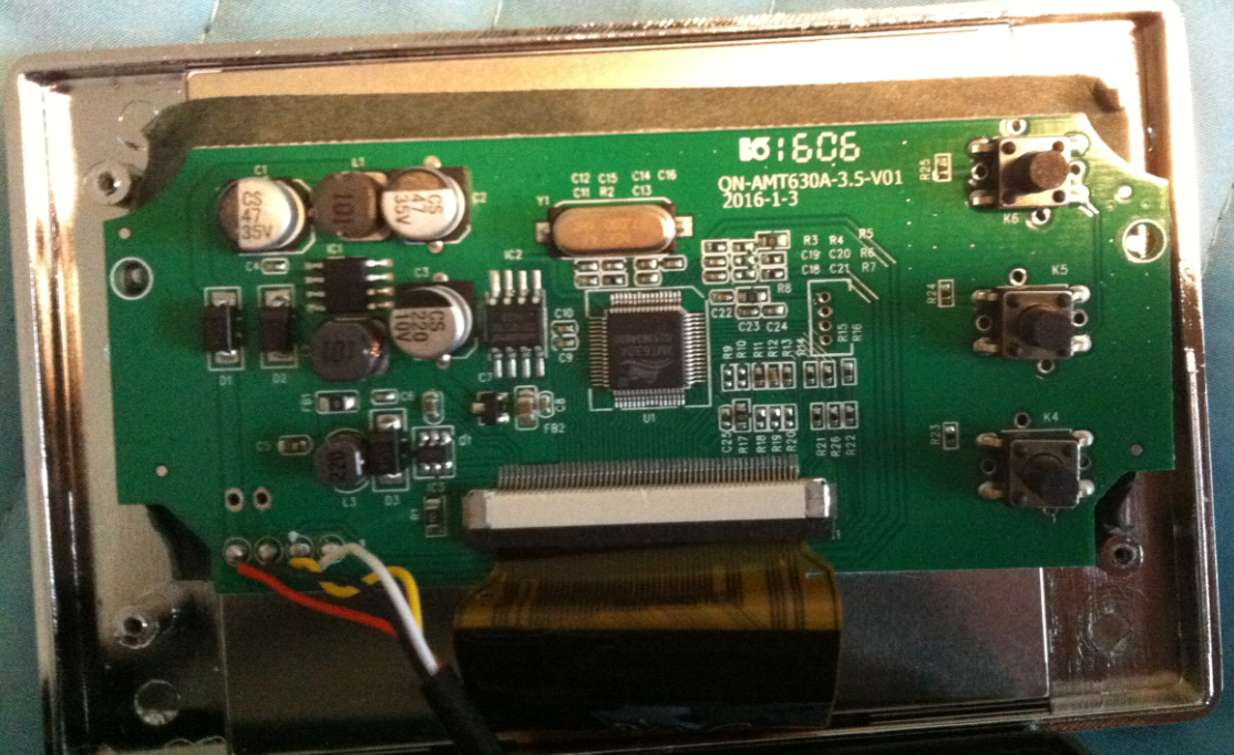

I ordered the same screen as user "solder": http://www.ebay.de/itm/281957411642?_tr ... EBIDX%3AIT
I wasn't lucky though.. Got one with a huge pcb. Is this going to be always like filling a lottery coupon if you don't buy the adafruit one? Or is there any confirmed alternative item/seller that will work 100% sure?

If its working anyway, maybe you could cut of a bit of the pcb, it looks like theres a lot of free space. You could try to see that using the flashlight trick @wermy used with the micro usb breakout board.Retrorednek wrote:I wasn't lucky though.. Got one with a huge pcb. Is this going to be always like filling a lottery coupon if you don't buy the adafruit one? Or is there any confirmed alternative item/seller that will work 100% sure?

I was thinking about that too until I checked out Wermy's guide where he uses the same board as an example: "The one on the left is too wide to fit in the Game Boy without cutting the edges a bit. Worse, though, it doesn’t work with some screen modes (some resolutions seem to just blink for no reason including some boot screens, as well as the Doom main menu), and has horrible image ghosting after staying on a screen for more than a few seconds (I tried it with both 5V and 12V)."witti wrote:

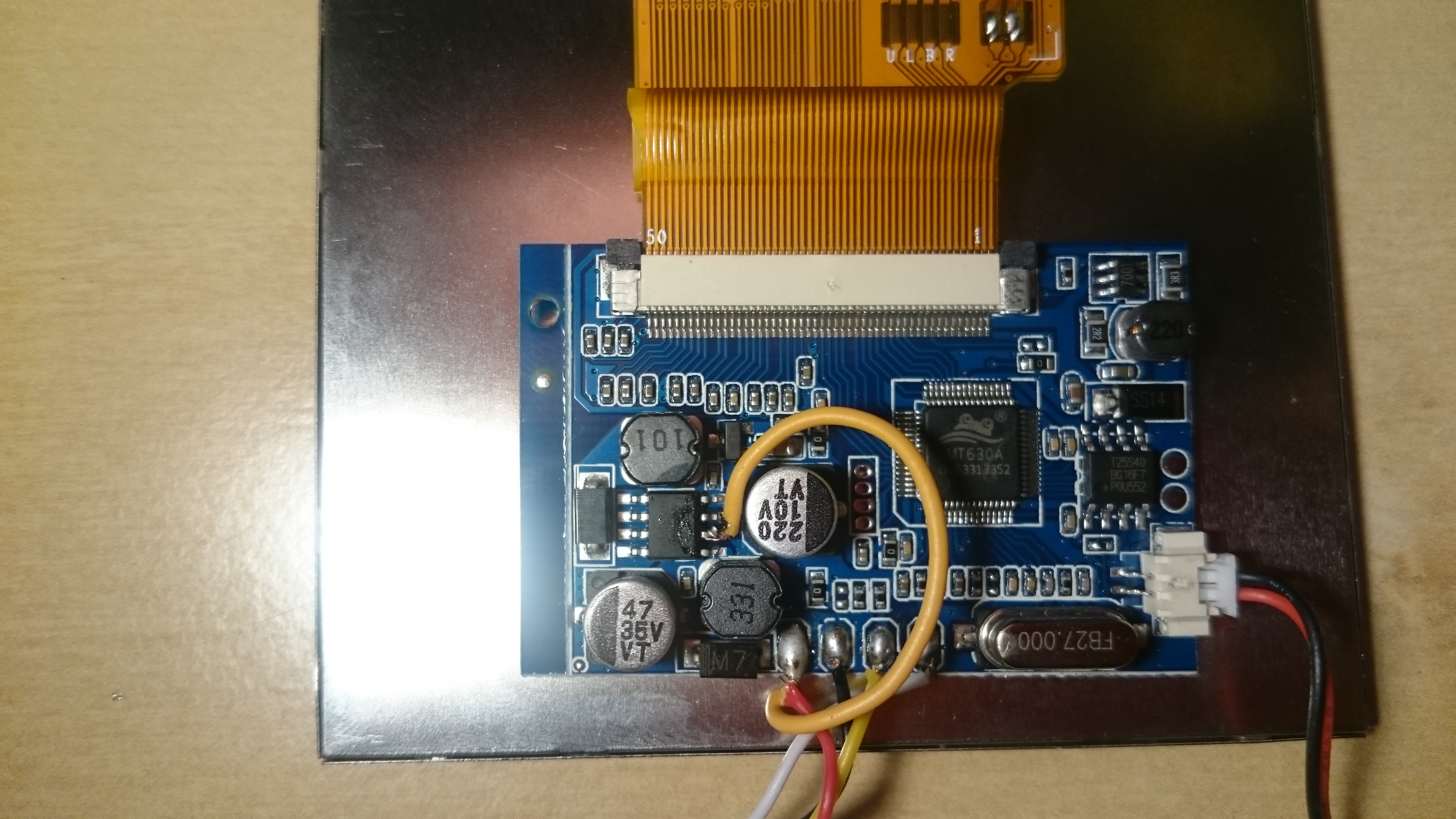

Hi! I recently bought two screens from Amazon UK. I bought 2 because it's been awhile since I've done any soldering and I thought it was better to buy two, just in case! (they're also very cheap). Funnily enough, even though I ordered them at the same time and from the same merchant, I believe I got different screens - a Variant 2 and a Variant 7 - see screenshots below:
The problem I've got is that I can't get either screen to work. Neither screen's backlight will come on when I plug in a 12V 500mA power supply to the power input on the screens (does polarity matter?). I've also tried 5 other power supplies (5V to 9V power) and still nothing. I also tried a 9V battery that I took out of my smoke alarm and that didn't work either (admittedly its quite an old battery so might be a bit flat).
I thought it might be just bad luck with the power supplies that I've got so I went ahead with the 5 volt wire mod on the Variant 2 screen - see screenshot above. Now the backlight will come on but I can't get any picture when I plug a Nintendo Wii into the video input socket. The slightly concerning thing is that the backlight doesn't stay on properly - it alternates in brightness every second or 2. Has anyone ever seen this?
Next, I tried to solder +/- power directly from the Variant 7 board to the +/- 5V output on my Pi Zero. The wiki states that the Variant 7 board should work with 5V without any mods. Unfortunately, I can't this screen to work at all - no flashing backlight, no nothing.
Has anyone got any suggestions? Would anyone be willing to check them over (preferably in the UK), make sure that I've done the mod correctly and send one back to me? (they can keep the other screen if they can get it work). I'd be willing to pay a few quid for your time!
