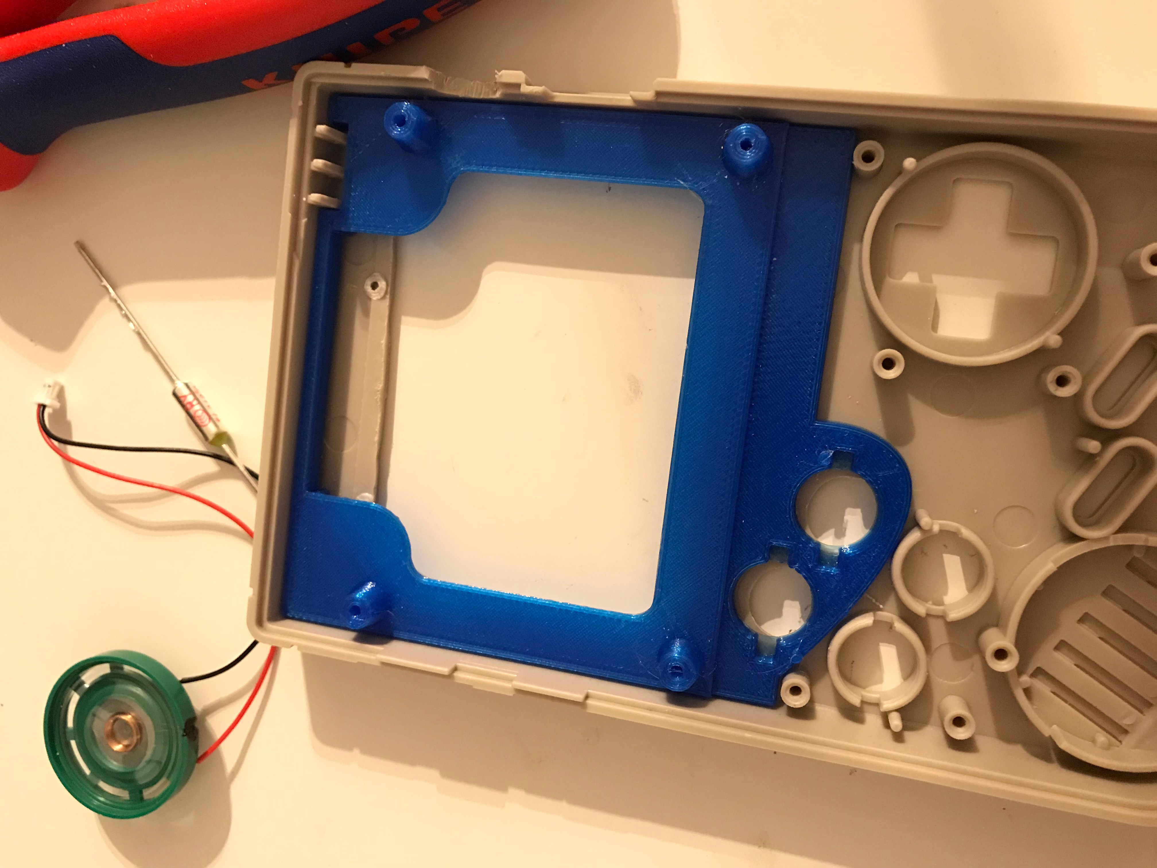

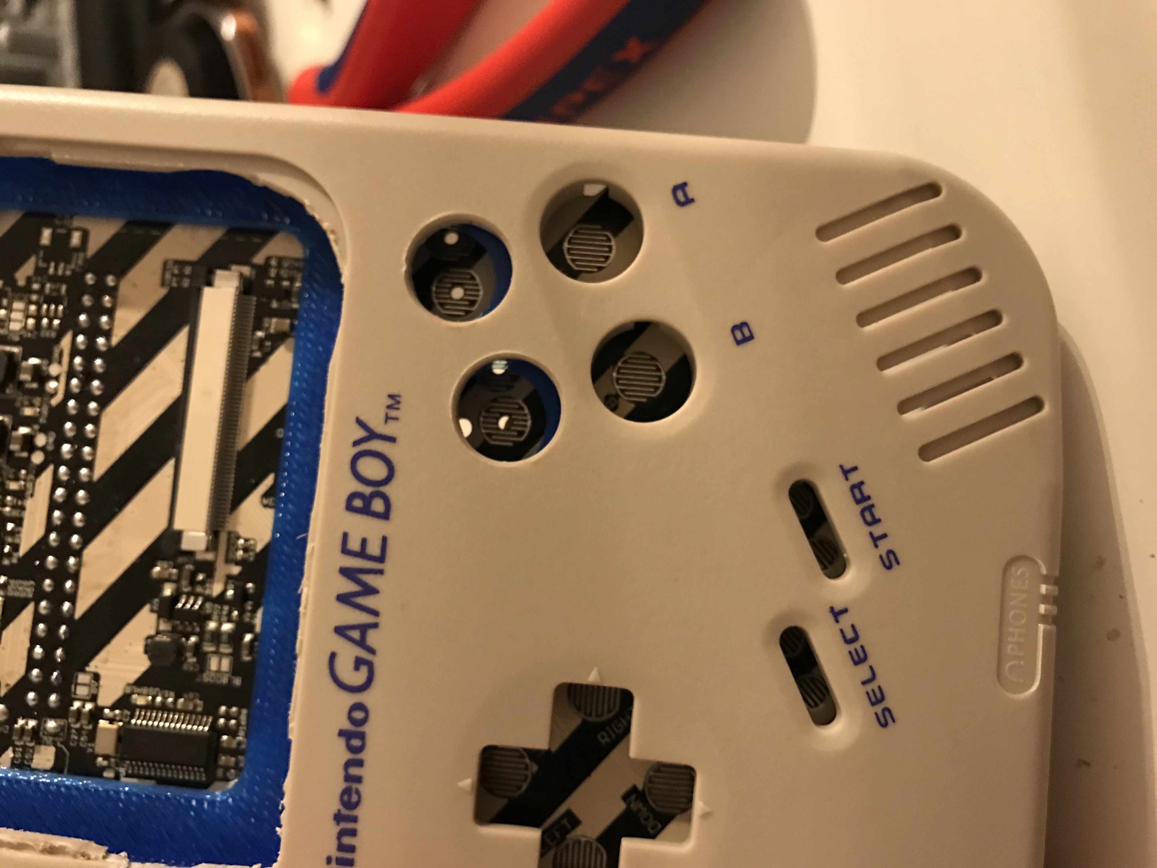

I am working on my first GBZ and I use Kites latest SAIO Board and I also used the "Normal"-Holes printed on the PCB and now the Buttons do not batch with the wells on your bracket. Where did I do wrong? I already ordered a new Case as I messed up the Screen cutting. So should I use the two nobs with the hole, that came with the bracket or should I sand down the bracket a bit?

You need to position the bracket and then insert the two well guides in the bracket wells. Mark the holes with a fine marker. Use a small drill for a pilot hole on that mark then make the appropriate size holes with the correct size step drill bit. The information is posted on the first page of this thread. Hope this helps.

Thank you! So it was my own fault :/ I stupidly followed the PDF from Kite.
