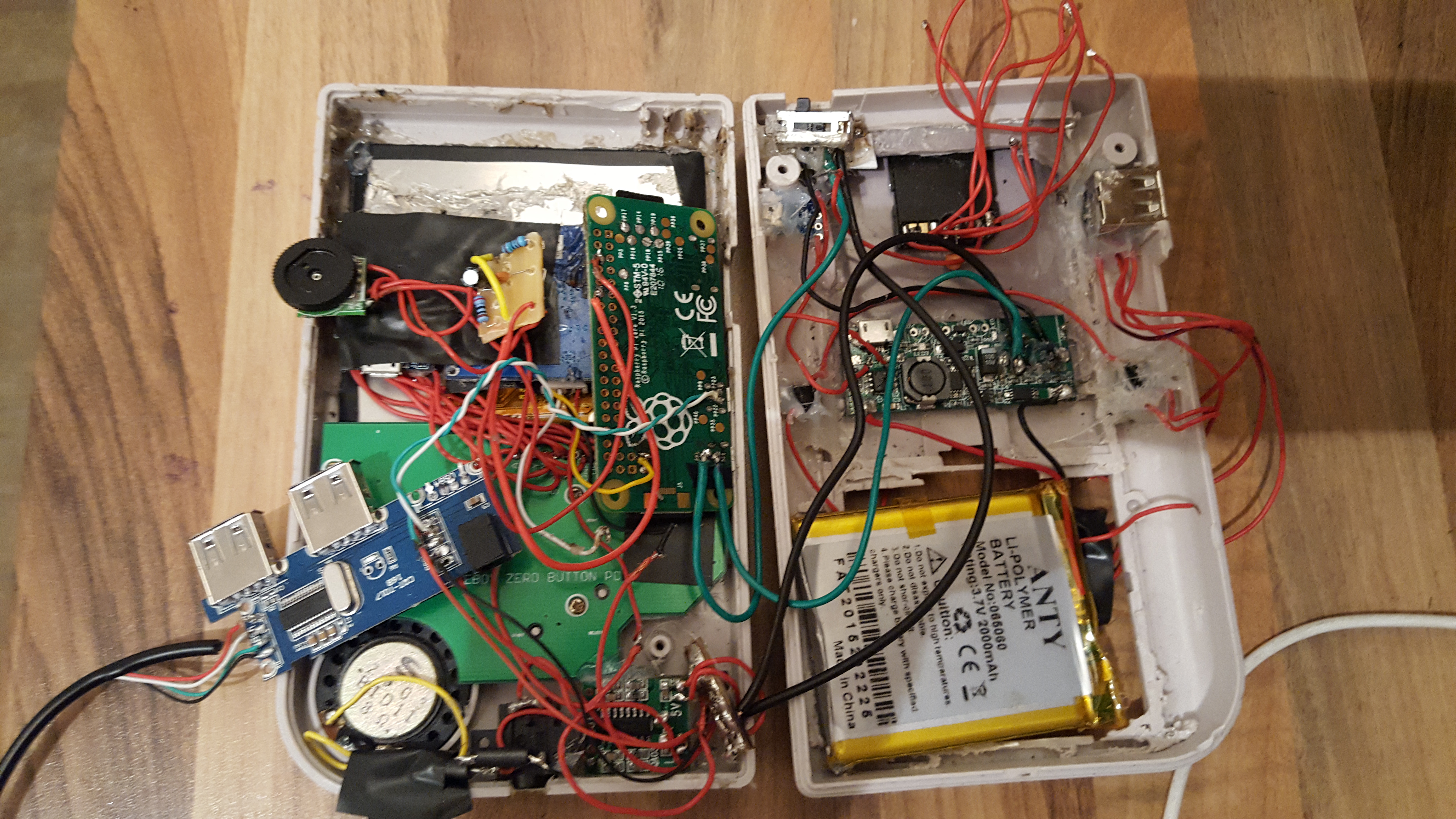

If it's only getting hot in the case, maybe you have a short somewhere that only happens when it's all squished in place. There is no way a zero will get red hot just from being in a case the cpu in those is very cool running even under load. Just idling, nah.
Can you take a pic of your setup both in and out of the case?

abrugsch wrote:If it's only getting hot in the case, maybe you have a short somewhere that only happens when it's all squished in place. There is no way a zero will get red hot just from being in a case the cpu in those is very cool running even under load. Just idling, nah.
right back to getting helpful advice..... i have a lot of space internally currently so do not think anything is being squashed?
pic below of the inside i know there are a "few" lose wires but these are wrapped when closing

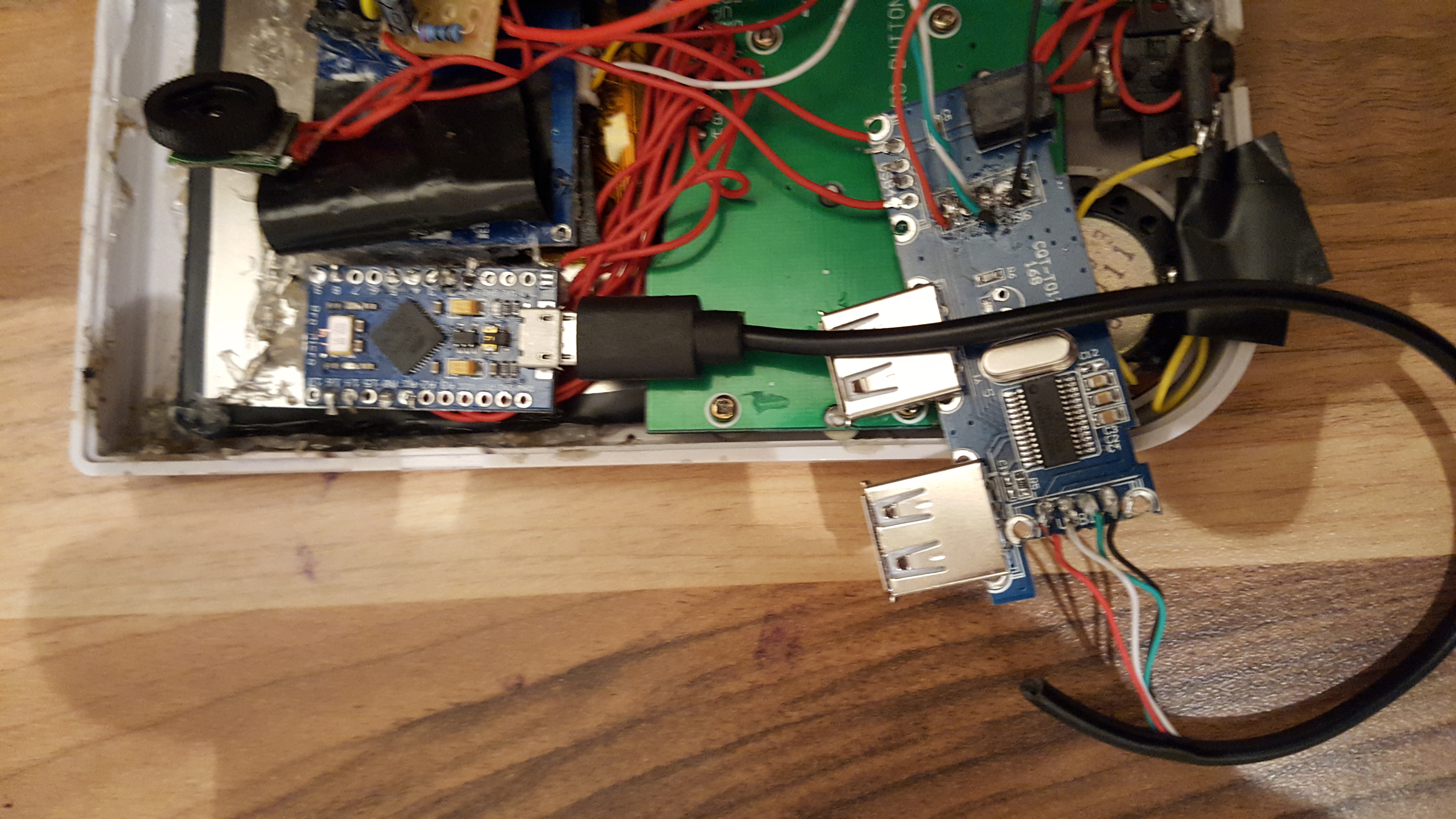

i have however made some progress, previously mentioned about taking it back a few steps and just running a few things then adding more and it seems my arduino maybe causing the heating.
My pi running the screen/speakers was left on for an hour in the case and got warm but not "hot" :D
i than connected the arduino and within minutes the red square came on.
i have attached a pic of this close up. Because the arduino lacks the connections that the teensy has i had to connected it through the usb to my usb hub, maybe this is causing an issue but not sure how else to connect it?
