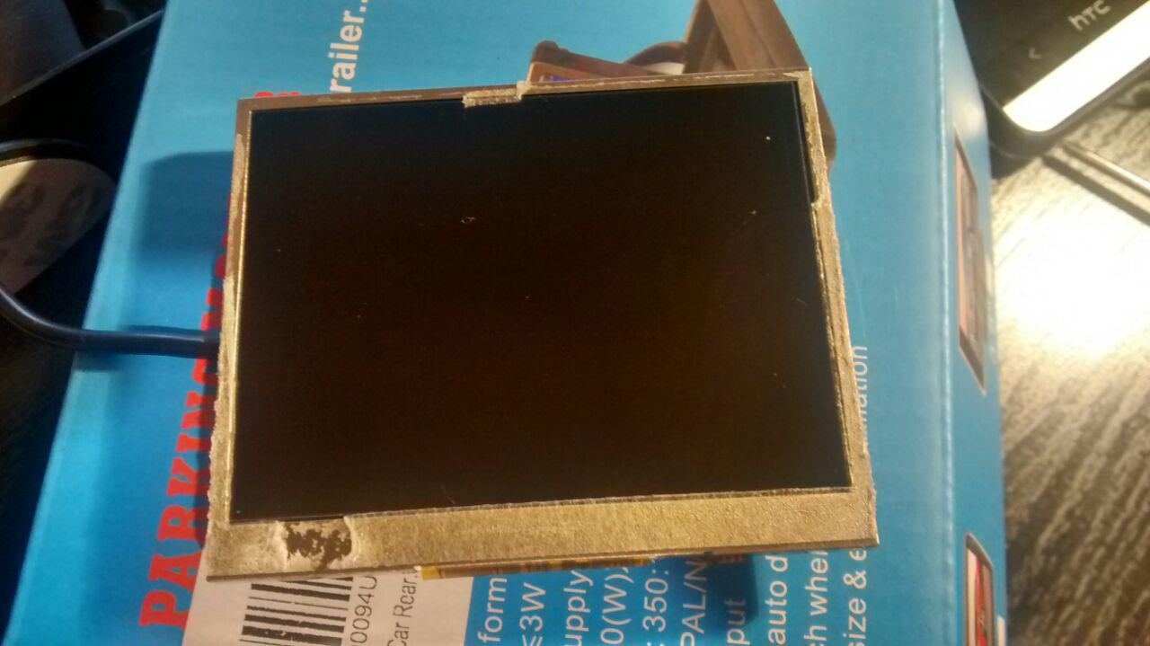

Be careful about removing the screen from the front panel, I've cracked the corner of mine! (fortunately it's invisible :roll:)

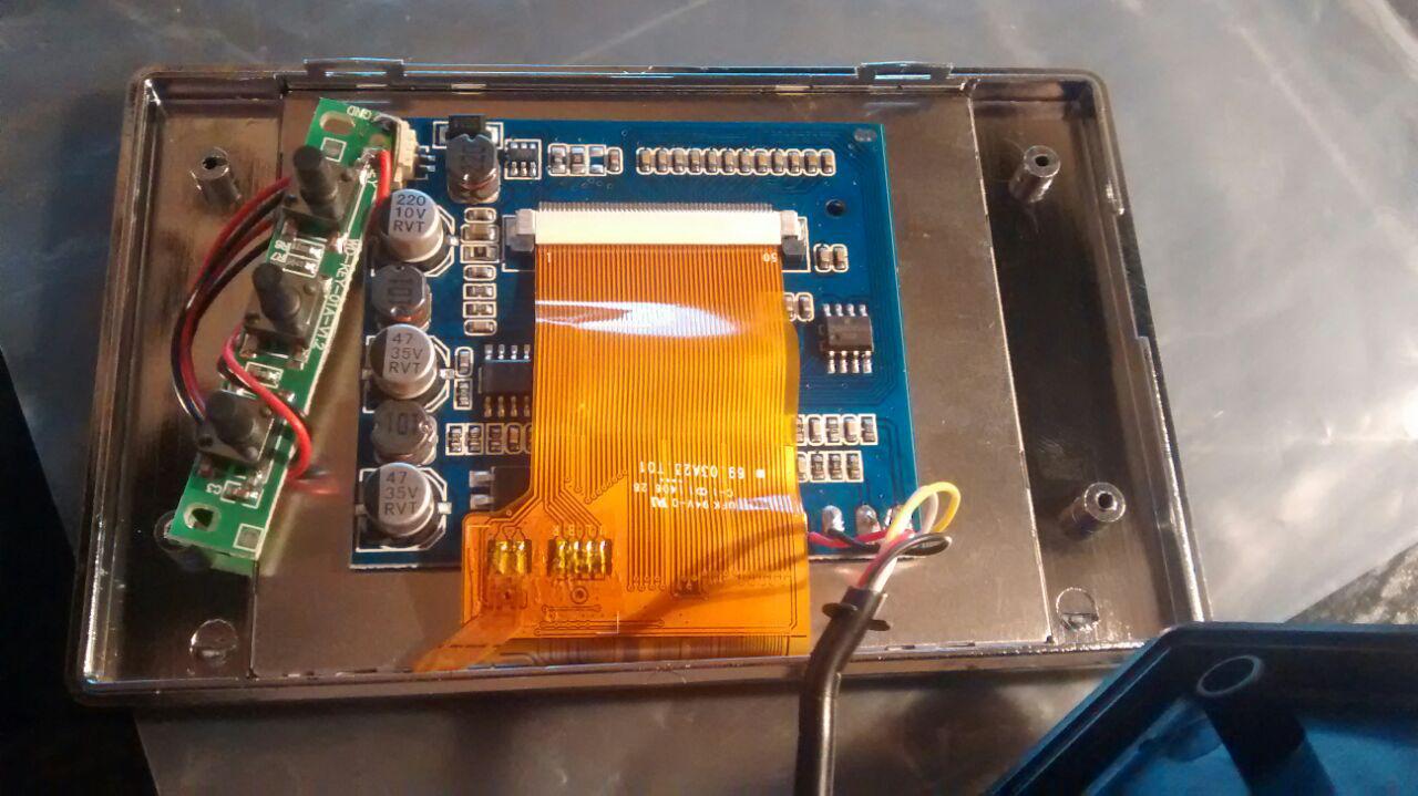

The mine has just arrive. It is the same as @Tom showed.
@Tom how did you remove the frame?
Anyone knows how to make this model work with 5V
agarajag
Posts: 7
Joined: Sun May 08, 2016 3:44 am
Post by agarajag » Mon May 09, 2016 1:53 pm
I just remove the frame. I recomed to use the hair dryer.
As you see I have made a mistake in the case :S

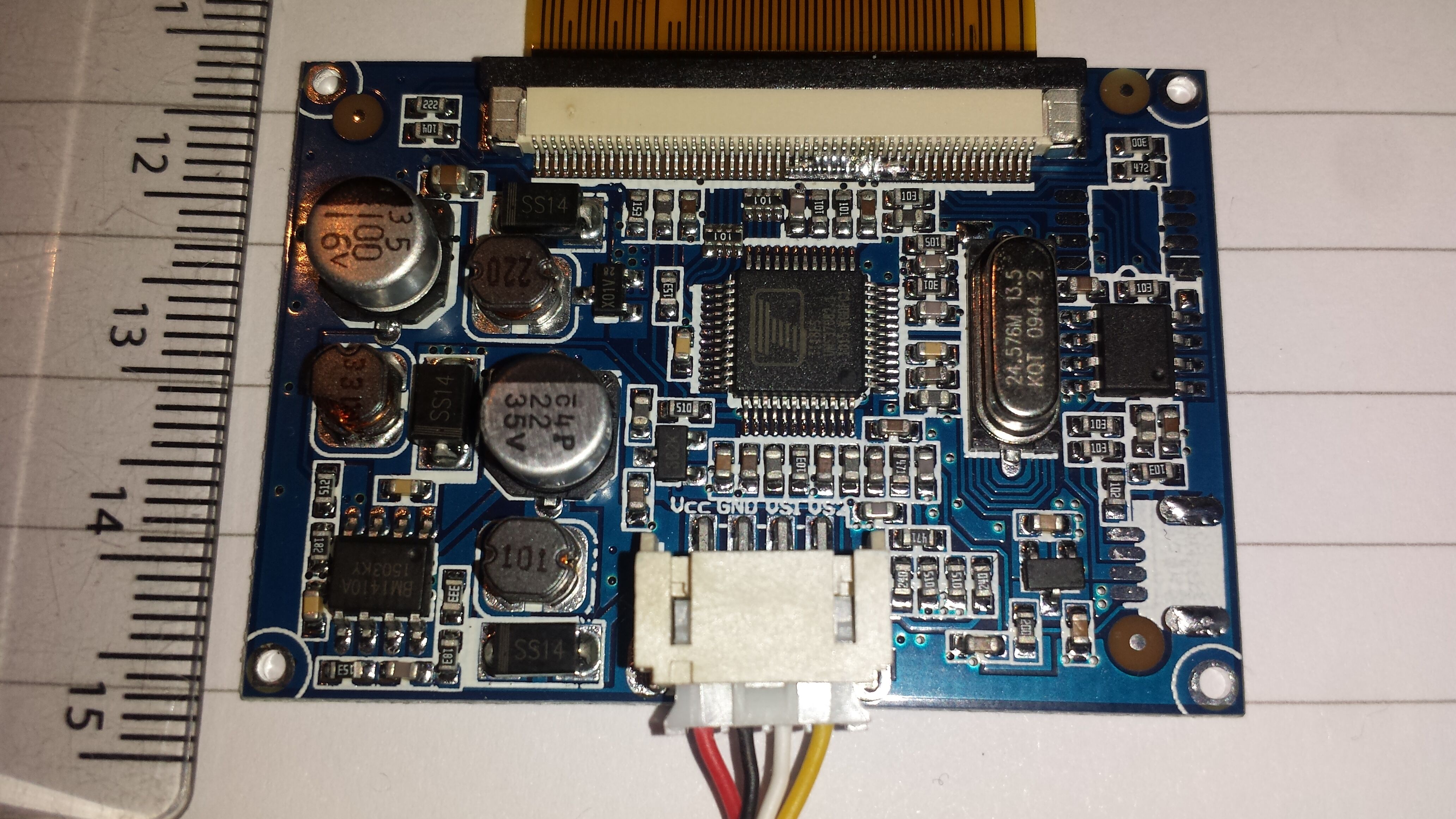

Forgive me if this is a beginner question but how are you testing it to ensure that it works off of 5V? Where do you connect the wires? I have a 5V power supply and want to add mine to the list but I am not sure how to make meaningful commentary on it. Thank you in advance for clarification! For reference I have the same board as DeltaShadow at the beginning of the thread.
crispy_tofu
Posts: 340
Location: Australia
Post by crispy_tofu » Mon May 09, 2016 8:38 pm
Frank_Steine wrote:Forgive me if this is a beginner question but how are you testing it to ensure that it works off of 5V? Where do you connect the wires? I have a 5V power supply and want to add mine to the list but I am not sure how to make meaningful commentary on it. Thank you in advance for clarification! For reference I have the same board as DeltaShadow at the beginning of the thread.
Plug the 5V power supply into the power jack of the screen. If it works, bingo!
If it doesn't, open it up and do this: https://www.raspberrypi.org/forums/view ... 1eebd9f91b
If it works, huzzah!
If it doesn't, then the screen cannot be run off 5V without a boost converter. :)

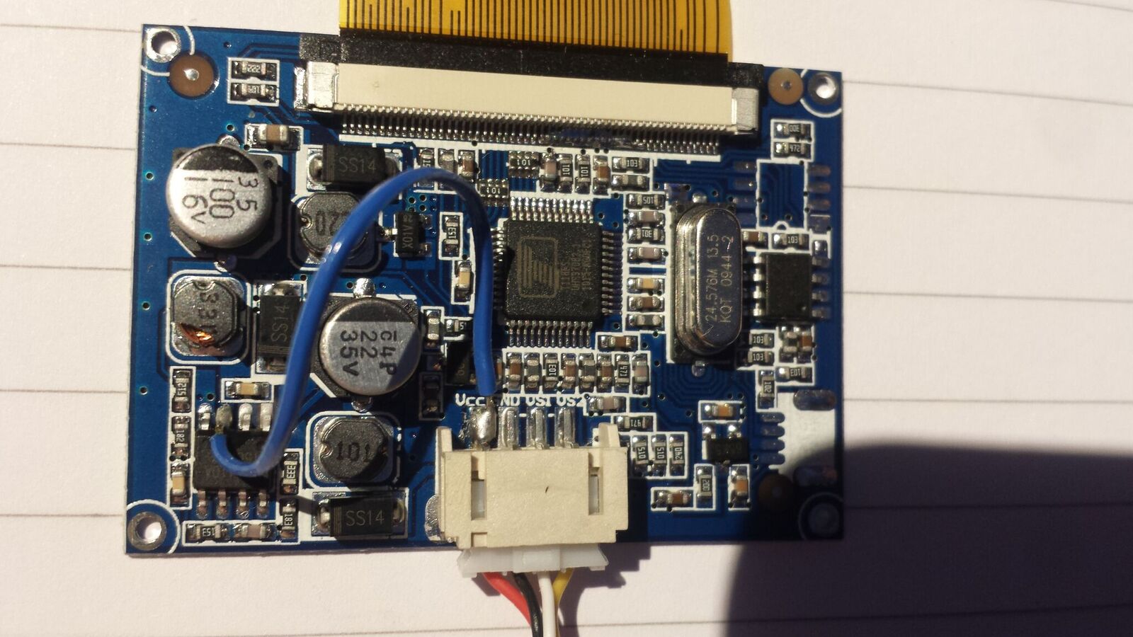

1. no it doesn't run directly off 5VDC
2. Yes it has an IC (bottom left corner BM1410A)
3. Yes with the IC mod it works off 5VDC
4. no contrast buttons?
I didn't remove the step down converter just soldered on a jumper wire, looks like its working fine.
