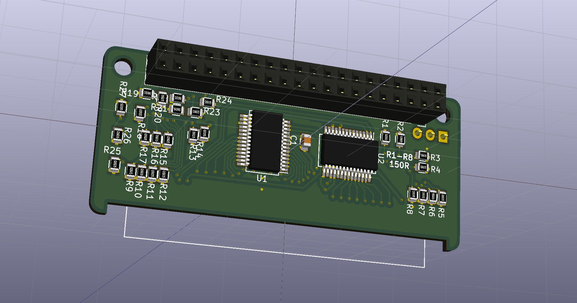

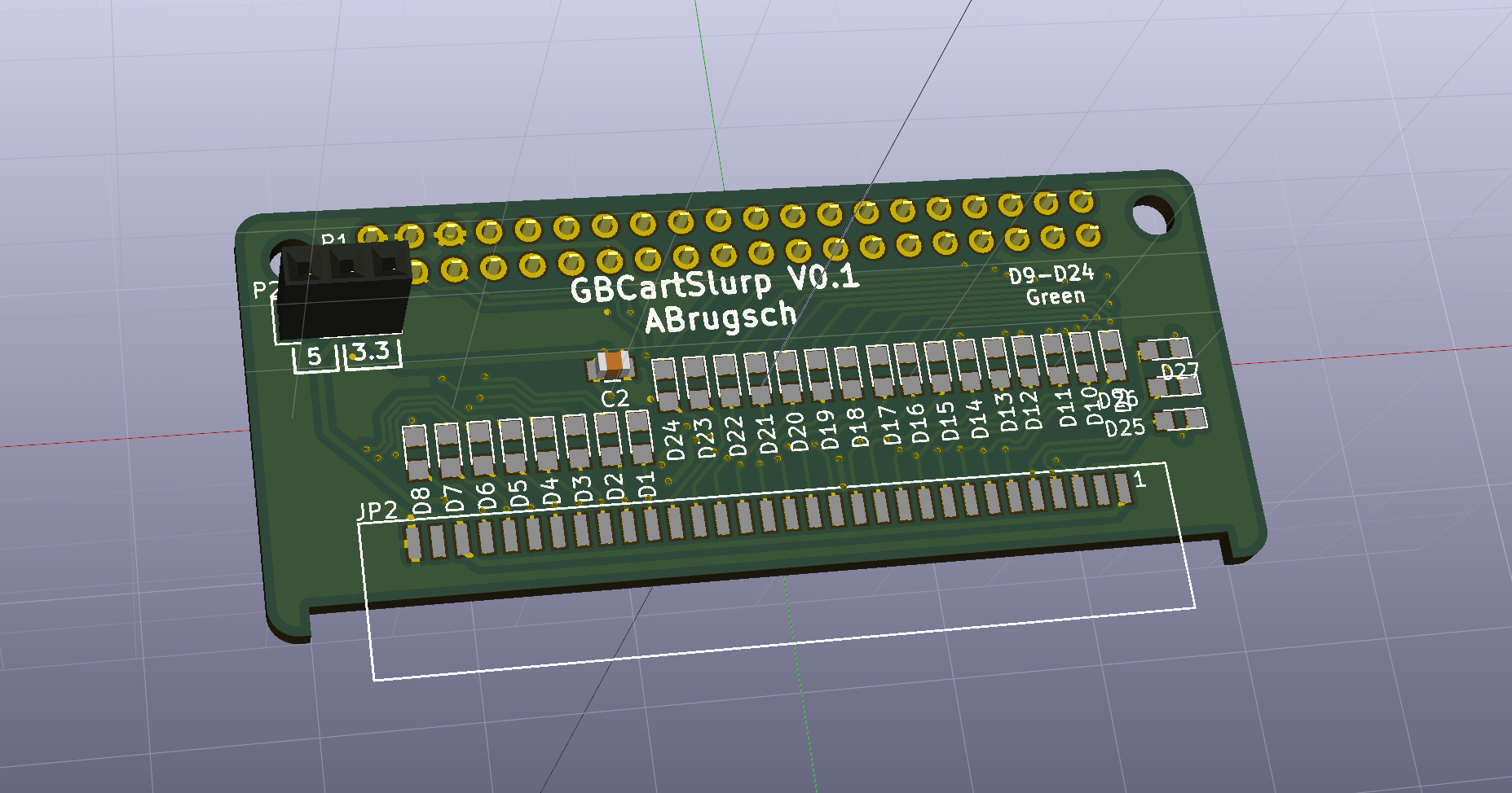

really starting to look like something proper now.
got some testing to do before I send it to be fabbed but now with added decoupling caps :D

Post by abrugsch » Mon Jan 16, 2017 6:00 am
Minor update, I've sent the PCB to OSHPark to be fabbed so should get it in a couple of weeks.
I've also updated the github repo to include a wiring diagram for anyone foolish enough to attempt this themselves ;)
https://github.com/abrugsch/GBCartSlurp ... iagram.svg
