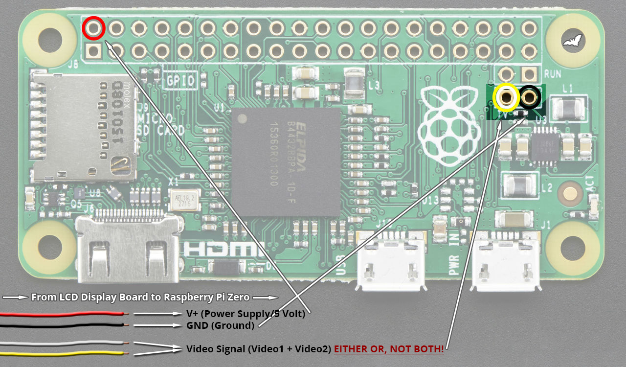

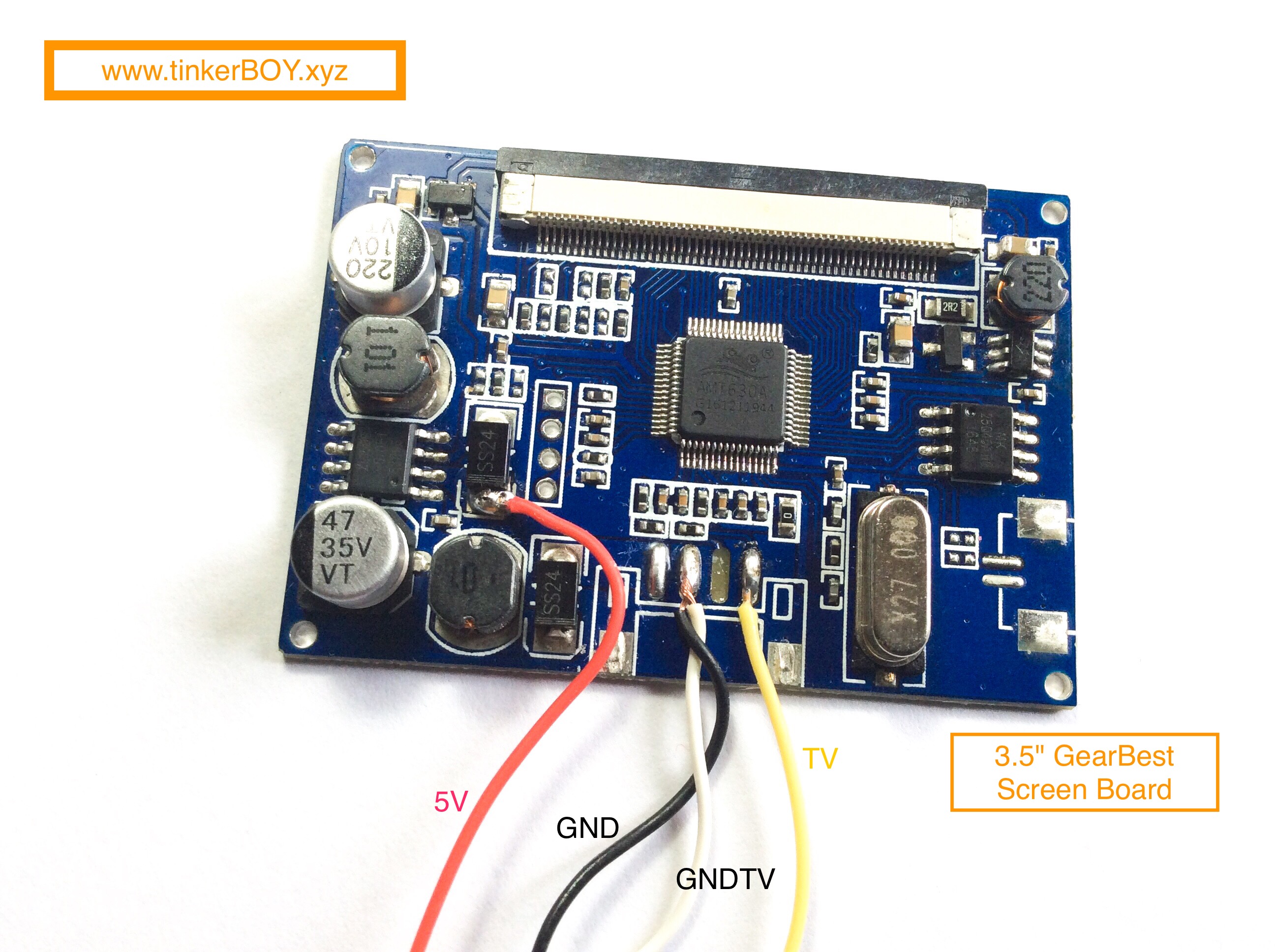

Hi,
I Just recieve this display.
Can you explain me how connect it to the raspberry or give me link to tutorial who explain how to do this ?
I understood there's no need a powerboost, but I can't find anything about the connexion of the display.
Thanks to everyone.
Re: Rodocop's 3rd GBZ [COMPLETE]
Post by rodocop » Fri May 10, 2019 8:13 am
alscino78 wrote:
Fri May 10, 2019 12:34 am
Hi,
Thanks to everyone.
If you received the same display as I used in this build, then yes, you will need a boost module to provide 5v to the screen. You do not need to make any modifications to the screen though, since it will run on 12v and 5v no problems. Check this for wiring info for composite screens:
viewtopic.php?t=958

Yes, it's the same screen.
Thanx a lot for your reply, Can you please, add the the complete schema from display > 5V module > Pi0 ?
Thanx again.
Post by rodocop » Sun Oct 20, 2019 5:08 pm
alscino78 wrote:
Fri May 10, 2019 4:45 pm
Thanx again.
You can see it two posts above for the connections to the pi, see here for the screen connections.
https://www.tinkerboy.xyz/wp-content/up ... G_2339.jpg
