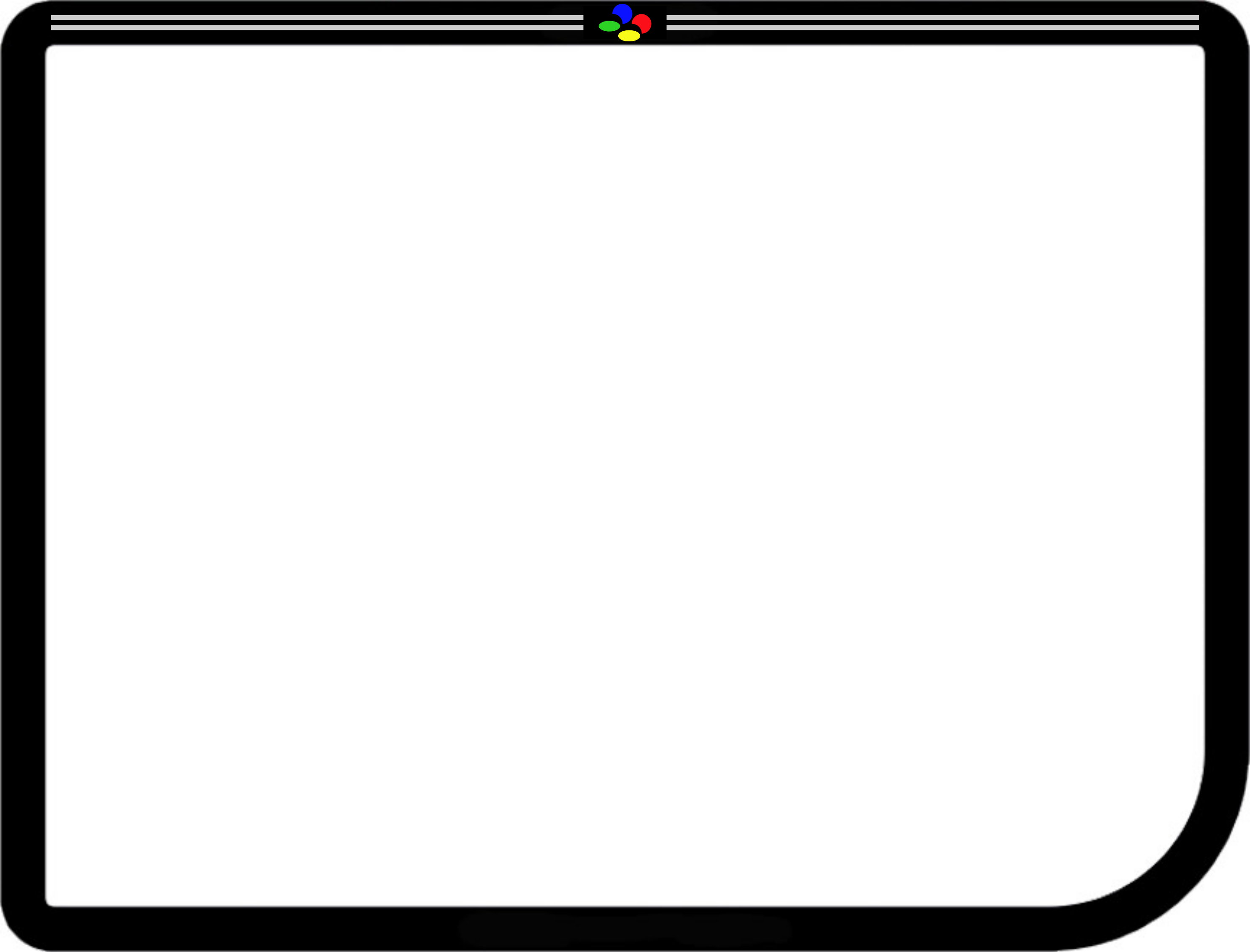

I was trying to ignore names completely and just go for a logo. Something like this but haven’t had any luck getting one made.
