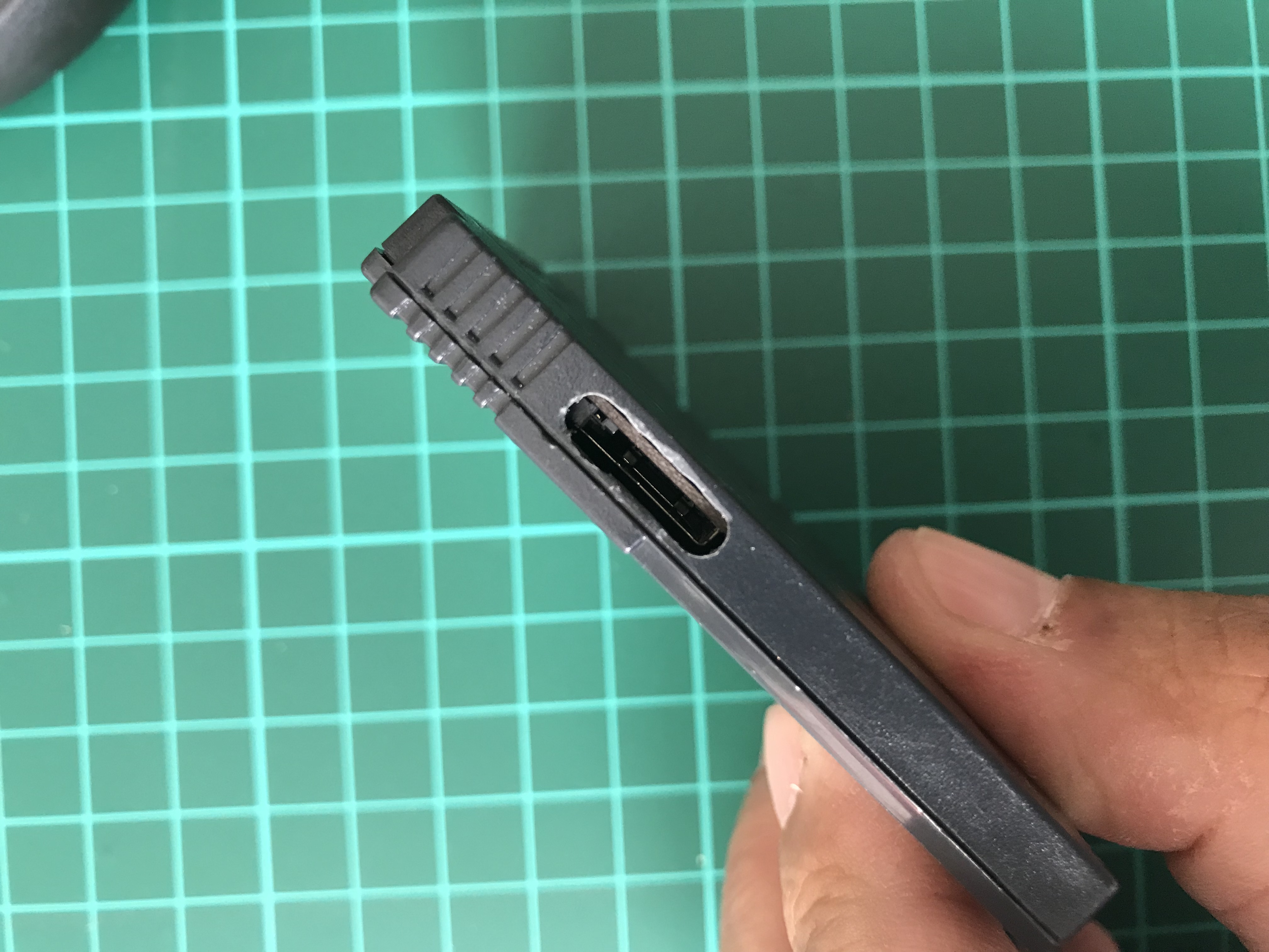

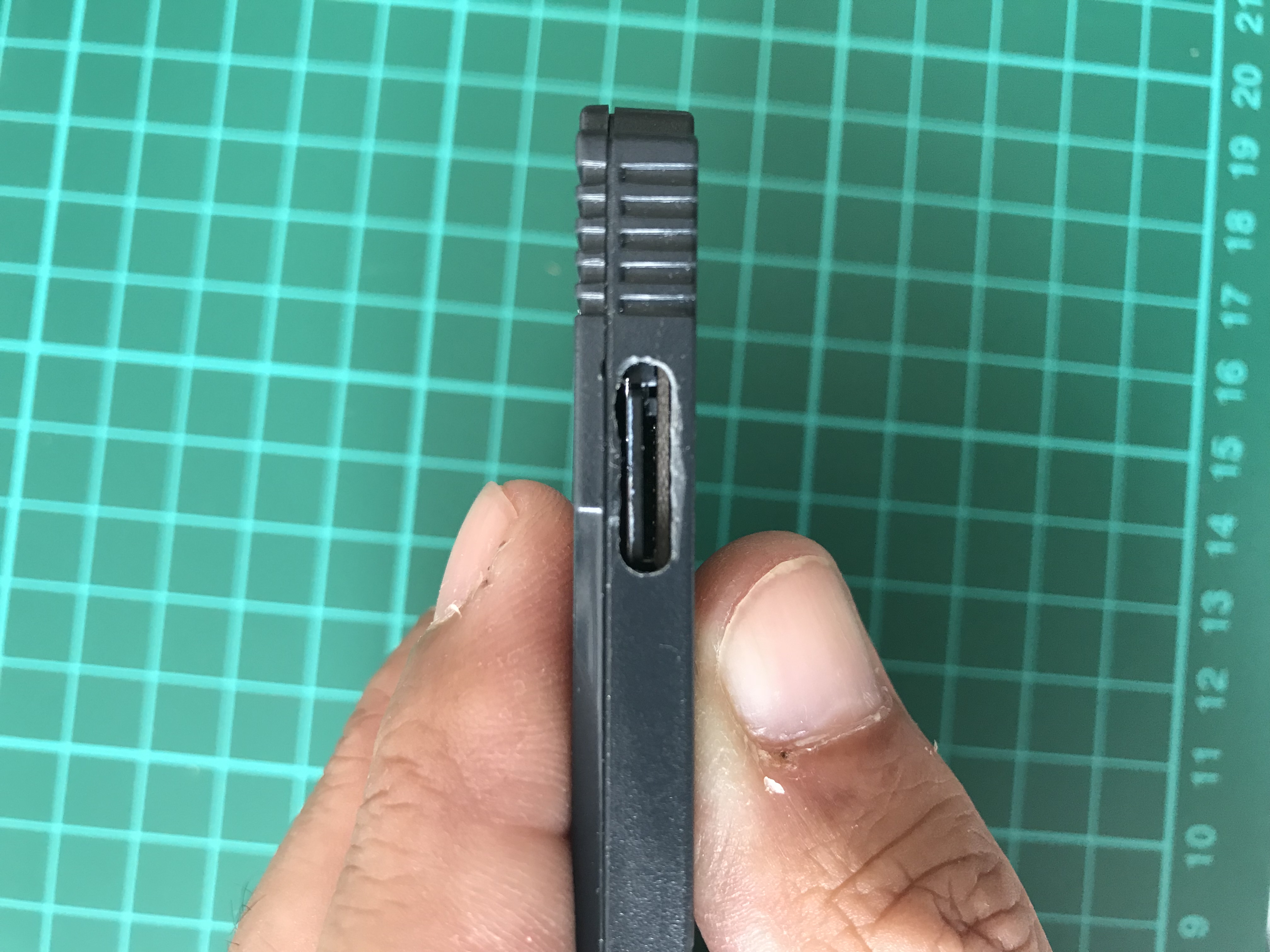

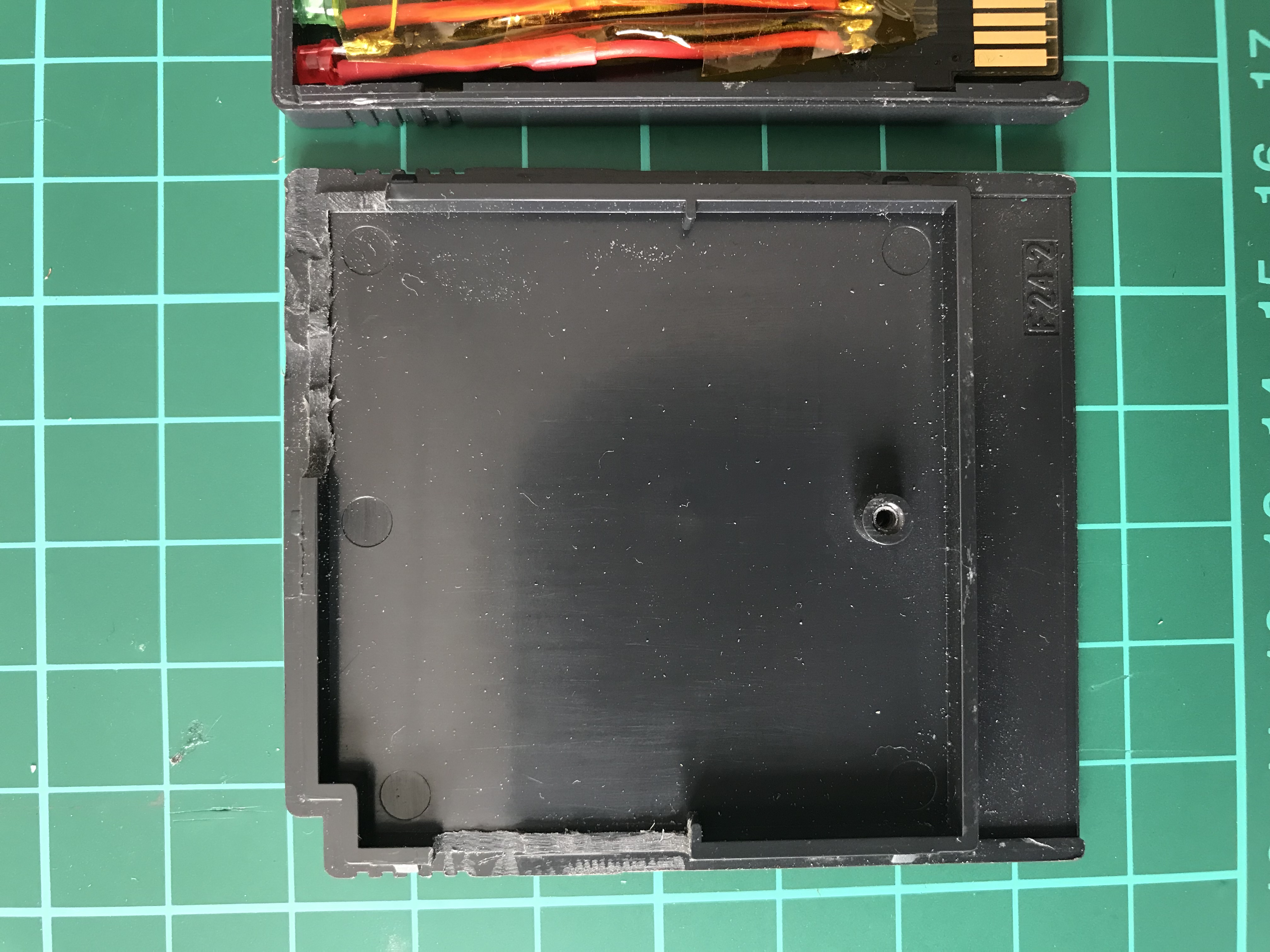

The front shell cutout to let some room to the LEDSShow

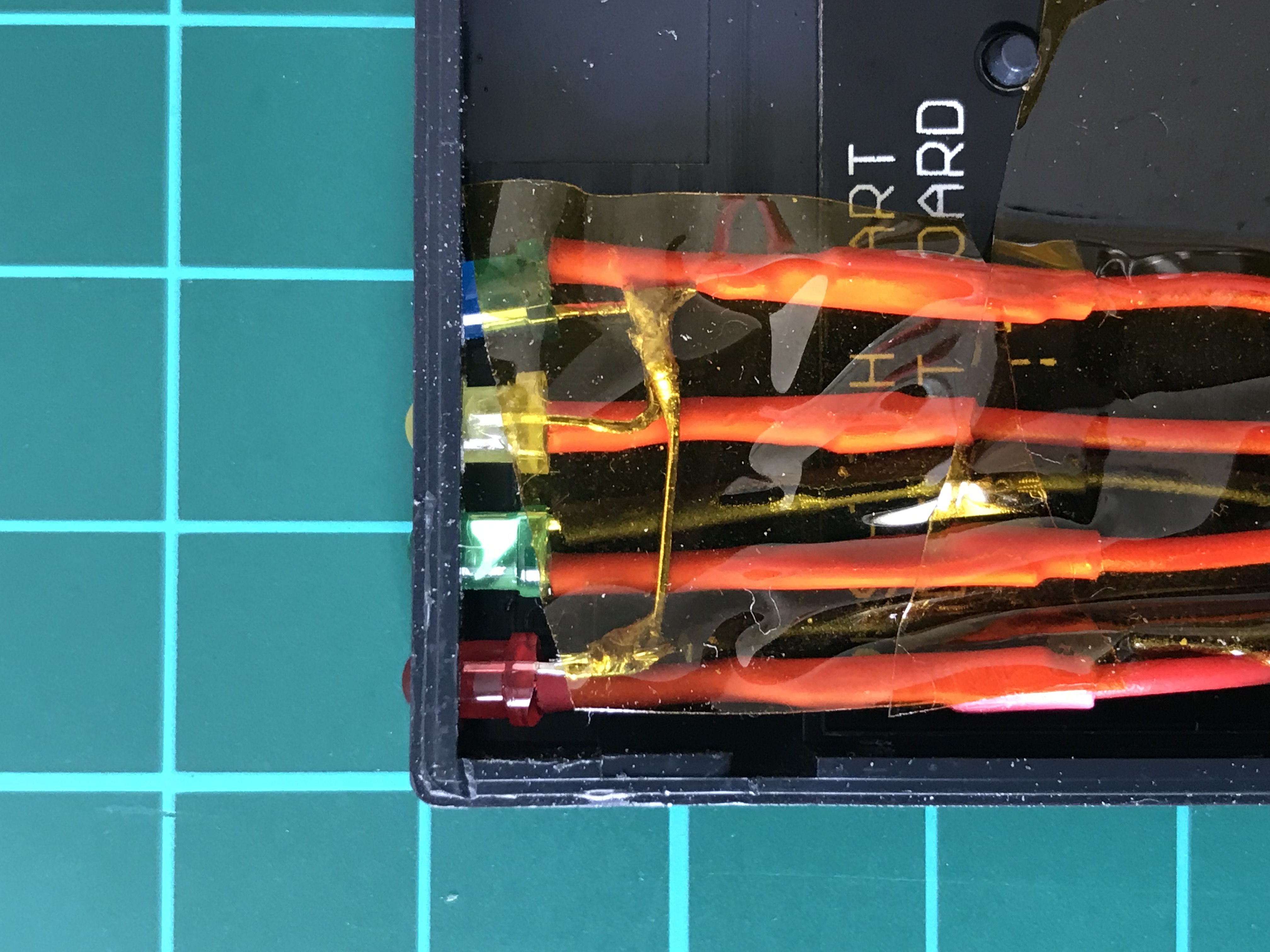

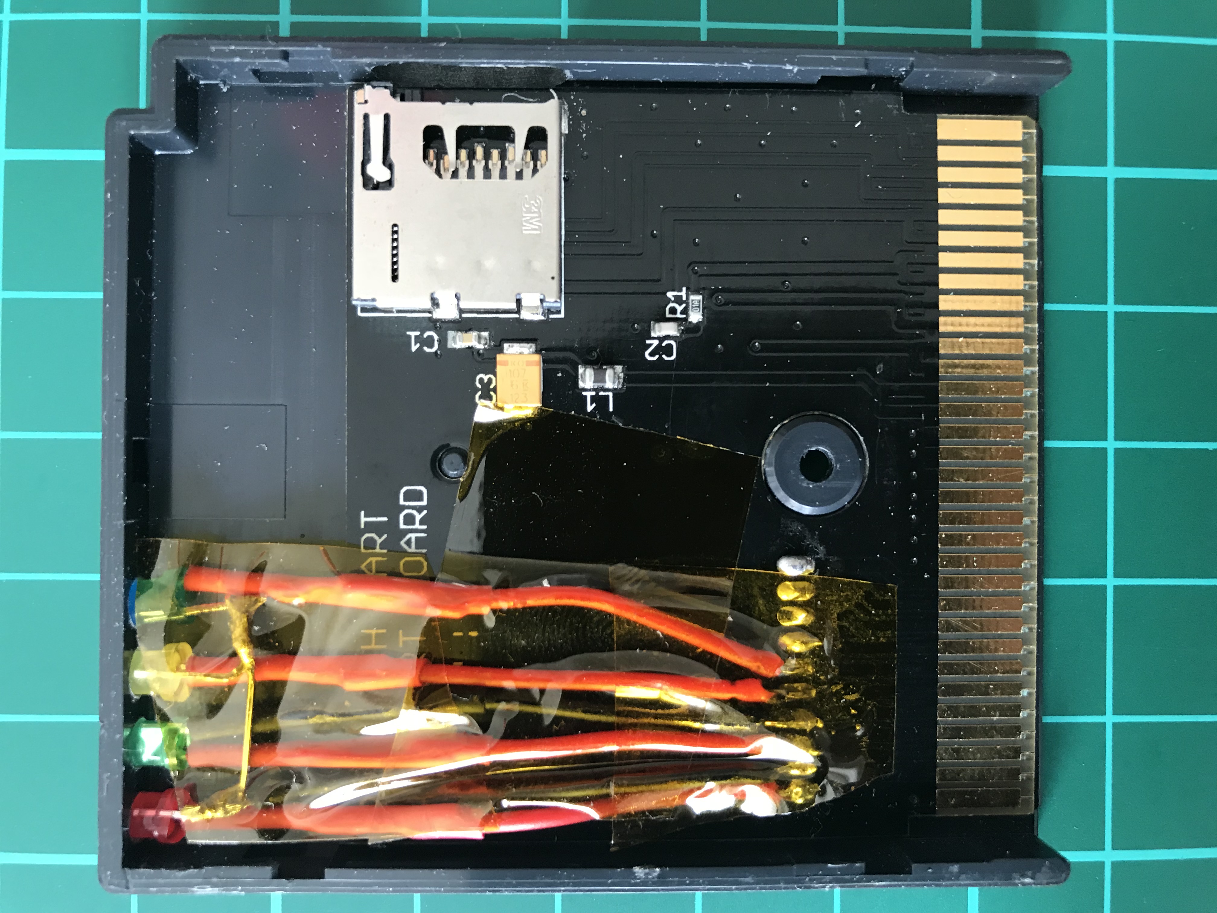

The ledsShow
This one was a try. I'm not satisfied by the result...
The cutout on the side is ugly because the pastique was so old that it was like dry sand as i was milling into it.
I've putted the LEDS too close to the shell and thus, i had to grind the font cover to let room for the first led.
The soldering is awful as i was using my old and not adjustable iron for this job (i was waiting for my kit from amazon)
I'm next going to try another thing... Transparent orange cartridge from Kitsch Bent with the snap off leds board from Kite's SAIO. This will give me a clean result and tiny beautiful LEDS.
You wonder why this as i have everything on the board yet ? Just for the challenge and the fun :mrgreen:
I also forgot to mention that Wifi/Power/Status have a common ground and Charge is independant.
You can see on my wiring that the frist 3 mentionned led have the groung leg soldered together. This allows you to free up some pads from Prs-Tech’s SD card reader

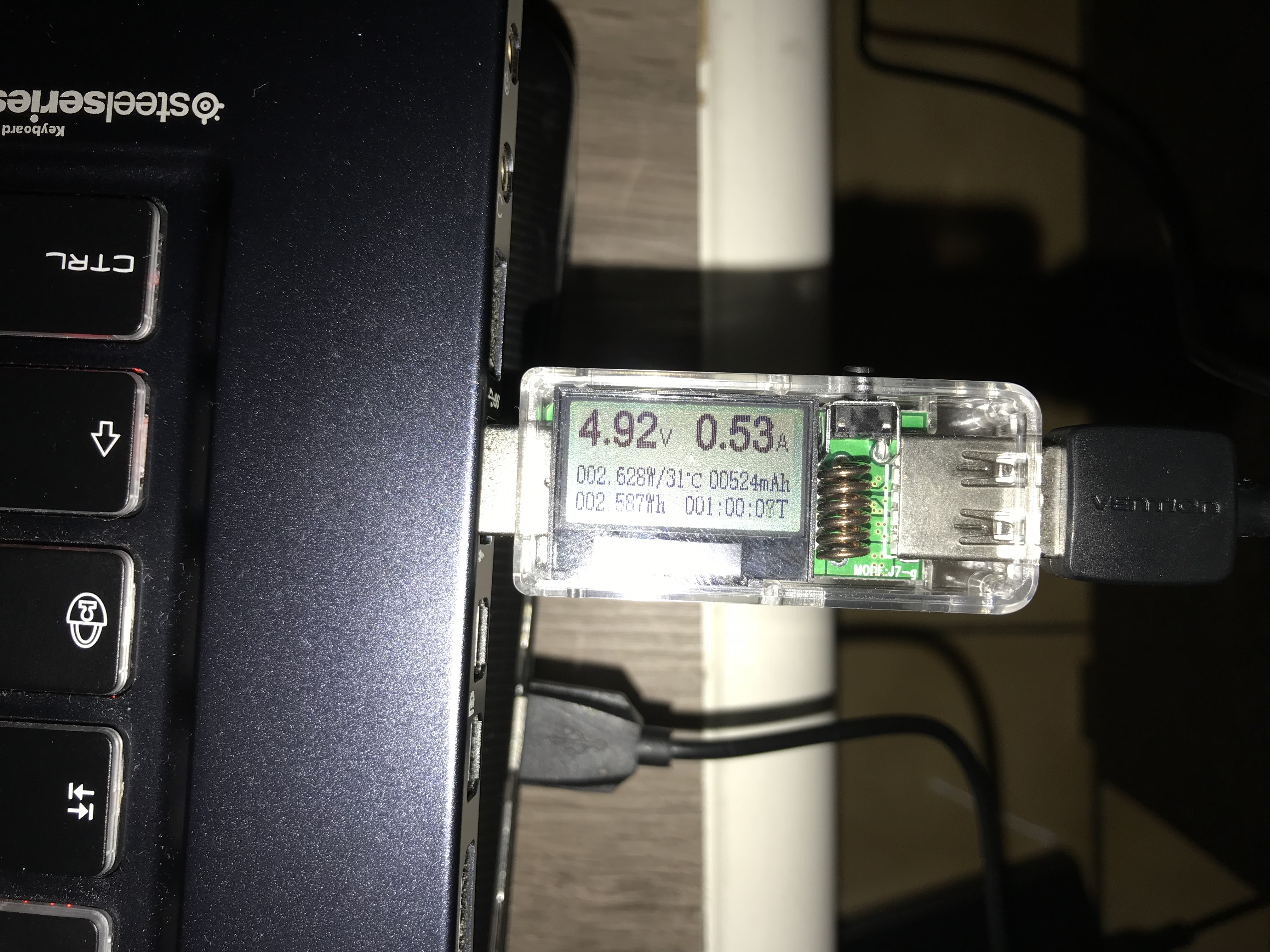

New power consumption test :mrgreen:
Testing conditions :
- brightness to max
- sound to max (speaker)
- wifi enabled
- fan always on
- overclocking
arm_freq=1000
gpu_freq=500
core_freq=500
sdram_freq=500
sdram_schmoo=0x02000020
over_voltage=2
sdram_over_voltage=2
Played Samurai Shodown 5 Special for 1 hour (lr-fbalpha)
Total consumption : 524mAh :D
This is really good.
I am really satisfied with the result.
So i can say that my play time will be between 11 hours and 9 hours :mrgreen:
If i take in count the battery effciency (which i cannot test for now) i should expect playtime of about 8 hours at full load.
