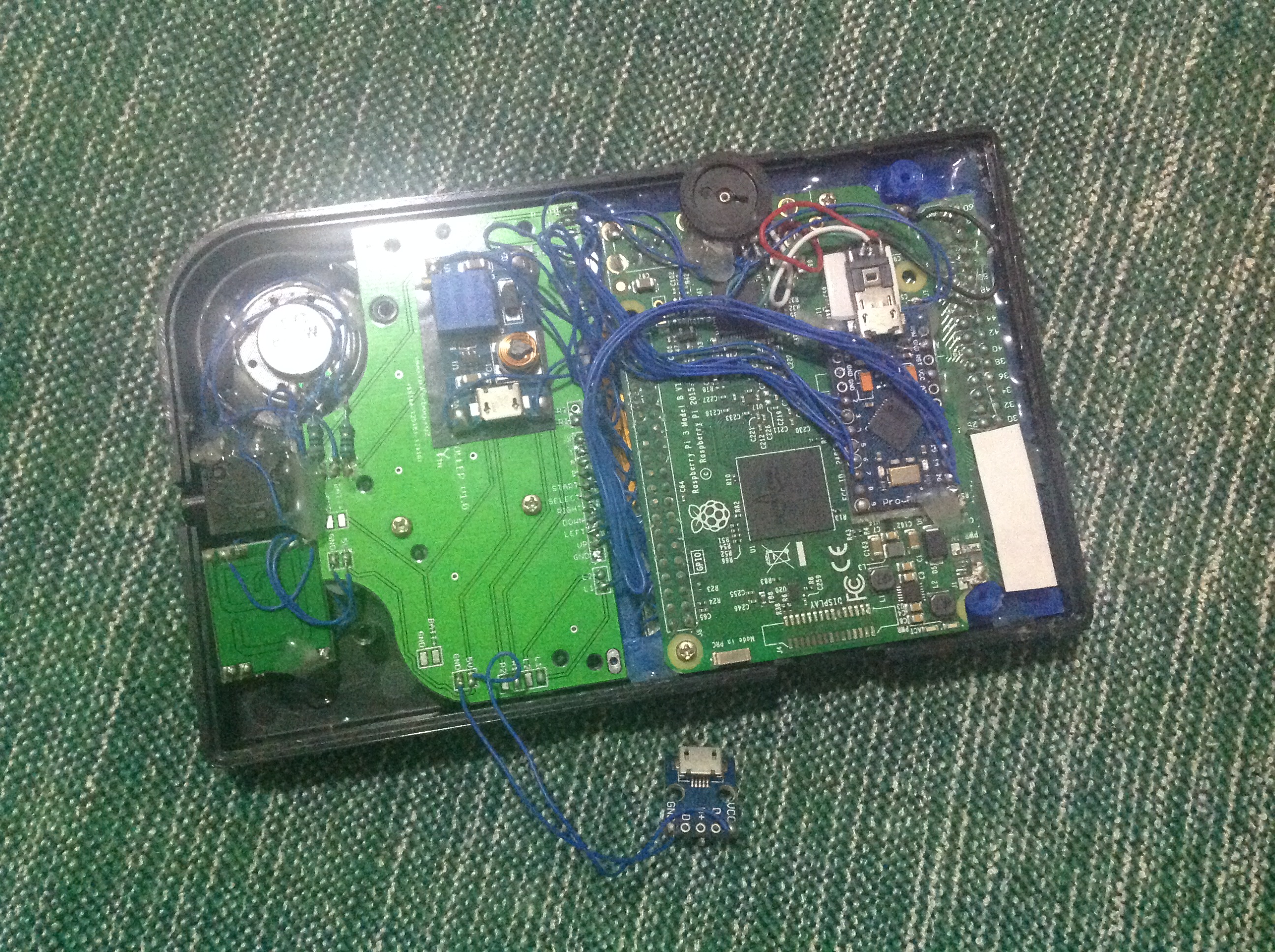

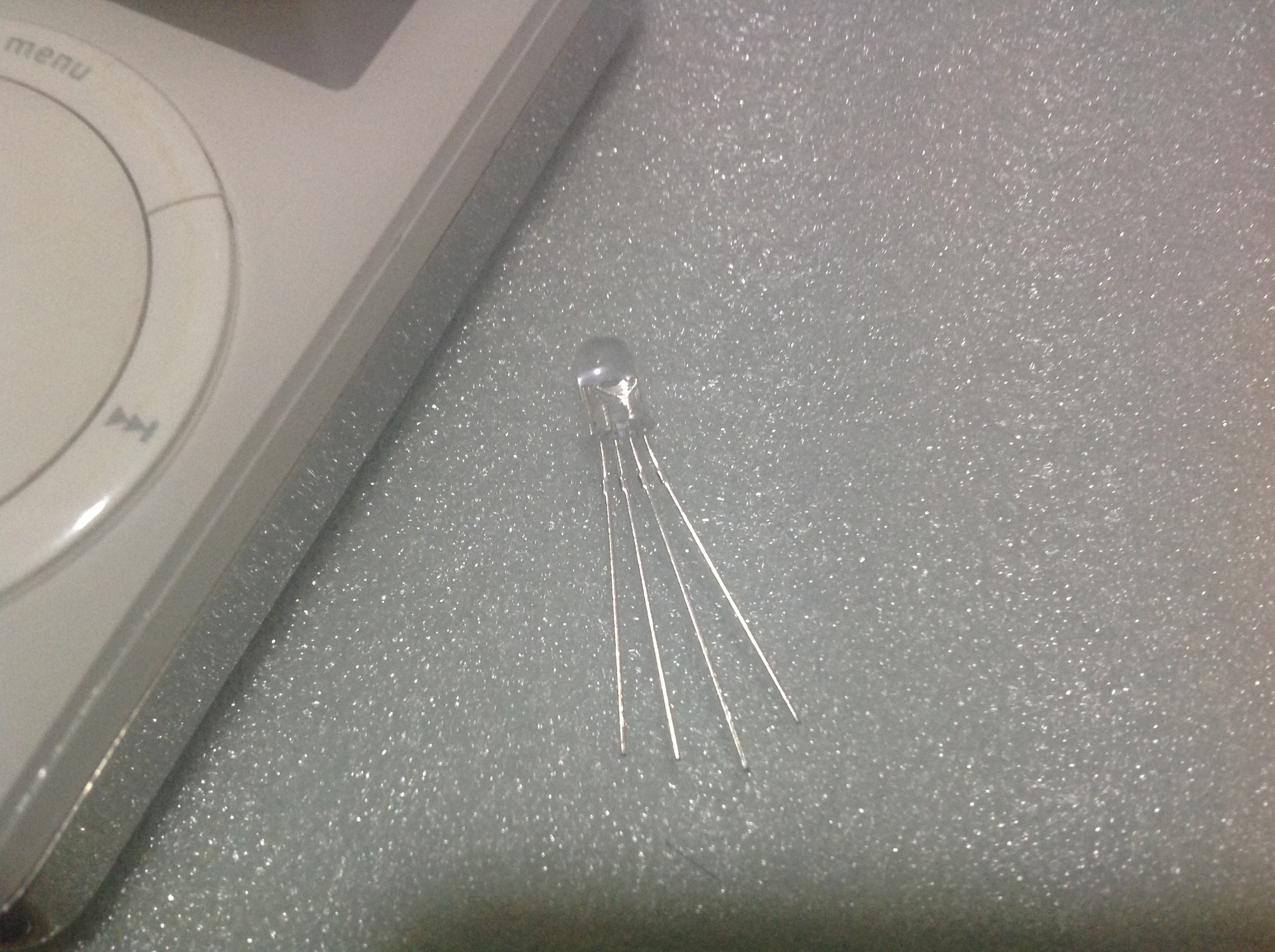

I think I'm done with the front half of the case. I can actually play with it now. Next will be the rear case for the battery, 5v boost, charger, l&r buttons, and the external USB port. Also I'm still figuring it out how to use a single RGB LED light for power on, charging, and low battery alert.
FrontShow
RGB LEDShow
