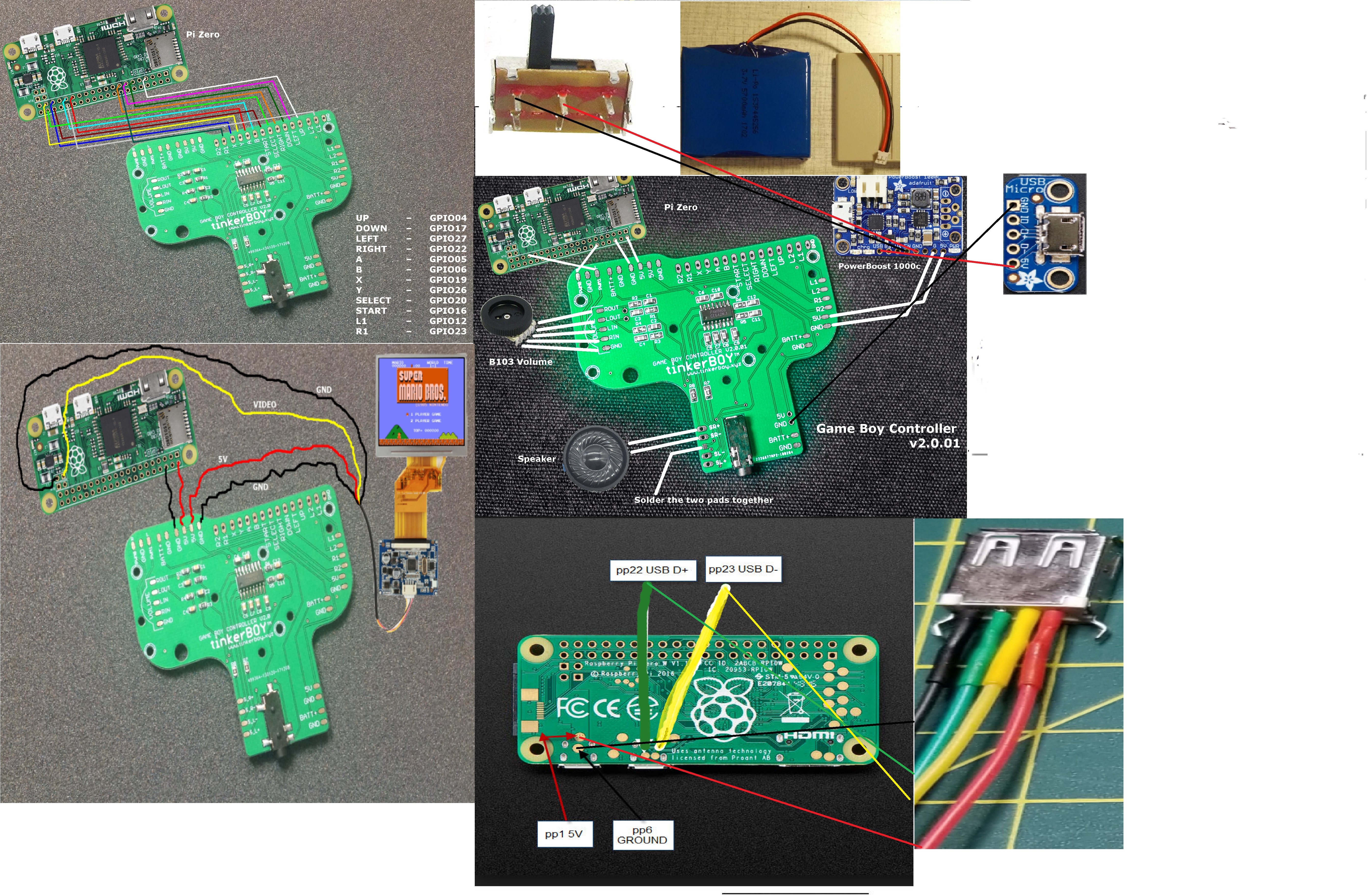

Ok I got some time to make outline of the wiring. So Im Kinda confused where would I solder the usb micro charging board, usb, and screen? Watched wermy build again and the usb board ground and 5v is taken by the pcb.
- GBCv2.1_wiring-1.jpg (3.6 MiB) Viewed 6332 times

Re: Do I have the right parts?
for the screen do this:
https://sudomod.com/forum/viewtopic.php?t=958
As for the micro usb port, if you are using the powerboost you will wire the bat pin to the postive pad on the micro usb, and a ground to the negative pad.
For the USB wire it to the pis test pads like this:
You can take power from anywhere, I have the test pads on the pi labelled, but I would use some of the 5V/GND points on the tinkeryBOY board instead.
test padsShow
I used yellow instead of whiteShow
Well after being gone for a while I'm back
I heard so many mixed things about the pi zero w. People saying it does not run mame or neo geo well. So I went out and bought one to see for my self. I am very impressed this little board kicks ass! It exceeding my expectations and re affirmed I want to go through with this project.
Here is the wiring diagram that I made. (Complied for the most part) Could someone actually look at it and tell me if something is wrong with it? Im going to be following this exactly the way I have it down.
Also from my understanding the power boost has LEDS on the board to show when it charging, low bat, and fully charged. I was wondering how do people hook up additional leds. This way I can visually see from the outside of the gameboy case what status of the battery is. Or is there any more convenient/easy ways to indicate battery life?
Thank You ahead of time
- gameboy zero wiring.jpg (5.76 MiB) Viewed 6109 times
I can't find anything wrong. Didn't check all the GPIOs for buttons but it's a compiled image so I'm assuming that's correct. Audio looks right, power looks OK. Ground to the charge port could go to the boost, no need to go all the way to the controller board for that.xxrob511 wrote: ↑Fri May 18, 2018 3:45 pmWell after being gone for a while I'm backI heard so many mixed things about the pi zero w. People saying it does not run mame or neo geo well. So I went out and bought one to see for my self. I am very impressed this little board kicks ass! It exceeding my expectations and re affirmed I want to go through with this project.
Thank You ahead of time![]()
Also might want to wire the power of that external USB port to a through hole on the Pi or to the controller board if you have a spare contact, it's easier IMHO. I also wired my screen's power to my pi, made wiring a little cleaner and was able to test it without the controller board but again, my opinion.
It's good to verify your battery polarity. Although I think the power boost should have protection for that, it's not a bad idea. My battery and boost were reversed.
Not sure about adding external status LEDs for that boost. Some boosts have options for external LEDs but I don't think the Adafruit does. With a safe shutdown board you could get low battery warnings via software and have the whole safe shutdown bit. Might be easiest to locate boost somewhere you can see LEDs on the board, like a clear cartridge case.
Good luck with your build and have fun!
