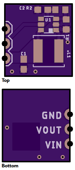

I tested the new capacitors, and though the voltage is much higher (2.5V), it's not the 5V I'm expecting. I'm going to test another battery before I order a redesigned PowerCastel. I suspect the battery might be bad because just the load of the PowerCastel drops its voltage to 0.7V.
The redesigned PowerCastel is slightly larger, but incorporates everything from the PowerBoost 1000C.

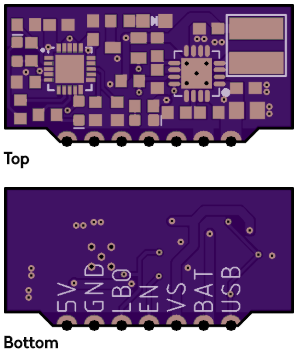

I've had success with the USB hub and audio amp. I have not had success with the PowerCastel v1 (and haven't tested v2) nor the 32u4Castel (because one of the ICSP pins was incorrectly mapped). I plan on revising these two designs and adding a BacklightCastel (for high voltage backlights).
Update: I have revised the 32u4Castel.

Post by Sushi » Sat Jan 12, 2019 3:52 pm
Just confirmed the new 32U4 module works flawlessly :D

Post by Sushi » Sun Jan 20, 2019 11:35 am
The new PowerCastel also works nicely. I'll update the git repo soon.
