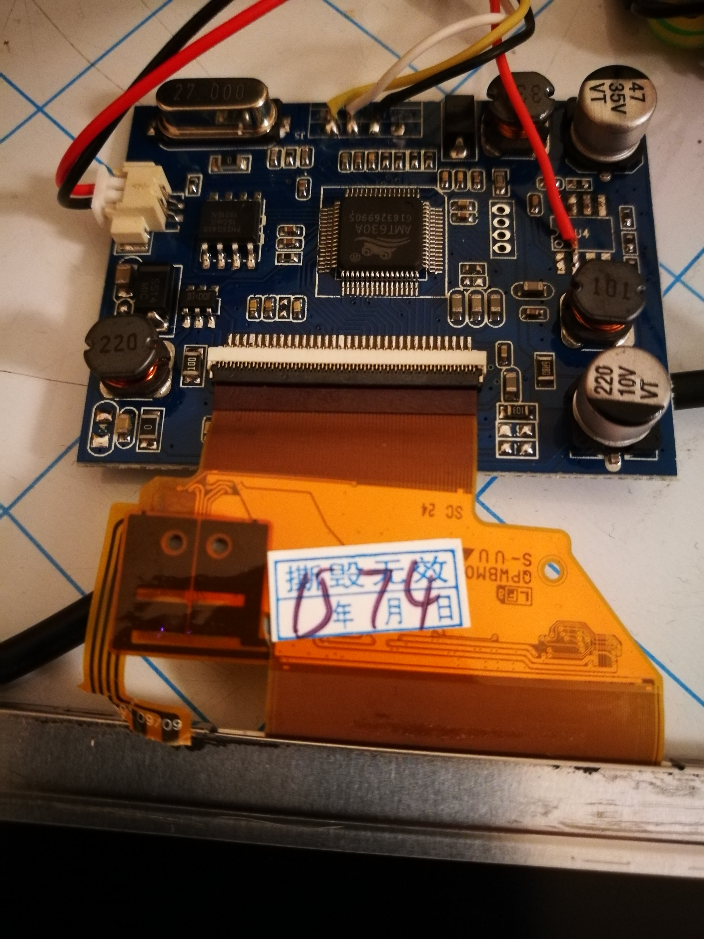

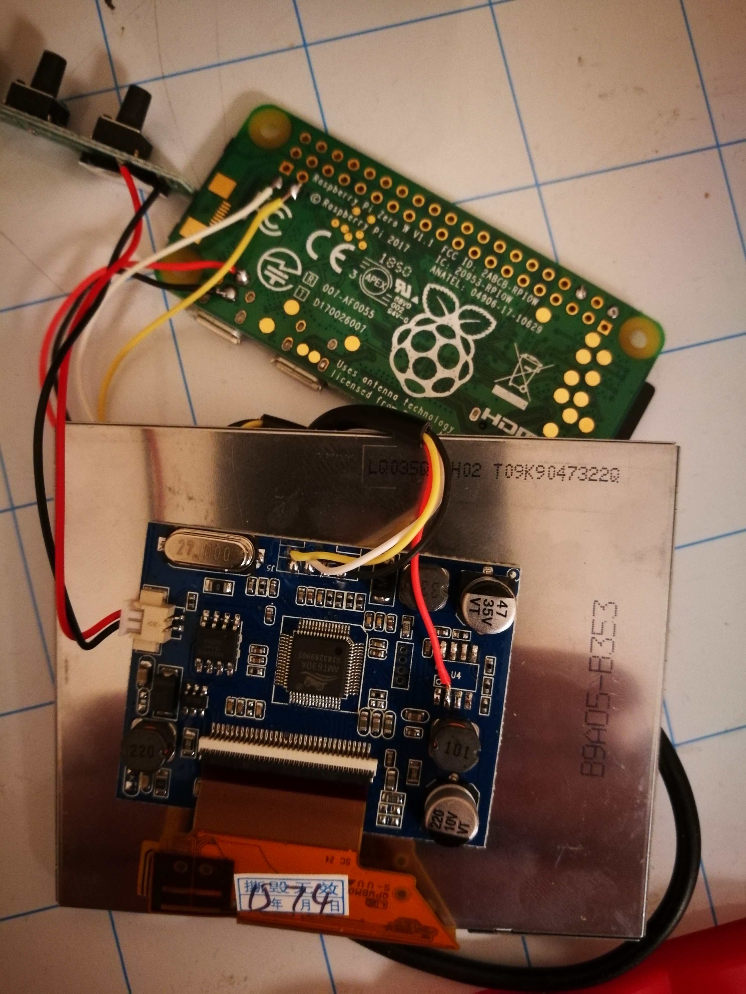

Hi everyone, I have a problem with the monitor, I connected it as a guide but it doesn't turn on. I doubt that the card that enters the monitor has broken, you can see in the second photo on the bottom left .. Can you give me some help? Should I get a new one?

Hi everyone, I have the same problem, connected the red wire to the pin after removed the 8pin, et connect it to the PI alimentation, the screen don't power on, I don't anderstand.
Maybe this is note the same board, iENA and me have a white wire for the 2nd channel, not green, any solution ?
