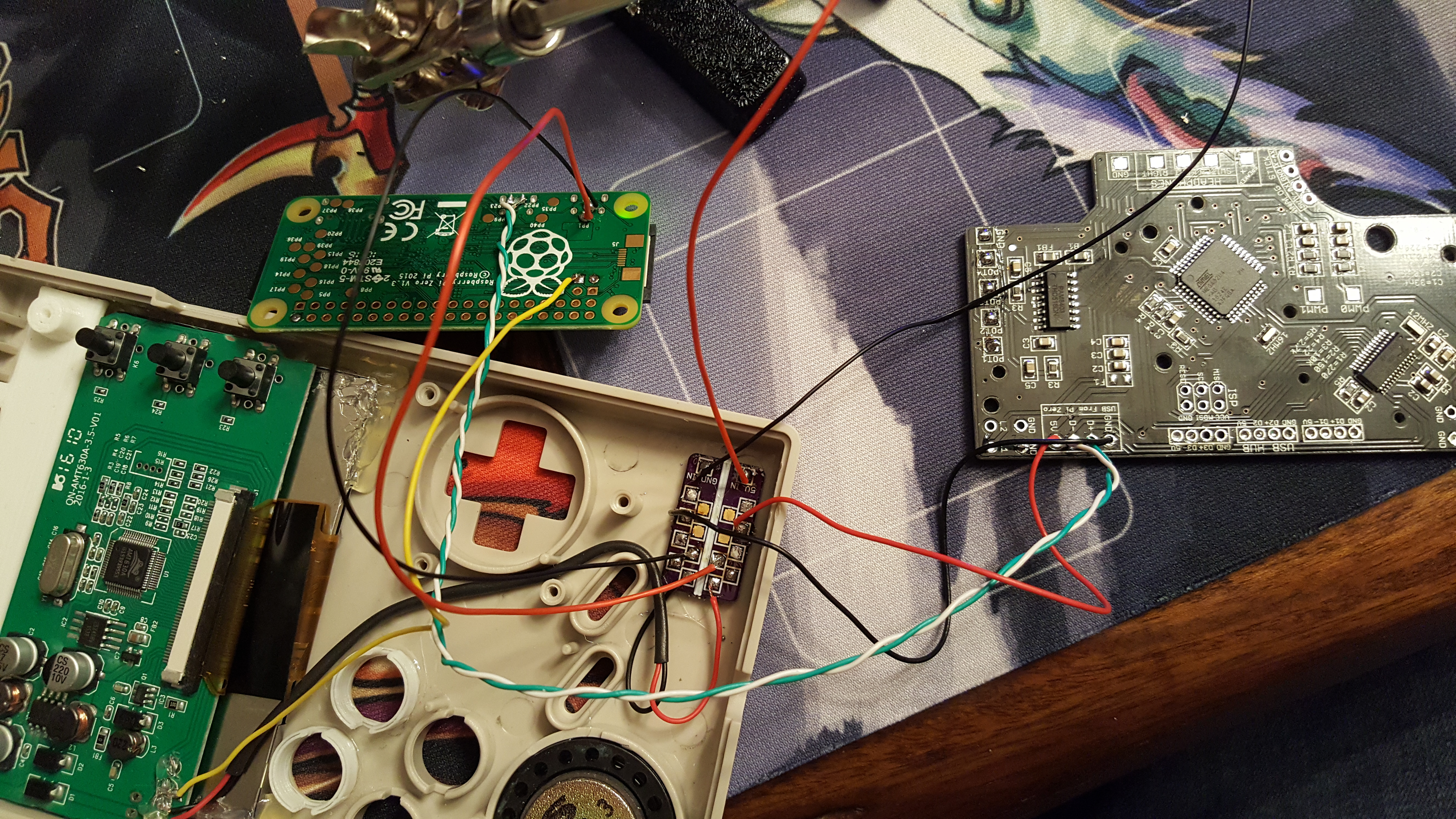

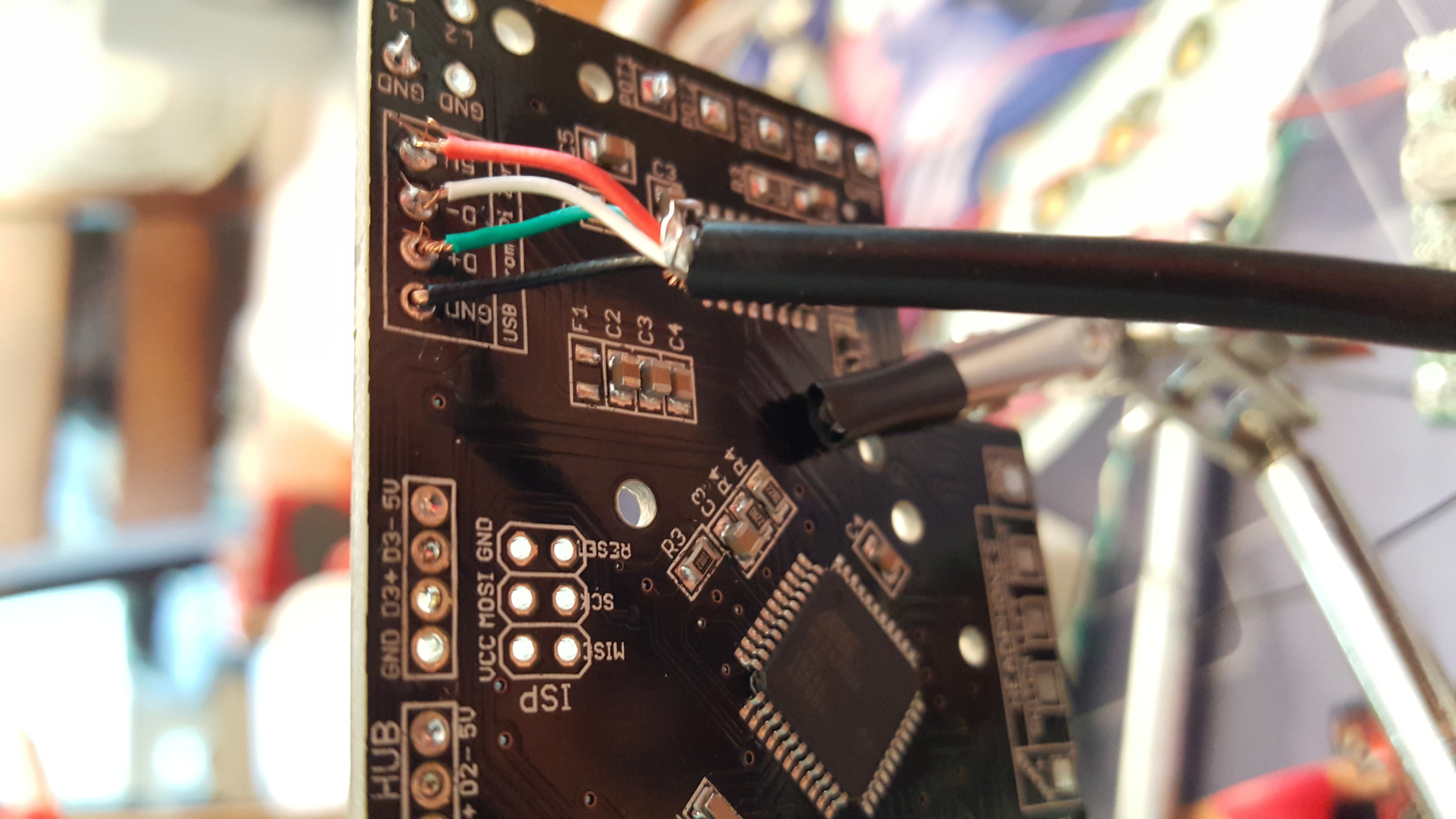

Are you sure you have it wired properly to the usb cable? post pictures please and you might have to reflow the hub chip or the 12MHz resonator if the hub isn't getting detected. Don't reflow anything yet until the wiring has been confirmed.Fiirikkusu wrote:Hello,
I purchased a 1.4 AIO board and I can't seem to get it to detect on my pi0. I have tried various ways of connecting it but it doesn't seem to be working. I also tried connecting to my PC via usb cable but it's not even detecting or even prompting me that I connected a usb device. Any help would be greatly appreciated. Thank you.

Hi! I've been waiting on a reply, I posted my wired up AIO with the screen and power PCB. I also uploaded a picture of the usb cable wired into the AIO to connect with my PC.

Too many quotes in the message I couldn't figure out what or who was asking for what. In your picture I don't see the USB data lines going to the Pi and I don't see how your screen is being powered either. How are you testing the audio? Are you connecting the Pi to an HDMI screen?

Sorry about that. So I connected my AIO to my project and I got 'No Gamepad detected'. I did all the solutions in the OP but none worked. I then wired it up to 2 different usb cables to get it to detect on my PC but neither worked. Also, my soldering is amateur at best but the power connections worked with the screen and pi0.Helder wrote:Too many quotes in the message I couldn't figure out what or who was asking for what. In your picture I don't see the USB data lines going to the Pi and I don't see how your screen is being powered either. How are you testing the audio? Are you connecting the Pi to an HDMI screen?

Is it just me or does it look like the fuse is missing on the board in the first picture?? I'd think that'd keep it from working...Fiirikkusu wrote:Sorry about that. So I connected my AIO to my project and I got 'No Gamepad detected'. I did all the solutions in the OP but none worked. I then wired it up to 2 different usb cables to get it to detect on my PC but neither worked. Also, my soldering is amateur at best but the power connections worked with the screen and pi0.Helder wrote:Too many quotes in the message I couldn't figure out what or who was asking for what. In your picture I don't see the USB data lines going to the Pi and I don't see how your screen is being powered either. How are you testing the audio? Are you connecting the Pi to an HDMI screen?
Yep. It's missing in both pictures.
Would help to braid and tin your wires before soldering also.

Great observations! Just simply bridge the pads with some solder and that will resolve the issue.HoolyHoo wrote:Yep. It's missing in both pictures.Would help to braid and tin your wires before soldering also.
