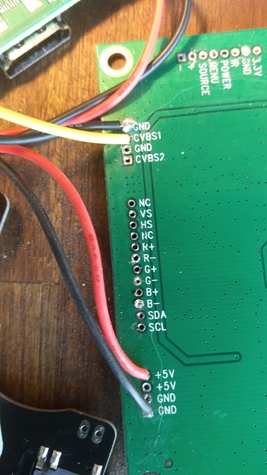

I wired everything - screen black. Pi boots normal.
Wired the button board for screen on the vga board -> Led on but screen still black.
Tired to change source but the screen just does not power on. The VGA Board has 5V and on the Controller Board for the Screen the 3,3V are also there.
We tried everything but it just does not cause any reaction by the screen. Any ideas?
Did you test the screen before wiring this way? Did you test with 12V and 5V? I have not used this screen with a pi 3 before, so I am not sure the exact test pad to use for video. Make sure you are using the right one. Also, you need to have a properly imaged SD card for anything to display. I see an SD card in there so I assume it's good.
You'll also use 5v not 3.3v. And make sure the ribbon cable is inserted properly. If you did not test and confirm it was working before hand, we have no way to tell if it ever worked in the first place. It may just be a bad screen that did not work from the start.
Also, FYI, the buttons board is not required to turn on the screen, once it detects a signal it should turn on.
You can also change the yellow wire to CVBS2 and see if it makes a difference.

Hi thanks for your answer!
Nope we could not test the screen before.
The 3,3 V are to the button board of the screen.
5V are on the VGA Board as shown on the board (attachment).
What do you mean with test pad?
The Image on Raspi works (tested with hdmi).
Also inserted display_mode=3 for testing in config.txt... But does not change anything
We pluged the ribbon cable more than once - but there is only one way it goes in (if you look at it) and should be ok.
Sorry totally newbie :)

By test pad. I mean the solder point on the pi 3. You have the yellow wire soldered to the pi. Make sure that is the correct spot.
Re: Full VGA resolution (640x480) 3.5" display, composite in
Post by rodocop » Tue Jun 25, 2019 11:25 am
It should be pp24. And from your picture it seems that is where you have it wired....hmmm....
