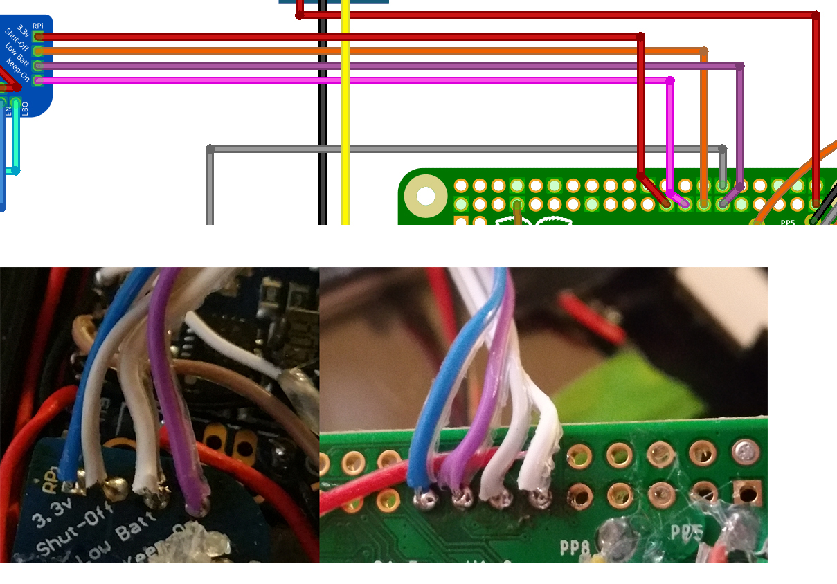

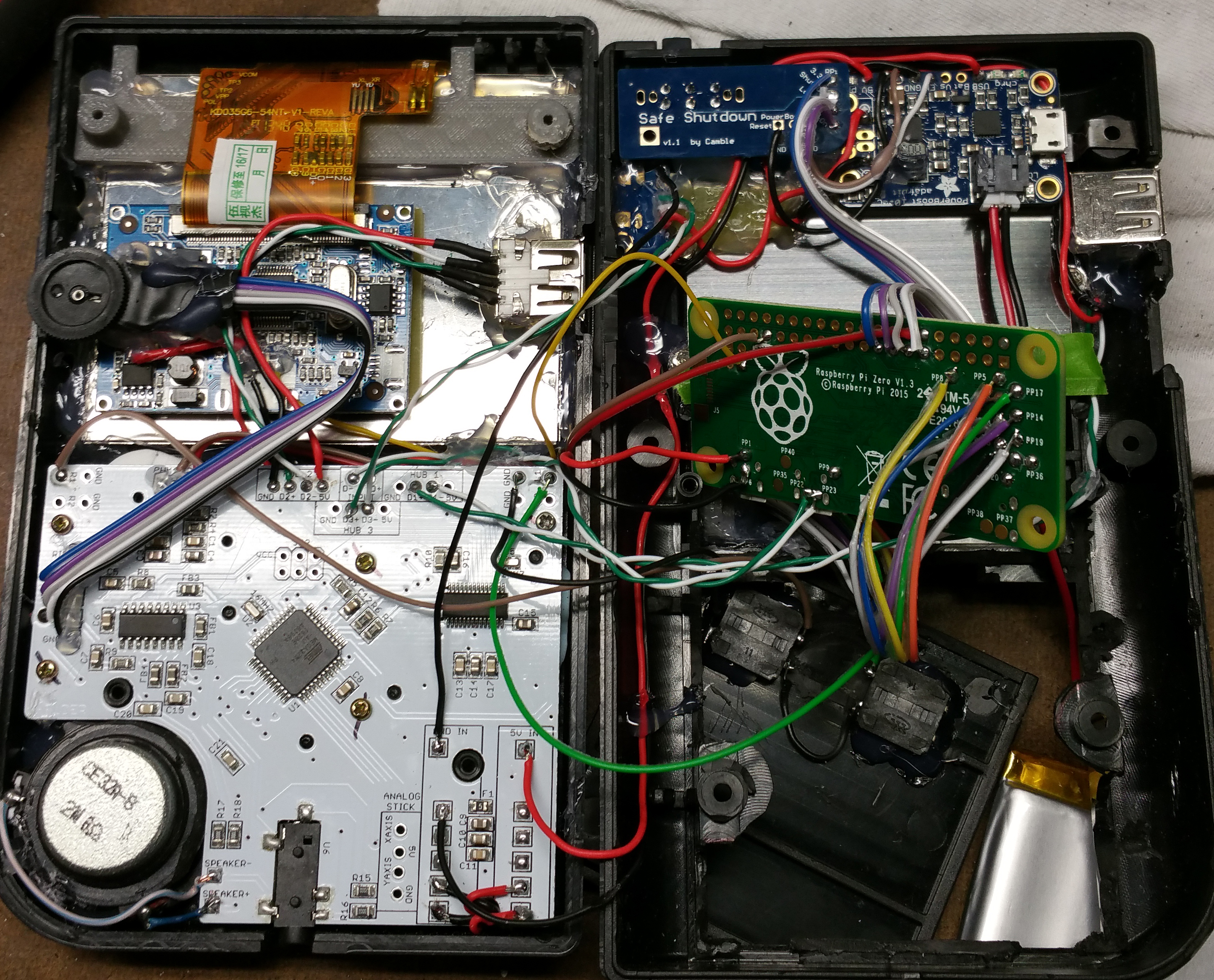

Could it be that my somehow my wiring is simulating this? I took a look at this diagram to see if I routed the cables any different way. And I think the only thing that's different is that I have my Gear Best screen's 5v going directly to the 5V powerstrip, as opposed to the GPIO pin they have shown.
Also below is my wiring. Probably hard to figure out which cable goes to which end when it goes under the Shutdown switch, but they go to where the diagram says they are suppose to.
But see anything else that looks out of place? I've added the reset switch since this photo. And it still works fine.
http://i.imgur.com/jJddqdg.png

@WoodMill It looks like you have GPIO17 and GPIO27 swapped. I could be wrong, since the wires are similar colours, but it looks like you have low battery to GPIO27 and shutdown to GPIO17

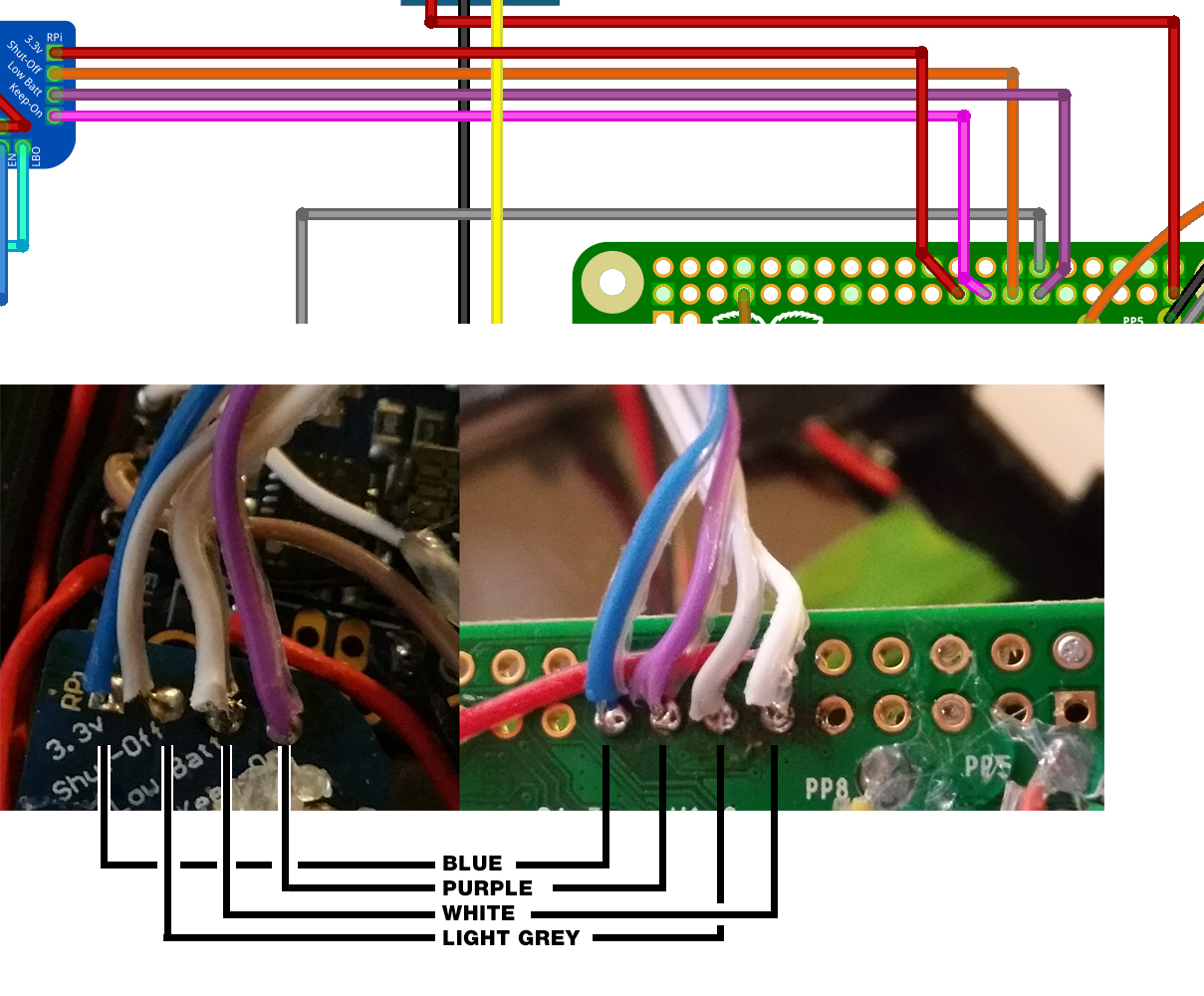

Ive got it wired like the diagram says. Is it wrong?

@WoodMill I really can't tell from your photographs. You have a white wire and a light grey wire. I'd just double check them to be sure.

Yeah, sorry. Here's an image with the colors called out. To me, they go along with the diagram, unless I'm overlooking something.
