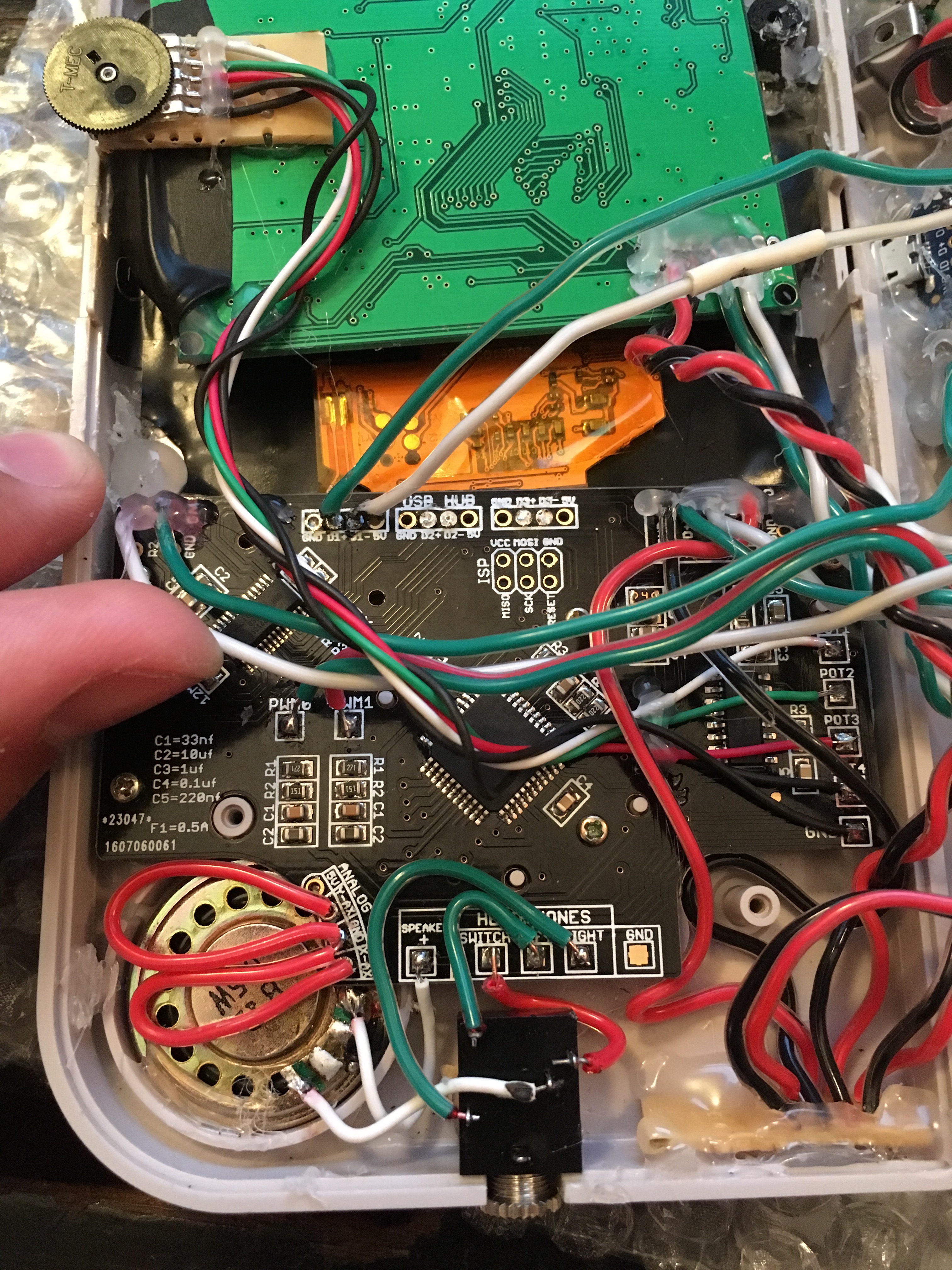

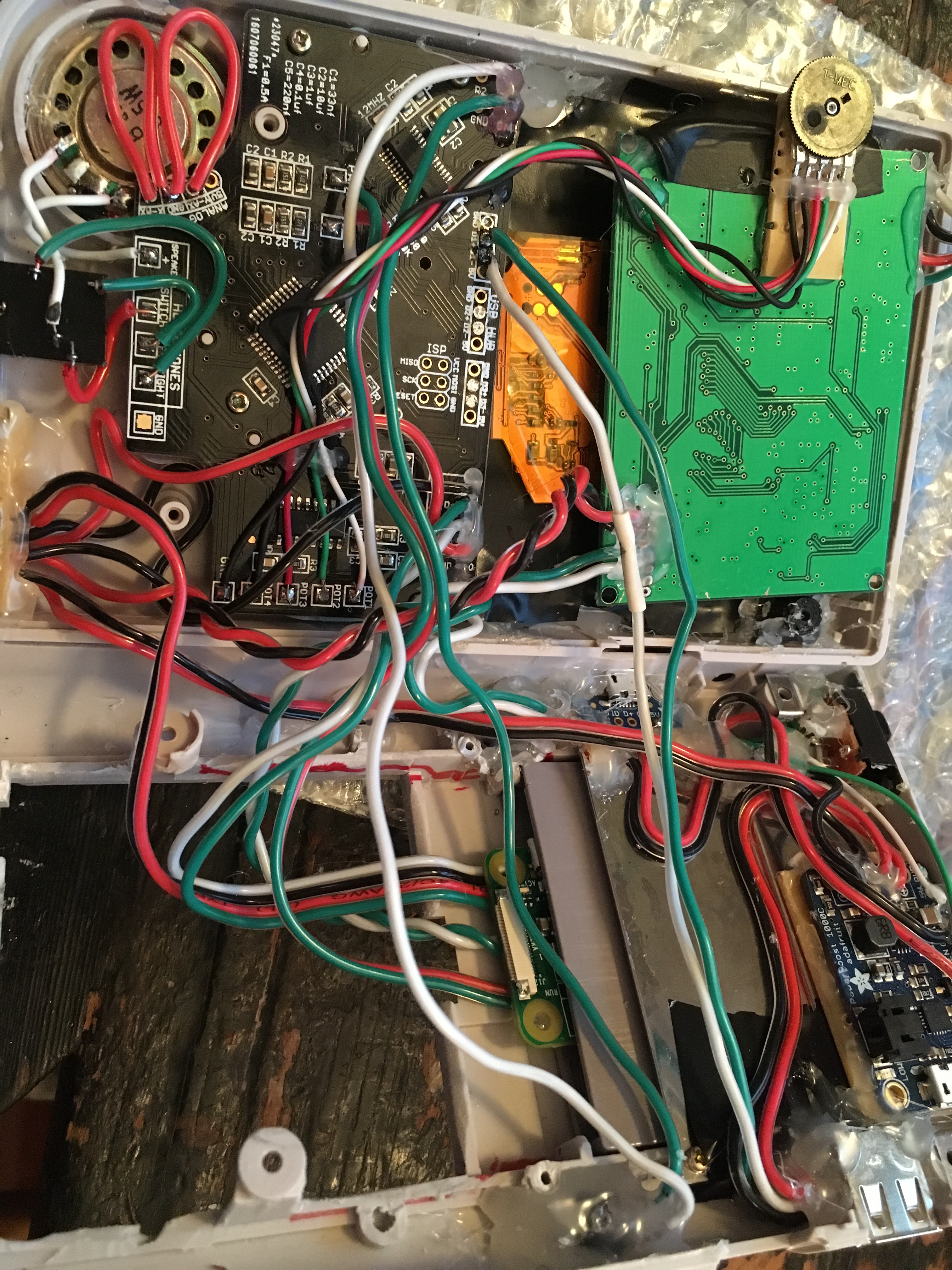

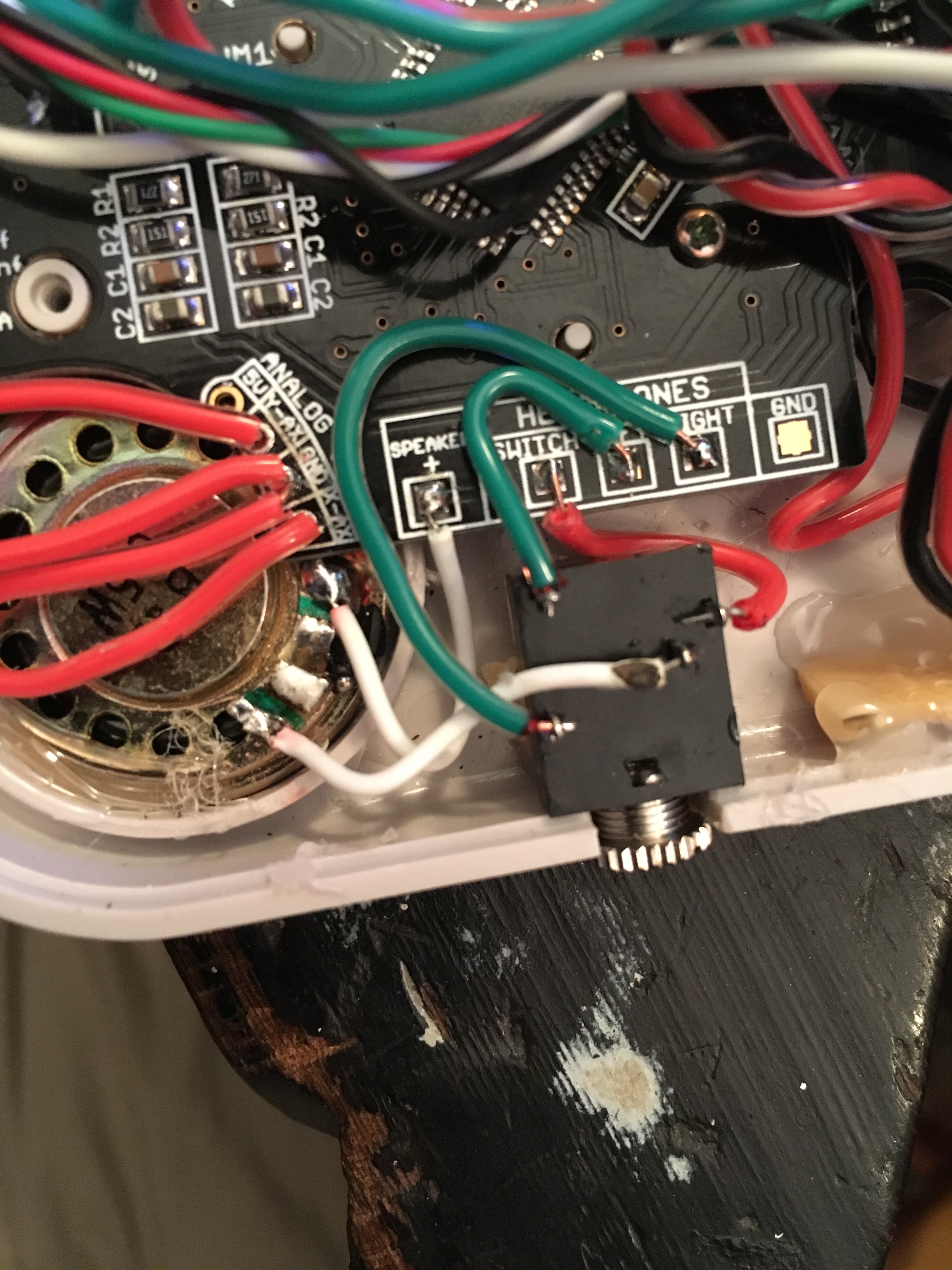

Alright, heres my clusterf**k - Boots up, screen works. Game loads. Usb port powers up, not reading at the moment but i think its because my usb is not formatted correctly. Controls work some of the time (no i didnt reprogram it because im using a mac and arduino for the first time so i dont know what the hell im doing). Anyway, controls sometimes, get no sound from speaker but do get static from the headphones. Both ears. Pot seems to work but hard to tell since no game sound. Not sure what im missing here.

I think you need to ground the headphone socket or rewire it, I'm not familiar in wiring that particular socket. Also I think you have the black wire on the pot going to GND swapped with the POT4 point, hard to tell with all the wires and both are the same color.
Also follow the link for Support in my signature.
