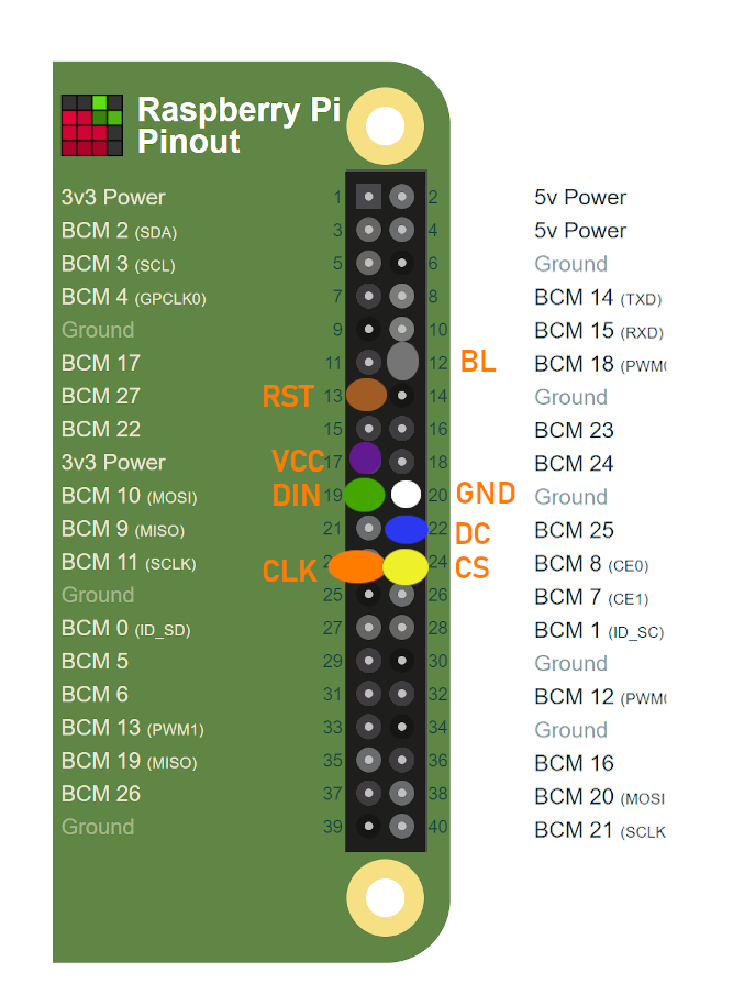

this is how i was able to get the same screen with the waveshare board working with the juj driver...
## get the library...
git clone https://github.com/juj/fbcp-ili9341.git
## make the build dir
cd fbcp-ili9341; mkdir build; cd build
## set driver options
cmake -DSPI_BUS_CLOCK_DIVISOR=6 -DGPIO_TFT_DATA_CONTROL=25 -DGPIO_TFT_RESET_PIN=27 -DGPIO_TFT_BACKLIGHT=18 -DSTATISTICS=0 -DBACKLIGHT_CONTROL=ON -DUSE_DMA_TRANSFERS=OFF -DST7789=ON ..
## compile the driver
make -j
### then you will need to add to start up
sudo nano /etc/rc.local
## add, before exit 0:
/home/pi/fbcp-ili9341/build/fbcp-ili9341 &
and i think you will want to add this to /boot/config.txt:
## Display
hdmi_group=2
hdmi_mode=87
hdmi_cvt=240 240 60 1 0 0 1
hdmi_force_hotplug=1
ignore_lcd=1
framebuffer_width=240
framebuffer_height=240

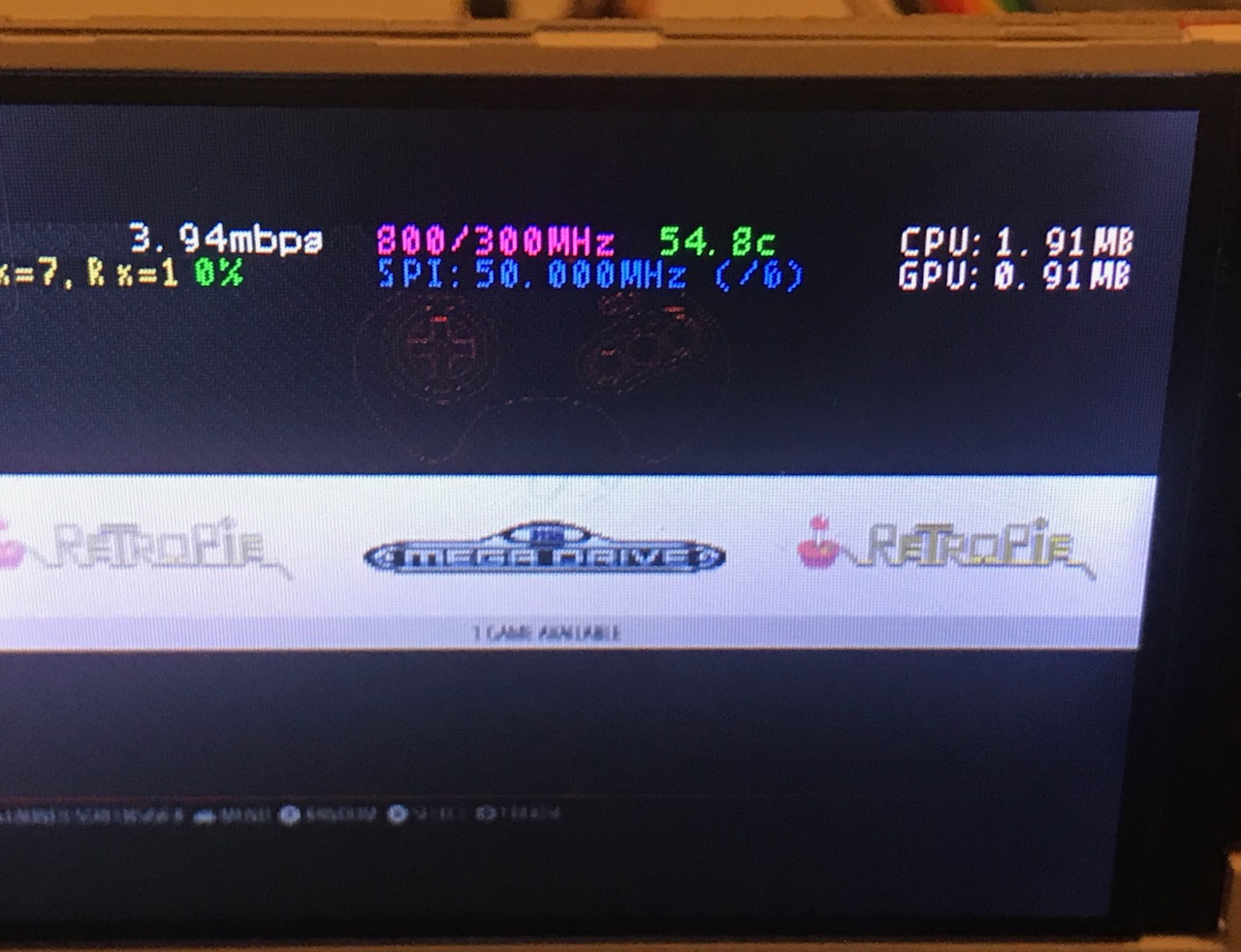

Hi There
I bought a generic lcd ili9341, its a generic one of Ebay 240x320 LCD Panel 2.8 V1.2 SPI Serial Port Module w/ PCB ILI9341.
I can't seem to make retropie full screen or any of the emulator ie Sonic on the mega drive emulator and I was wondering if any one
can help me.
also how do I switch the details on the screen off
thanks
