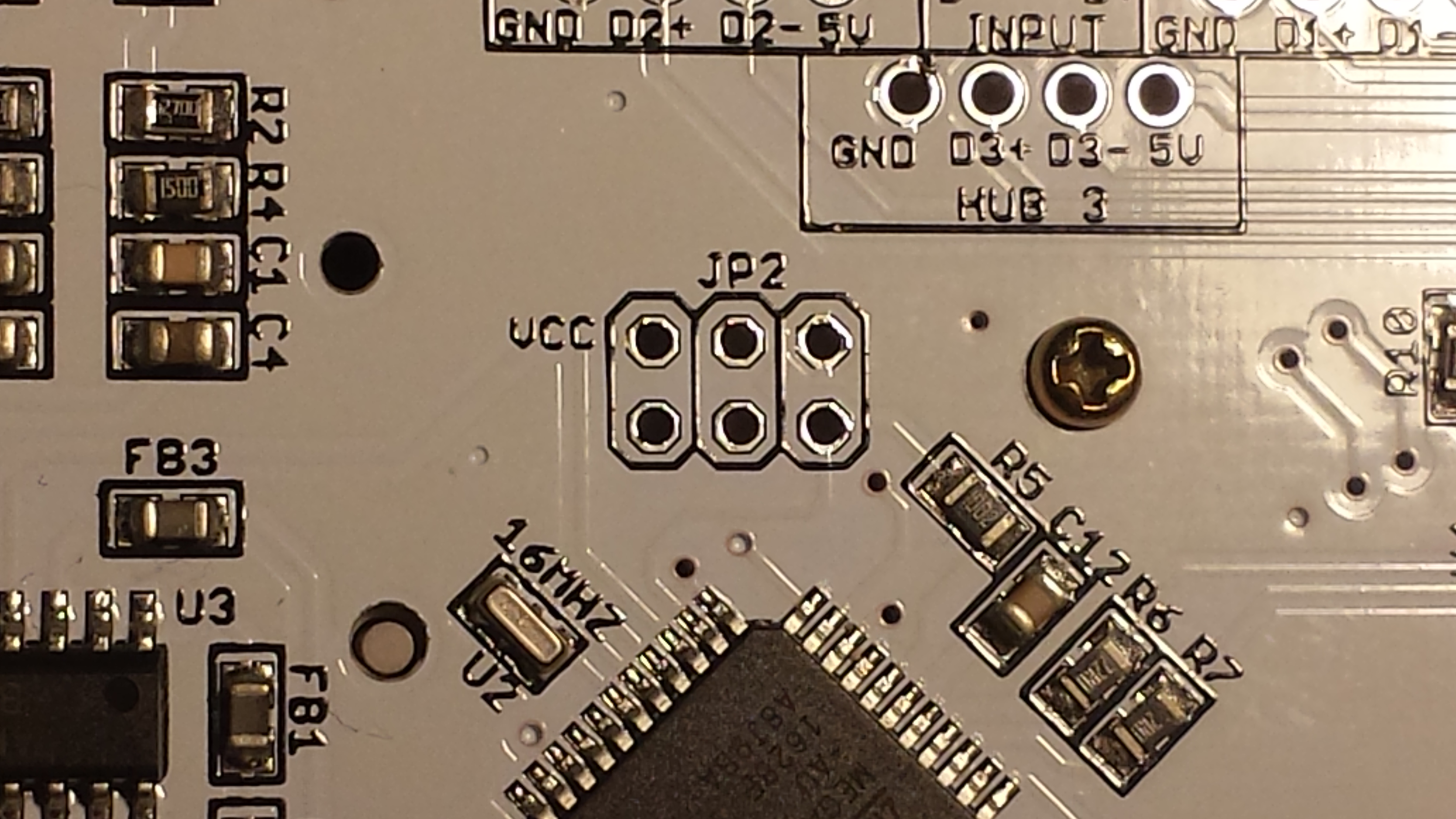

What is this for?
VCC JP2

Post by rdazjeff » Sat Nov 12, 2016 8:12 am
Dukana wrote:What is this for? 1478960224132-1004085764.jpg
Program the Atmega !
