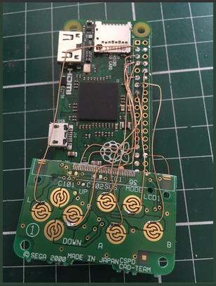

Hello all! I now have everything I need to build this. Its been a dream since 99 to have a gameboy inside a vmu. I first tried to do this a year ago by cramming a watch phone inside but I could never get the controls to work. I then saw your youtube vid satri360 and have since been buying what is needed. My problem is I am kinda of a noob at this. Mostly software related. So any help with the code that is needed to get this working would be amazing. I think I have the video figured out but for sound I have no clue. My soldering skills are also not the best. Been practicing your guide abrugsch.

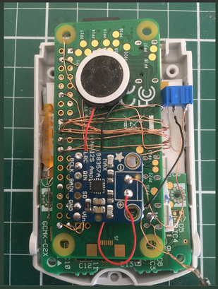

I found this https://www.youtube.com/watch?v=WpAbeKMVBFE and on their twitter these pics. Really wish I new what screen was used.
So I bought the sound card from these pics. I have no clue how to do the software but the wiring looks easy enough.

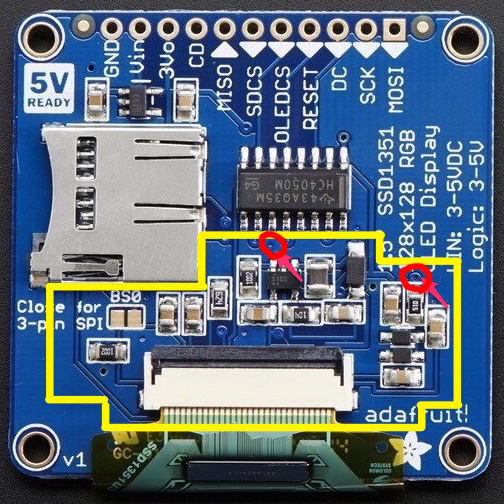

On this
How did you solder this without it spilling over? can I use something as like dividers? Its so damn small. :shock:

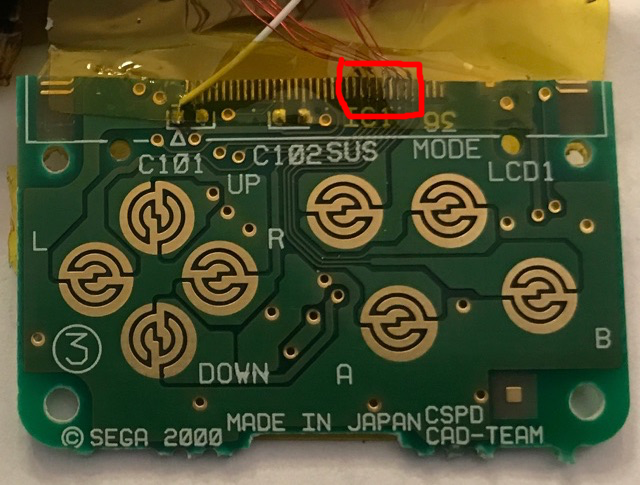

And here
Is what I have circled what you mean?
Lots of flux, fine wires and a fine soldering tip...
You can also use the vias (the small holes in the pcb linking traces from one side to the other)

The screen is actually an adafruit one https://www.adafruit.com/product/1431 the yellow box is showing how much of the pcb he left remaining, and the red dots show some of the places he attached wires
I am not sure what he is using but assume one of the 1.44" 128x128 ILI9163 just based on the white stiffener of the LCD.
You can follow the complete instruction from the Adafruit to enable the I2S Audio.
https://learn.adafruit.com/adafruit-max ... y-pi-usage
I use flux, decent solder iron tips and the Nikon SMZ - stereo microscope. This helps a lot when you solder narrow pitch components like 0.5mm. We might not need this for wiring the VMU I/Os but definitely good for the OLED board. It could a bit pricy to get the best quality of image but an affordable one would be still sufficient for home soldering :).

And here
These spots are marked to attract some attentions when they cut the PCB.
Middle - GND via connecting top and bottom layer. Don't lose it or you have to wire them like I did. Yeah I busted and took me an hour to fix.
Right - VSL (segment voltage reference) via.
