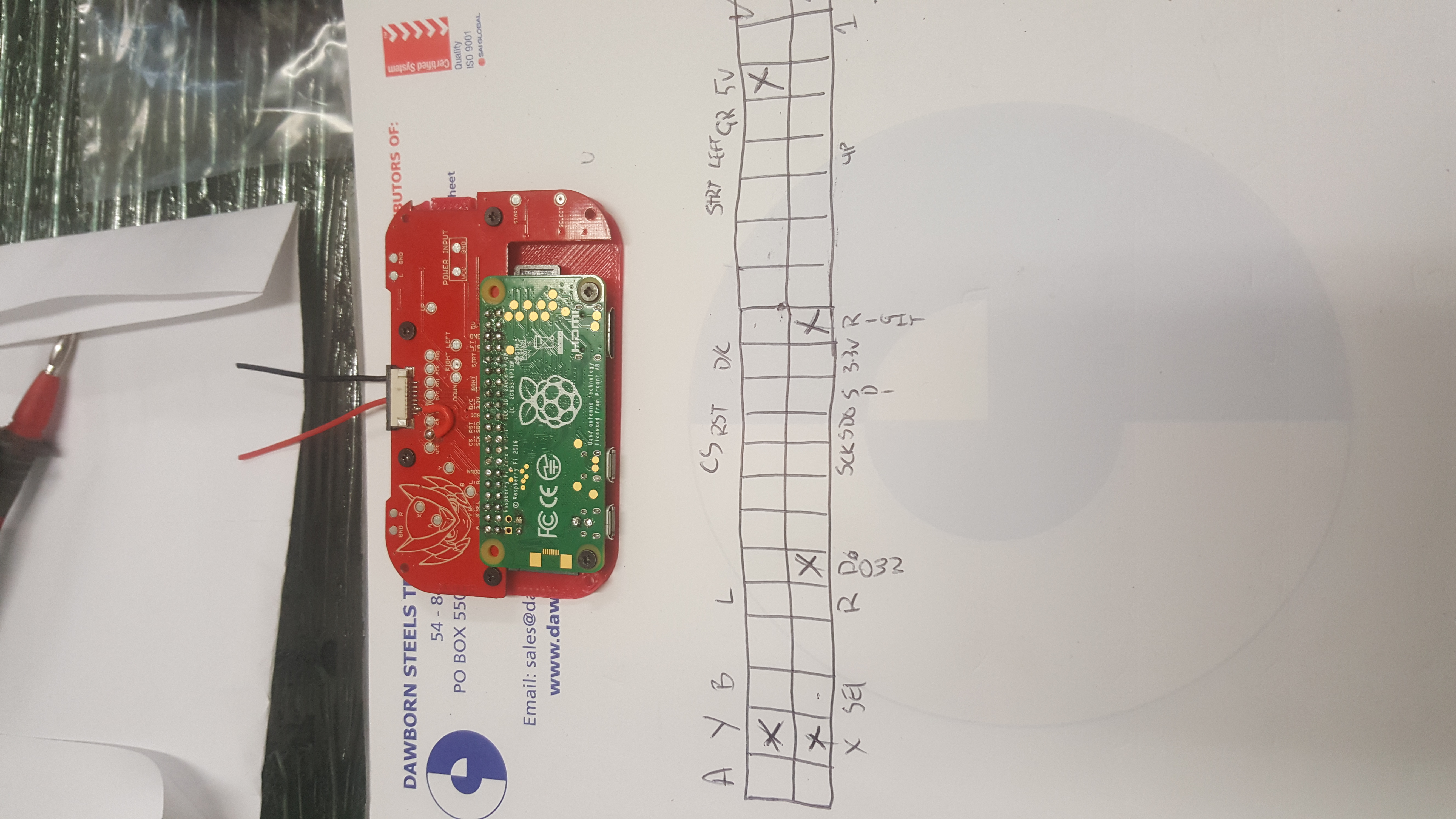

So once i fix this if i have my ribbon alligned properly i should be good to go? X marks bad connections

That's the logic - based on your diagram, only the 5V 'X' will stop the screen displaying :D
Difficulty I've found is that once you get a bad connection there is a fine line between fixing this and bridging a pad.

Ok so i fixed all loints and have continuity between everyting.. but when i pluf in a power source to test i get a reading from 5v gpio on the pi to the vcc input anf the input ground. Is that meant to happen?
