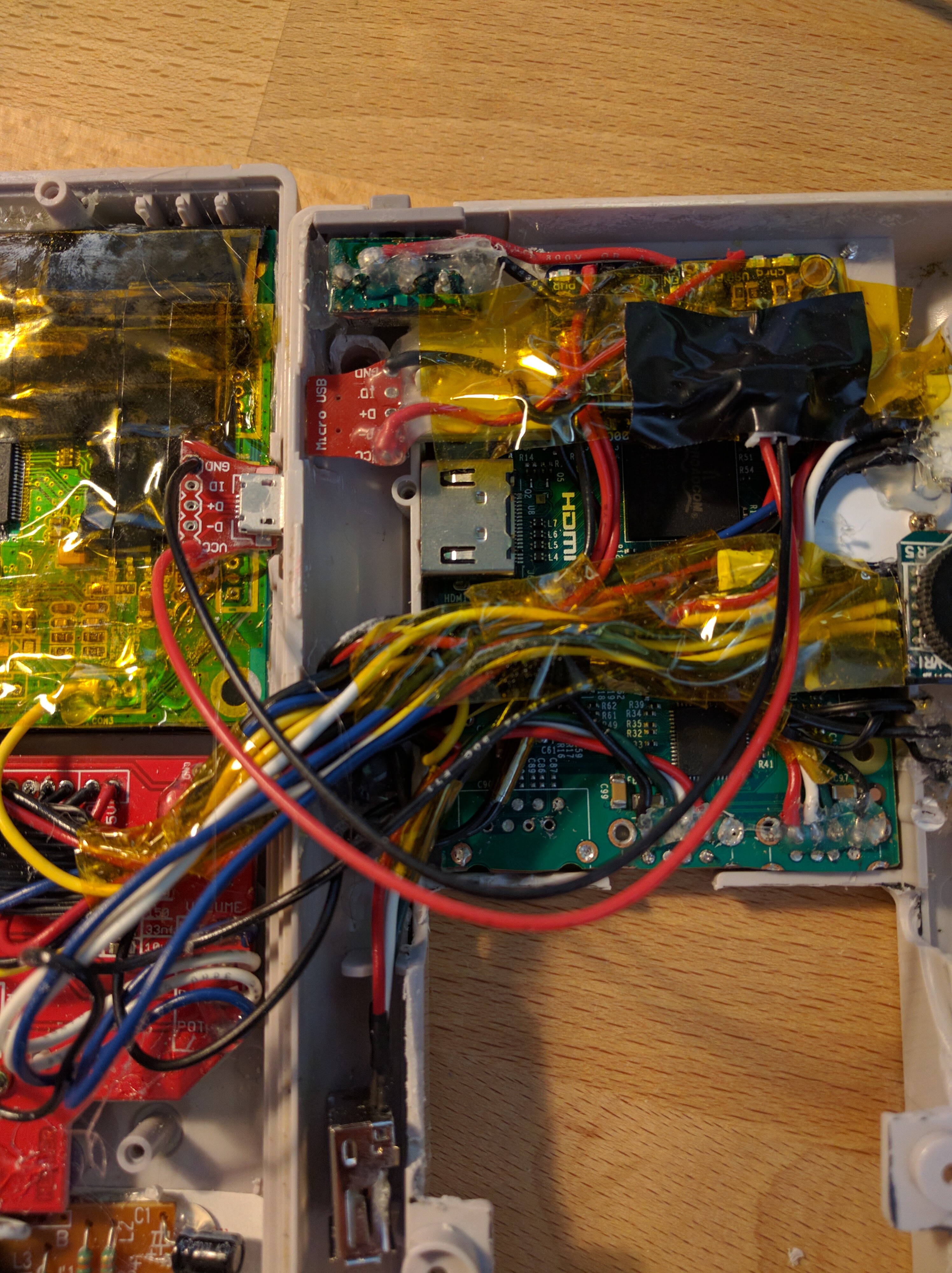

Looks like it works pretty will this way. I had an extra port.
[spoiler="Connected micro usb to PINs"]
[/spoiler]

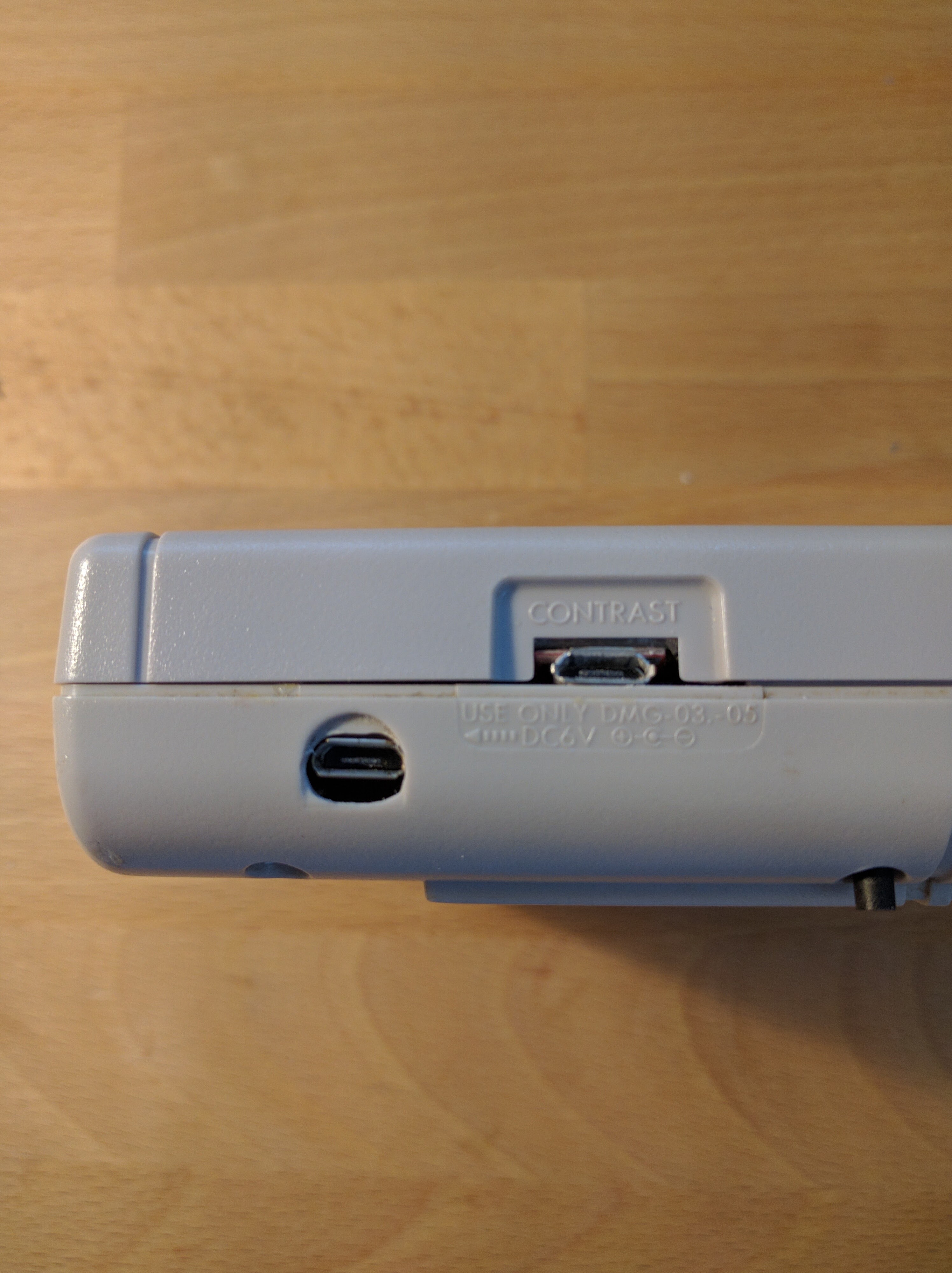

[spoiler="Had to sand down the front as much as I could to get it to fit with case"]
[/spoiler]
[spoiler="Connected to the Powerboost"]
[/spoiler]

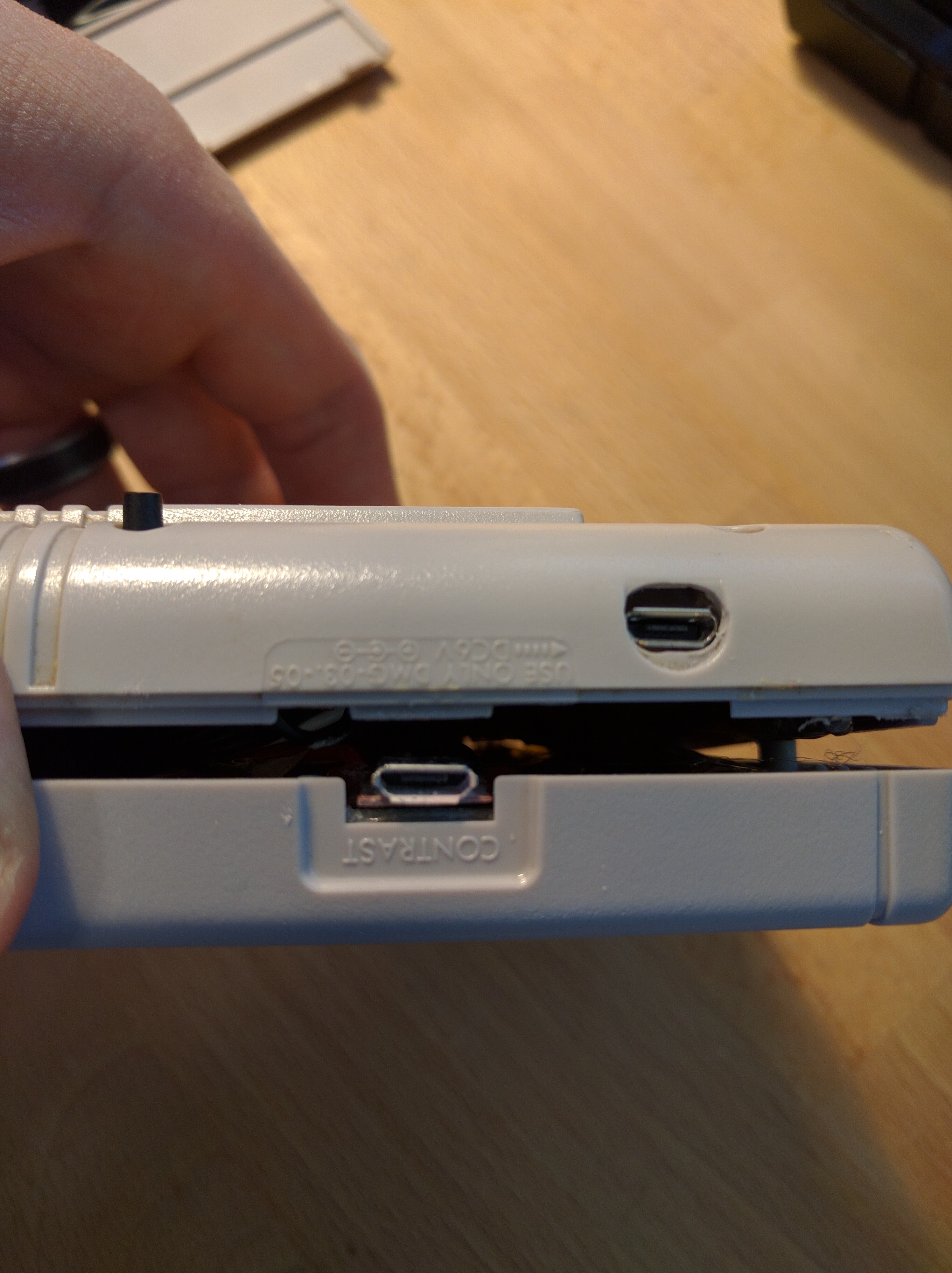

[spoiler="Looks like it is a tight squeeze"]
[/spoiler]
[spoiler="I removed the little plastic part with a knife, closed good now"]
[/spoiler]

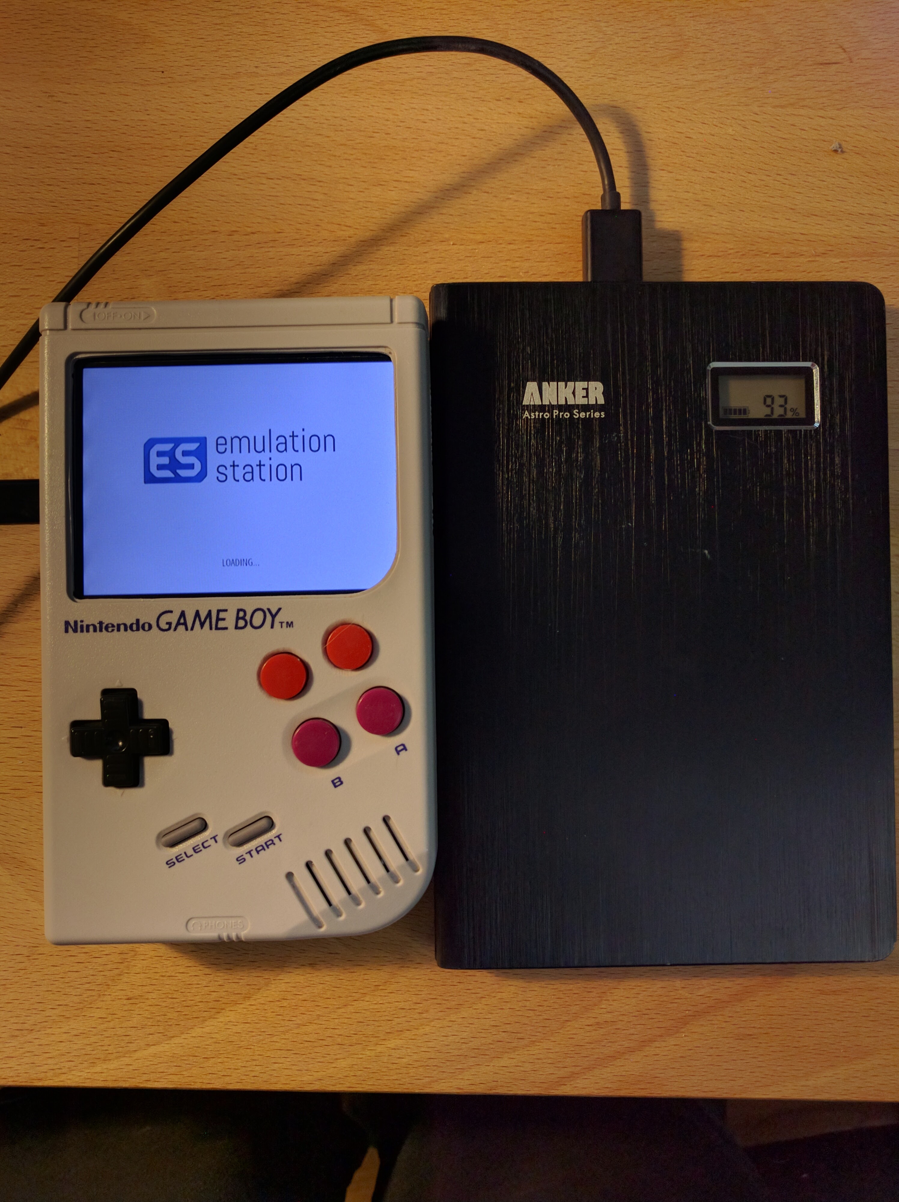

[spoiler="success with the power bank"]
[/spoiler]
