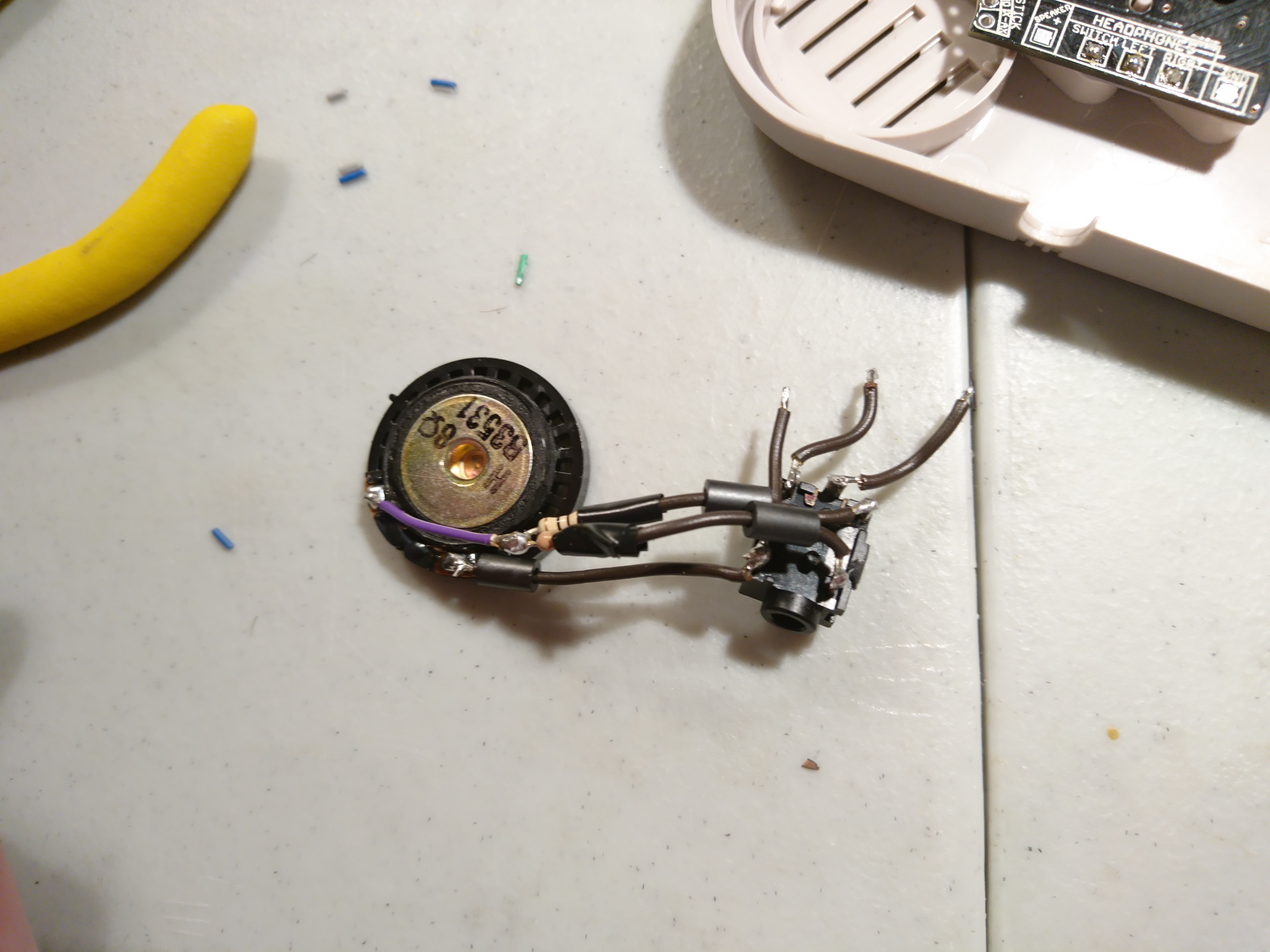

Has anyone used to pj-325 headphone jack without using an AIO board? I'm trying to figure out how to wire it up correctly.
I don't have an AIO so I tried to follow wermy's Custom parts guide. I have the left and right output going to the adafruit audio amplifier and I added 10ohm resistors to the L/R inputs which are going to the speaker. Does this sound right at all?
Sorry if this is completely wrong, first time doing anything like this.

Re: [Guide] Audio-/Headphone Jack Information Thread
I'm getting no sound to my speaker. When I go through menus in emulation station I should hear something right?
Here's how I have it wired. I also swapped the wires on the speaker.
Using original Gameboy speaker. Using volume wheel too. Am I missing something or not wired right?
Try removing the resistors and keep the ferrite beads. Try wiring it like http://sudomod.com/forum/viewtopic.php?f=22&t=1209 but use the correct pins associated with whichever jack your using.tlxxxsracer wrote:I'm getting no sound to my speaker. When I go through menus in emulation station I should hear something right?
Still getting no audio.RetroGamingNow wrote:Try removing the resistors and keep the ferrite beads. Try wiring it like http://sudomod.com/forum/viewtopic.php?f=22&t=1209 but use the correct pins associated with whichever jack your using.tlxxxsracer wrote:I'm getting no sound to my speaker. When I go through menus in emulation station I should hear something right?
Do i need a game to test the audio?
