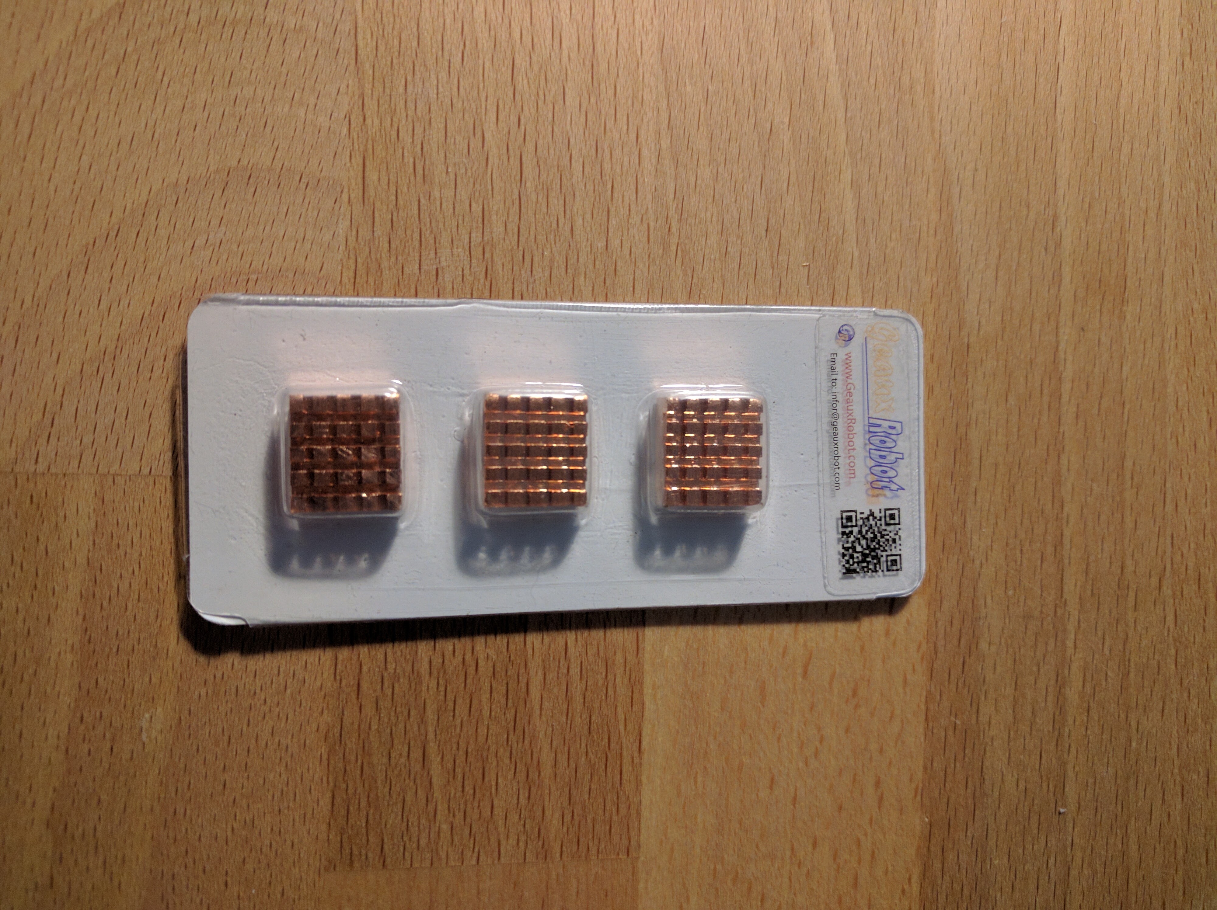

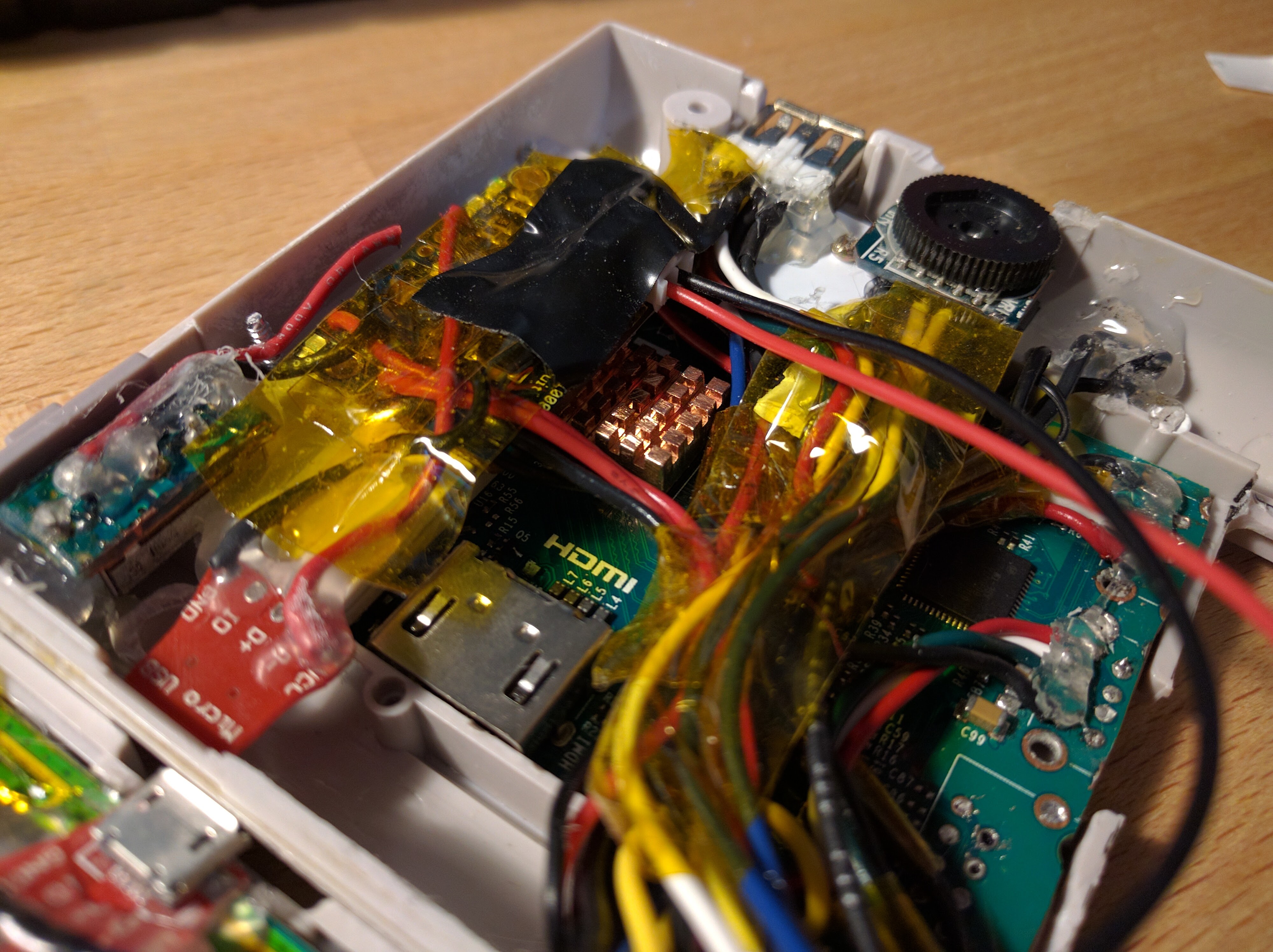

I added a heat sink to the processor to help with the over heating.
*The temps get to 60 degrees or higher sometimes which really calls for a fan, but the way I built this version, the fan does not fit. I will build a v3 model later and make sure there is room for the fan.
[spoiler="Heat Sink"]
[/spoiler]

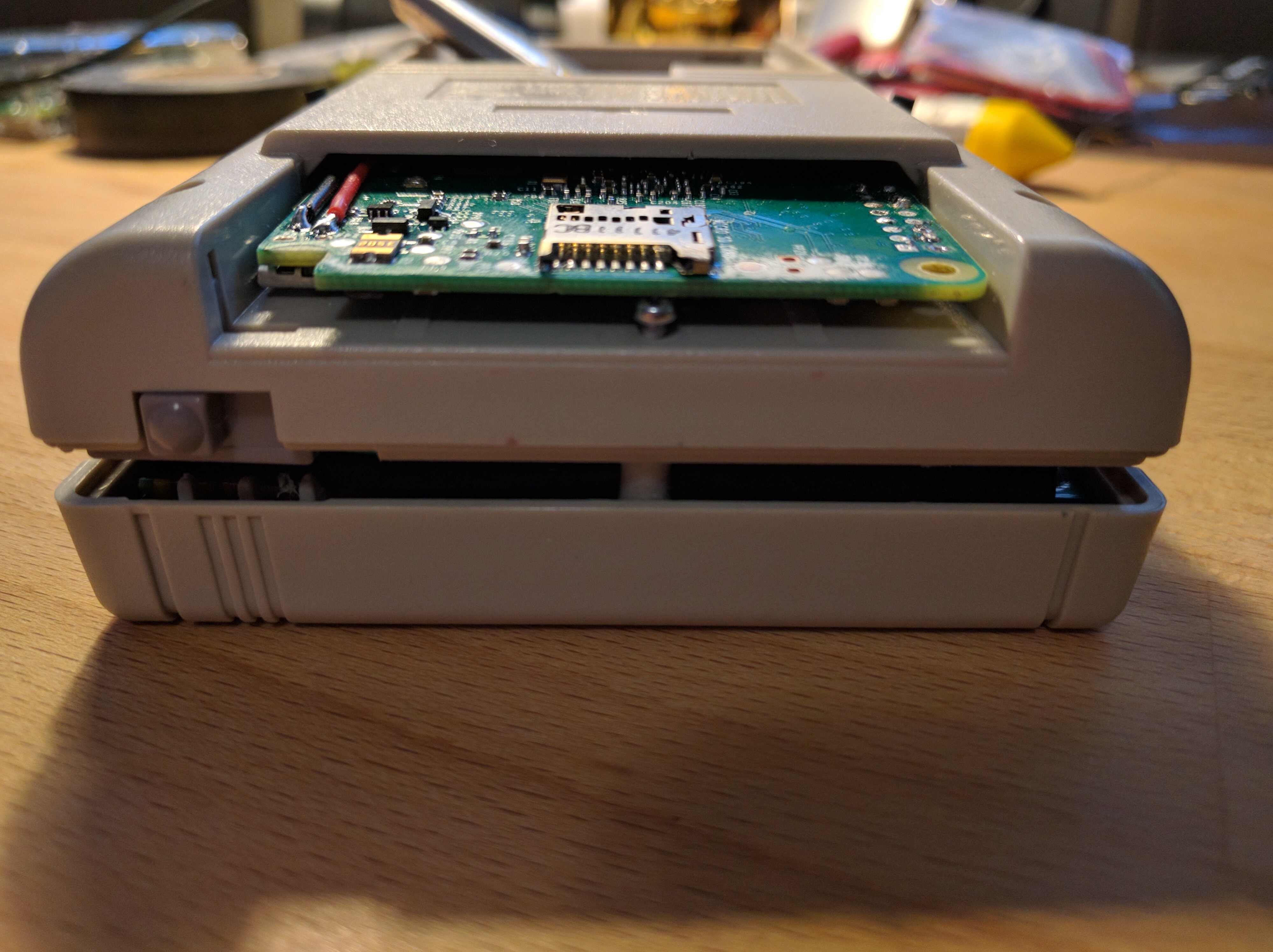

I created another screw post for the top of the case.
[spoiler="Screw Post"]
[/spoiler]

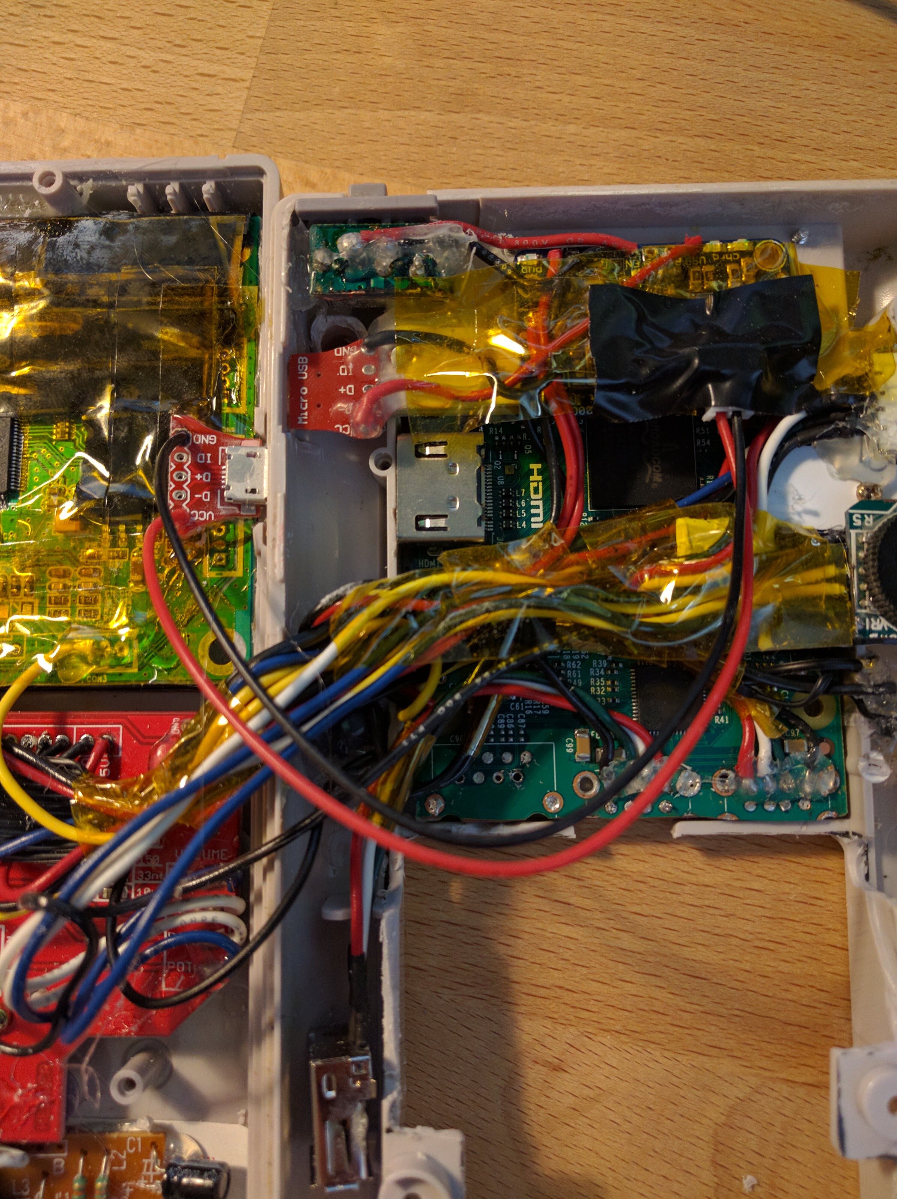

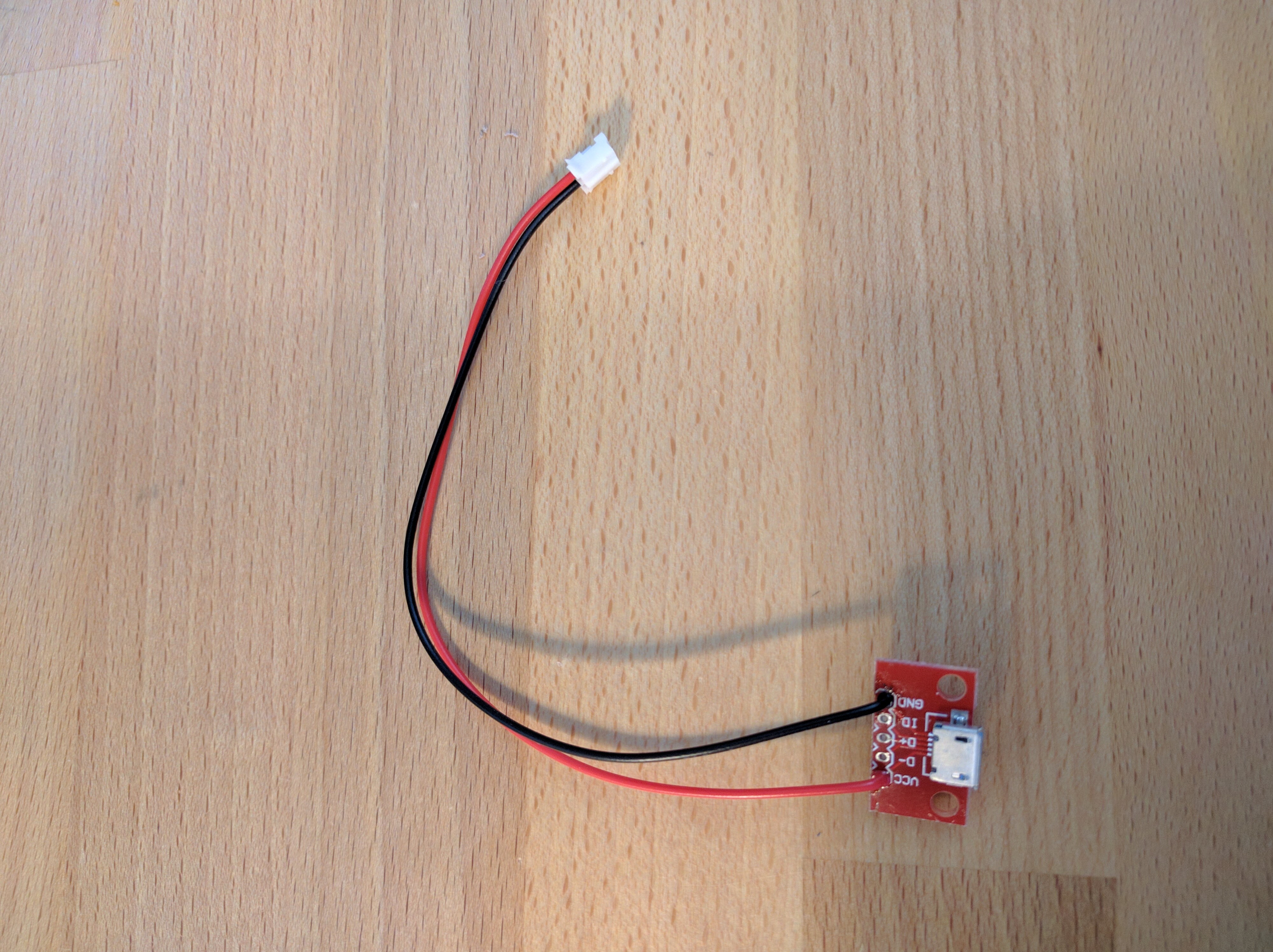

I created a second Micro USB connection so I can play with a power brick.
[spoiler="Second Micro USB port"]
[/spoiler]

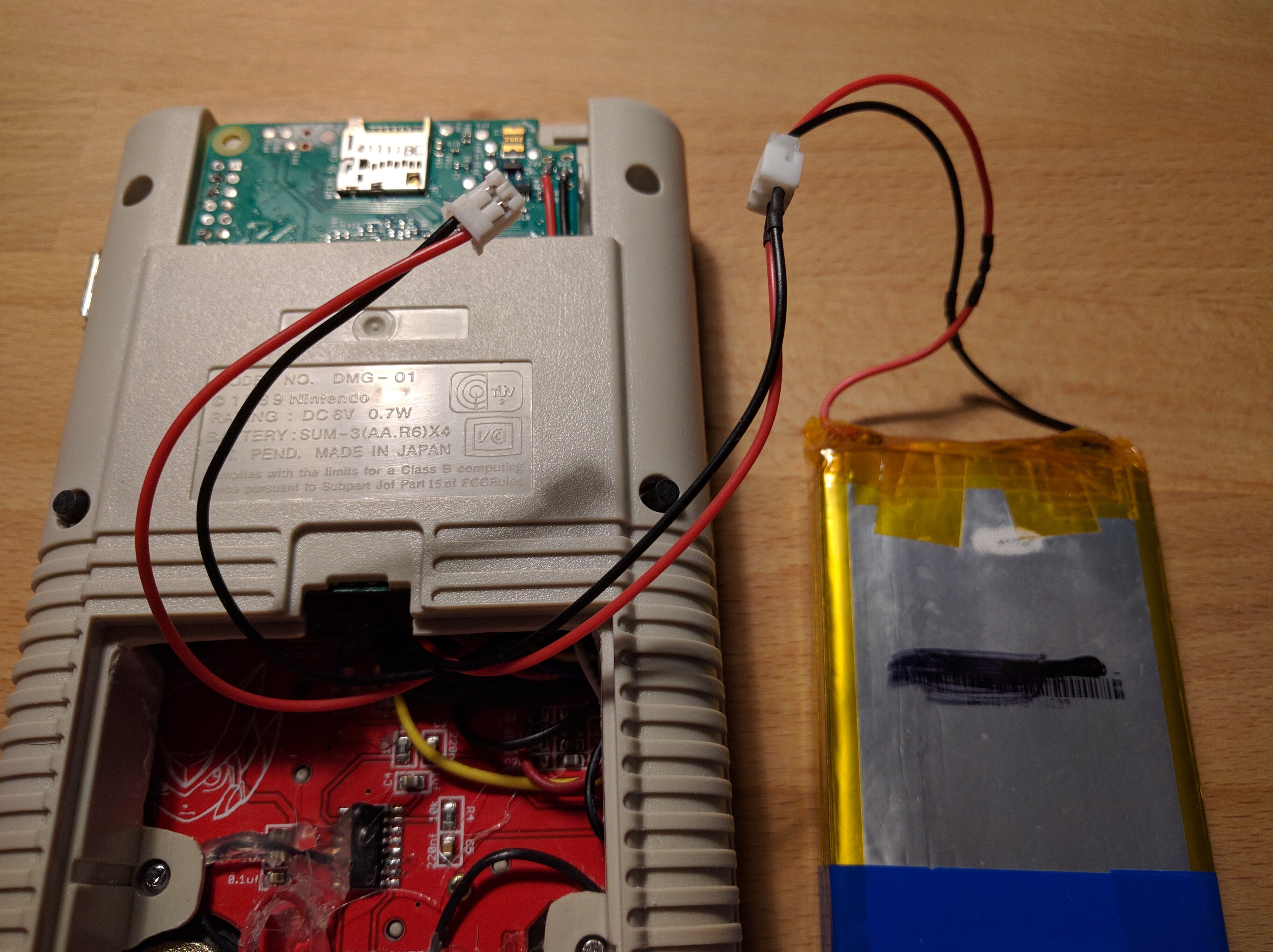

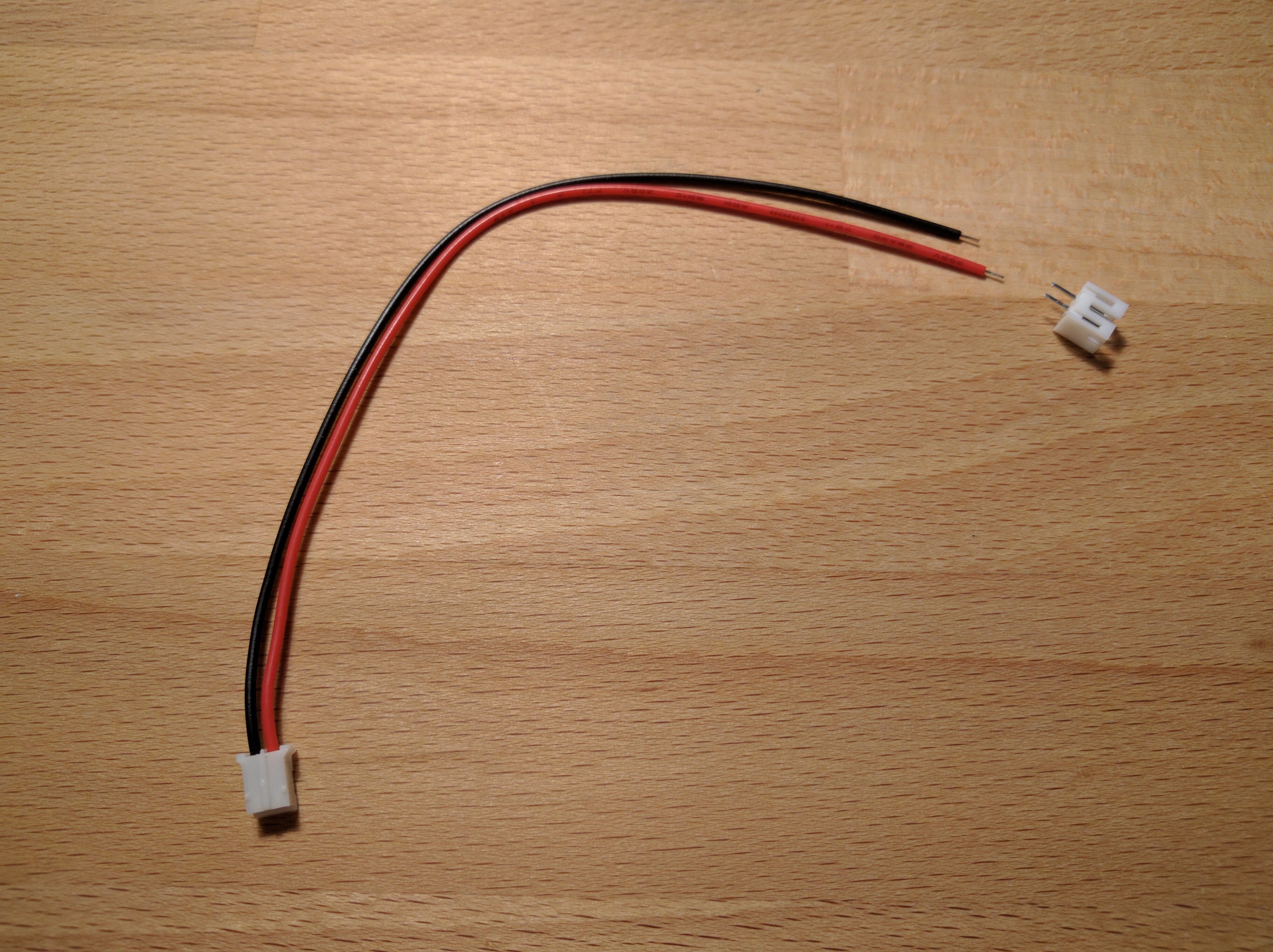

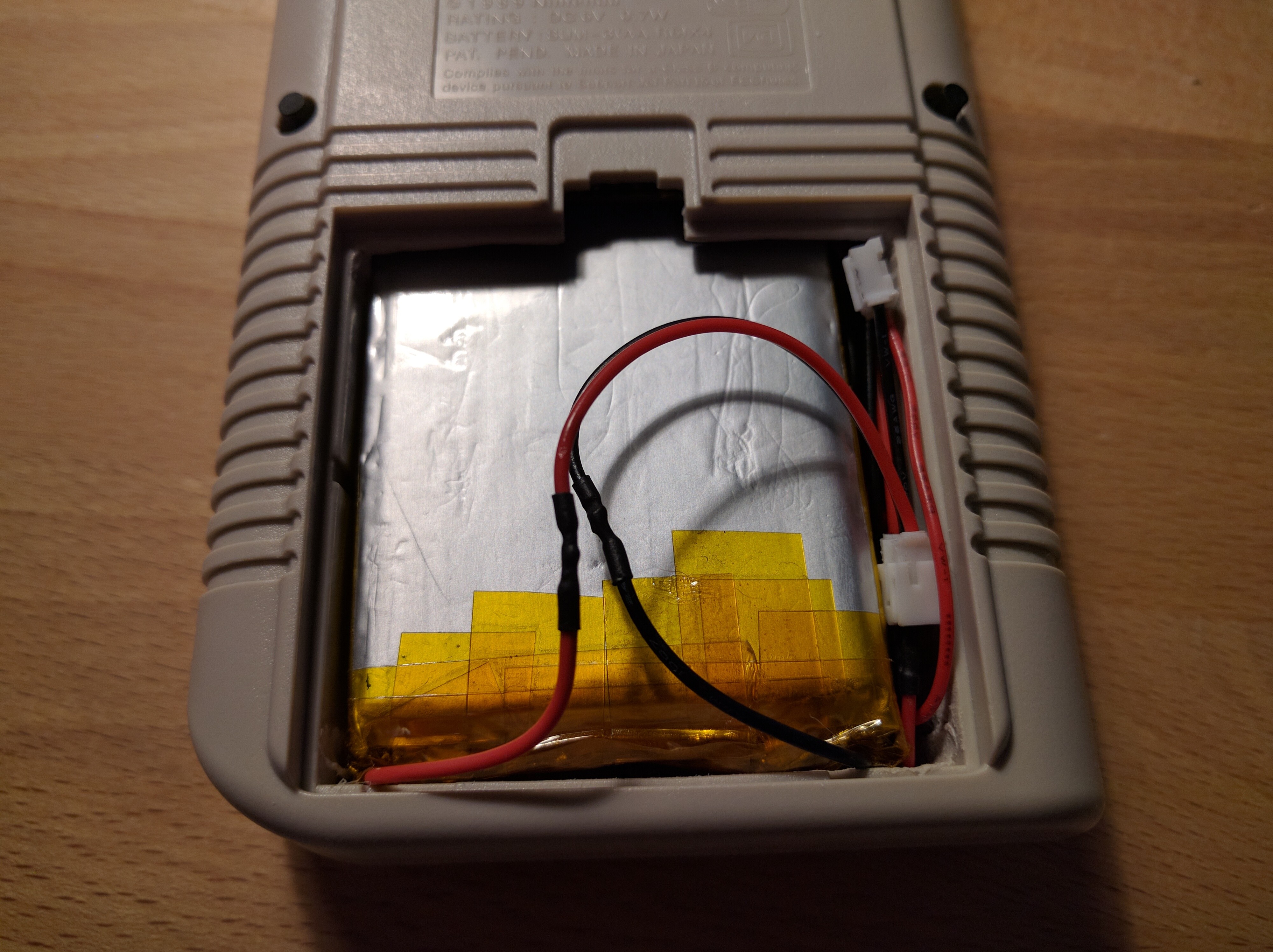

Made a male and female PIN for my powerboost and battery.
*This way I can unplug the battery and connect the other micro usb port for power if I want. You want to never leave your battery connected for safety reasons.

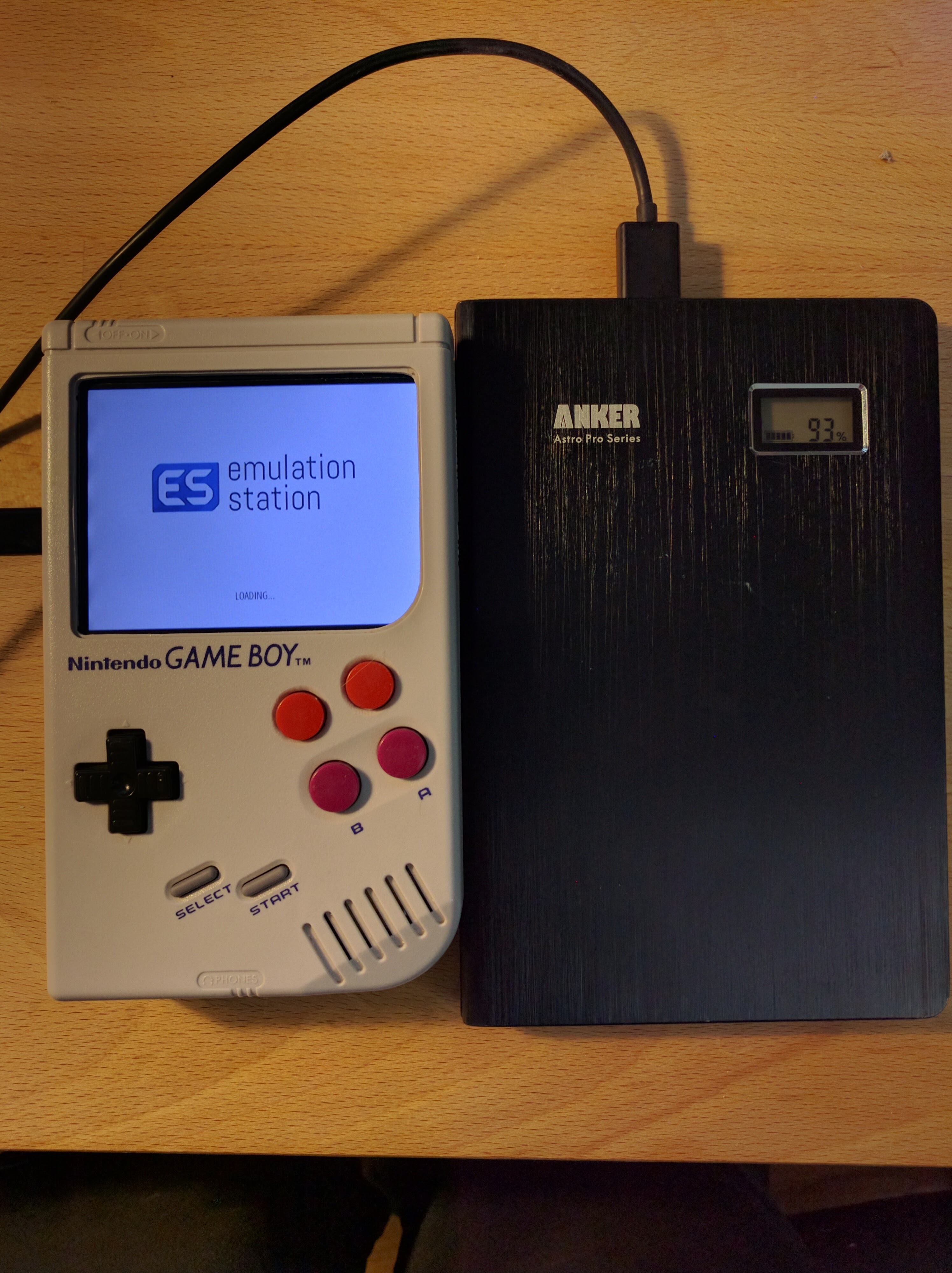

This is where I am right now. I have some custom stickers coming so I will post them once I receive them. I have been testing if for several days. Hope you guys enjoy.
