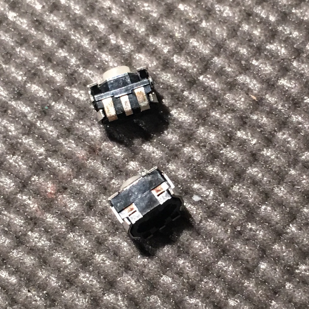

I bought everything they sold but it didn't say there will be shoulder buttons with it, I didn't know the shoulder buttons where DS Lite buttons
@Kyran and anyone else thinking of sourcing DS lite shoulder buttons...
DS Lite shoulder buttons will technically work (after all it's only a switch that clicks "on" when pressed and breaks when let go) BUT the DS Lite specific ones are absolutey TINY, and Surface mount. you'll have an absolute nightmare trying to make them work physically. you want regular 6mm x 6mm ones like this: http://uk.rs-online.com/web/p/tactile-switches/4791429/
you can usually get a big bag of them for a couple of bucks just searching ebay or amazon for "tact switch" or "tactile switch"
Here's what the DS Lite tactile switches for L/R look like. They have three pins on one side and none on the other.

[*]Tactile switches: 2 for start and select - these 2 will be pre-attached to Helder's board - (2.5mm tall including the actual button, 2mm tall without, 6.2mm x 6.2mm base), and 2 for L/R (5mm tall including the actual button, 3.2mm tall without, 6.2 x 6.2mm base)
2 are attached and you'll need 2 regulat tact switches (not the DS lite ones as mentioned only in the post above yours)

6x6x5 is perfectly usable in fact I ordered some similar but with 2 legs instead of 4 with longer legs for relatively cheap, Wermy used what he had on hand which is what he suggested but the base being 6x6 versus 6.2x6.2 is negligible for this.
