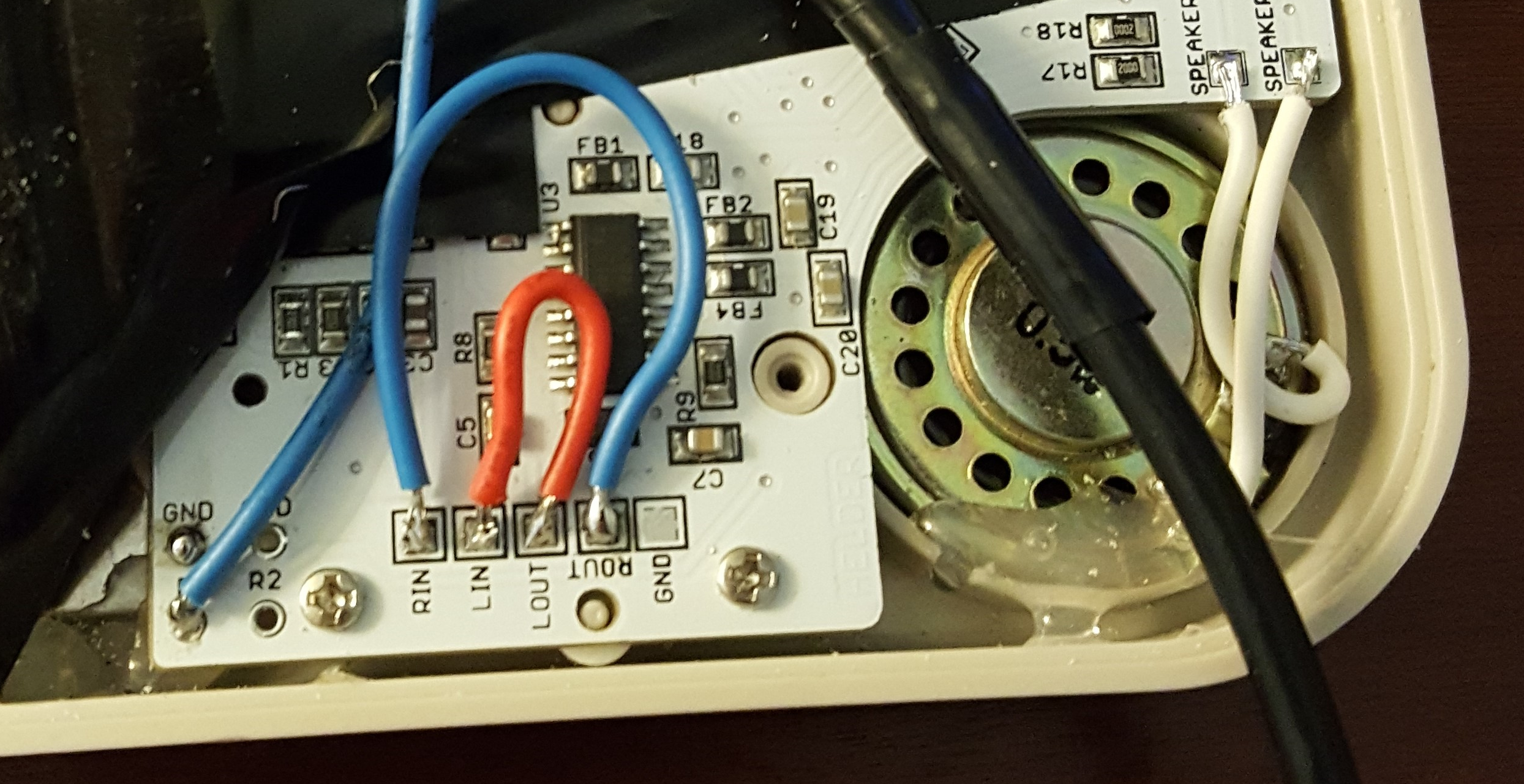

Helder wrote:
chanh55 wrote:Wifi works now! Transferring ROMs now... 500 kb/s. :shock:
If I don't wire up a volume wheel will the sound still work? Maybe through the headphone jack and HDMI?
No unless you use some wires in the pot pads, go look 3 pages back to see the diagram @Mischief made.
Like this? I matched the color too just to be sure. :D

AIO 2.2 - No Audio
Post by paeblits » Thu Nov 17, 2016 3:52 pm
I'm so close to finishing the build w the AIO 2.2. Everything works except audio. I get nothing out of the speaker, but when I plug in headphones I get a lot of loud static noise.
I've done/tried the following:
1. wired it up based on the wiring diagrams on another post. See image for reference.
2. updated my /boot/config.txt to contain
max_usb_current=1
disable_audio_dither=1
3. changing audio options in Emulation Station
I haven't:
1. modified /boot/cmdline.txt because I don't know if I need to yet.
I apologize for my terrible solder skills. Please see images below for how I have my wiring set up.

2 things I see from your pic.
1) On your volume wheel Pot 1 - 4 wires are reversed. This should go straight across. Not sure if this will just reverse the way you turn to lower/raise volume or if this will make it not work.
http://i.imgur.com/HmfM5Nn.jpg
2) Your PWM 0 and PWM1 wires are in the wrong pins on the RPi Zero
PW1 (your yellow wire) should be on the right column, 4th from the bottom (where you have solder)
PWM0 (your green wire) should be on left column, 6th from the top
http://i.imgur.com/YX6m9ny.jpg

shozumi@gmail.com wrote: 1) On your volume wheel Pot 1 - 4 wires are reversed. This should go straight across. Not sure if this will just reverse the way you turn to lower/raise volume or if this will make it not work.
I blindly wired them like you said and how it is shown in the video and it worked. This still confuses me because other wiring diagrams show the pins going to different places on the volume wheel.
shozumi@gmail.com wrote: 2) Your PWM 0 and PWM1 wires are in the wrong pins on the RPi Zero
Thanks. I should have just followed the video more closely. I had the impression that those two rows on the pi zero were like power and ground rows.
An interesting and important note for others putting their Game Boy Zeros together. I overwrote config.txt with the one provided on the first page of this post, but I did not overwrite cmdline.txt because I found that this messed with my USB ports and did not detect my keyboard. Helder should mention this on in the first post if it isn't already.
Thank you so much to all for the support!
