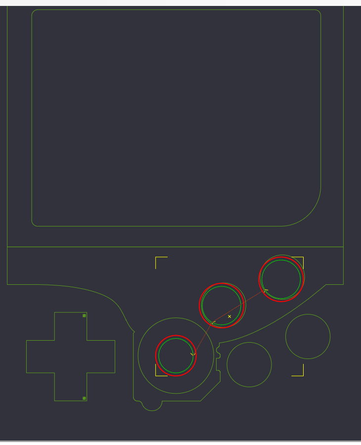

kubino
Posts: 207
Has thanked: 54 times
Been thanked: 152 times
Re: [For Sale]HoolyHoo's AIO bracket for Kite's SAIO Board
Post by kubino » Tue Feb 27, 2018 4:11 am
Allright we should be compatible with PSP bracket now! Huge thanks to HoolyHoo who provided outlines and center hole positions!
Anybody would like to try ? :D
Btw. what's the best hole size for PSP? 10-11mm?
