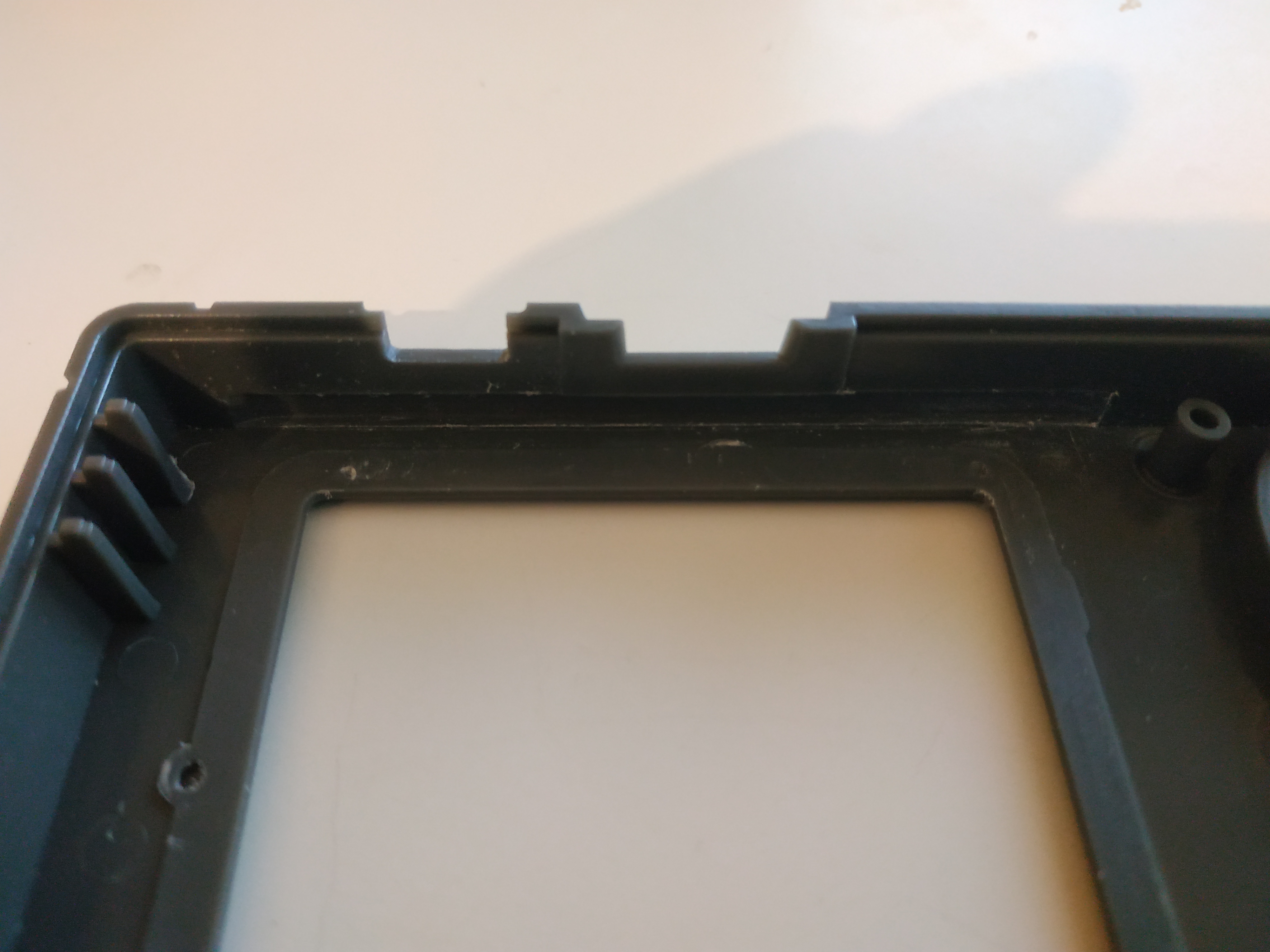

Post by kubino » Fri Jul 06, 2018 4:44 am

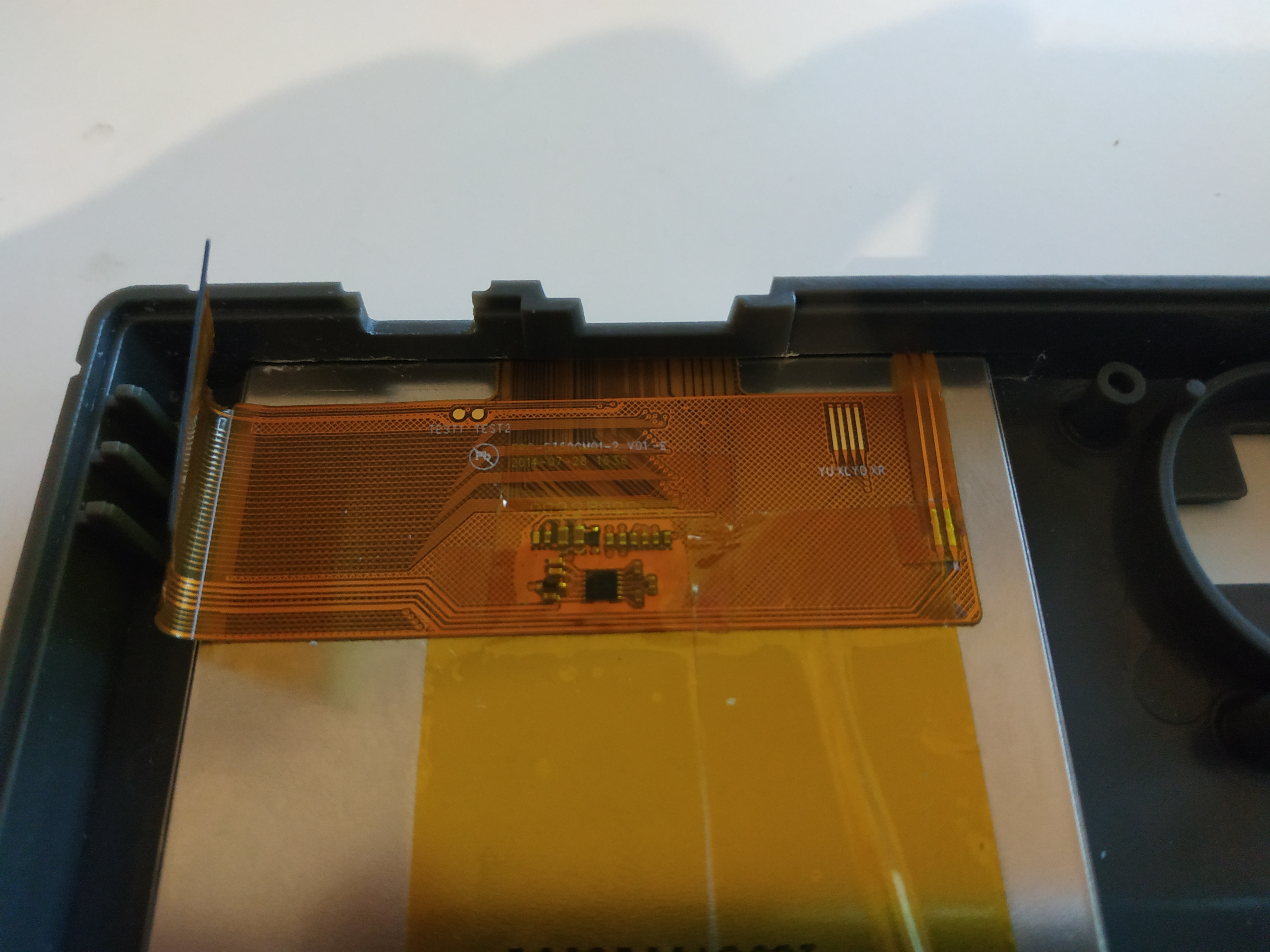

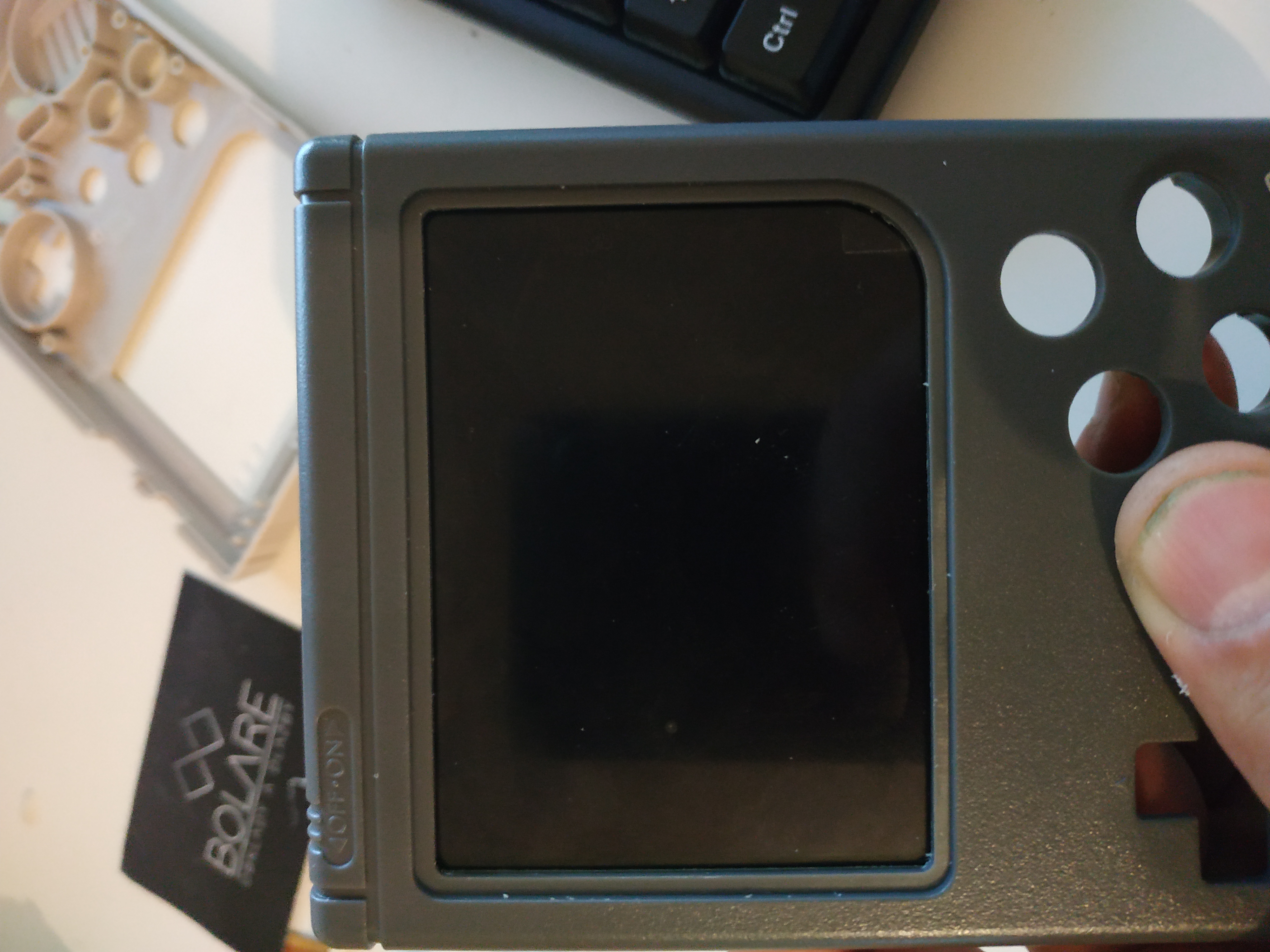

Finaly was able to play with 640screen. Here is what I was able to get :
Left side of the shell is shaved 1.6mm and small part under volume wheel is almost transparent, but still looking good when screen is installed ;-)
On the right side was enought 0.6mm

If you followed geometry from my bracket then vertical side should be OK, but for horizontal part there would be still some pixels missing on the right of the screen.

I'm affraid no space. The only possibility is to cut from the screen as described in wiki. If you insist I can do the hole throught the case but I dont think it will look nice ;-)

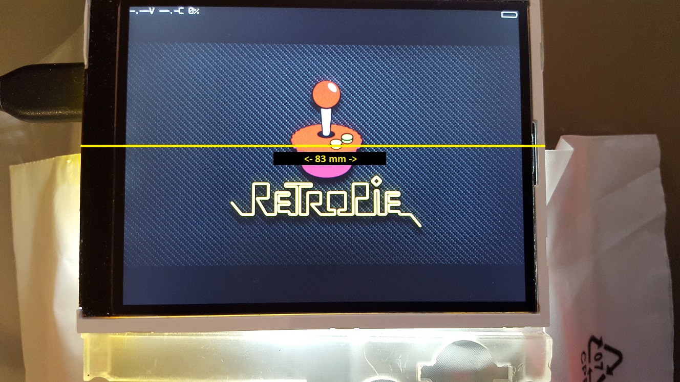

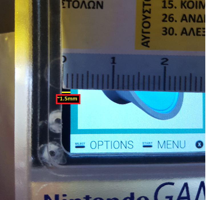

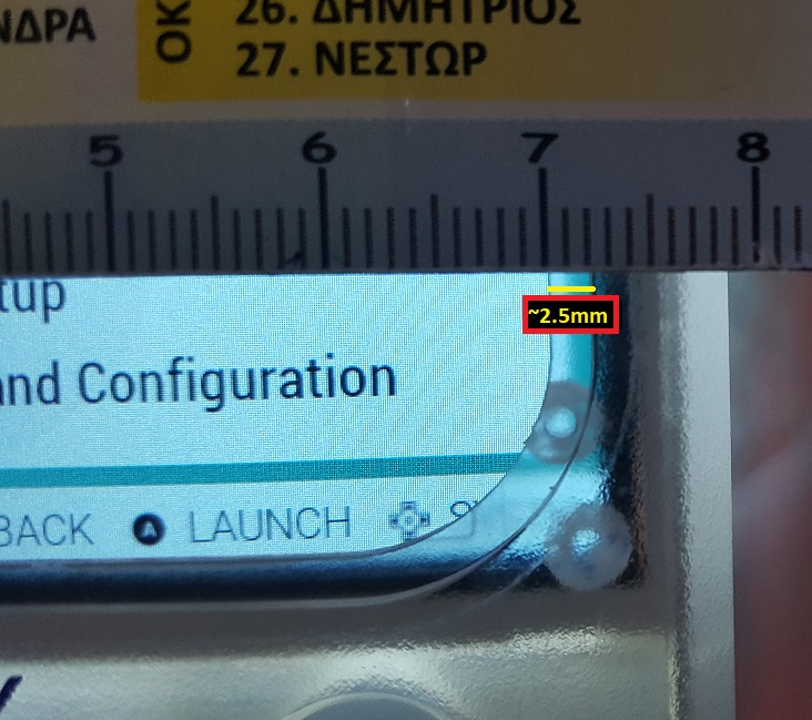

Hello guys, I got some measurements for the 640x480 screen, hopefully it will be useful to some of you..
So I cut the screen following the directions from Kite. The result is this:
the total width is ~83mm
I tried to put this with kubino's bracket directly on the front of the case. This is what we are missing from the sides:
Left
Right
Up and down sides are placed more or less OK.
What does this mean :?:
With the cut from Kubino we can have near perfect fit on the left side and lose ~1mm on the right side but without using overscan settings :)
Unfortunately to get the best results a cut on the screen would be needed.. be extra careful!
Cheers

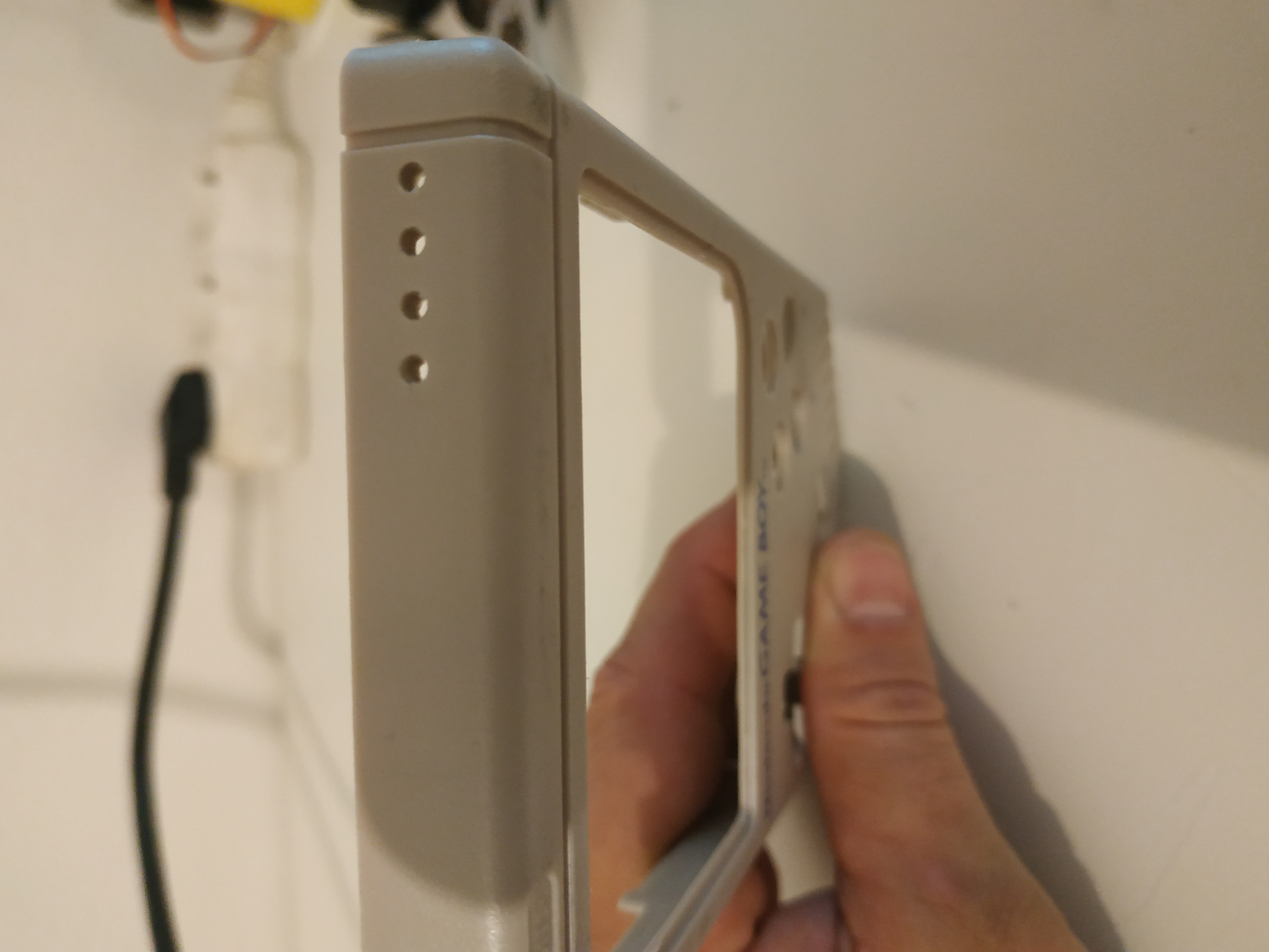

Post by kubino » Thu Jul 19, 2018 2:15 pm
This was quite requested cut, so here you go :-)

Post by kubino » Thu Aug 09, 2018 2:00 am
Battery cleanup on original shell:
